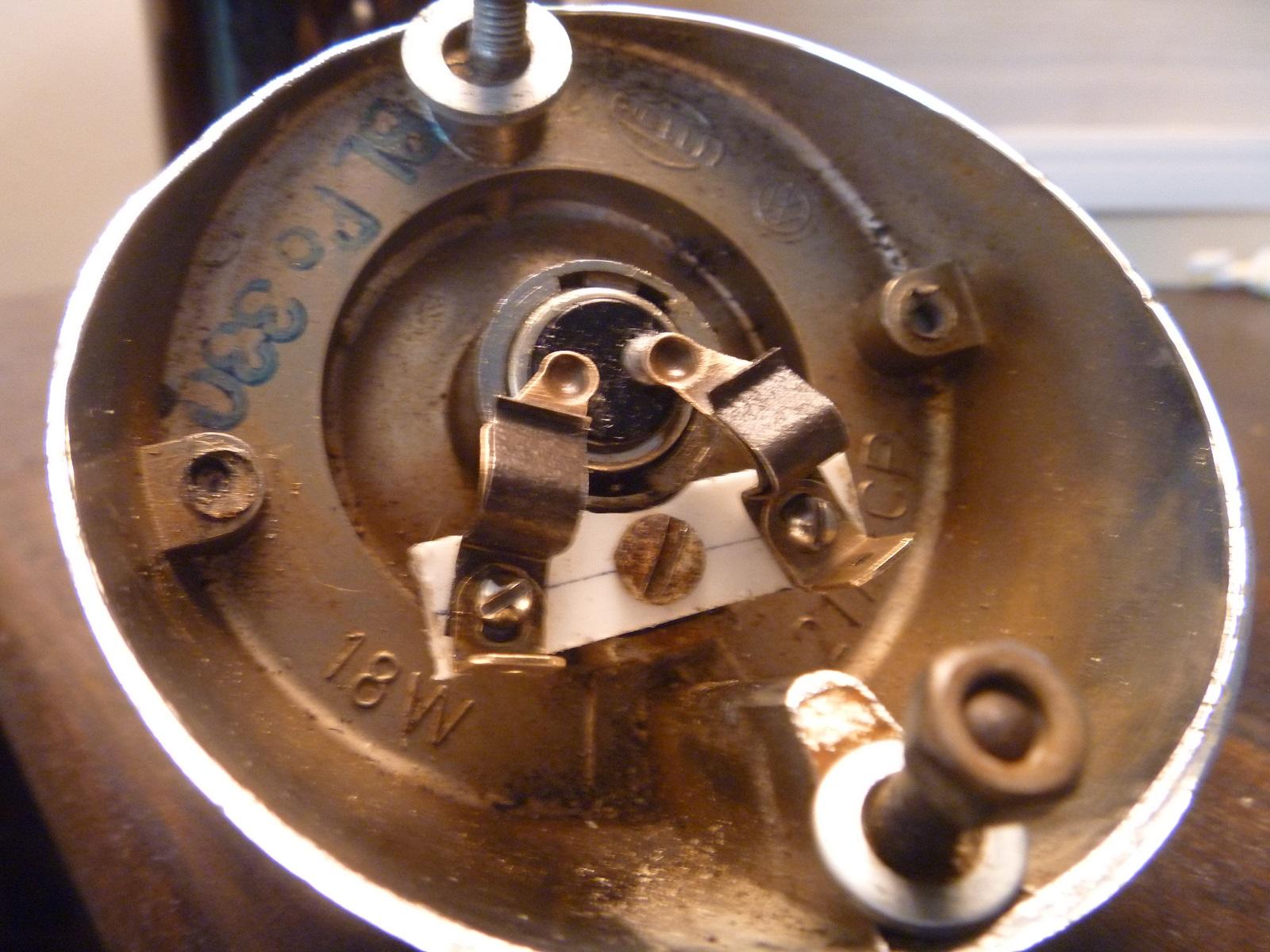

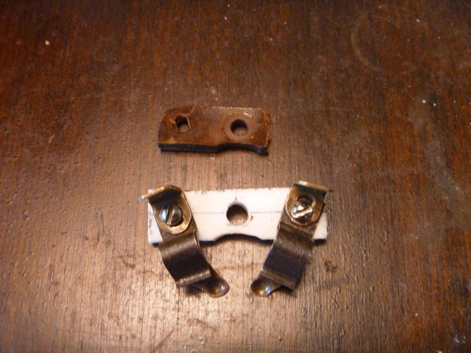

As pre-63 Ghia owners might already know, the little fibrous mounting board for the contacts in the front turn signals doesn't age well. In my case, one had succumbed to its age early on in the restoration and was replaced with the then-available replacements from KGPR. The other one was in ok shape and I thought it might last. It didn't. And just my luck; KGPR has ceased producing them. Time to make a new one then!
I had asked my engineer father and brother if they could come up with a replacement piece of plastic or something from their respective high-tech workplaces, but neither were able to come up with something (mostly because they'd get wrapped up in calculating tolerances or some other nerdy thing at work and forget). After snooping around the farm and my apartment for something that would work, I found a perfect candidate: a cheesy plastic ruler.
So, here's the new with part of the old:
And in situ:
Ben

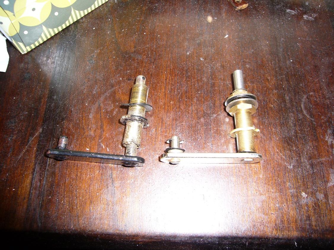

PostPosted: Wed May 14, 2014 10:48 am    Post subject: Reply with quote
I've driven the Ghia already a bit this summer. Took it for a quick bath a month or so ago:
Replaced a really, really worn out wiper shaft:

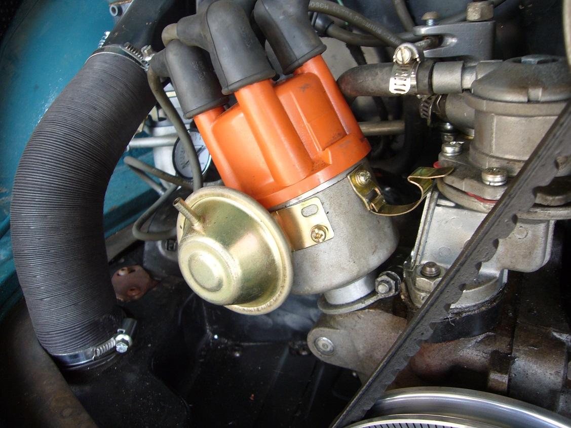

Ever since I got the thing going, I've just not been able to get it to run correctly. I set the timing, ran through the carb synch steps numerous times, and tweaked just about everything possible.
Still, the thing hated to start cold, ran rough until it warmed up, had a noticeable stumble during acceleration, and I could never really get the idle speed pinned down. I'd set it at 900 rpms and take it for a spin. Pull into the garage, and it's 1200... or 600. Aggravating.
I called up Jeff at the Kaddy Shack, and he suggested that I might have a bad distributor. Couldn't be the case, could it? It's brand new! I bought an old beat-up SVDA from a local guy and popped it in to check, and lo and behold, I think it might have solved the problem. Hurray for fixing it, but -1000 points to me for feeding the spm (shitty parts monster). Embarassed
Distributor in question:

You did have the vacuum hooked to the canister?
ernstben
Joined: April 30, 2005
Posts: 622
Location: Manchester, Mi
ernstben is offline
PostPosted: Wed May 14, 2014 1:59 pm    Post subject: Reply with quote
Laughing Absolutely. Just took the picture as I was taking it out.
