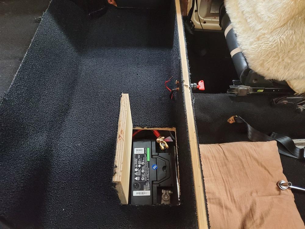

Im workin this question. But first. Battery stuff. Cool Cool
Re-gluing door panels Mad Arrow Mad

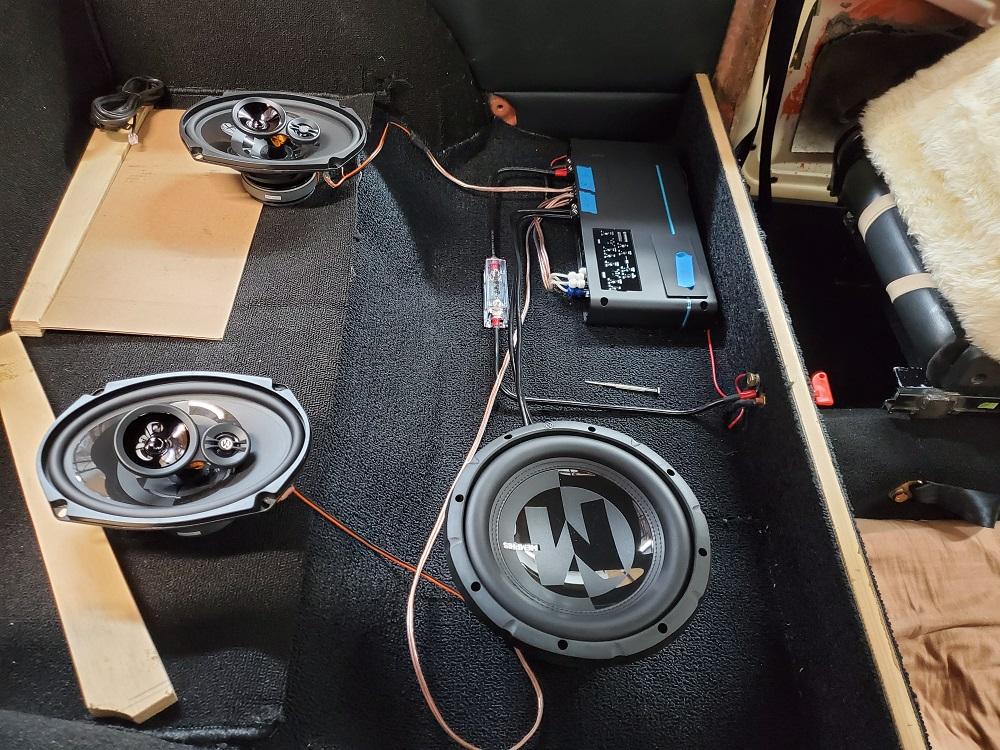

Slooooowleeeeee workin it. Pics. 10 inch sub
I got the 700 5 channel but only using 4 channel. Cassette player has no sub connection.
Sounds awesome. But,,, Front speakers are a pain to install.

Puttin the clips in for the front speakers was a pain Mad
Cut and glue em in Arrow Arrow Arrow Let dry Mad
Put screws in and let dry to get placement Mad
Done, Sweetness Cool Very Happy Very Happy Very Happy Cool
Freakin pain, but look and sound awesome. Cool Cool
Finish the rear and Crank It Up Cool Cool Cool Cool

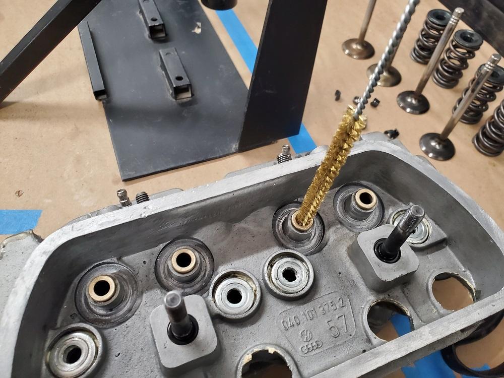

Well, Choke My Chicken, Im an idiot. You will never guess what it was. Well let me explain.
Ready Question Question Question

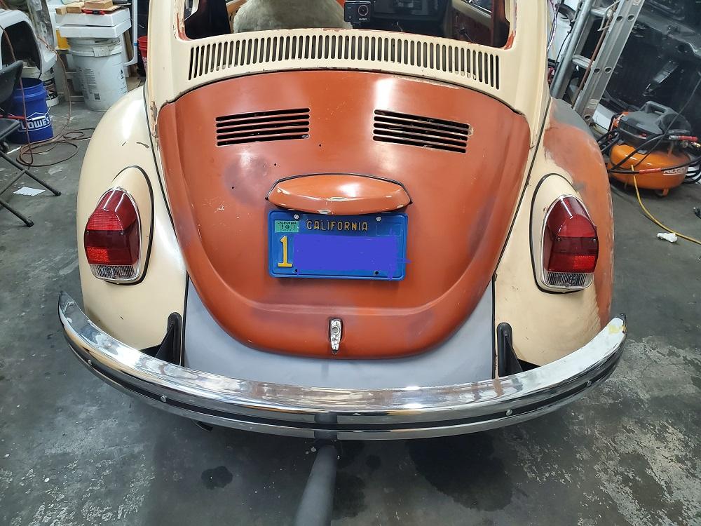

BAD GAS, can you believe. The gas glued the valves in the guides, like stuck. The popping you hear is the springs, pushrod being tortured and make that popping noise on #2 intake. It was really stuck.
The first time it happened the pushrod was half on the cup, so I popped it back in, but 1&2 never sounded right on start up. Than after 2 months, same sound. Depressing thoughts,. Take it all apart and relief. Very Happy Very Happy Cool
Remember all this HP TQ & Chrome and System, around 5gs. Im a cheep ass POS Cool Shocked Cool
Lets scrub everything pretty and put it back together. No turbo this time Sad
I was trying to move JB to another location to finish the Tank, real close to painting, and this happens. I need it driving, so lets slap it back together. Cool
Thought the worst stuff, but, lookin pretty in there Very Happy Cool Very Happy

PostPosted: Thu Nov 14, 2024 9:32 am    Post subject: Re: 1971 Beetle Restoration (The Junkyard Bug) Reply with quote

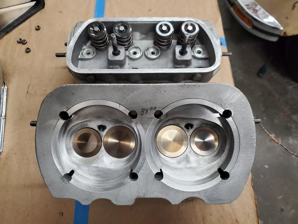

Wait, I could still go Turbo, but someone would have to give me a Boost Laughing Laughing Laughing Shocked
I need to take off some CCs somewhere. 51 here Arrow Arrow
Pretty Cool
Cleansing my valve guides Cool Cool Cool Arrow
Clean Cool Arrow Arrow
The Tank has many uses. Valve spring compressor. Cool Cool Cool Arrow
Who wants me to turbo it?? Question Question Idea Idea

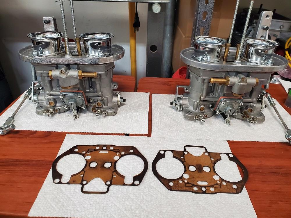

Carbs all cleansed Cool Cool Cool

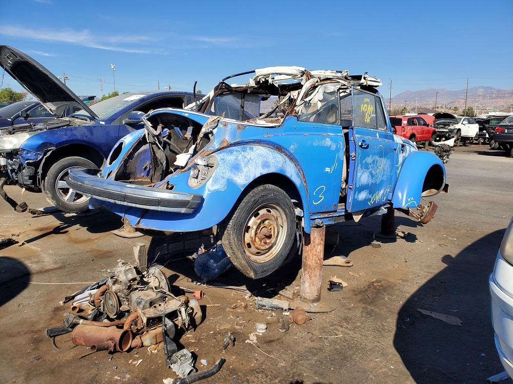

Went back on Sat. they took the van. That was depressing Sad Mad Sad
Another beetle to the crusher. Sad
