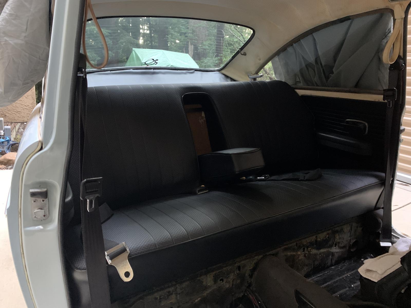

Today I wrapped up reupholstering the backseat. It’s a good project to do inside while we are having a heat wave. I did bottom a while back and was working up to the backrest. That was a beast. I think you have to be an octopus with experience in massage and shoving watermelons up a monkey’s ars.
I still need to get a couple black brads for the cardboard behind the arm rest and figure out why the bottom won’t go on the pins. But not being an upholsterer and done this a few times before, I think it came out pretty well.
Feels very comfy and less smelly. I think original owner was a smoker so that and crumbling horse hair didn’t make it a pleasant cabin. Plus it makes me itchy.
Next front seats, which will need folding knob sorted out. I was able to pull them off but clips stayed inside, and replacements are way too short
Scotty D
Joined: February 08, 2020
Posts: 285
Location: Claremont CA
Scotty D is offline
PostPosted: Sun Jul 07, 2024 9:18 pm    Post subject: Re: 1970 Fastback "sympathetic restoration" Reply with quote
Looks fantastic. Well done.
I’m glad my late Squareback doesn’t have a rear seat arm rest to worry about when I attempt to recover it. Seems you’ve handled it quite well.

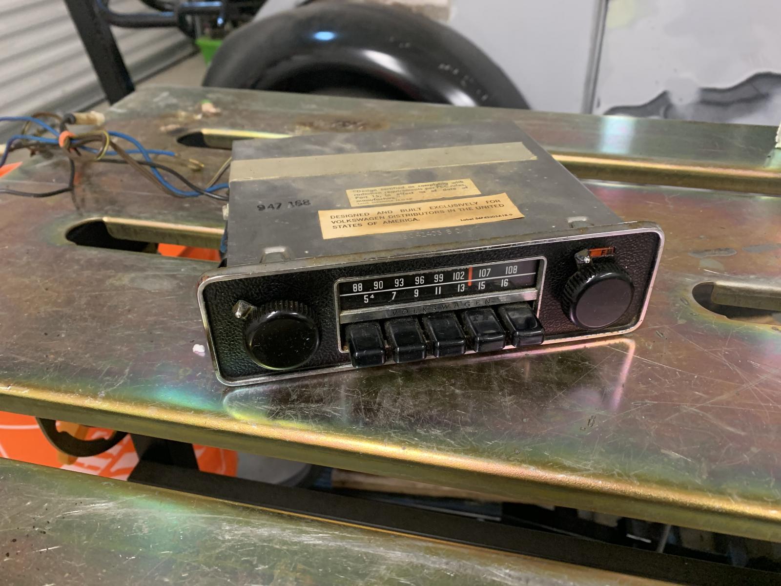

While searching for some bits for invader project, I dug out this!
I don’t believe it’s functional, but now I will need to find someone who can restore it.

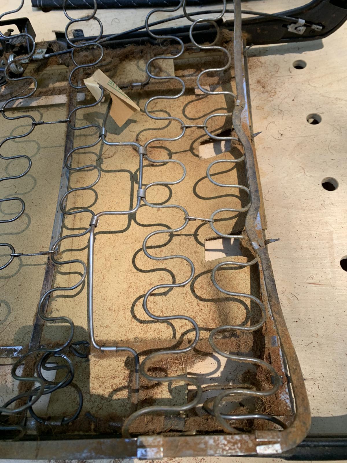

Making progress on the front passenger
A while back I replaced the foam but jet original covers, they are officially clapped out…
All stripped down and clean
I used .5mm plastic to get the cover on
Bottom needed a little tlc
Tiged on both sides and backed it up with a 20 gauge strip
I think it’s missing some springs I am guessing that the lever on the backrest is supposed let the sit slide forward
The backrest is not tight enough to finish it, need a bit more time in the sun. And I ran out of jute, another roll and it should cover the floor as well.
Scotty D
Posts: 285
Scotty D is offline
PostPosted: Tue Jul 16, 2024 11:00 am    Post subject: Re: 1970 Fastback "sympathetic restoration" Reply with quote
Nice work. The seats are coming along nicely.
I'm guessing the lever on the backrest is used to allow it to release it from the locked upright position and lean forward.
The driver side lever is non-op on my '73 Squareback front seat, I'll be taking it all apart eventually as all of the padding needs replaced, along with new seat covers.

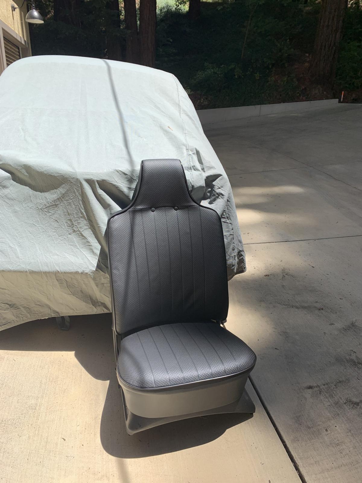

Today I wrapped up as far as I can the passenger seat. I still had to pull the cover over the spikes on the back rest and assemble the whole thing.
Here I am using old cover to find location of the wires for the buttons
Luckily my buttons are mint but if somebody needs a part number here it is. I don't think they are available.
back side looking top notch
and so is the front. I got them back where they were originally and right on the lines just below the stitch
After assembly here is the result
I was a bit bummed out about the bunching up in the bottom middle in the back rest but after 30 minutes in the sun everything went into it's place!
this is almost stock looking except there are supposed to be 9 lines not 7. I think i can live with that!

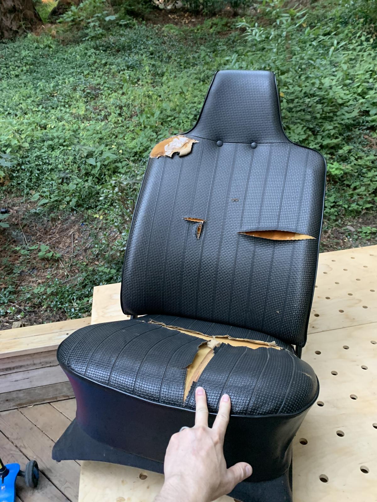

Now onto the driver side

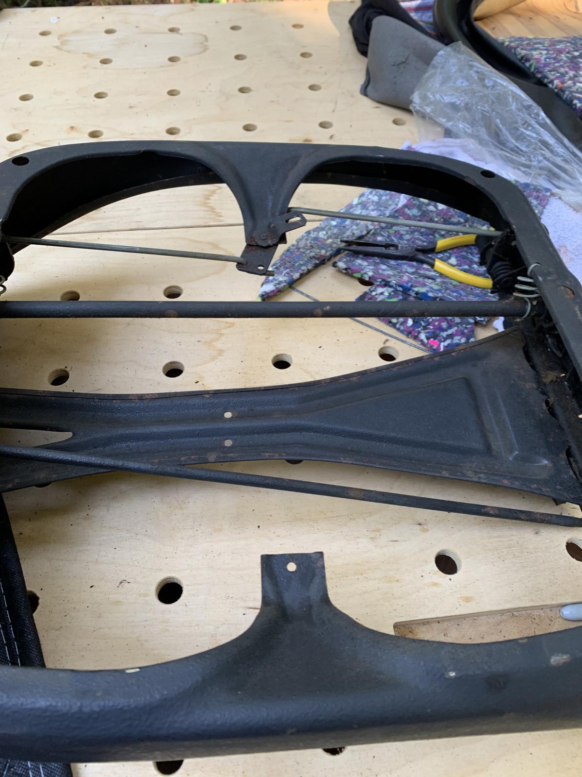

this is what we started, very clapped out original.
This is the kind of crap that is all over the car, it's not fun to have that flying around and getting it in your eye.

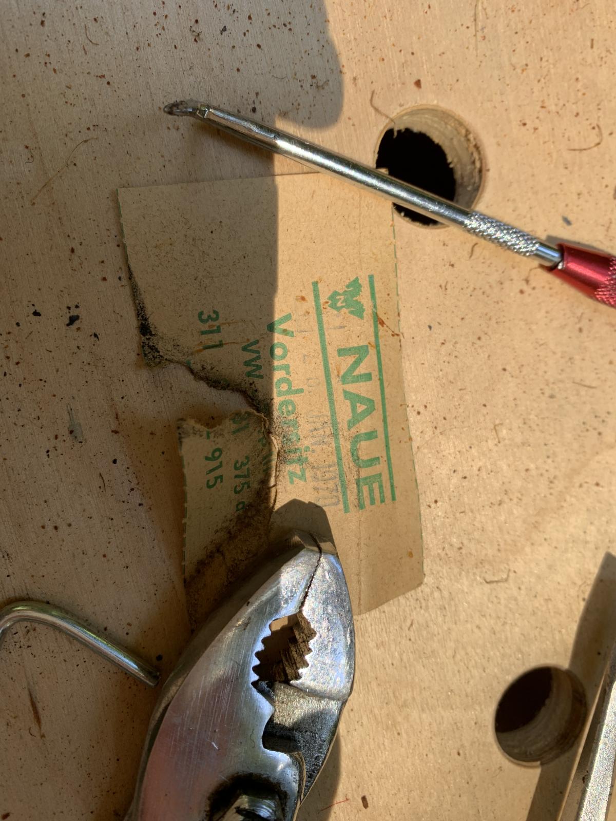

still had original tags!
not sure if it says jun or jan 1970, I think the car was built in august or something later in the year.

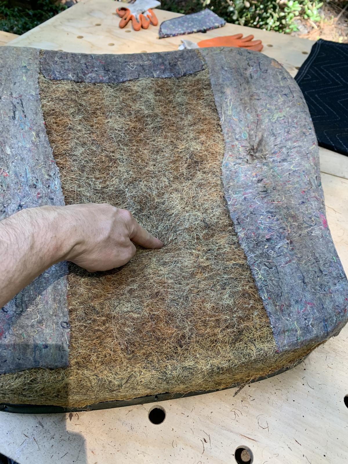

These bent needle nose pliers are best for unbending some of the spikes
It was not fun ridding in this seat, when I flipped it over, sprints were nearly through the horse hair pad
To my surprise and delight new foam is not the light foam that is more of craft store variety but molded proper auto trim type. Buttom pieces are too narrow though so that causes small bulges just below the top.

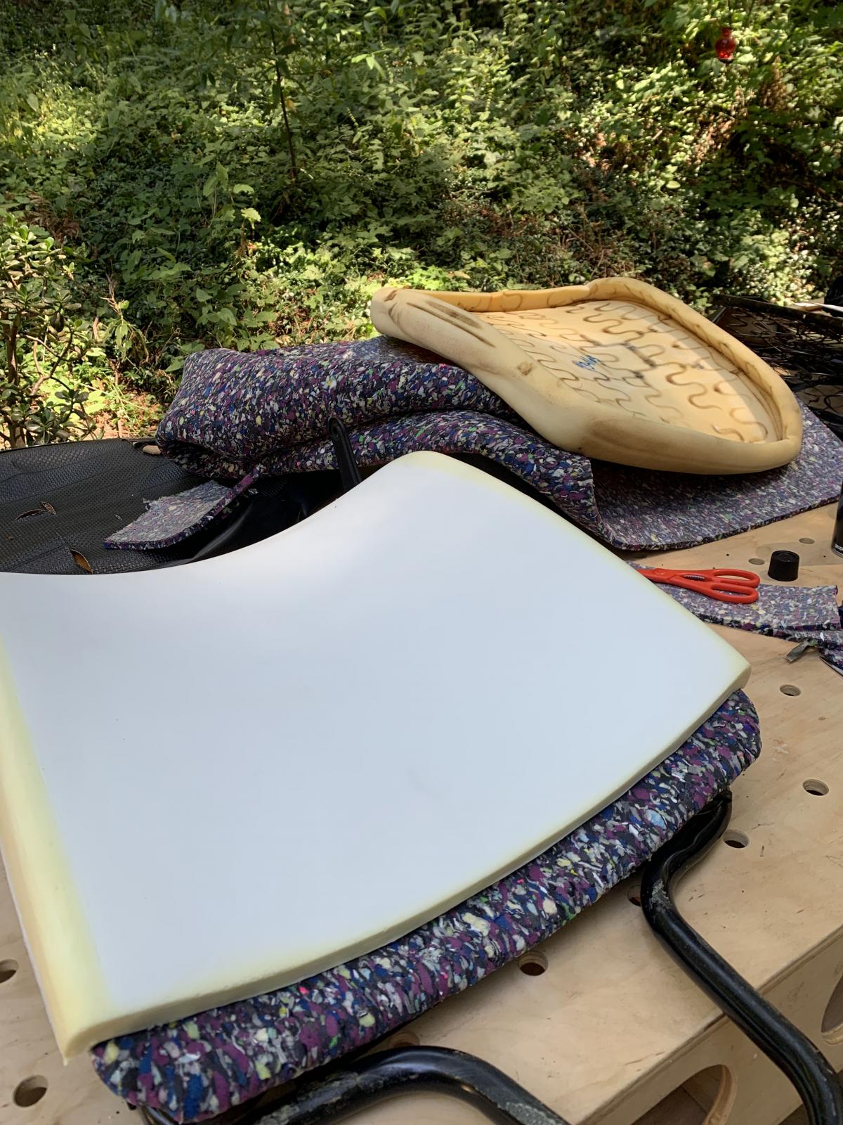

after test sitting the passenger I figured I would add just a tad more lumbar support, on the passenger side just added one layer of jut and here I did two.
Now I am at the same progress with driver side as I was with passenger this morning. I have both sides covered but I need to finish the back rest. I want to give it a bit of heat before doing the final pull.
