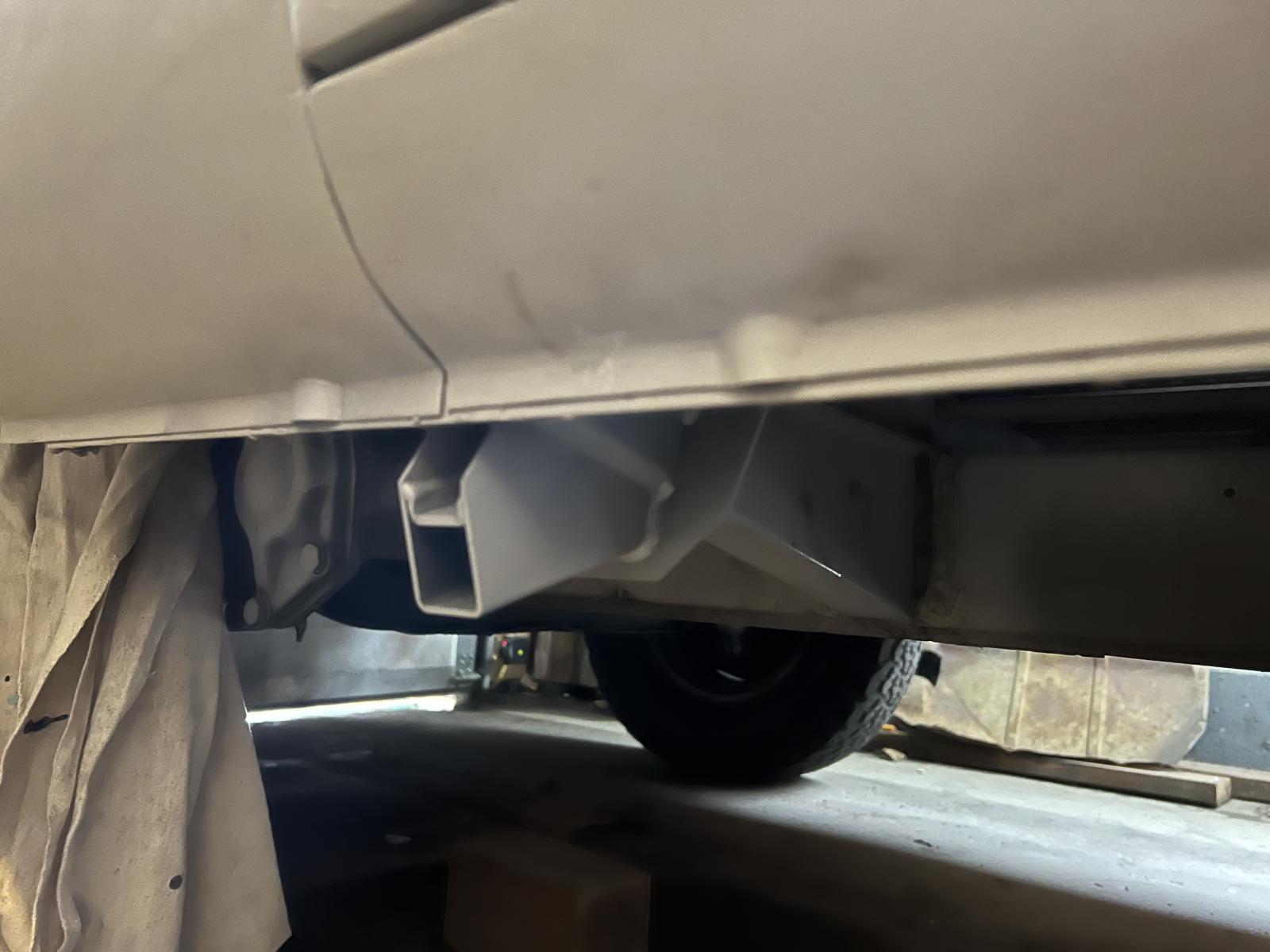

A little progress, still need to finish welding.

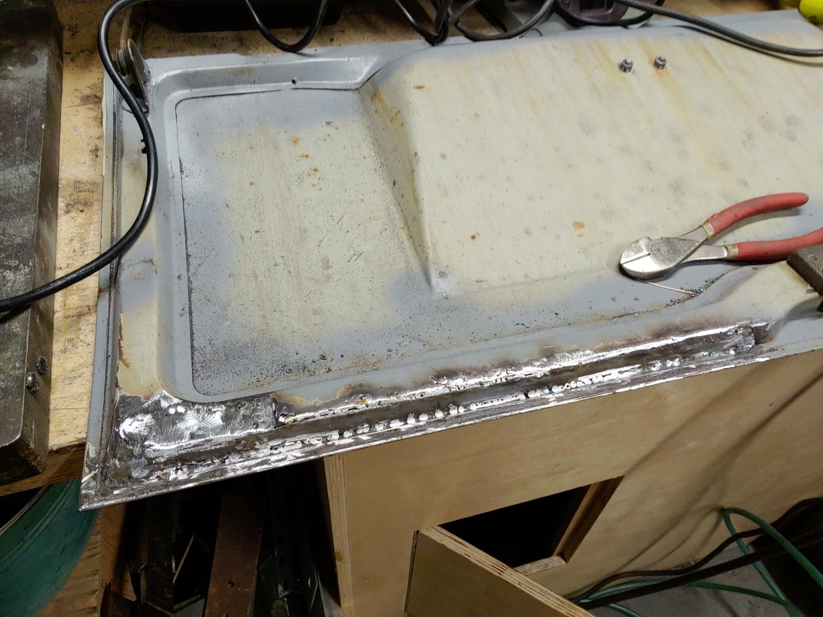

Tailgate is solid, needs to be stripped and painted.
Got a new Wolfsburg West apron. Excellent part and great fit.
Spent a few more hours stripping paint in door edges and jambs. Lots more to strip.

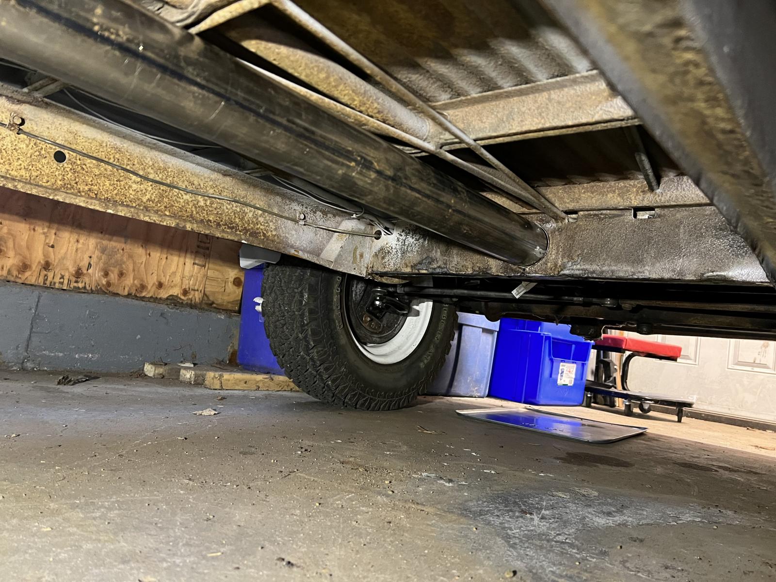

I got two Jack points mostly welded in today, but my welder died on me part way through!

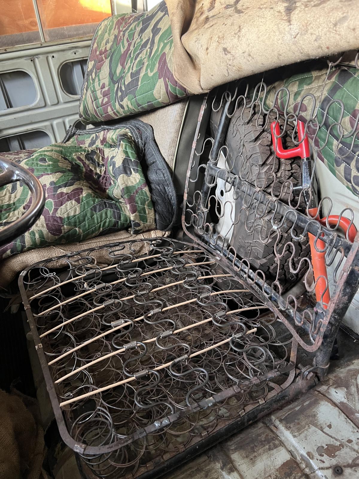

I had a very saggy driver seat. Coils are very hard to find and expensive so I tried getting some flat couch springs and putting them in. I need a couple more to even it out but worked great. I welded the ends to the seat frame. They come pretty coiled up so I bent them mostly flat first. Worked very well- much less saggy and still uses the old couls to support some of the load.

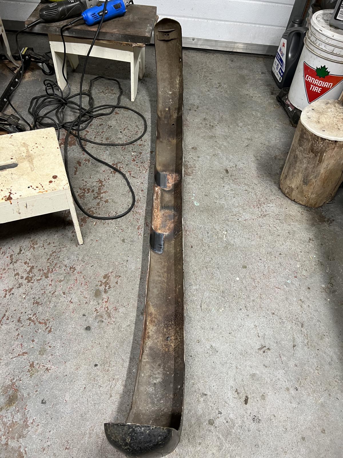

My friend and I started on fixing the rear bumper this holiday season. It was pretty rough..had been hit so lot of wrnkles, dents, and some beetle tailpipe cutouts:
Before
After
The before/after doesn’t do it justice… I’m happy with the results. Once it warms up I will prime and paint and get the overriders back on.

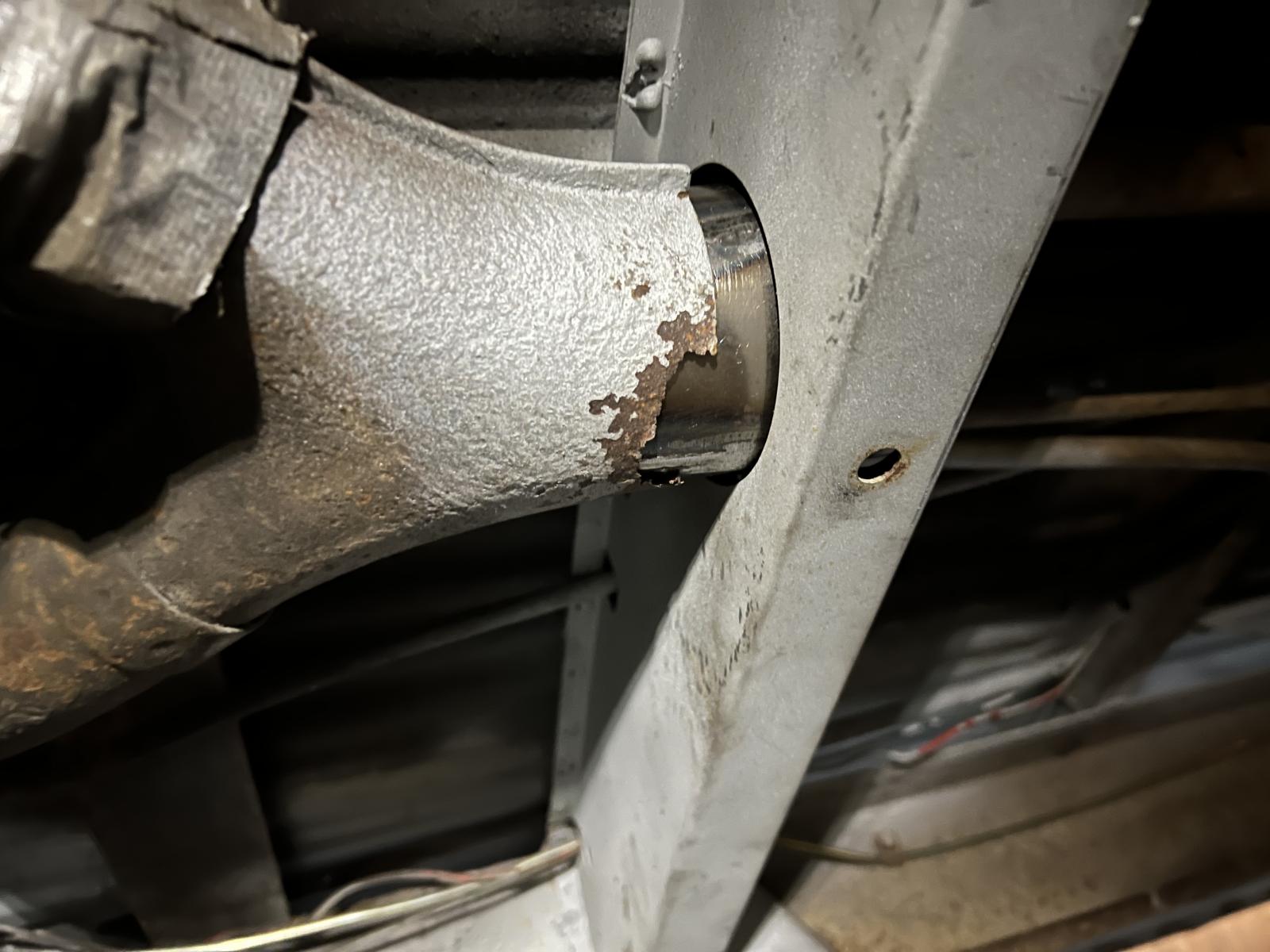

Today I replaced the main heat tube. The heater boxes need replacing but may work still. Most of the ducting was good both up front and coming off the heater boxes, other than the bottom of the y-tube as shown. I think it’s repairable though, which I will do eventually when I replace the exhaust system…probably a few years out still.
It seems WW sells all the parts, but getting them here is a bit pricey. To save time and money I did what others on here suggested and got some 2.75” OD
exhaust tube and a 2.75” ID connector. I had to taper both ends of the pipe as shown- they wouldn’t slide in otherwise. Next up I will paint them and install them, and see if I can get any carbon monoxide free heat up front!

Installed. I’m very excited to have working heat! I just put a screw through each side to hold it in place. It’s a pretty solid friction fit too. I will order the insulation and cables soon.
