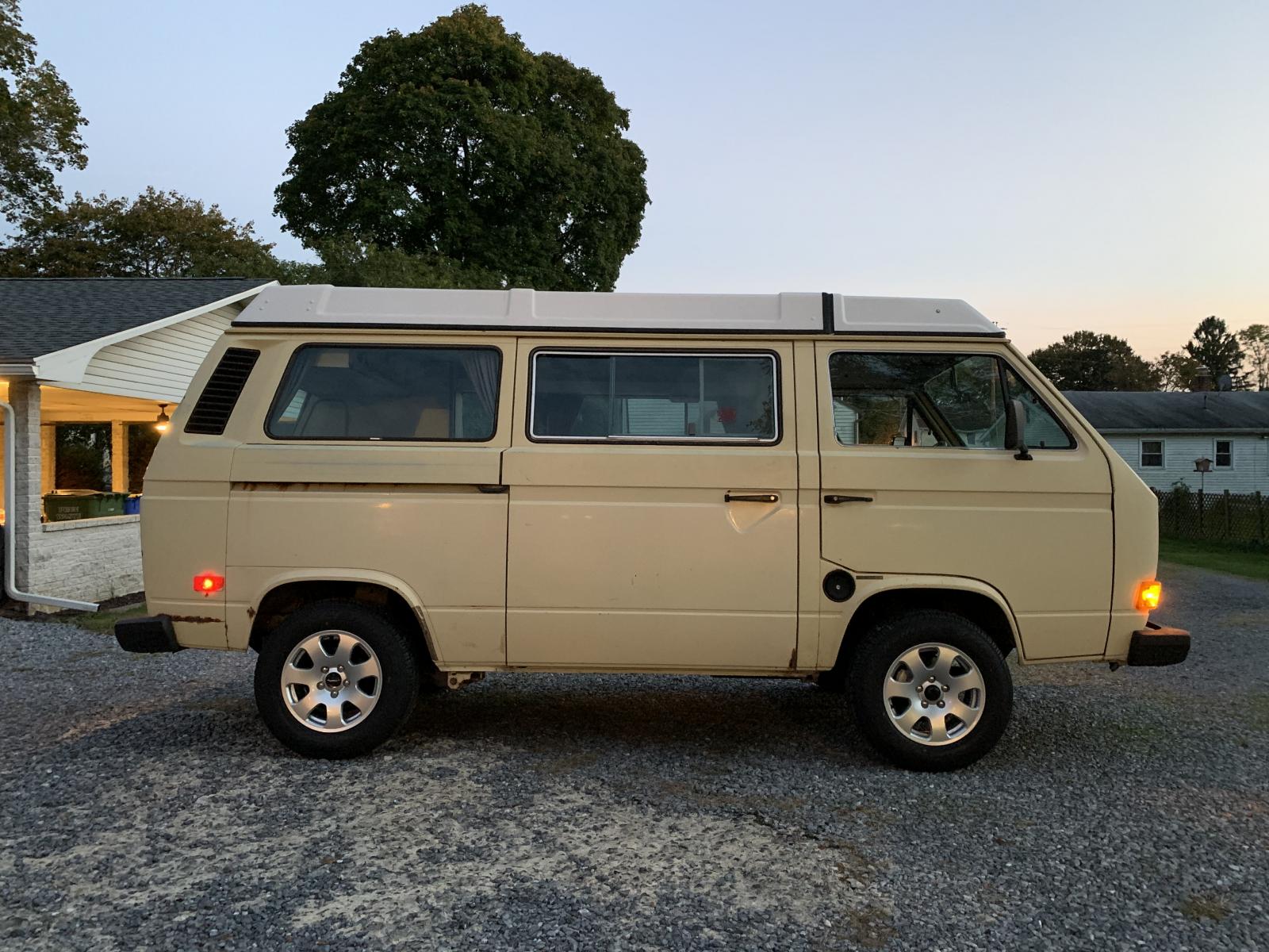

Here’s my long awaited wheel upgrade:
Mercedes wheels from a 2006 C 240
7x16 ET31
7mm spacers rear, none in front
60mm rear studs
Small ball seat lug bolts and nuts
Drilled out lug holes to 14mm
All hardware including drill bit provided and fit perfectly by Christopher at T3 technique, thanks Chris!
After much research and looking around for tires I ended up getting the Achilles Multivan 215 60 R16C’s, I feel like for the price this is one of the few C rated, 6 ply tires in this size made, only available online, so far the ride feels pretty great.

That looks really great! Nice job!

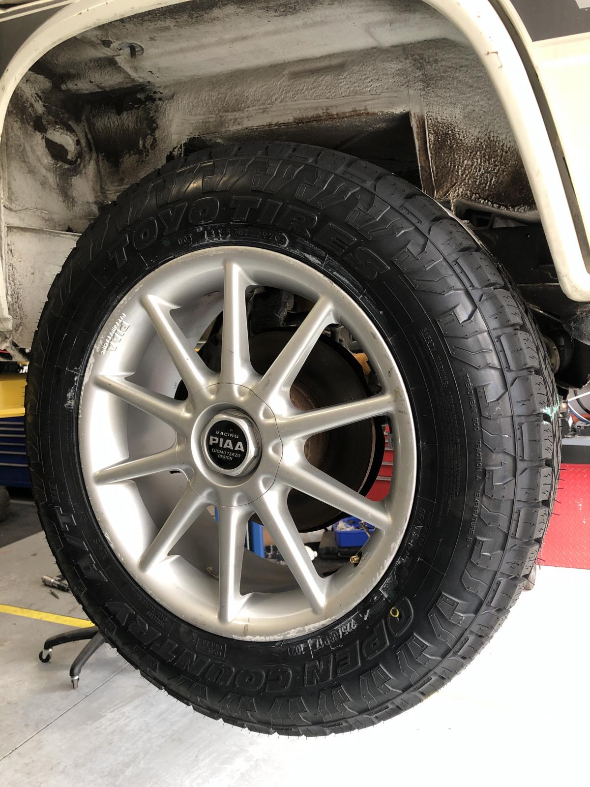

Pick up a set of mid 1990s PIAA 17x7 dual drilled bolt pattern wheels; they fit my Westfalia and Volvo 745T!😀

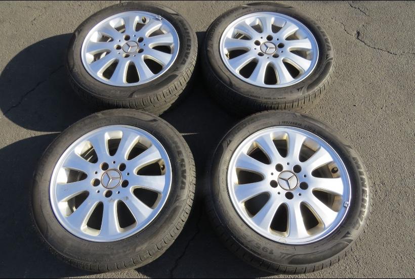

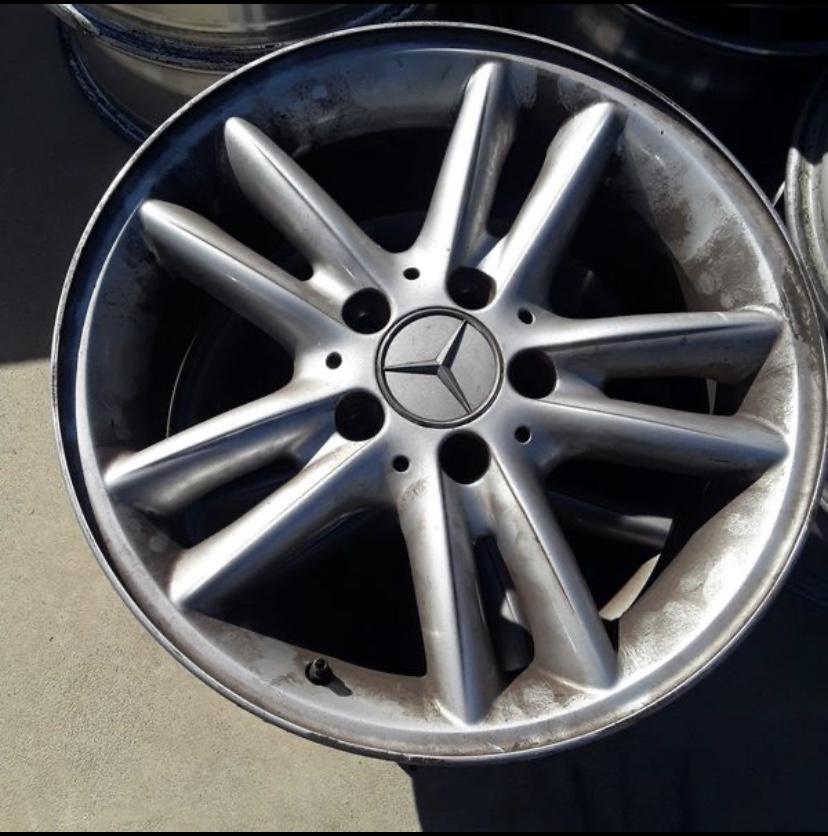

I haven't seen anyone post these. Do you think they would work?
They are from a 2003 C230 Kompressor Coupe. ET37 7Jx16H2

PostPosted: Fri Sep 11, 2020 4:27 pm    Post subject: Re: "What wheels fit?" The ultimate wheel post. Reply with quote
I think so with a 5mm front spacer and a 10 to15mm rear+ MB lug nuts and bolts possibly longer studs. Call Chris at T3, he will hook you up.

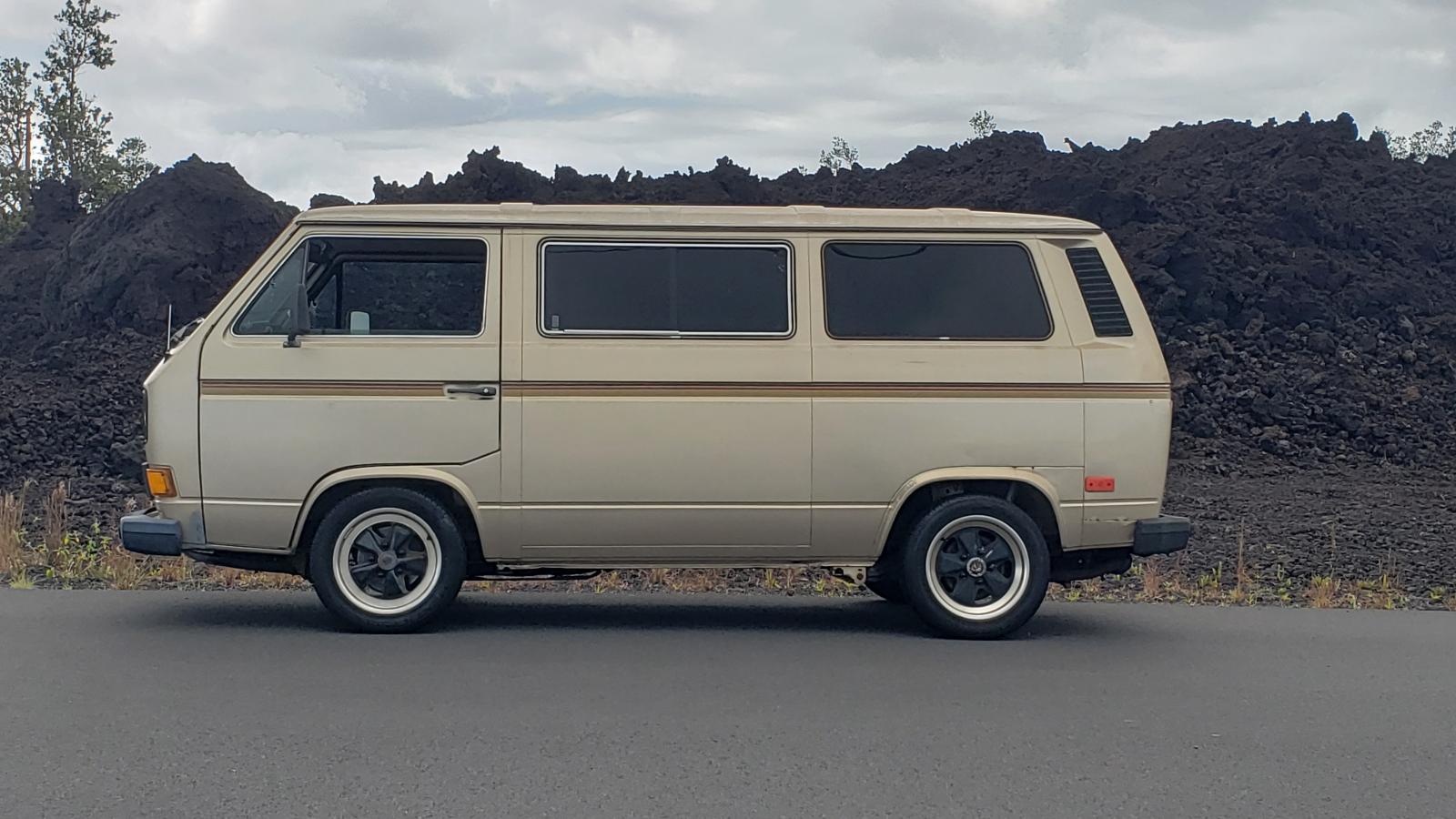

Thanks to T3 for your awesome adapters .
Aloha Ted

Welcome! I saw and got pix of lots of Vanagons when I visited the Big Island but not that one.

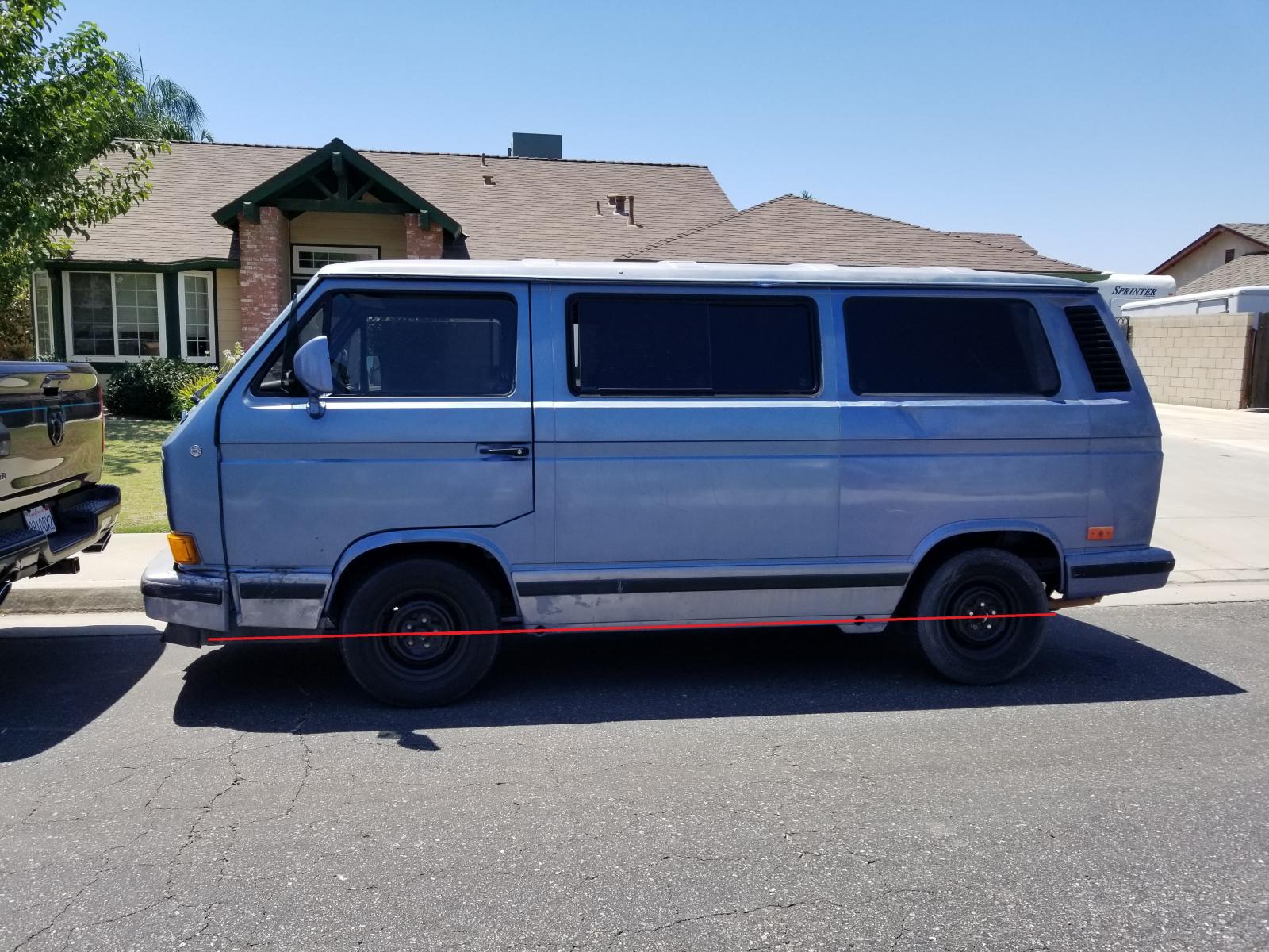

That's a sweet van. Those look like 15" Fuchs. I just sold a set of 16's, but I would have kept 15's Cool
It looks like you have 45mm drop springs. The Carat springs have the wheel centers aligned with the jack holes (see bottom ref pic)
