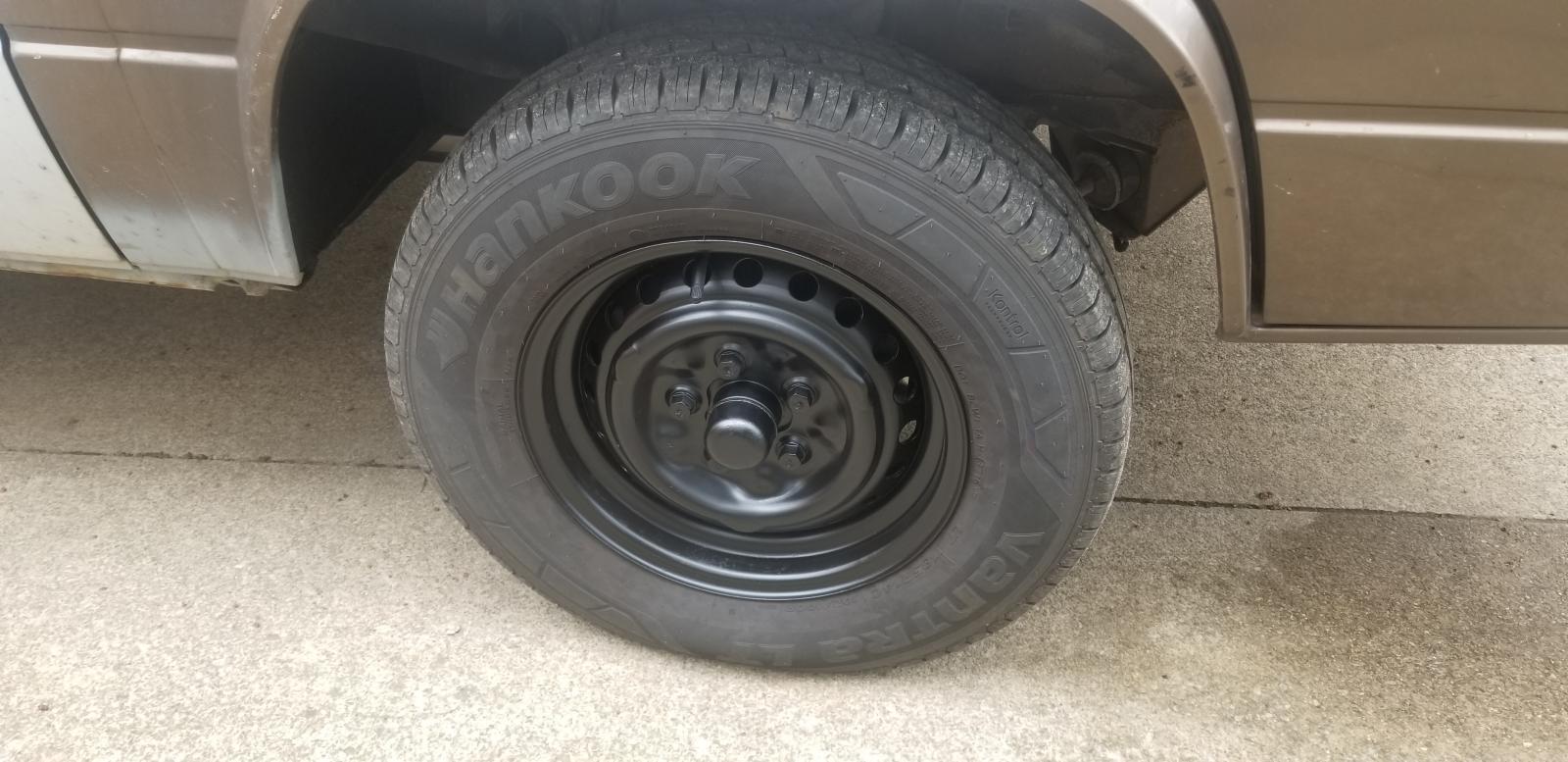

I just installed a set of Hankooks to replace my beloved BFG A/t. It’s a great tire for a Vanagon- stable, quiet, and ample load range. But, they are lame looking, and perform horribly in wet grass. Man I sure miss those 14” BFGs.
I would pay a ridiculous amount of money for a new set of BFG ATs, or better yet a set AT K02s.

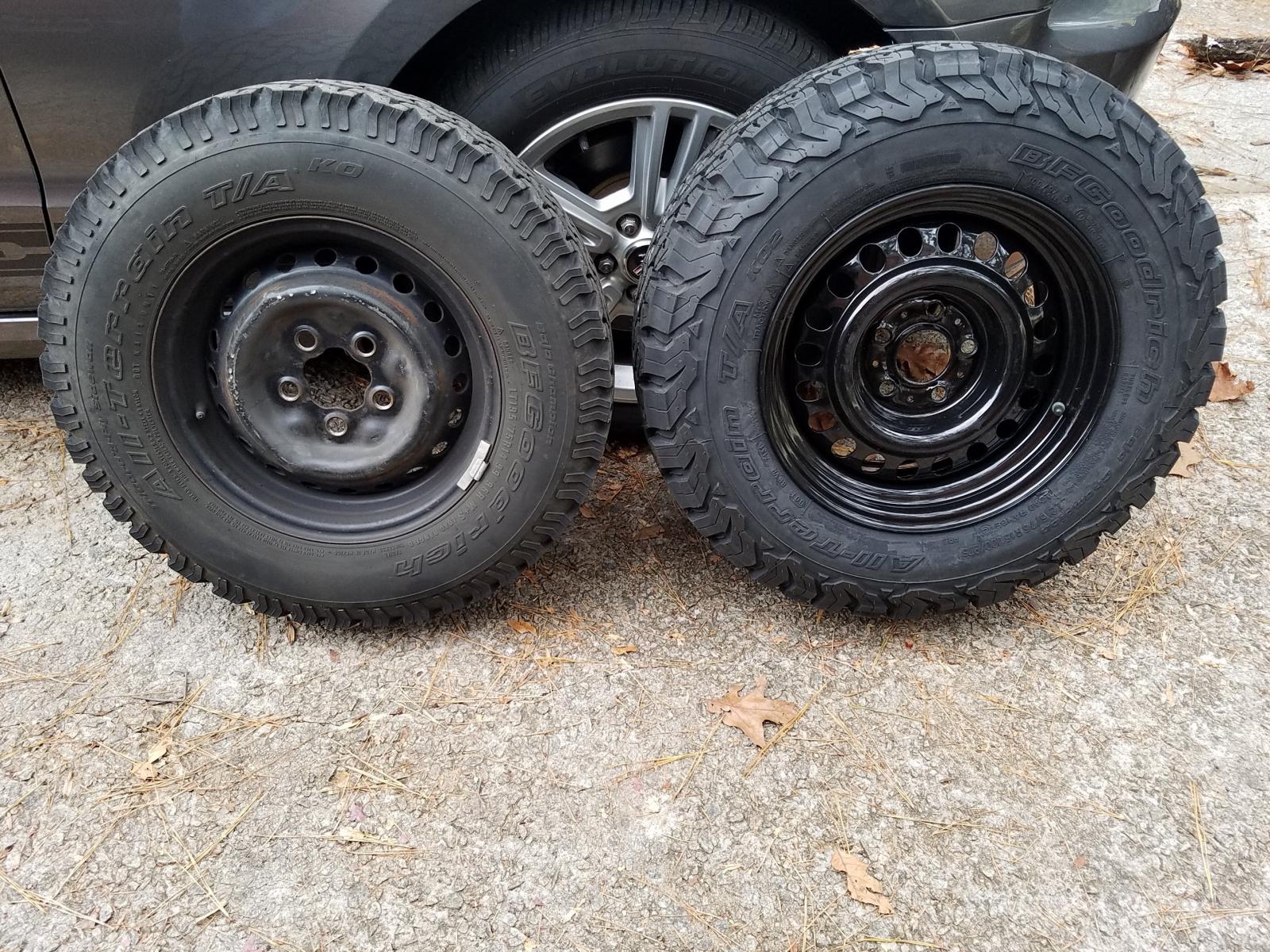

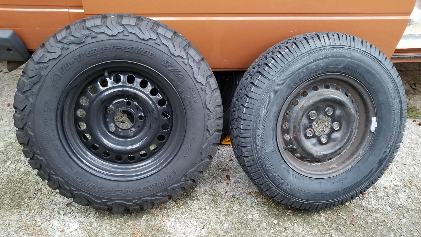

B.O.B.Wanders wrote:
I recently went to 15" rims and BFG KO2's but still wanted to keep a spare in the clamshell. I had done a gentle mod by removing the rod and adding a spacer in front to squeeze a 14" BFG in there. I wanted to see what I could do to narrow the size difference (25.5" KO to 27.9" KO2) but still use what I have without further modification or moving a spare to the rear ($$$).
I had put a set of the C-rated 27x8.5R14 Starfire SF510 LT's on my old Ford Ranger not long ago and thought with the slightly taller profile one of those might work out. Seems like a good solid tire.
So I put one on the old spare rim and it does just fit without rubbing the steering shaft etc.
I'm not getting into the load rating debate, but If I didn't have a full Westy, I would definitely consider the (Cooper) Starfires. The specs are identical to the General Grabber AT/X. If you are comfortable with the Grabbers for your van, you should consider these as an option as well. They are running around $100 apiece but I've seen them lower. [Caution: Cooper says 6"minimum rim width and OEM steel rims are 5.5". I'm OK with that - your mileage may vary]
The old BFG KO vs. KO2 for comparison
BFG KO2 vs Starfire SF510
On the van. Mounted to confirm fit and check the ride. I didn't notice any problem with tracking or issues with rubbing, although it is close to the UCA. I wouldn't want to leave it on for too long since there is still a noticeable size difference, but I'm comfortable with it for emergency use. I probably could've just gone with the old spare BFG and been fine for emergencies, but I really wanted to try this tire. (Yes, I'm carrying the OEM lug nuts and bolts)
Are those the South Africa 15 inch rims you used? Also, what size Bfg? I'm considering going 15 or 16 inch myself. Do you have them installed yet?

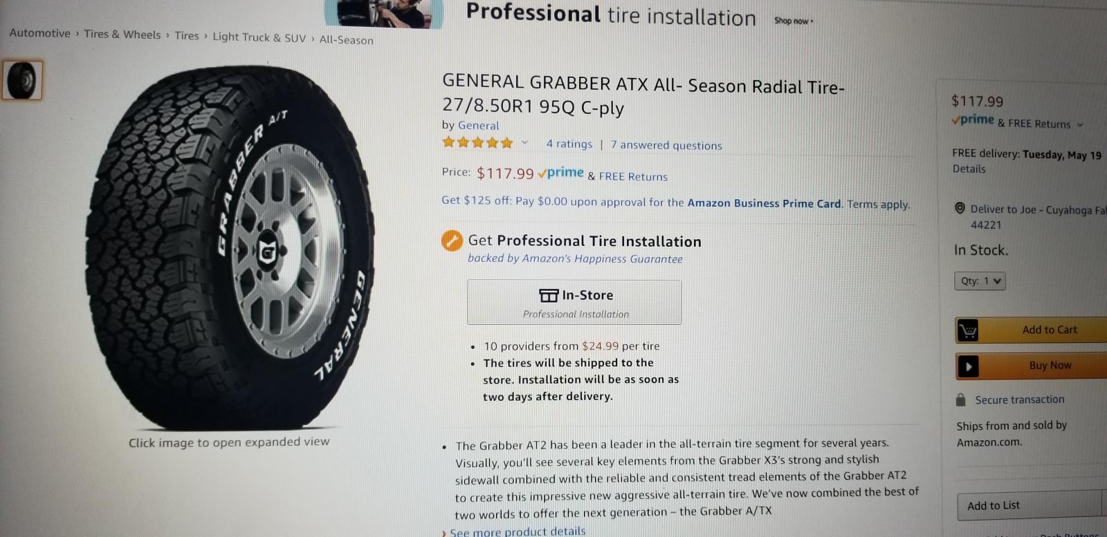

Are they making the General Grabber at2 anymore? Is that know the ATX ?
If I put the 14inch Grabbers on the Alloy rims will there be any rubbing?
Thanks

PostPosted: Mon May 11, 2020 5:23 am    Post subject: Re: 14" Tire Options Reply with quote
Anyone know if they changed the at2 to the ATX? Do they make the at2 anymore? Also will these rub on alloys. ?
Thanks

PostPosted: Mon May 11, 2020 5:33 am    Post subject: Re: 14" Tire Options Reply with quote
Yep, AT2 discontinued, replaced by similar ATX.
*** Note to Kamz: tire sticky/PDF needs updating on this point ***
Should be OK on the (slightly wider) alloys, although my experience is with AT2's on steelies.
- Dave

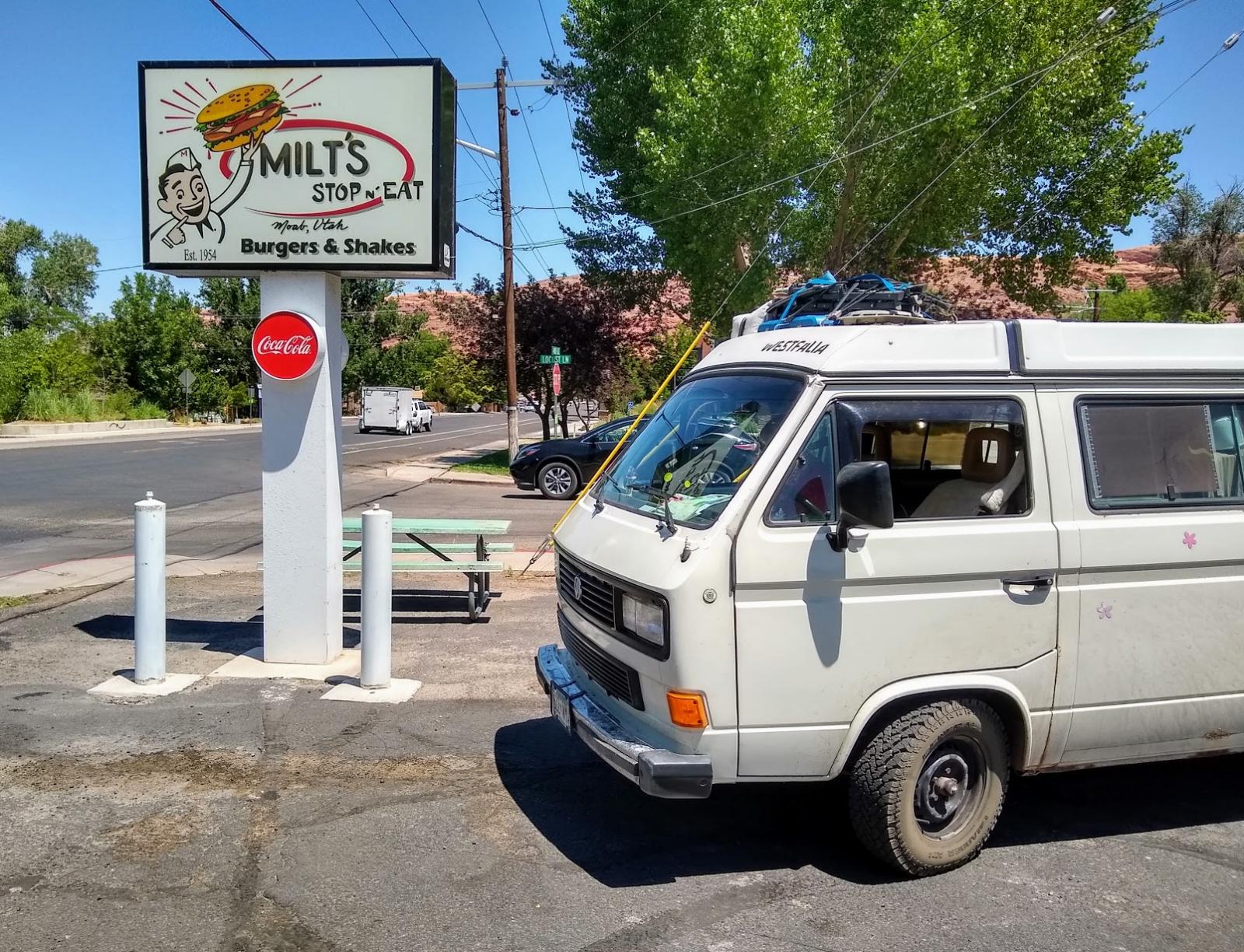

FWIW: I ran Hankook RA-08's for about 8 years (predecessor of the RA-18 Vantra)...which were affordable & sturdy,
great on the highway & fine on gravel, although worthless on snow, mud or even wet grass... Rolling Eyes Evil or Very Mad Sad
They also had a definite "pizza-cutter" look on the van; less than inspiring for appearance & "attitude"... Confused
I've since gone to General Grabber AT2's (now replaced by ATX) before my first Utah trip and have been very
impressed by the upgrade...very capable in all conditions, dry <or> wet rocks, snow, mud, etc... A definite
night and day difference, & I'll never go back to Hankooks...
Likewise, YMMV. So, where do you want to take your van...??? <shrug> Twisted Evil Twisted Evil Twisted Evil
- Dave
Thanks, Dave. Very helpful.
I will put most miles on the highway, getting to camping off road in dirt, mud, rocks, occasional snow and ice at times.
What size are yours? Larger or wider than the 185s? 195s, 205s? If so, did you notice much difference in handling in wind, cornering, diminished power up grades with the larger diameter tires?
Thank you.

The Grabber AT2's are 27x8.5R14 LT...quite a bit wider than 195's & about 10% taller than stock.
With a 95 load rating I'm not sure I'd run them on a "full kitchen" Westy camper, but even fully loaded
my Weekender runs about 800# lighter than a full Westy so I went with the recommendation and I've
been very happy with them. I definitely feel the difference in getting out on the highway but the rpm's
once up to speed put it right in the WBX sweet spot. Real hills/mountains are not much different than
stock, maybe just gotta downshift a little earlier & the WBX does the rest.
Yes, sidewalls are a bit softer than the Hankooks so they offer a bit of "give" but once they set in
on a corner they're like riding on rails the rest of the way. Long story short, I like 'em a lot... Cool
FWIW... (Sorry, not really an action shot, but you can see the tires & Milt's has a very good burger... Laughing )
- Dave
