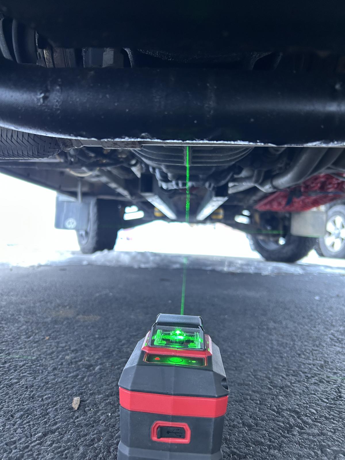

I want to keep this theme going instead of staring a new thread. But like 4gears here is my alignment since installing my 2.5 subie with kennedy carrier. Obviously needs to go towards pass side about 10mm. There is no adjustment in carrier bar or in engine mounts to slide the engine over. Any thoughts on how to get engine over? Would love to see some other alignment pics from other syncro owners with subie conversions. This misalignment would certainly explain my driveshaft vibrations, which led to my decoupler bearing failure after about 5,000 miles. Luckily it didnt crack the housing as we have seen in a recent thread

If you can rotate the front differential input flange so the bolt holes line up vertically, I think it gives a really easy indication of how far off it is. Is that 10mm though? Looks like ~5mm to me.
As for fixes, I can't imagine anything easy. Slotting the engine mount holes and possibly welding washers in a new location occurred to me.

Cant rotate it right now as the van is in snow. But just look at the center nut and its clearly off, it should run right thru the middle of that, 10 or 5mm will have to measure later when my fingies aren’t so cold, 10 degrees right now lol. Either way its off the mark

Yep for sure. The 2 nuts should be bang on even, can't have a one side lower situation here. Laughing

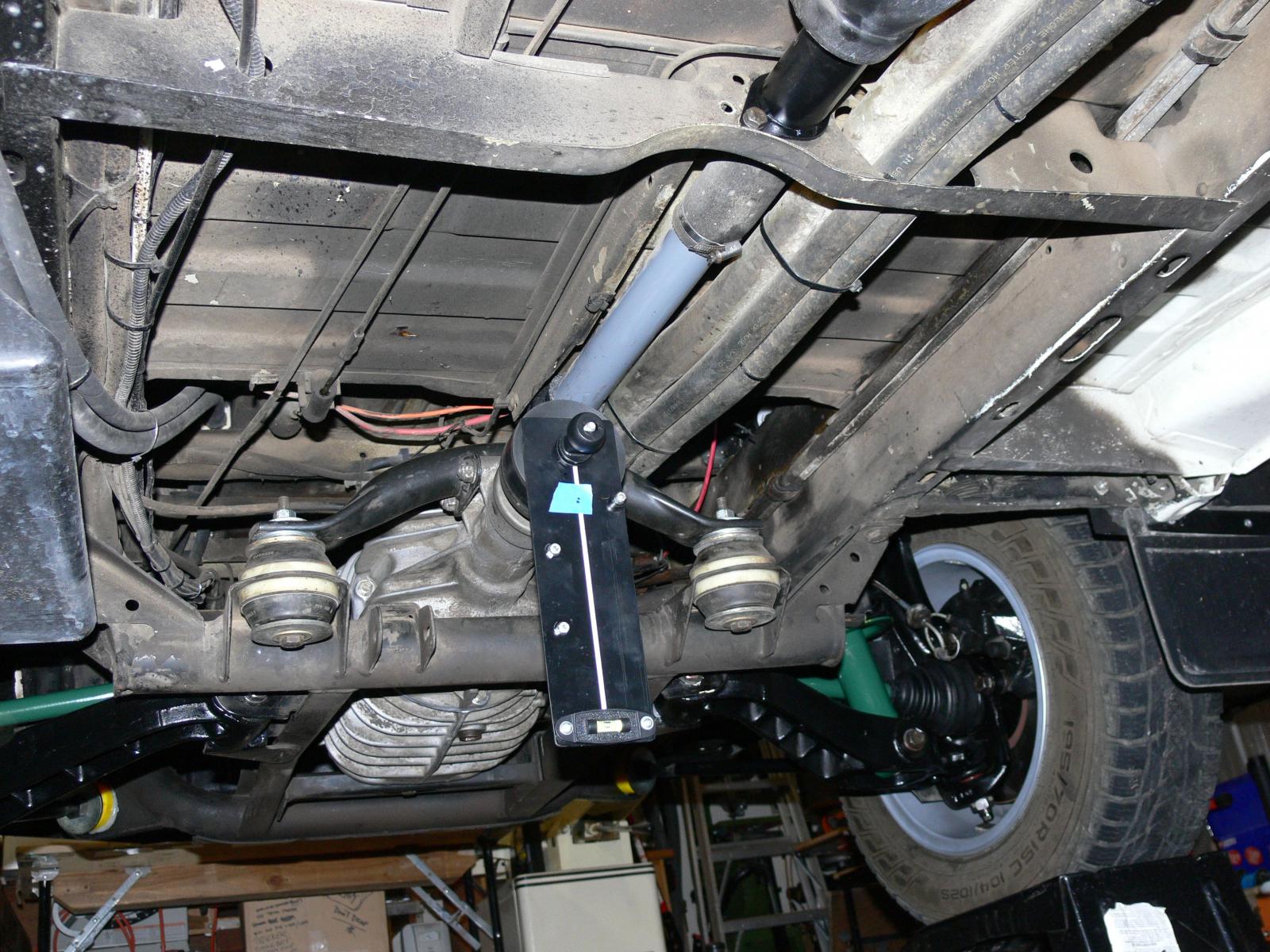

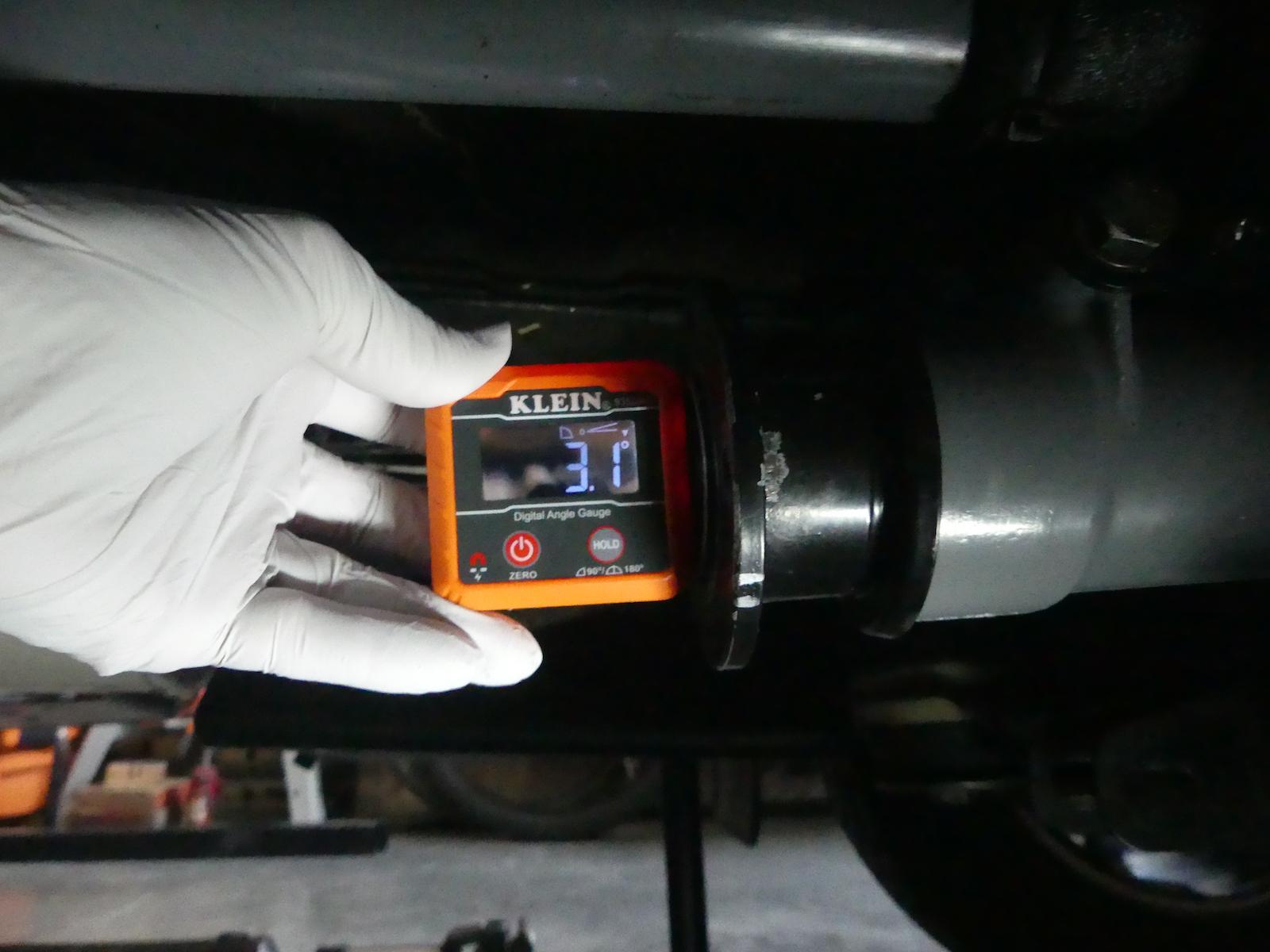

Hi Candyman (and sorry to 4Gears4Tires for thread drift) Doing a Bostig/Zetec conversion entails the same issues, getting the engine/transaxle in line with front diff.
Using the construction laser is great to check alignment of the transaxle to front diff but is just the starting point. Remember that it's not important for the transaxle/diff alignment to perfectly parallel to the body (the CV joints will soak up any small difference), just that they align with each other.
Once you get those two in line with each other you must get the driveshaft angles correct. That's the downward angle (or droop) of each, it should be about 4 degrees (what matters most is that both are the same).
You can use an angle finding gauge like this fairly cheap Klein:
Or better yet a custom shaft mounted laser like the old GW driveshaft alignment tool, more effort and money but superior, it checks both alignment and droop angles at the same time.
Important bit is the ball end of laser holder:
Picture shows approximate drop from horizontal, can be a bit more, should not be less.
Tool uses a laser in a flexible mount that when centered describes a dot instead of a circle on a marking card while rotating the flange. When laser describes just a dot while flange is rotating then it's perfectly inline with output shaft. Mark and repeat from both directions. When dots are on top of each other and on center line of marking card front and rear are aligned.
All checks should be done with the bus level side to side.
