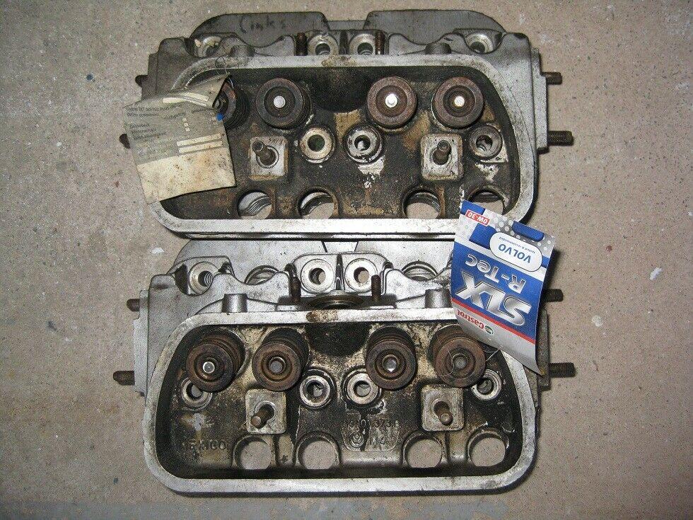

Terrific thread!
I was almost able to classify three types of cylinder heads I have here.
One pair has the cast number 113 101 373"B", which is very similar to the "good" 113 101 373 heads mentioned in the thread.
Does someone know the difference? Are they as good as the good heads?
See sample pictures
Tim

Posted: Thu Jan 02, 2020 2:22 pm Post subject: Re: Long Studs and Valve Adjustment, (Stud Kit?) |
The 113 101 373 are for '65 1200cc square boss single port and the 113 101 373 B are the later '66 1300cc single port. _________________ 1964 Sedan 6 volt |

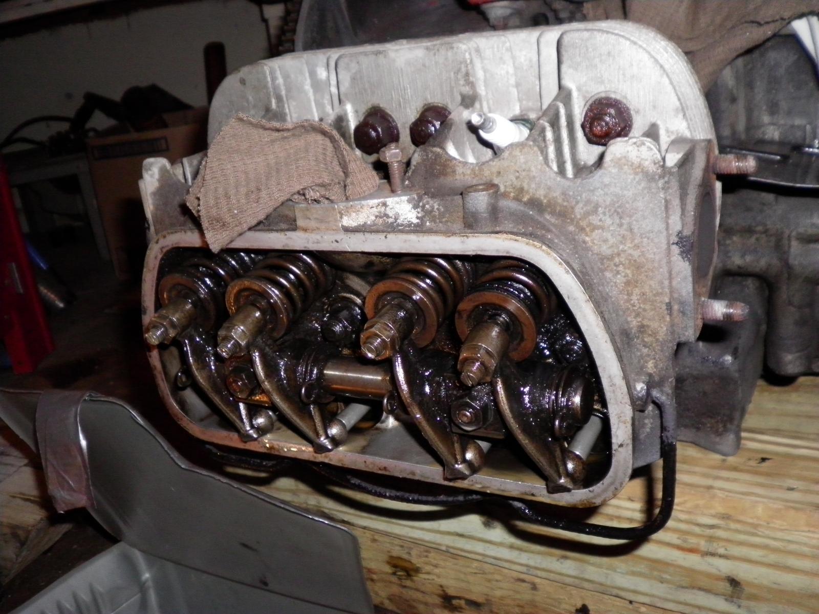

Just a quick question. I've removed my engine from my '62 bug. The numbers on it are close to a '62. I took it out mainly to put in a thermostat system(stale air) & crankshaft seal., but it has snowballed from there to numerous other stuff.
I'm probably the last one in the country with the original long stud system. Anyway I'm not reusing those heads but my question was about these rocker arms in the photo. Do you think they need cleaned ? Just kidding. These are from a 1500 automatic equipped engine and would anyone know what the ratio of these would be. engine # H5406978 which looks like 1968. I'm looking to install on 1965 square boss heads. Does anyone see where I shouldn't do this or is this a direct fit ?BTW top photo is the 1500 semi auto engine , bottom photo is current 1200 40hp. Thanks in advance
| Back to top |

| thomas. wrote: |
You're not alone....I'm still running long stud heads on my '65 (original engine). When it comes time to replace them, I've collected a couple of pairs of "F" heads which have short rocker studs and can use the original length case studs. If you use the newer '65 heads, you will need to locate a set of the longer case studs (someone please correct me if I'm using the wrong terminology here). _________________ '65 Sunroof Bug |

Posted: Wed Jan 08, 2020 6:58 am Post subject: Re: Long Studs and Valve Adjustment, (Stud Kit?) |
I'm using the top row cylinder head studs from the 1500 in the previous photo. I got the engine for free and using the parts. The 1500 studs are 8" long and 7.6" is needed. I've mocked it up and it looks to fit with some extra washers. Either that or I might cut it shorter.

| thomas. wrote: |
| my question was about these rocker arms in the photo. These are from a 1500 automatic equipped engine and would anyone know what the ratio of these would be. |
If stock, they should be 1.1:1 ratio rockers. The easy way to tell the difference between the earlier 1:1 rockers and the later 1.1:1 rockers is the later variety has two cast-in lines as seen in the picture below; previous rockers lacked these lines.

Posted: Wed Jan 08, 2020 11:40 am Post subject: Re: Long Studs and Valve Adjustment, (Stud Kit?) |
Thanks for that Mukluk. That's what I wanted to hear. After checking for those marks that's what they are. It only took half a week to clean them.

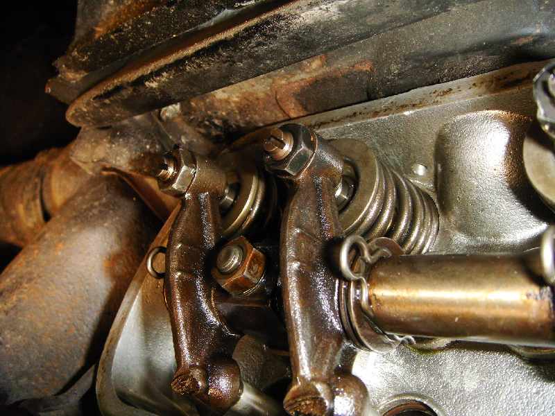

| glutamodo wrote: |
Okay, here's the story on the 40HP heads. For whatever reason, when VW redesigned their engine in 1960, they decided to redo the heads so that the studs passed through the rocker "chamber" pass under the fins on the underside of the head, and screw into threads tapped just behind the combustion chamber. Not a good idea. The heat stress, added to the constant stress/vibration of the valvetrain, caused many of these to fail - the studs would snap off, or would pull out of their threads. VW monkeyed with this layout from 1961 models to the 1964s. They changed the size of the threads in the head and the shape of that rocker shaft, but the problems continued. Also, the heating differences of this style required that huge valve adjustment, as the clearances usually decreased from a cold engine to a hot one. Depending on what VW literature you read, they were either .008/.012 cold or .008/.008 cold.
Now, the earlier style 36HP heads, the rockers bolted onto studs that were screwed right into the rocker chamber. These didn't have that problem with breaking studs, or with wildly changing valve clearances, that were set to .006/.006. So when VW engines started having problems with the long studs, VW issued orders to retrofit them to the short studs. There were several companies that produced kits to do this. The most common one was one that drilled a large hole where the rocker fit, then a large slotted insert was screwed into the rocker chamber. The rockers were now secured with BOLTS, these are amercian bolts too, by the way, they have 1/2 inch head on them (although a 13mm fits OK) So if your engine has BOLTS holding down your rocker arms, you are converted to "short studs", and can set your valves to .006.
The other style fixit kits out required you drill out the rocker stud holes, then tap them for a giant "step stud" - these were metric kits, at least any that I've seen were, and have a M8x1.25 nut that holds the rockers on. The only way to tell for sure whether you have long studs or not on engines that have STUDS holding the rockers down is to look under the engine for where the rocker stud hold emerges on the under/backside of the head. If it ends there, short studs - .006 valve adjust. If it continues over to the combustion chambers side of the head - long studs.
In 1965, VW finally decided to fix all the problems with the 40HP heads , and designed a very strong, beefy head that is much like the 1300-1600 single port head. These have a square shaped embossment under where the rockers bolt to the head. I have these heads on the 1385cc 40HP in my 62 bug, and they are great! (but since they are beefier heads, they require longer upper studs than the other 40HP heads used) Now, after 1965, VW put out a "universal" replacement head that would fit the 1961-1964 engines, that looked more like the earlier heads, including a rounded emobssment under where the rockers bolt to the head, but had short studs. These usually have a casting part number that ends in "F".
As far as your engine in particular - your 1965 has the Long Studs? Well, there's very few VW's with their original engines out there anymore anyway. Most of the old "long stud" heads have been converted years ago, not many of the old ones remain. What I'd do, if you truly do have long studs, is do this test. Set your valves to .008/.008, COLD, of course. Then run the engine around for a while til it's nice and hot. Then come home and put on some cloth or leather gloves and a heavy long sleeve shirt to protect you from heat, and pop those valve covers off. Then check your valves and see how tight the clearances have become. IF they are are all about the same, and none are on zero clearance, then go with the 008/008 setting. If the exhausts are down around or past the zero clearance, go to .010, or .012.
As far as getting the kits installed - it's best to have the heads off the engine. Also, I don't think you can BUY the kits any more, although I have a couple of the US style ones laying around, enough to do like 4 or 5 heads I think. However, they require special size drill and tap to put in, and not many people have them around any more. I know I don't have the tools, although I do know of a retired machinist that has the tools for the kits I have.
-Andy

ONE other style!
I have talked more about the different short stud repair kit styles in other threads in the past. I guess I never put any images into this thread before though.
Note, the .004" valve adjustment, which was what VW wanted before their retconned .006" short-stud revision around the start of model year 1972.
