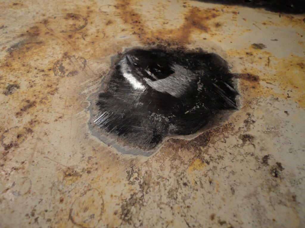

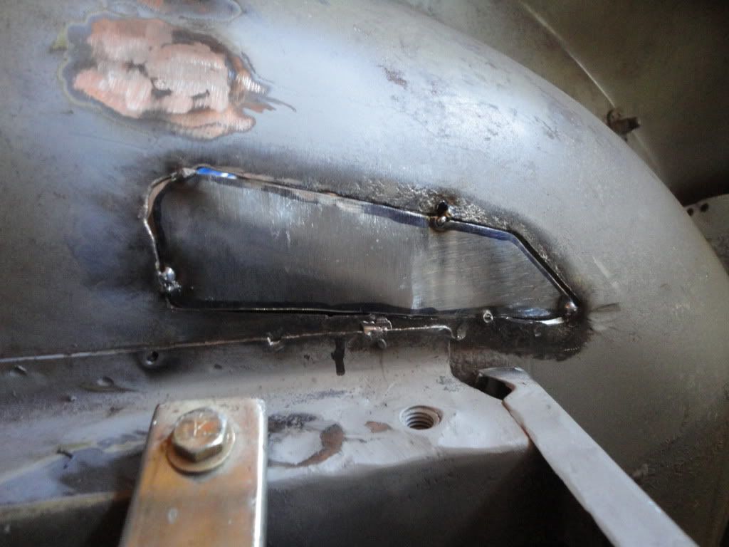

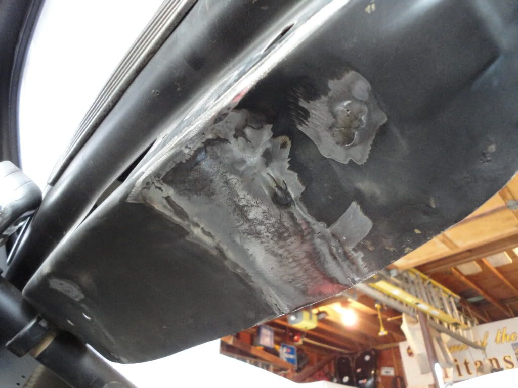

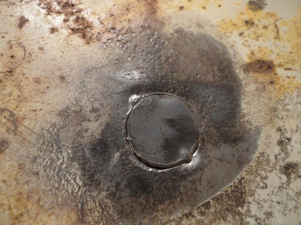

Made patch pieces for the holes. Tacked them completely in until I got the hole seam covered.
I then ground the welds down until it was smooth.

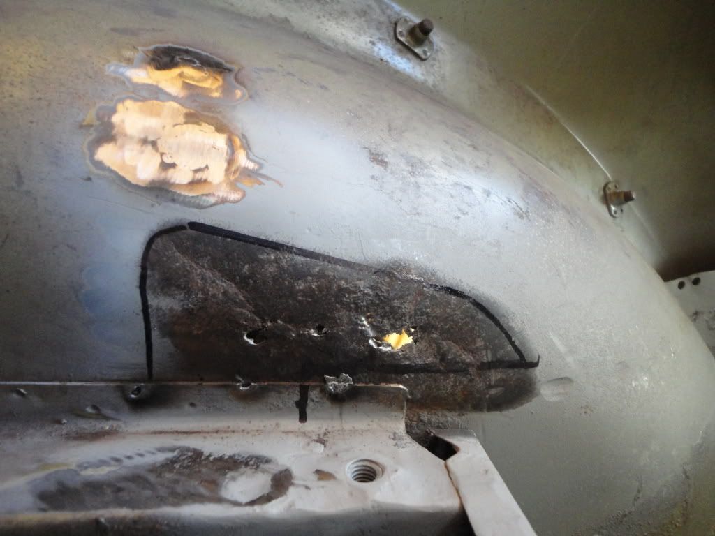

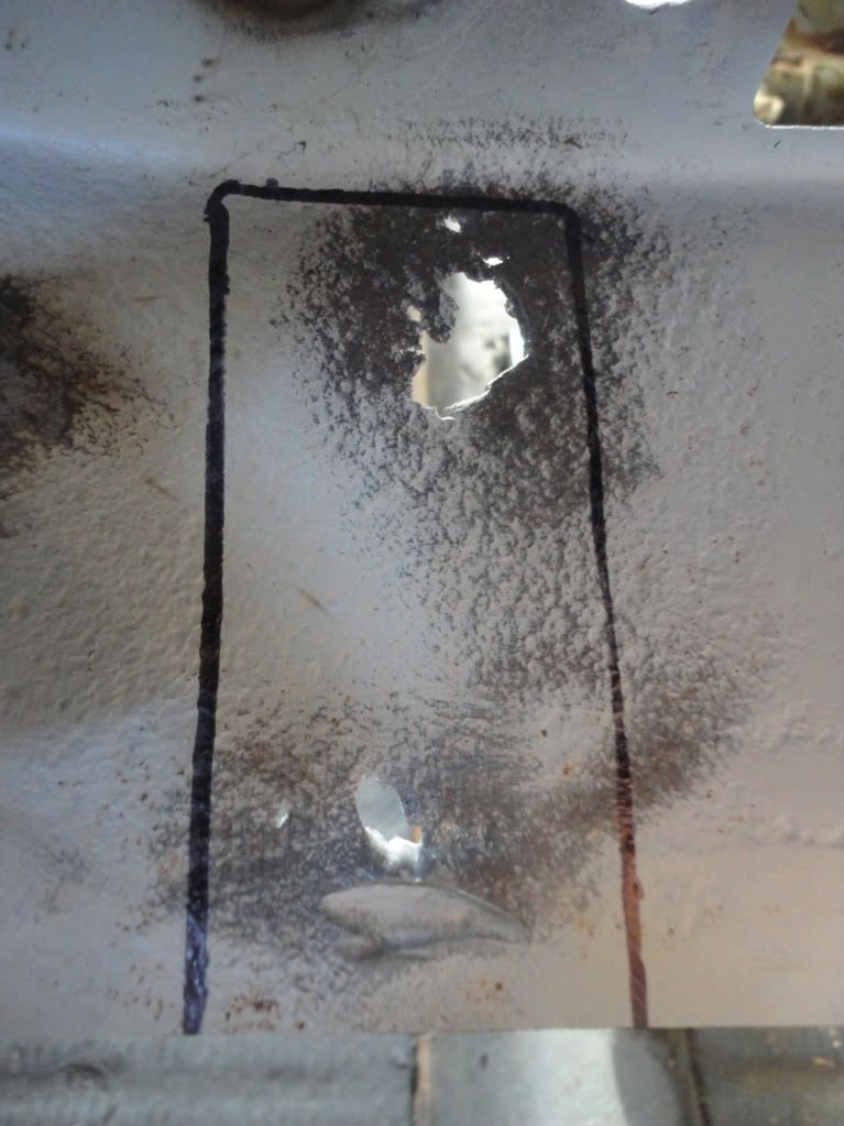

Cut this piece out too. This part is partially under the radio.
A little filler and you'll never know
This has to go too.
Tacked in and ready to go.

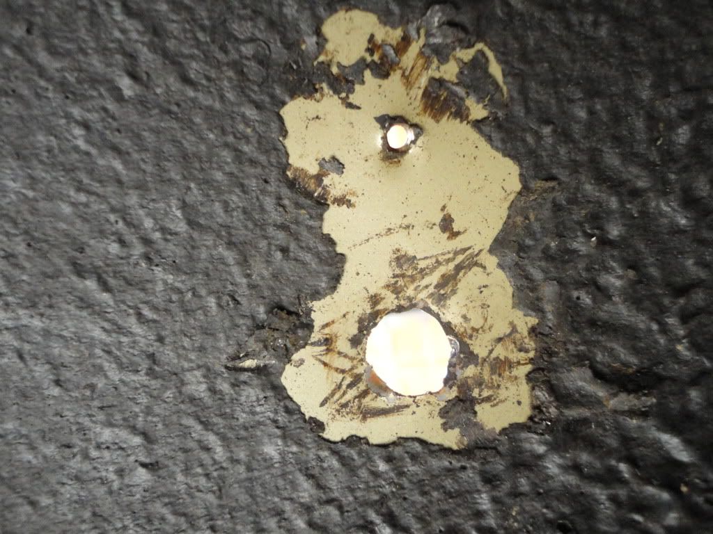

Clean OG paint under the layer of undercoating Very Happy

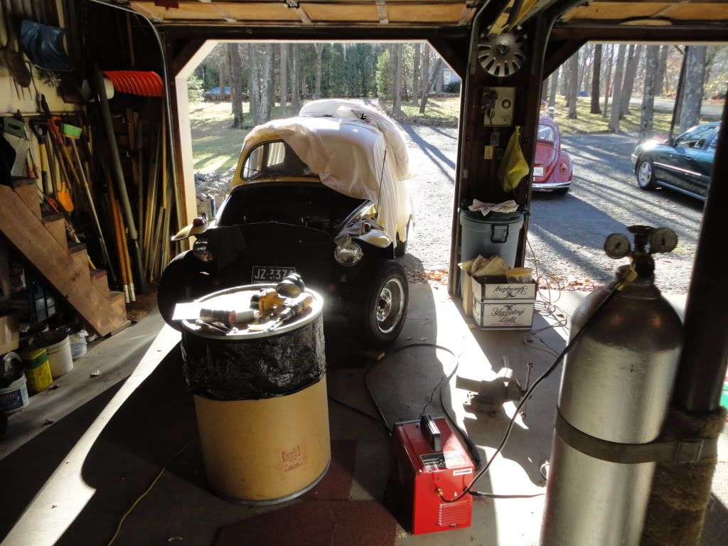

Garage shot

think you could use a bigger gas bottle
My friend is a nitrous distributor and that was an empty bottle he had kicking around that he uses to fill customers small bottles. Surprisingly this was only $20 more to fill than one of those small 3ft bottles, so it seemed worth it.

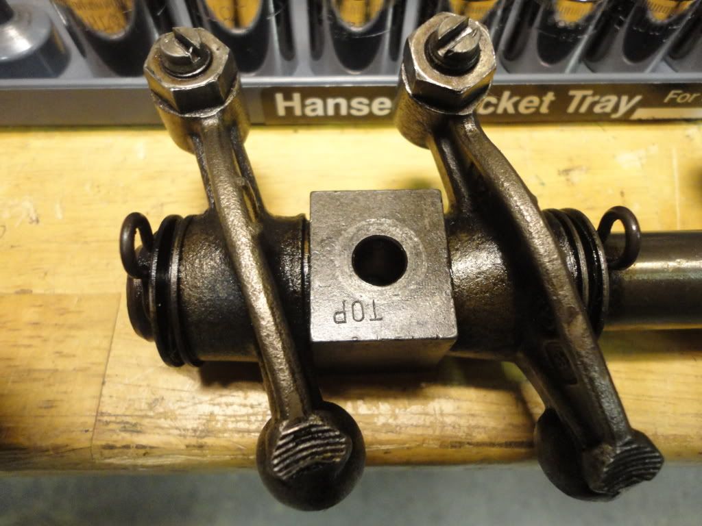

How worried should I be that the "top" is on the bottom? This must have been like this for the life of the time my father owned it. Would it as simple as un-clipping the rockers and flipping them?

Yep Un-clip and flip, Good to see an update.
