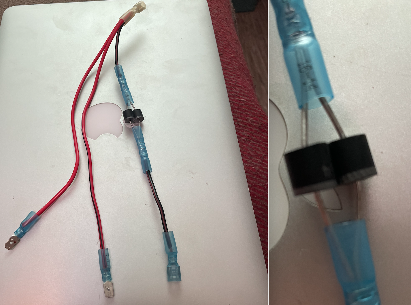

I just fabbed up one of these for use on two no-start 2.1 waterboxers. Maybe you guys can point me in the right direction about my results.
(1) 1st van is being weird. Fuel pump gets no power without the tool installed.
With the tool installed the fuel pump buzzes really loudly. With the inline fuse removed the fuel pump buzzes less loudly, but still louder than one hears in a normal van for a few seconds when turning the key to the on position. To reiterate: even when i disconnect the tool from the batter, leaving it connected to the 87 ports where the relays were, the fuel pump still buzzes loudly.
It's also getting only 7V at the starter.
(2) 2nd van belongs to my kid & has been the bane of my existence for 1.5 years. I spend a month on it last summer, a couple weeks this past spring, then finally surrendered & took it to a well reputed VW mechanic who conducted all the same tests I had already tried last summer before he too gave up and charged me 1k to hand backs keys to a non-running van.
I was very hopeful the tool would help me figure this out. Still won't start. Van gets spark and has 32psi on the fuel tee. It just turns over & over but will not start. Maybe someone can help me remember what possibilities this leaves.

PostPosted: Thu Jul 06, 2023 4:30 pm    Post subject: Re: dead van diagnostic tools, wiring bypass Reply with quote
The purpose of the diodes is to prevent the power from backfeeding from the coil connection to the relay sockets.
If you leave out the diodes or install them backwards the 1 coil connection wire can also power the 2 relay wires and that is a bad thing.
Also if the diodes are installed backwards then the coil connection is invalid from the battery connection and that is a primary test function of the tool.
Mark
It's also getting only 7V at the starter.....
Mark
Believe it or not that did occur to me but I had faith in my brother who is a physics professor in germany, I built it while I was facetiming with him and i briefly showed him the diode and quickly asked which end was which and HE steered me wrong. I should have known, as he also failed to rig my vintage 1979 Mattel Vertibird to run on AC instead of C batteries Brick wall
I suppose I should ask if anyone knows off the top of his head what damage I should look for from my latest circus clown blunder.

PostPosted: Thu Jul 06, 2023 6:53 pm    Post subject: Re: dead van diagnostic tools, wiring bypass Reply with quote
They seem to be correctly oriented unless I'm missing something. Which I suppose would actually be bad news in the grander scheme of things
EDIT well I tested the diodes and they are indeed working as as a one-way voltage path, in the correct orientation. then I discovered the fuel pump gets power from merely jumpering the two female position 87 slots together. it would be nice if the other van worked so I could check to see if that’s normal
