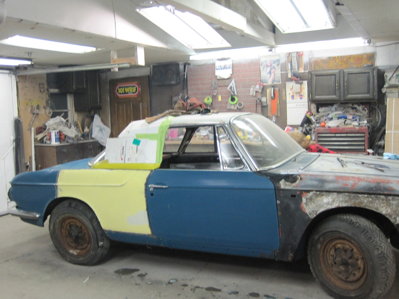

I had some free time sunday afternoon (after cutting the grass), and really got to looking at the dent from all sides. I found that part of it was held in place because of the amount of force of the impact caused it to go into the inner fender well (at the front of it). Since you can't just unbolt the fender (like a regular t-3) I had to cut out the "crash" damage to see more of the impact. Here's a couple of shots of what I mean. That wrinkle in the back isn't supposed to be there in the 1st pic. Nor are the others in the front of that view.
I also straightened part of it in the 2nd shot above, so it will help with getting the new inner portion to fit better.
This one is of the outer door jam. Notice that it's also pushed back. That was also working against me. I ended up pushing it forward a few mm's, mostly in the center.
Here's a couple after I got most of it welded back on. I still have to grind it down, and finish welding, but it's pretty close now. It was pretty easy to install that section, and I also see why Russ picked it up now, as it fixed a lot of the problems in that area. Sue came out and started playing again as well. Wink
She felt that "Wolfie" needed a "bath", granted it was more of a sponge bath, but it did get most of the "industrial" dirt and grime off.
It's looking much better now, and pretty soon I'll go back to working on the front clip section. I've just gotta finish this part up first, then seal it in DP (probably in the next couple of days).

Well, I got to do a little more to it over the last couple of days. Last night I got the rest of the welding pretty much done on theat side (looks like I need to work on the tail light edge now). I had most of the rear fender sanded back down to bare metal. Tonite, I finished sanding the rear fender, popped the metal around both tailights (along with removing some more of Russ's HF moving pad). While I was doing that, Sue finished the the right front fender, and got 1/2 of the hood sanded. Here's some pics.
Chris (my daughter) said you almost can't tell the rear fender was worked on, other than part of the weld seam (at a dent). Sue and I laughed at that one, but then I did fit it so I wouldn't have to use a lot of filler (the previous body guy used more than enough in the front clip). And since we're supposed to get some rain, I figured I'd seal all the bare metal up, so I epoxy primed it (used PPG's DP series). Here are those shots.
It's looking better already. Now IF I can get the front (both sides and the middle) close to that, I'll be in good shape. Cool These car definitely have some cool body lines.
