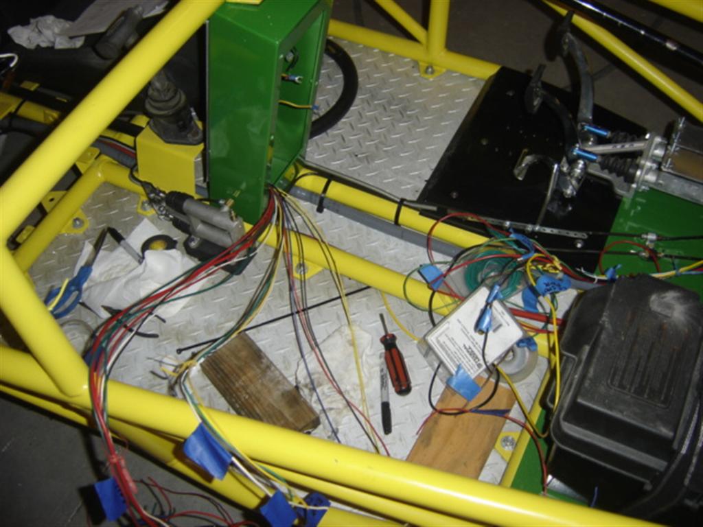

Last couple of weeks, I've been able to devote most of my time to tying up loose ends and finally got ready to get back to my streeter project.
This week, finish brake and clutch hydraulics, cutting brake install, finish console and relay box, rough in all the wiring.

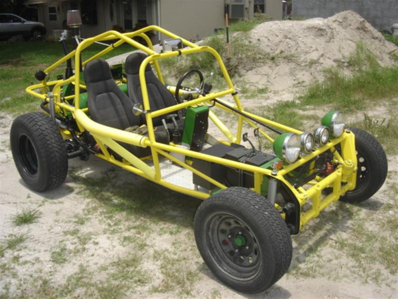

OK, As promised. Here are the" 'Deere Wagon" family album pic's
Most of the NQR sorted out, 200 miles on the clock. A couple of oil leak's and shitty street manners still to be delt with yet, but, up and runnin'.
What I started with...
It only took a year and 2 weeks, 8 months wasted, workin' a day job, LOL
