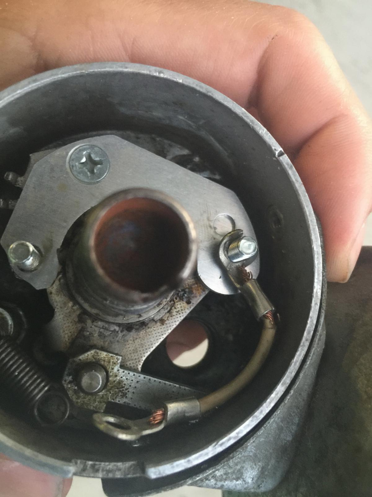

PostPosted: Tue May 17, 2016 7:51 pm    Post subject: Reply with quote
mattlockwood wrote:
Thanks for the motivation to rebuild! Here's mine. No before and afters, just after Very Happy
in the photo, it looks like the ground strap is touching the vacuum can arm, but it's not. Points wire isn't touching the distrib case either. iPhone photos....

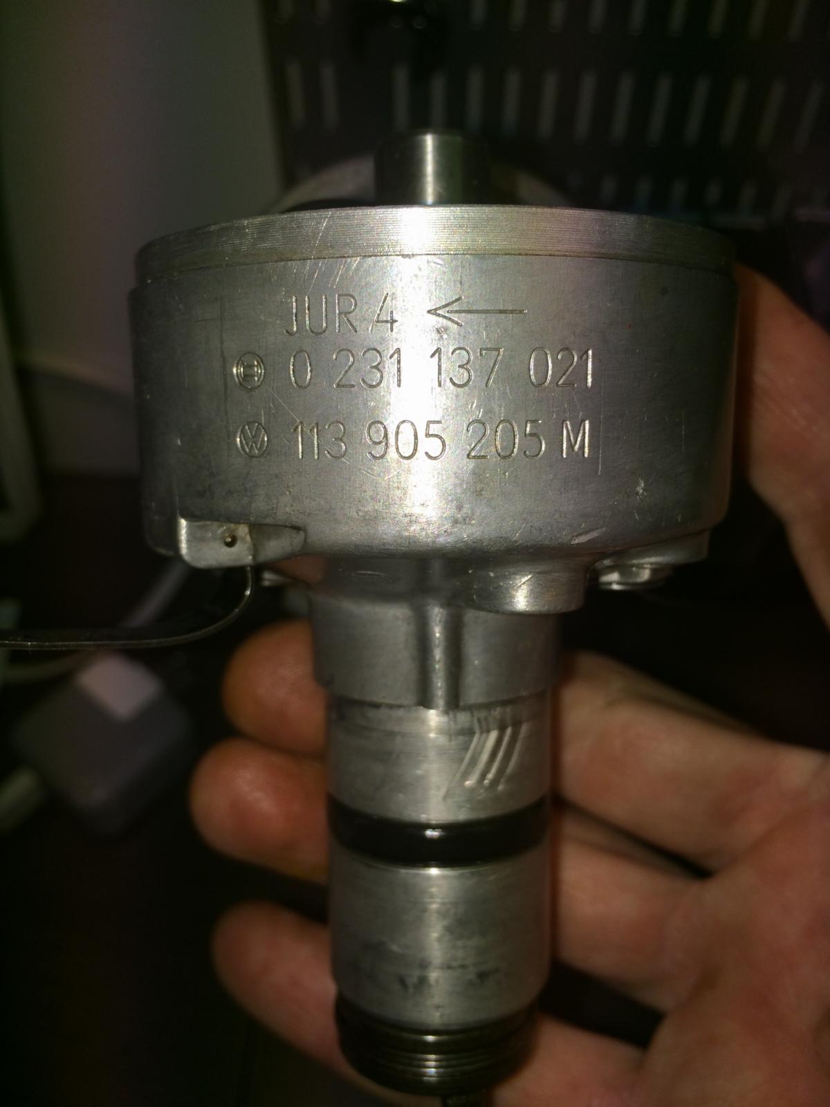

I have a 113905205t marked distributor that looks exactly like this 205M when looking at the inside of it. Was wondering if I should get caps and rotors for an M or T?? Wonder if someone changed the internals or something on it?
Glenn Premium Member
Mr. 010
Joined: December 25, 2001
Posts: 80311
Glenn is offline
PostPosted: Tue May 17, 2016 8:02 pm    Post subject: Re: Distributor 113905205T rebuild *PIC Heavy* Reply with quote
Looks that way.

PostPosted: Tue May 17, 2016 9:04 pm    Post subject: Re: Distributor 113905205T rebuild *PIC Heavy* Reply with quote
The 205M is just like the very common 205K distributor. It uses different parts than the "T". For one, the cap is shorter than the "T". They do look similar inside.

PostPosted: Wed May 18, 2016 12:00 am    Post subject: Re: Distributor 113905205T rebuild *PIC Heavy* Reply with quote
VW uses the M and T interchangeably in application in every text I have ever read. They do use different tune-up parts. T's are more similar to the 009/SVDA style caps and rotors. Allegedly, the M uses the shorter "earlier" style parts, but I have not verified this in person.
The M is listed as having the same parts as the K, but note that the K is timed differently, and utilizes a different vacuum signal. T and M utilize the same vacuum signal.

PostPosted: Wed May 18, 2016 1:44 pm    Post subject: Re: Distributor 113905205T rebuild *PIC Heavy* Reply with quote
Both the 113 M and T distributors use the updated points plate that has a hole for the points to sit in instead of a brass post. They may appear to be the same but, the 113 905 205 M has a shorter and narrower shaft at the rotor end and thus requires a shorter cap and rotor.
The 113 905 205 T has a taller wider shaft at the rotor end requiring a cap and rotor identical to the ones used on the 009 and other later distributors.
The difference isn't readily apparent until you line the two up next to each other.
The difference in the rotor shaft is the reason they have different part numbers.
rotor shaft diameter:
113 905 205 M 12 mm true also for 111 series distributors
113 905 205 T 14 mm true also for 009 and all later distributors
The shaft diameter where it enters the distributor housing is the same on all aluminum boded distributors essentially the K,M,T are interchangeable and often are Sad
The 113 M and T have the same timing specs because the vacuum canister are identical.
In addition to a different vacuum canister the 113 905 205 K distributor has a different return spring than the 113 M or T. So you could install a shaft from a 113 T into a 113 K distributor and retain all other 113 K parts. You could assemble a 113 905 205 K with the later tall cap and rotor. When assembling the points plate sits underneath the points cam/rotor post.

PostPosted: Fri Jun 10, 2016 7:30 am    Post subject: Re: Distributor 113905205T rebuild *PIC Heavy* Reply with quote
So i finally got the right electric ignition and am wondering if the grounding wire has to be soldered or screwed into the actual breaker plate or if i can do this:
a nut goes over that thread for the electric points. You guys think that would work?
