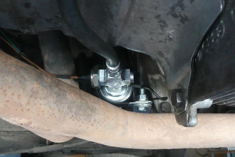

PostPosted: Tue Apr 12, 2022 4:44 pm    Post subject: Re: Any experience with GlowShift Oil Filter Sandwich Adapter? Reply with quote
Tried the Glow Shift on top of my stock oil cooler and had leaks and no clearance for oil filter.
I think the leaks are caused by the use of a gasket on my example, instead of an o-ring, being only .040" thick (about 1mm for those still using the metric system). A credit card is about .035" thick. That would probably be no problem on a cast aluminum or iron machined surface, but with the stamped sheet metal surface of the stock oil cooler, it is a hit or miss proposition.
Going to try an O ring instead of the funky gasket that came with my adapter.
As for the clearance issue, I think my van has an aftermarket stainless steel exhaust which leaves no room for the oil filter. I was able to machine about .35" off the adapter, some off the hex nut and some off the threaded pipe that the oil filter screws onto, and now I can just get the filter on and off without using any French.

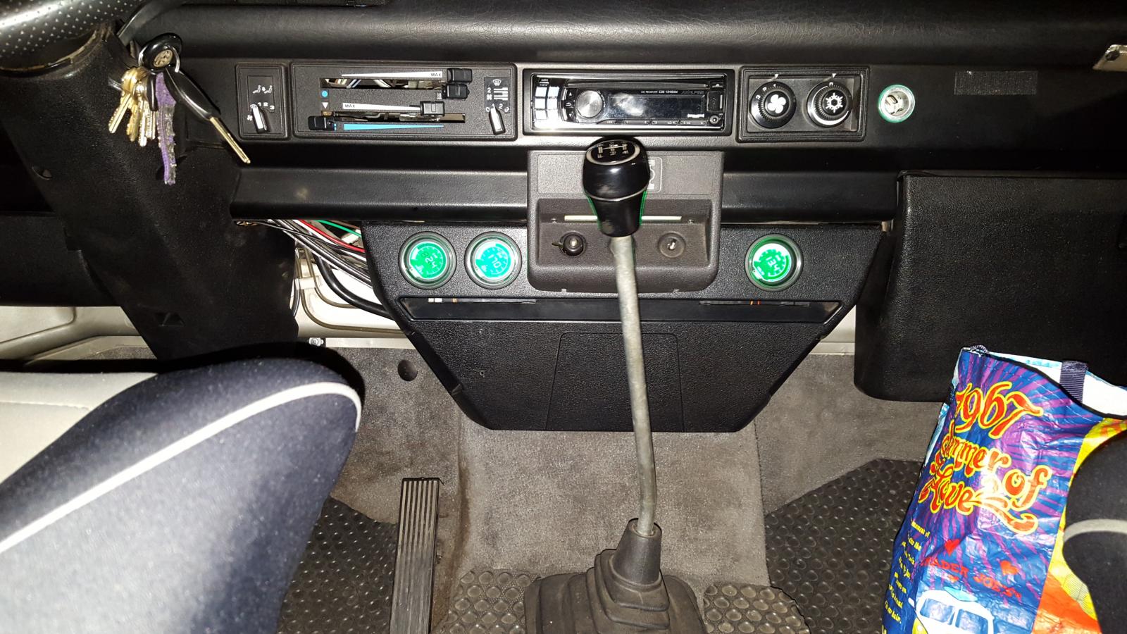

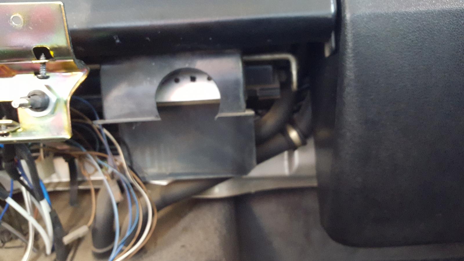

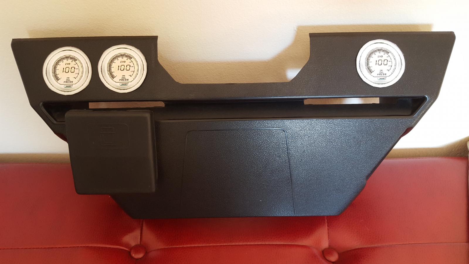

Syncronoid wrote:
Here's a mock up of my planned gauge install. It is to scale. Oil pressure and oil temp to the left, battery voltage to the right utilizing Prosport's 52mm EVO Green/White gauges. I thought the Green/White would blend in well with the greenish lights on the diff panel.
http://prosportgauges.com/evo-electrical-Digital-Green-White-Oil-Pressure-gauge-.aspx
While attractive, I think you will find ventilation ducts behind the panel will not accommodate this placement of your gauges.

Red Ryder, Here's my build thread, you can read about the minor trimming I had to do which resulted in no real impact to air flow. I wanted it clean, with no extraneous gauges on top of the dash, so that's why I went this route.https://www.thesamba.com/vw/forum/viewtopic.php?t=642686
Turned out nice I think....

Got some O-rings from Amazon that seem to work well. The size I got fit into the inner grove of the adapter plate.
Outer diameter 65mm
Inner diameter 59mm
cross section diameter 3.1mm
Nitrile rubber
10 pack $7.99
