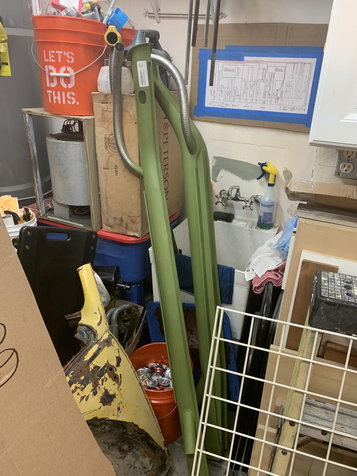

You know what is funny? I had the Klassicfab heater channels in the cart. Then I added shipping into the equation and was shocked. Figured I would grab a set of WW channels and cut and paste in the correct vents and remove and install the rounded section at the late model stamping for the vent. After getting them, I am now, reconsidering. I hate hind sight! Wanted to start in on the channels this coming weekend. Oh well. Need to work on the 70 anyways. It is missing really badly!
Looks like I am going to get the green ones and push that start date!

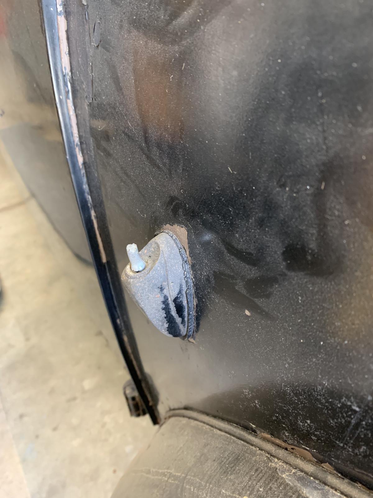

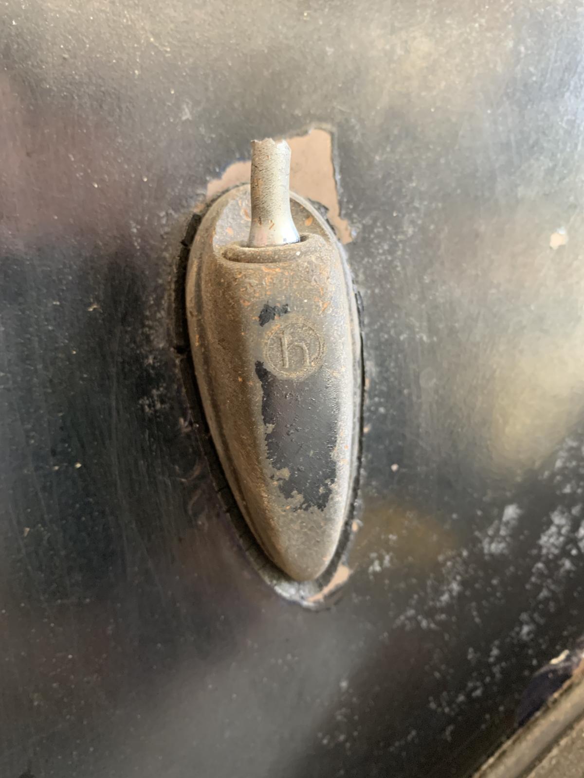

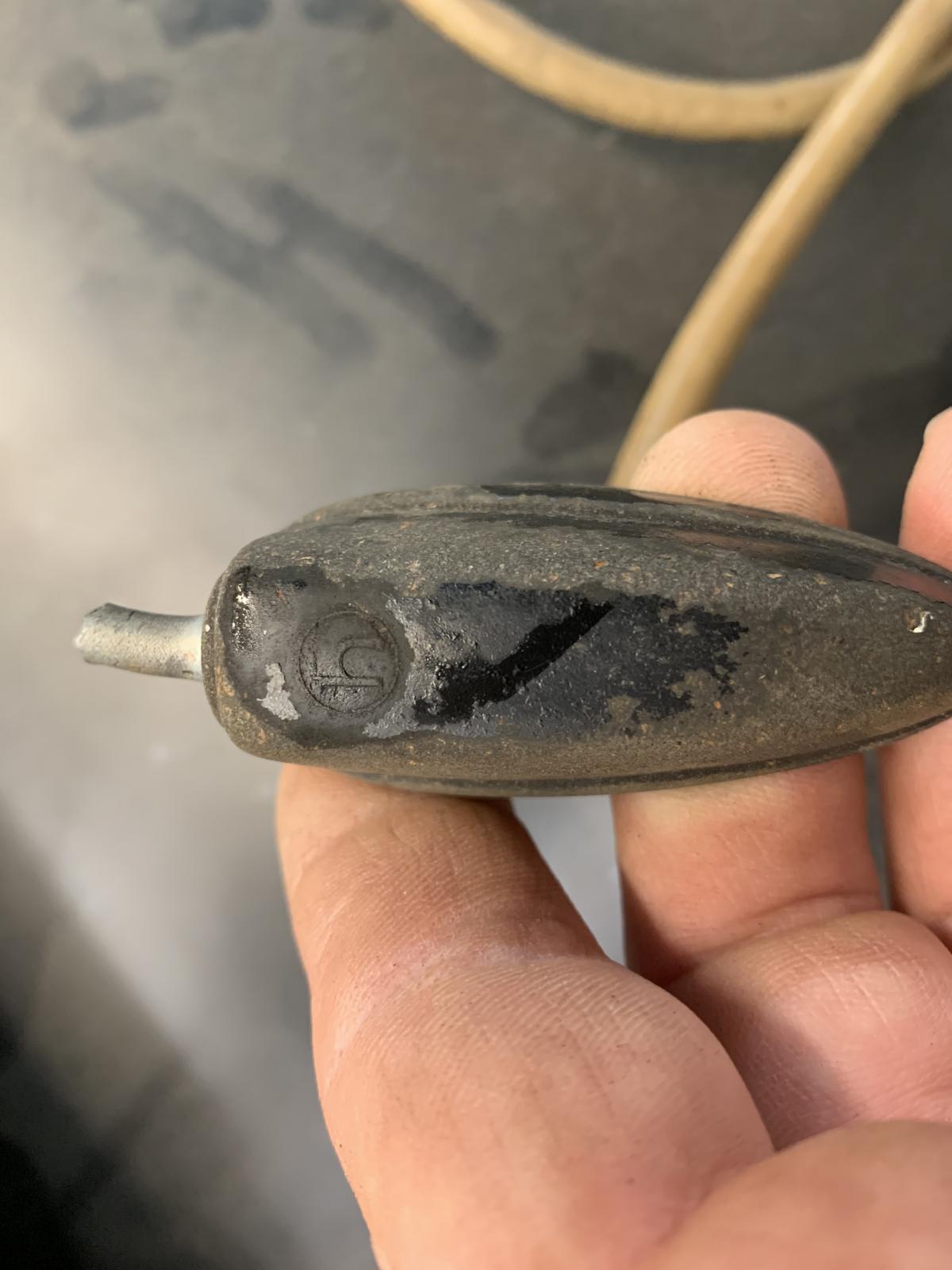

PostPosted: Thu Aug 01, 2019 8:26 pm    Post subject: Re: Jimmy V’s 54 Oval Project Reply with quote
VW_Jimbo wrote:
Hey Janerick3, the car has a similar antenna attached to the passenger side.
The "h" logo identifies this as a German Hirschmann antenna. It looks very similar to the early 1960s VoA-sourced accessory. I have never seen one of these before, so I don't know if this was the replacement for the cowl-mount antenna found on pre-Oct '52 split window bugs. It is unique enough to "restore" with one of those universal replacement masts that are held in place w/set screws, assuming you can still find them.
Thanks,
Jan K.

PostPosted: Sun Aug 04, 2019 11:01 am    Post subject: Re: Jimmy V’s 54 Oval Project Reply with quote
janerick3 wrote:
Thank you for the information. I will try and restore, as best as I can. We will see what happens!

Update time! Still going out into the garage to remove the body from the pan. I did manage to get most of the front trunk area stripped down, bagged and tagged!
I will drop the motor today and start in on the body removal. Wish me luck, as I am certain the bolts are well rusted to the heater channels!
And on that note. Just ordered the Klassic Fab heater channels! $777.00 Damn! I still need to return the WW ones.
Out to the garage I go!!!!

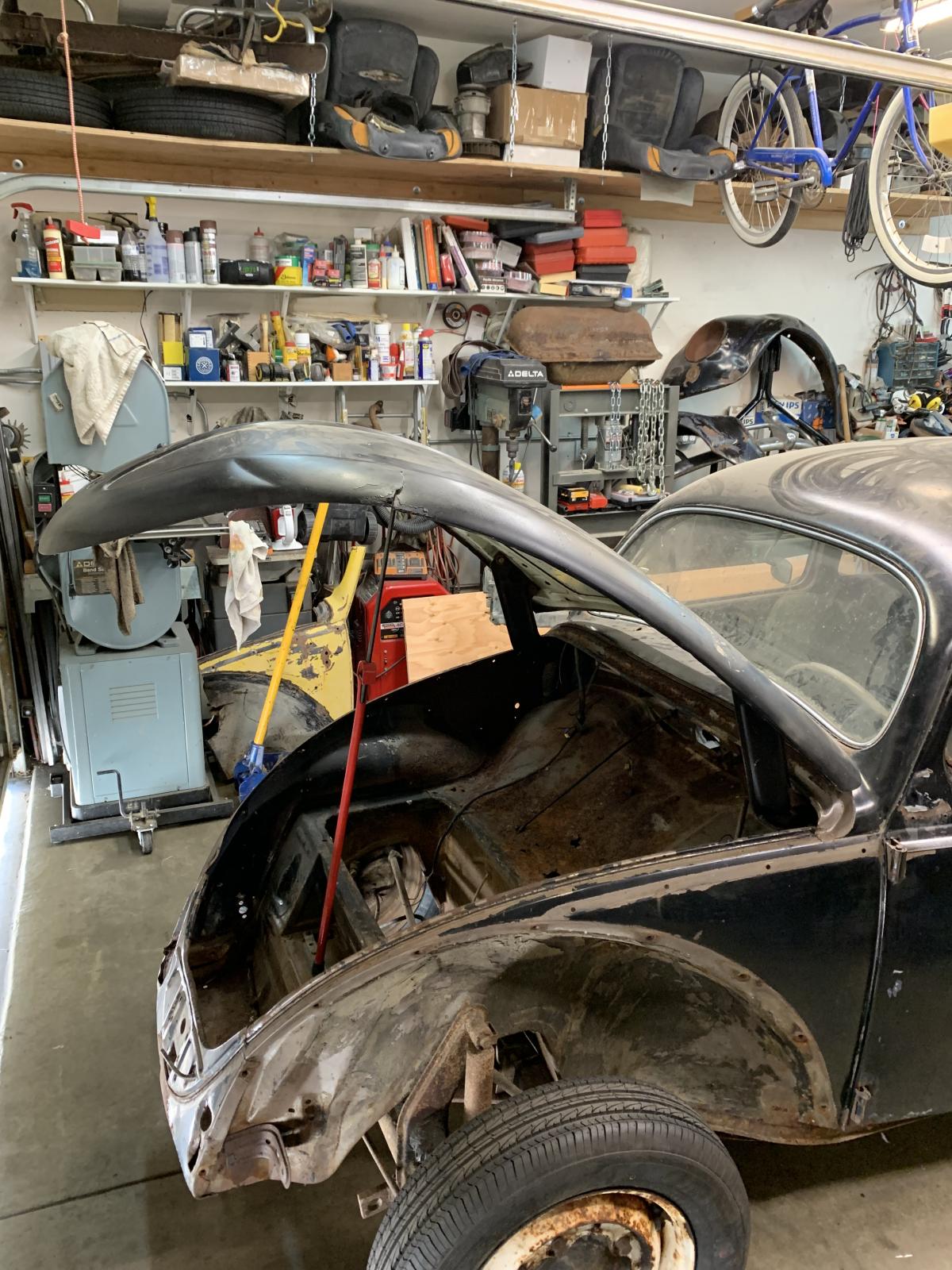

PostPosted: Sun Aug 04, 2019 10:34 pm    Post subject: Re: Jimmy V’s 54 Oval Project Reply with quote

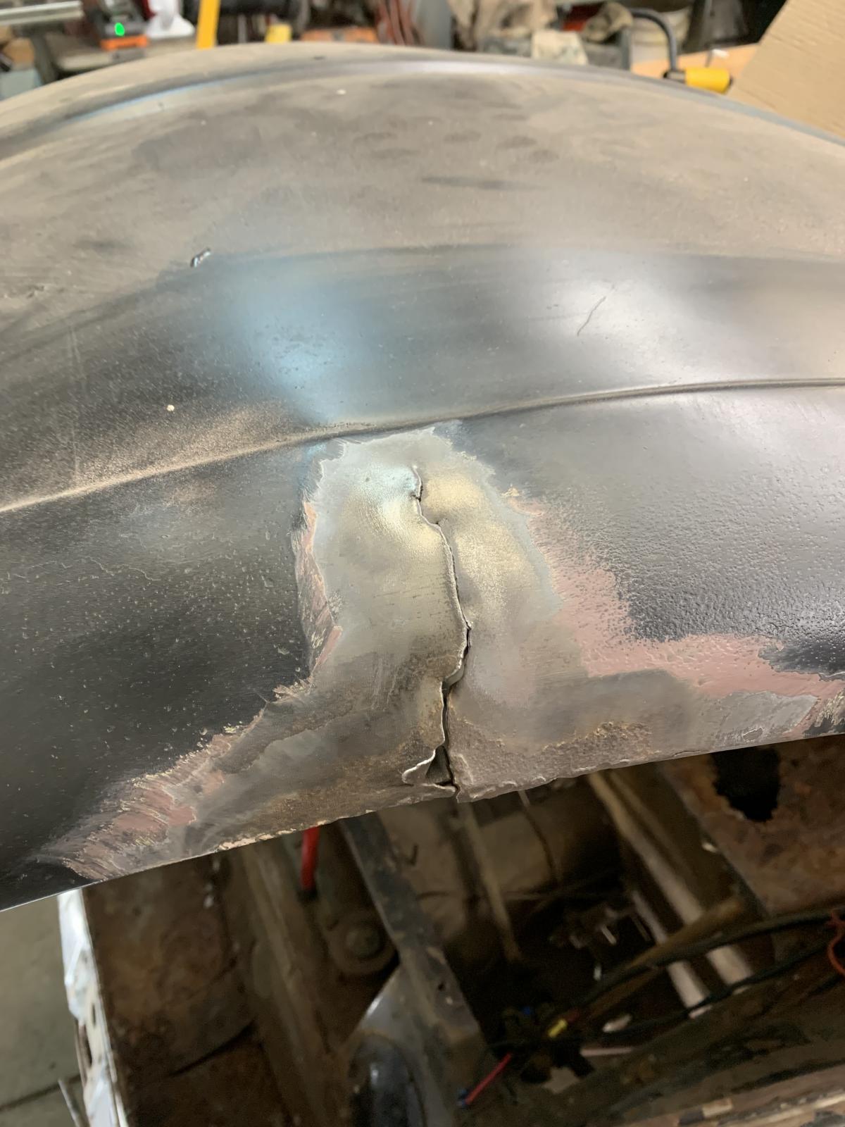

I spent the day playing in the garage. I really should have worked on the 70 Bug, but the 54 was calling me!
So, decided to get the hood welded up and beat out a few dents.
Here is my starting point. Crack at the prop area and one at the very bottom.

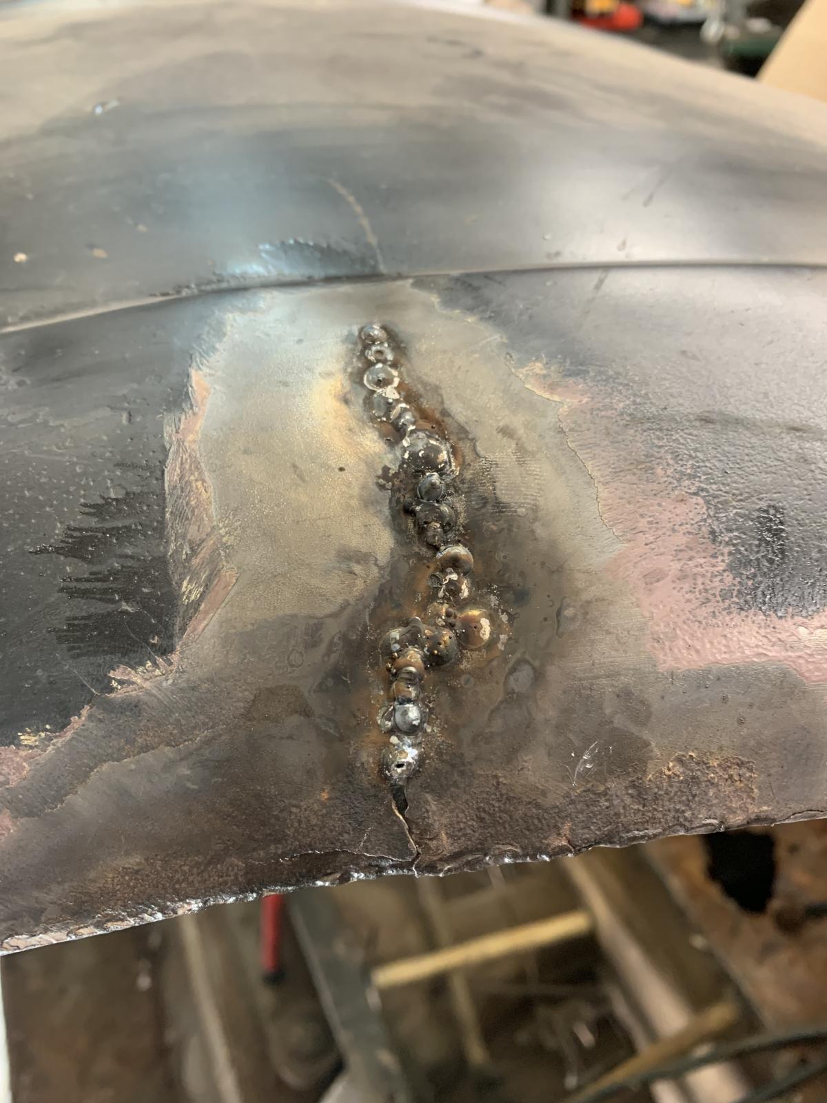

I wire wheeled the area down to the steel, because welding paint is hard to do, and STINKS!
Started with just a few tacks at the best looking portion as I twisted the hood to get the crack into alignment.
Popped 3 tacks in place and blew compressed air at it. We do not want any warping or sinking! With those 3 tacks in place I worked the panel with my hammer and dolly.. Nursing it back into shape and alignment. Then a few more tacks, more hammering, more tacks and more air.
Finished the weld all the way down the side. There is a large rusted area on the return fold. That is a repair for the future. Right now, I just want to keep it from tearing anymore.
So, onto grinding those tacks down.
Then a few more filler tacks, where a few pin holes showed up. Ground all that down and primed it.

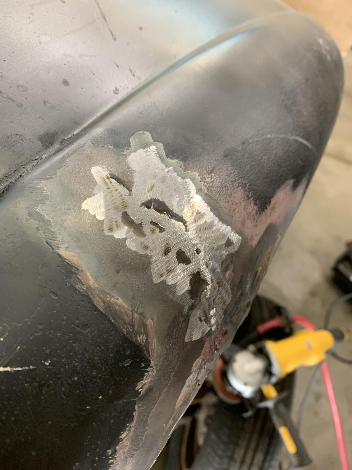

It was the lower portions turn.
Hammer and dollied it just a little bit. Then brushed the paint off of the area.
Welded it up with a few dozen tack welds and ground it all down. Nice and pretty!
That ought to keep it from tearing!
I also adjusted the retaining bolts to check the fit. Nuts on the money!

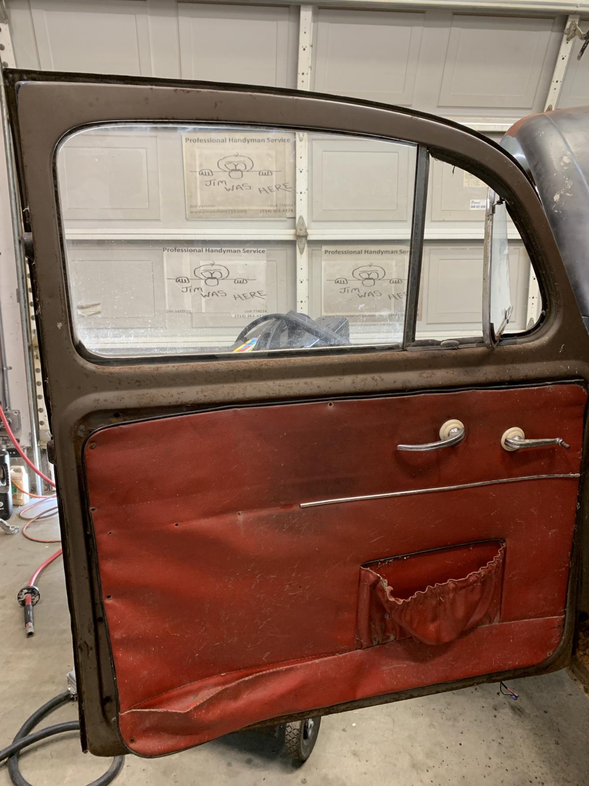

With the hood together and I am not fearing it folding in half, I decided to do the finish bodywork to those spots down the road. Just was not into it today. Feeling a little bit over whelmed. So, when I feel that overwhelmed feeling, finding it’s way inside, causing the doubt and regret to start. I remember back to being little, working for my Granddaddy. He would say, “Son. We do not need to finish it today. But we must get something completed. Let’s break it down into small pieces.” We would break the job down, together. We each choose a piece and went to complete it. We would return for another small piece, until none were left to take! Awesome strategy!
So, moving onto another small piece.
The driver’s side roll up window would not roll up. Heck, I was unsure if there was glass in the door. So, I began with spraying some WD40 into the roll up handle area. Then working the regulator. Not forcing it, just pushing it this way, then back that way. Spray some stuff. Move it again, so on and so on, till the glass fills the emptiness within the frame.
Waaa Laaa!!!!!
Best part is it is original glass!
Downside is, I cannot get the handles off of the mechanisms. I was able to push the collars back far enough to knock the roll pins out, but the handles did not even wiggle!
Soaked them down with WD40. Fingers crossed! Anyone have a trick? I tried pulling on them while tapping with a hammer - no movement!

PostPosted: Mon Aug 05, 2019 11:00 pm    Post subject: Re: Jimmy V’s 54 Oval Project Reply with quote
Anyone got advise on how to remove the inner door handle and window crank handle. I punched the roll pins out but cannot get the damn things off. They have been soaking in PB blaster for 3 days. I have lightly tapped on them with a dead blow mallet, hoping to impart some shock to whatever is holding them in place. I am trying to not damage any of the parts but maybe that is naive.
So, any tricks or just use a bigger hammer and try and buy good replacement parts?
Thanks!

PostPosted: Tue Aug 06, 2019 8:07 am    Post subject: Re: Jimmy V’s 54 Oval Project Reply with quote
Thanks!
I've used PB Blaster for years with good results but it has it's limits. I've recently found Knock'er Loose and it works better. I had an engine stuck that I couldn't get PB to do anything with but 2 days with this stuff and it's now free.
Another awesome product is Kroil.

PostPosted: Tue Aug 06, 2019 8:19 am    Post subject: Re: Jimmy V’s 54 Oval Project Reply with quote
Kroil is badass...but pricey. When I was in the Military, a vendor came into our shop to sell us on Kroil. We put 2 drops on a the end of a 7/8" plow bolt. He said that it would travel "UP" the threads. I thought ....yeah sure it will. We stashed the bolt (head down) in the back of the shop so nobody would mess with it, and he said that he'd return the next day, with the agreement that if it traveled up the threads, we'd purchase a case. Next day...sure enough, it did. We used it exclusively after that on all of our snow and heavy equipment.
I just can't stomach the 24 or so bucks a can. But this just might be what you need. I have a cherry set of ribbed door handles and black escutcheons that I tried for months to try to separate from the mechanisms without any success (heat included). I soaked then again...and shelf'd them. Let us know if you're successful!!!

PostPosted: Tue Aug 06, 2019 12:35 pm    Post subject: Re: Jimmy V’s 54 Oval Project Reply with quote
I'm a big fan of 50-50 mix of acetone and ATF.. in a small squirt oil can,it's worked great for me..certainly put to the test on my old turd '56

PostPosted: Tue Aug 06, 2019 6:55 pm    Post subject: Re: Jimmy V’s 54 Oval Project Reply with quote
Thank you for the replies!!!! I will try it all in the order that it is written in! I will let you guys know when the handles finally let go. I may try some heat first. What do I have to loose? I guessing a little heat a maybe a tap or two with a brass hammer and it might give! If not, onto the list of penetrating liquids!
On a big plus side!!!! Got my channels from ClassicFab! WAYYYY better looking and way heavier! Guessing they are using a little thicker gauge steel.
Plus it came with the correct heater tube to the window defrost ports! Was not expecting that.
Maybe now I will get the body off of the pan!
