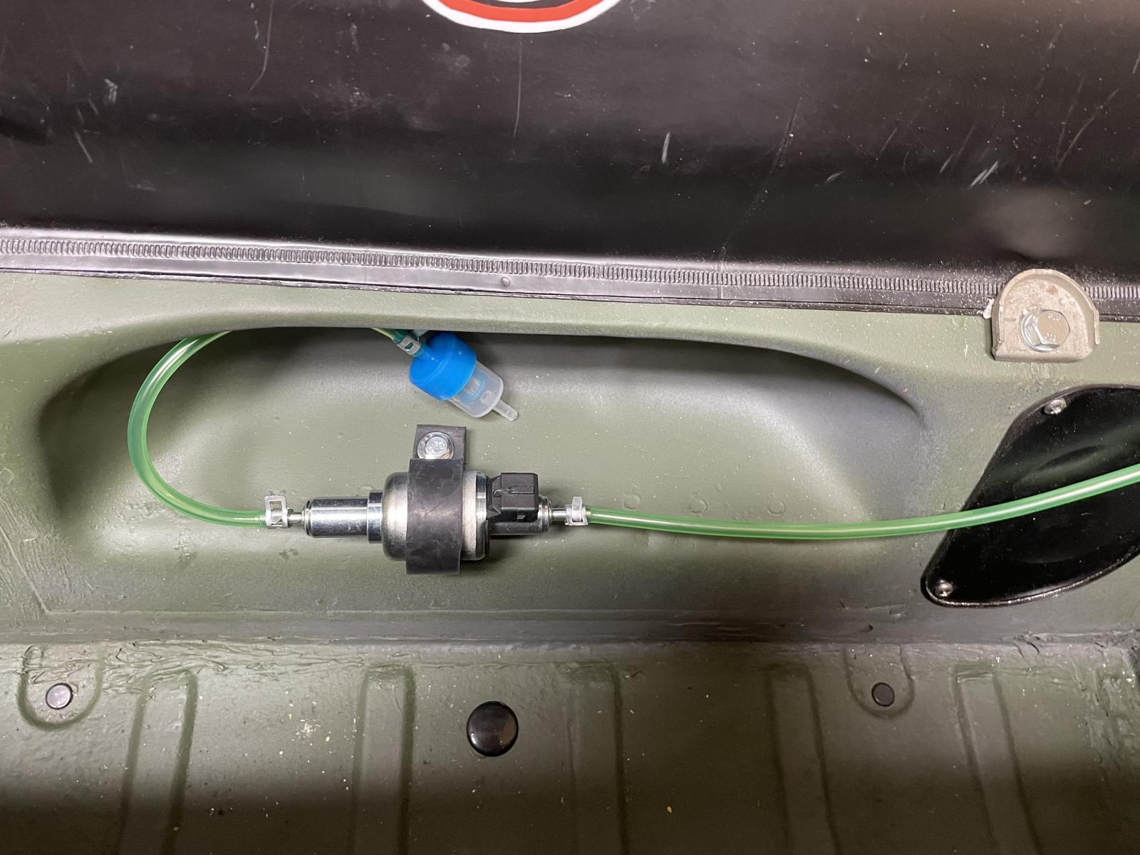

PostPosted: Fri Oct 27, 2023 4:50 pm    Post subject: Re: Kubel 2021 Reply with quote
Trying out one of these Diesel heaters Still need to finish wiring and the fuel tank install.

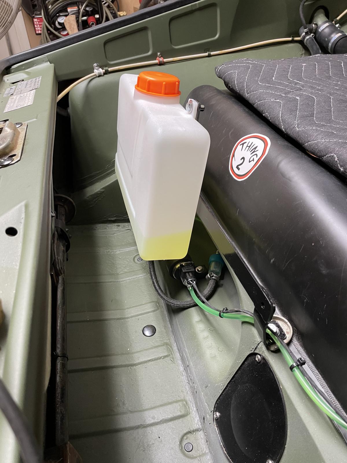

PostPosted: Thu Nov 02, 2023 1:48 pm    Post subject: Re: Kubel 2021 Reply with quote
Working great! Took a bit to get the pump primed but puts out very nice heat.
I will need to install a downpipe on the muffler though. 😎. The kit comes with a 10L tank which i hated. Too odd shaped to work for me so i changed to a 7L tank that fits much better.
I will be painting the heater cover black. 😳

Really nice work! I am reinstalling an original heater in my Thing. A lot of the holes in the Frunk were fiberglassed and hidden. I have found all the heater related ones, but how is that forward facing evap line from the canister running through the Frunk? I can't figure out how (where) it passed through to get under the chassis?
Thanks,
Bill

PostPosted: Fri Nov 17, 2023 2:04 pm    Post subject: Re: Kubel 2021 Reply with quote
There’s a hole beside the fuel tank underneath the heat shield for the heater exhaust.

PostPosted: Fri Nov 17, 2023 2:21 pm    Post subject: Re: Kubel 2021 Reply with quote
I was looking for where the evap line ran. Don't think I would want to route it through the hole for the heater exhaust, that might get a bit warm Smile
I did find that i could route it through the hole for the heater fuel line and fuel pump wires. That seems to work out pretty well.

PostPosted: Fri Nov 17, 2023 2:24 pm    Post subject: Re: Kubel 2021 Reply with quote
ncpi wrote:
That’s where I meant
