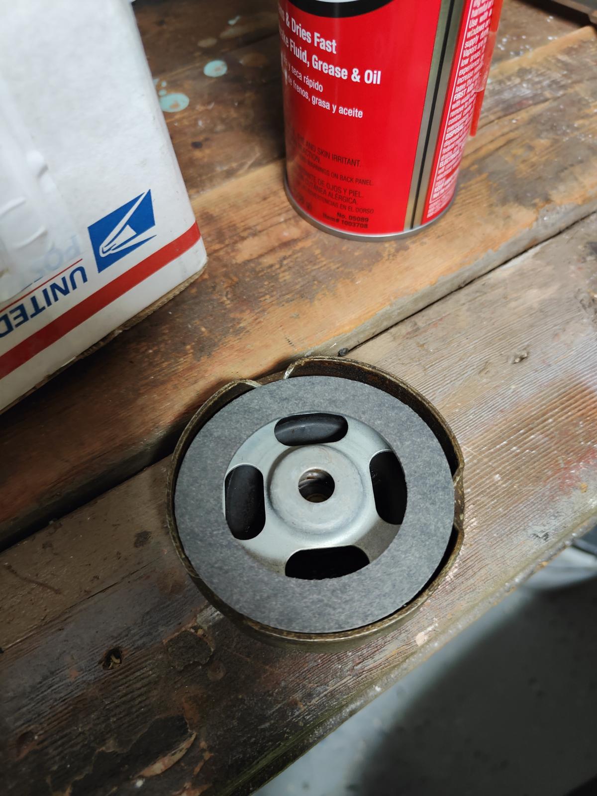

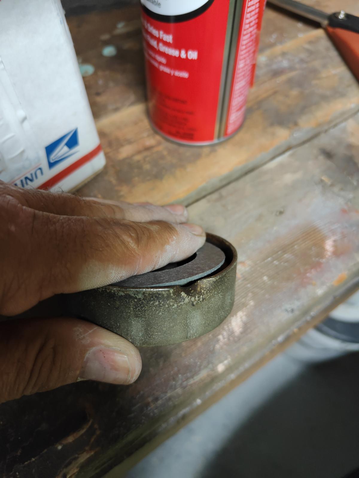

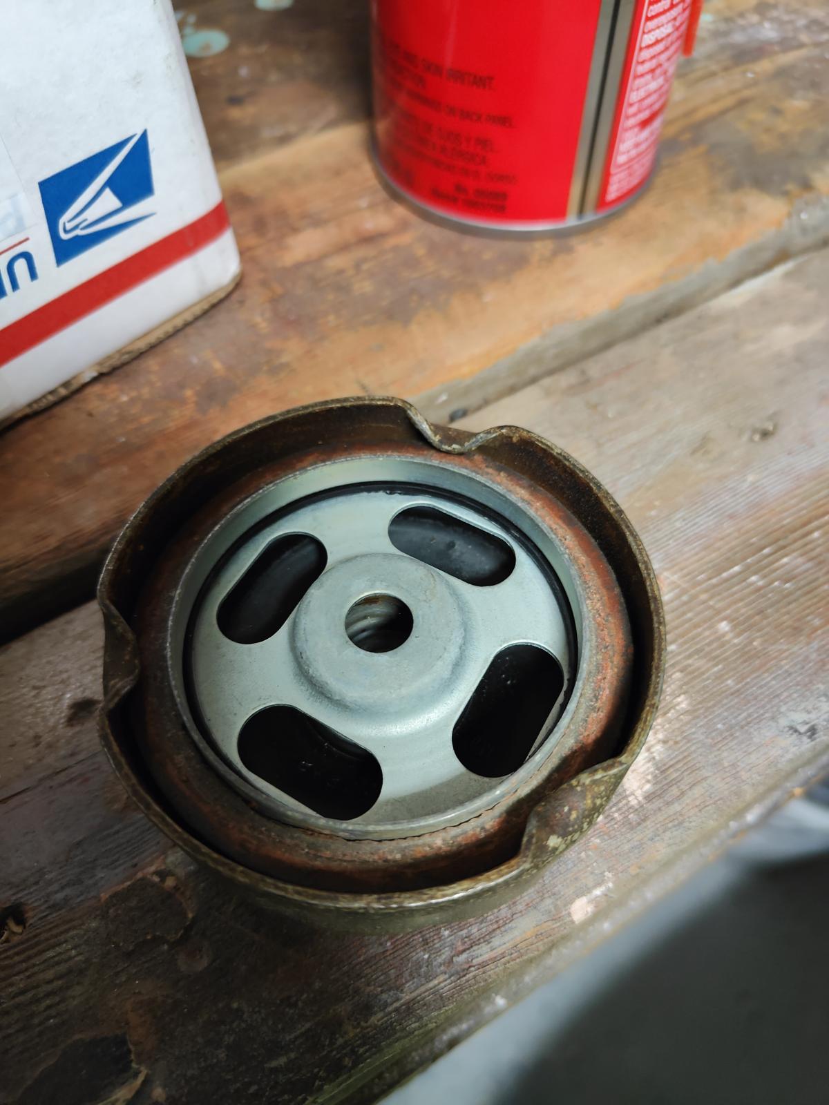

Trying to get a gasket for my gas cap.
It's 70mm but I got one and it doesn't fit
Suggestions?

great work, great Bug! The gas cap looks correct to me. It is the "higher" later version. This version replaced the older and flatter gas cap with the big VW-logo.
VW repair shops even replaced the flatter gas caps on older cars, because the hgher ones were supposed to be safer in an accident with tumbling over. The older version looks nicer with the VW logo, but I personally prefer the newer one (which you have) for safety reasons.
You are on the right track with the seal: It can be rubber or cork and it goes between the outer margin of the lid and the inner circle of the cap.
Check this:
https://www.csp-shop.de/auspuff-heizung/dichtung-tankdeckel-201-557-111a-21325a.html
Check this:
I think I'll try cutting down the one I have for now.
Thanks!

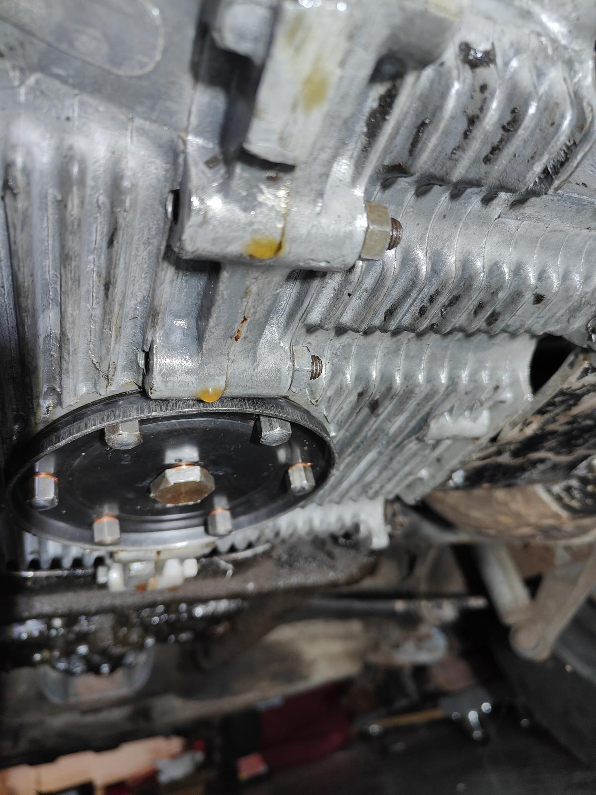

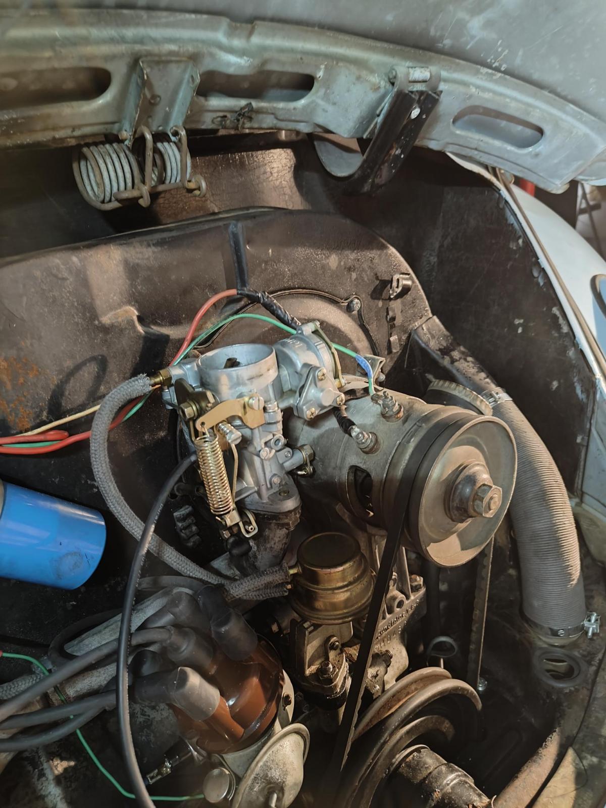

Well the summer flew by and I finally attacked my oil leaks...
The oil was more that just oil so I ended up dropping the engine so I could get isolation between the engine and transaxle (the only things that have liquids in them!
It turns out they *both* had leaks!
When I replaced the boots, I missed the memo about sealing every seam and boot to metal surface with RTV...
So I pulled them off and reinstalled... I wish I hadn't used RED RTV, it looks like a murder scene under there!

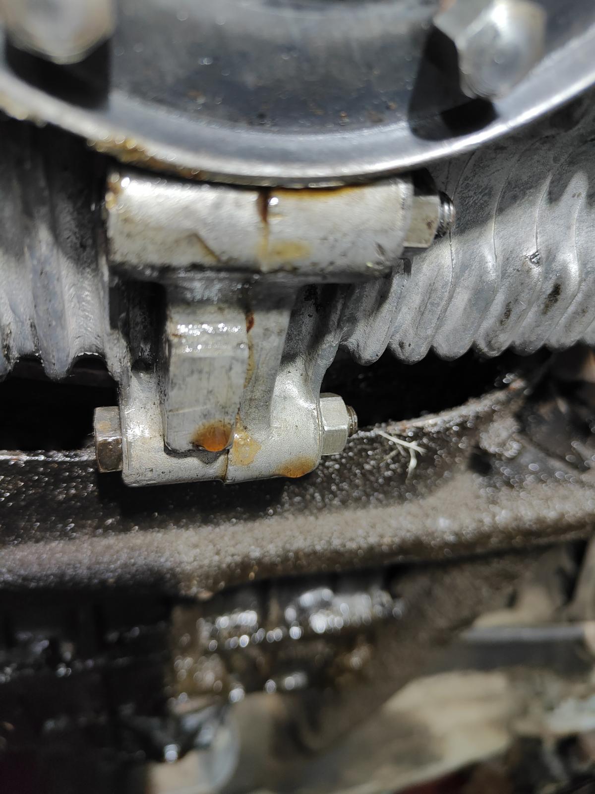

The oil leak was a bit more subtle, oil would show up on the bottom of the engine and drip from different places and it was off center, so it wasn't the engine seam...
Then I realized it was on the downhill side of the engine... it was on blocks on the floor
I ended up draining the oil and removing the sump plate and filter
It all looked clean and smooth
I brought it in to show my IT Guy (who doubles as VW expert his entire life Smile)
And upon zooming in the answer was staring me in the face
This one may not be a real problem
I bet this was the issue!
I put a small smear of RTV over each of those rough spots and overnight it is dry as a bone!
After church I'm going to fire it up and take it for a drive to be sure!

Well there's good news and bad news...
The good news is that after the test drive there is no sign of a leak overnight!
The BAD news is the engine is running very HOT.
I had seen this before.
How hot?
A maybe 2 mile drive to the entrance of our community and back the deck lid by the handle is too hot to touch!
Tom

PostPosted: Mon Sep 22, 2025 3:07 pm    Post subject: Re: Mojave 1967 Sunroof Reply with quote
A local friend suggested checking the basics... basic tuneup... valves, timing etc

PostPosted: Mon Sep 22, 2025 4:53 pm    Post subject: Re: Mojave 1967 Sunroof Reply with quote
w2vy wrote:
... the deck lid by the handle is too hot to touch!
Your timing is way too retarded.

PostPosted: Wed Sep 24, 2025 4:36 am    Post subject: Re: Mojave 1967 Sunroof Reply with quote
I found the vacuum line was loose enough to fall off... replaced it - tight now
Was raining last night... hopefully can test tonight

PostPosted: Sat Sep 27, 2025 6:14 pm    Post subject: Re: Mojave 1967 Sunroof Reply with quote
Tested runs much better, decided it would be good to check everything... Glad I did
Valves 1&2 just under 0.006, 5 was sloppy

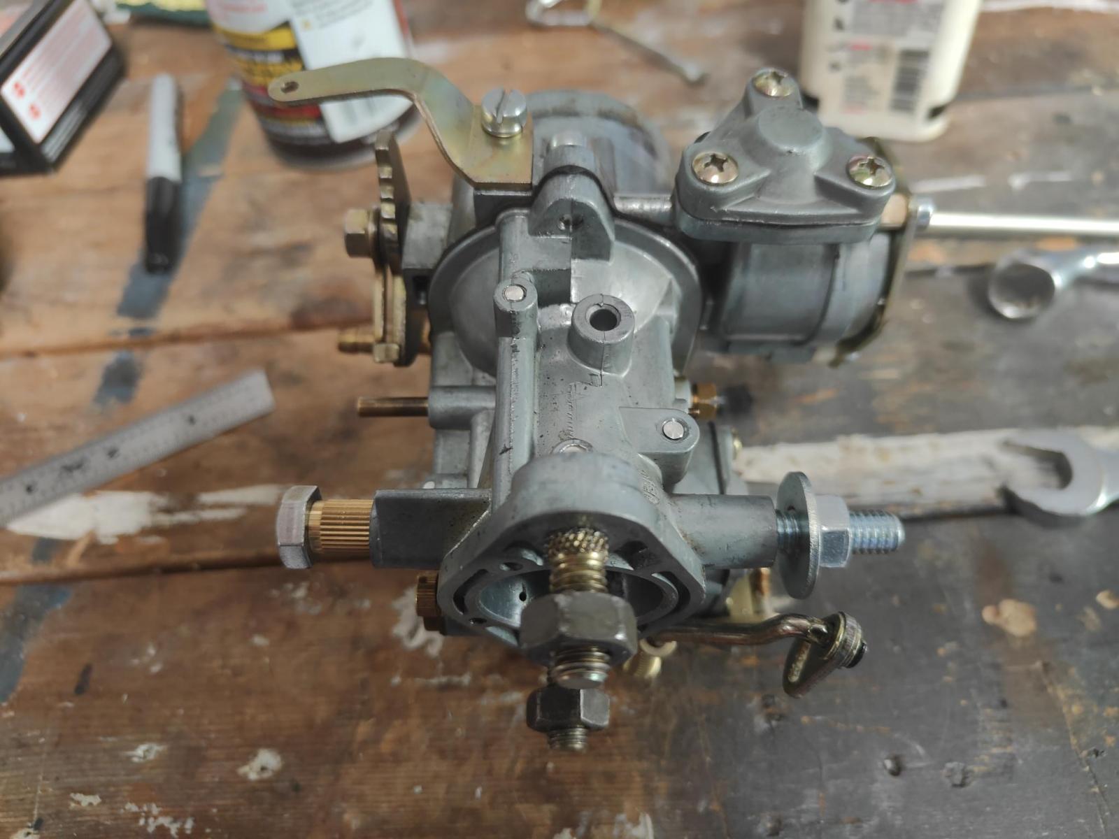

The engine always smelled Rich and I was having a hard time setting the carb right.
Yesterday I was working on it with the engine was off and air cleaner off and from time to time I heard a sea shell sound coming from the top and it only happened shortly after giving it gas (pulling the throttle lever)
It occurred to me it was the gas evaporating and the bottom of the carb was damp with gas
Then my eye caught this:... oops my video was in the wrong format or they are not allowed
I saw a flickering reflection between the carb body and the throttle control shaft (the one the butterfly is attached to)
Gas and drops of gas leaking out, which is totally a vacuum leak, which is why nothing set right!
About 7+ year before I got the car my Dad had an engine fire.
This clearly might have contributed...
New bushings and reamer on the way from ebay...

Well I got the reamer and bushings and then it took some time to get access to the milling machine at work. They have not used it in years... our offsite mechanical guy reminded me how to change the collets etc
I forgot to take pics there.. sorry
I came home and had to figure out how to press the new bushings in.
I ended up using a 5/16 bolt (4" long) with washer and nut
I did one side at a time, and they came out pretty good
Getting the shaft back in was a bit of work. I ended up cleaning the surface of the shaft with 400 grit sandpaper and worked on it for a while and got it back together
and installed
Once I got it back together right (wires lol) it started and ran ok.
I screwed in the Volume Control screw and it did slow down to almost a stall
which did not happen before so I think I fixed the leak
things were going well and then I turned the screw again and it stalled and I noticed
a lot of dripping from the throttle shaft (i think)
I wonder if I did not tighten the nut on the shaft far enough...
The throttle moves ok, butterfly not hitting anything
I will look at it again on Monday
Any thoughts?

Sadly it is leaking gas out both ends after the engine is turned off
I guess I need to get a different carb...
