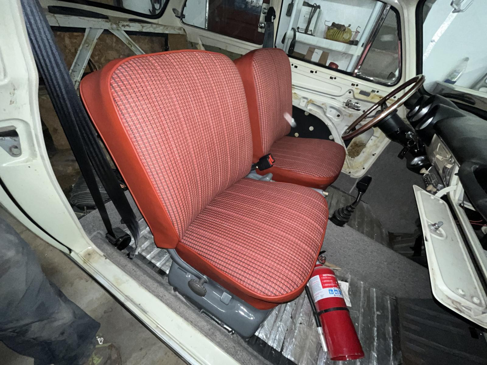

Front seats are done so test miles can start while waiting on the rest of the interior.
Looking REALLY nice. Who did the covers?

Thanks Tram! The upholstery is being done by Lee's Custom Upholstery in Youngstown Ohio. I got the cloth material from SMS Auto Fabrics, it's a pattern from a '60 Pontiac.

That's coming up aces. Really digging the seat covers.

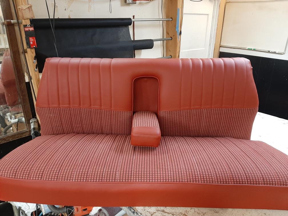

Missed another target. Rear seat pattern did not match the front seats and the quality was not the same. Moving on to another upholsterer. Spring is just around the corner.

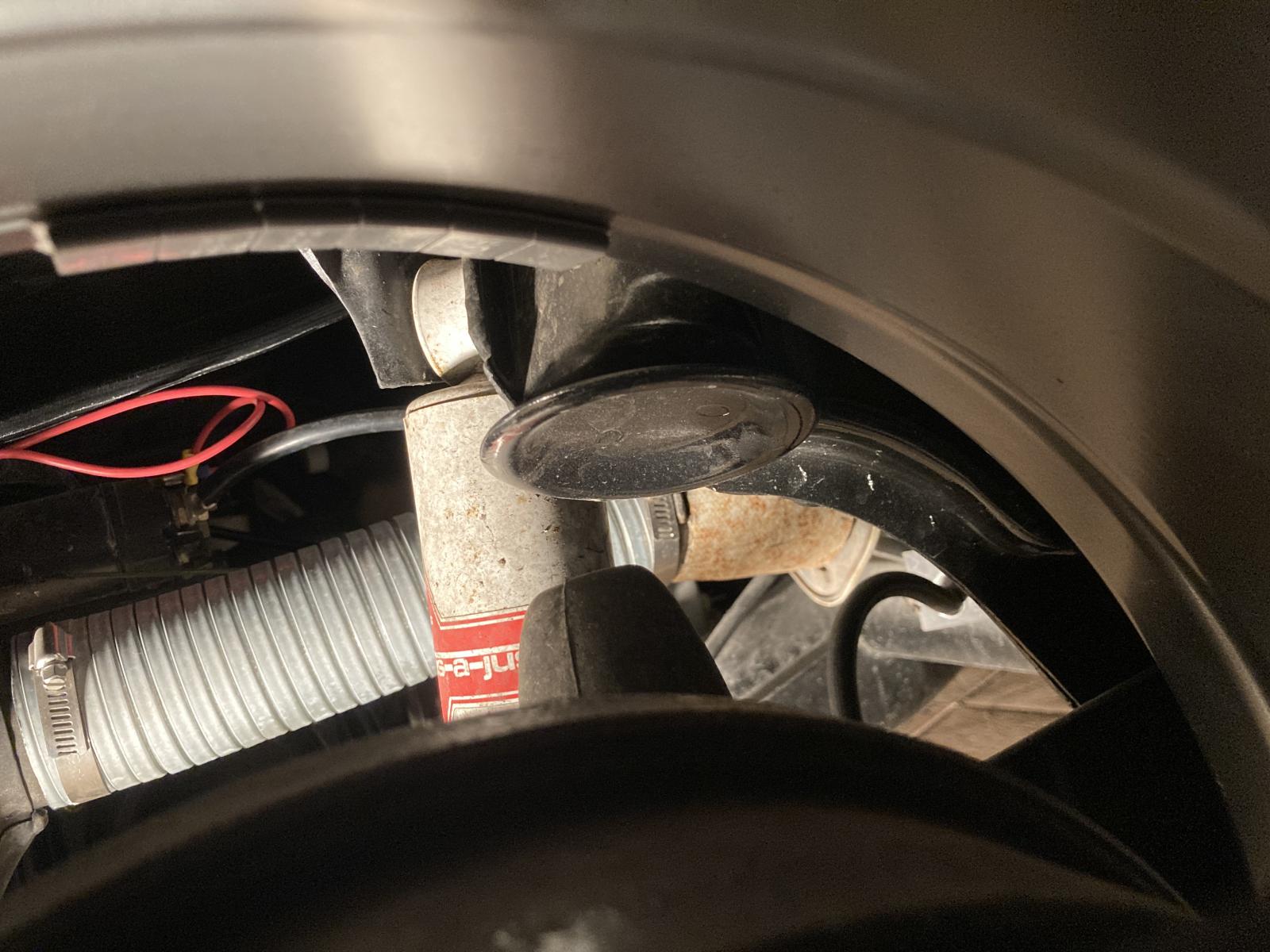

Needed new tires and took the opportunity to change the wheels. Not many performance tire options in 15". Went with Yokahama Advan Fleva, 205/50-17 rear, 195/55-15 front.
I had switched to Beetle short axles in the rear to gain space for the previous wheels. With the 17x7s and the short axles I need a spacer to get clearance for the bump stop and the spring plate. I might take time this summer to switch back to the T3 axles rather than run the spacer. Initial fitment with 3/4" spacer is tight, I expect I'll need to roll the fender lip. Likely need to trim the bump stop landing pad or maybe add a limit strap (swing axle).
Tough to get a shot that accurately shows the clearance.

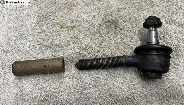

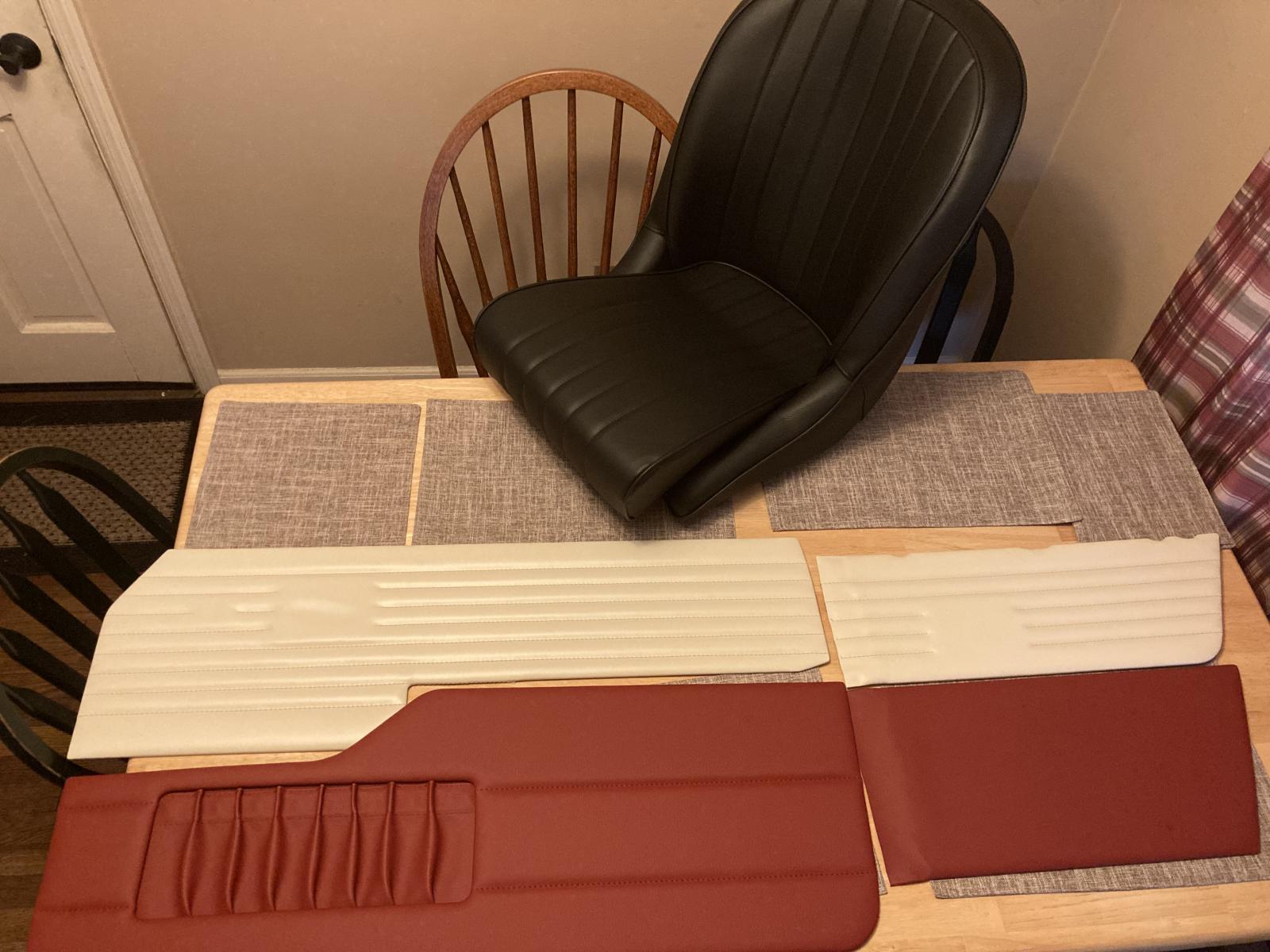

Latest updates: I raised the front one inner spline, the ride is sooo much better. BerT3 dropped spindles doing their job. Also leveled the rear side to side and the stance is now done. When I took the Notch in for alignment I learned the passenger tie rod adjusting sleeve is bent. I looked through the classifieds and don't seen anything available. ISP does not appear to list the adjusting sleeve but I have not called yet. I did see a classified ad for a left inner tie rod end which appears to include the adjusting sleeve so that might be an option. Does anyone know if the left and right adjusting sleeves are interchangeable? The one in the classifieds is also a later model, 68-73, any thoughts if that would work for my '65?
Continuing to work on finishing the interior. Received my door panels from Sewfine, looking forward to installing those. One backward step, the covers for the front seats are beautiful and I'm really happy with the fabric selection, however, since I hadn't driven the car for 15 years, I forgot the driver seat is just not comfortable (maybe it's because I'm 15 years older). After much searching for a period correct looking seat, I purchased a Cobra Roadster XL. I'll try the seat out of a month or two and if it works out I'll have it recovered to match.

What do you mean by tie rod adjusting sleeve?
#46 in your catalog here:
https://vwispwest.com/type3/front-axle-steering/steering/early/
You guys call it a "tie rod" but it's also an adjusting sleeve since it adjusts the length of the assembly.
Well that makes too much sense, I've just never heard it called a sleeve.

Well don't I feel silly now. I also had never heard "adjusting sleeve" so I checked the ISP catalog because the exploded views are such a great resource. When I didn't see a "sleeve" separate from the tie rod I looked through the classifieds and found this:
All I really needed to do was to climb under my car and look for myself. Oh well, if that's the biggest mistake I make this week, life is good.
All good. Very Happy After you mentioned that there was one in the classifieds, I went and looked, and saw the same ad. That is just the cardboard sleeve to protect the threads.
The tie-rods themselves are not interchangeable. There is a left (short) and right (long) side (for LHD models). If it's available on the ISP site from what Tram linked above, we probably have a good use one to send out.

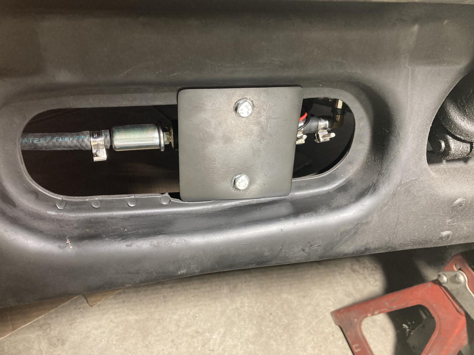

More tweaking, I didn't like the electric fuel pump mounted on the bulkhead so I moved it to the front beam. Sandwiched the beam seam between a couple mounting plates. Several layers of rubber innertube between the mounting plates and the fuel pump for some additional isolation.
I need to replace the Revolution Electronics fuel pump controller, it only worked properly a few times (cut off power after 3 seconds of no engine RPM), has been running continuously with ignition on ever since. Defeats the purpose. Now it's dead. Plan to switch to an inertia switch.
