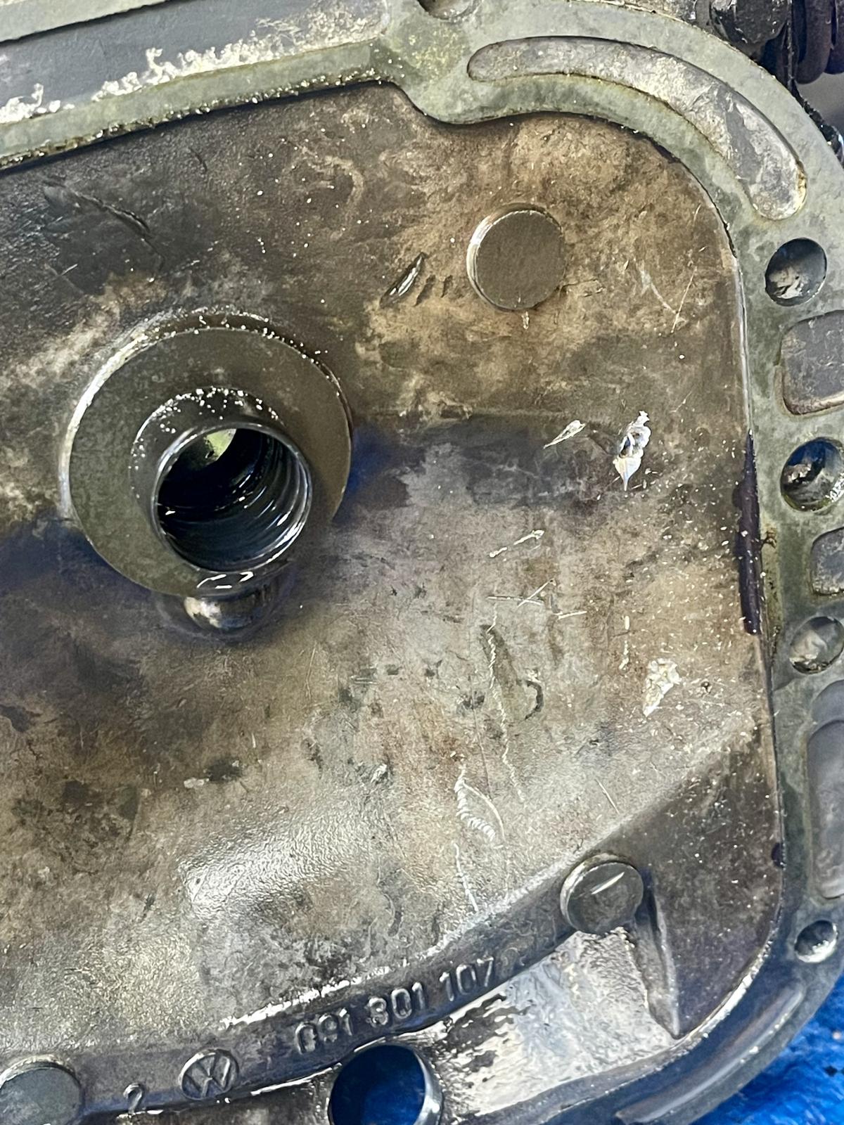

Back and showing what I am dealing with...
I dont know much on transmissions, so after talking on the phone with the rebuilder. he seems to think the Spider Gear Exploded, damaging the Ring Gear.
If the piece never came thru the bell housing, I would have never known.
well, eventually I would have, ( yes, More to come. )
what I can't believe is that the passenger and I never heard anything, such as grinding or crunching, felt anything other than the clutch slip, no shifting problems.
Here are some pics, anyone have any ideas?
I was thinking the seal would have been the issue but nope.
Seal was intact, no issues.
Drained the Trans and this is the magnetic plug
I guess these chunks are from the ring gear.
I have access to another Bell Housing cover for the 091 but was shocked when I saw the damage.
this was the inside of the bell housing, it's like a grenade went off...
other pieces scored the housing but only the one came through.
