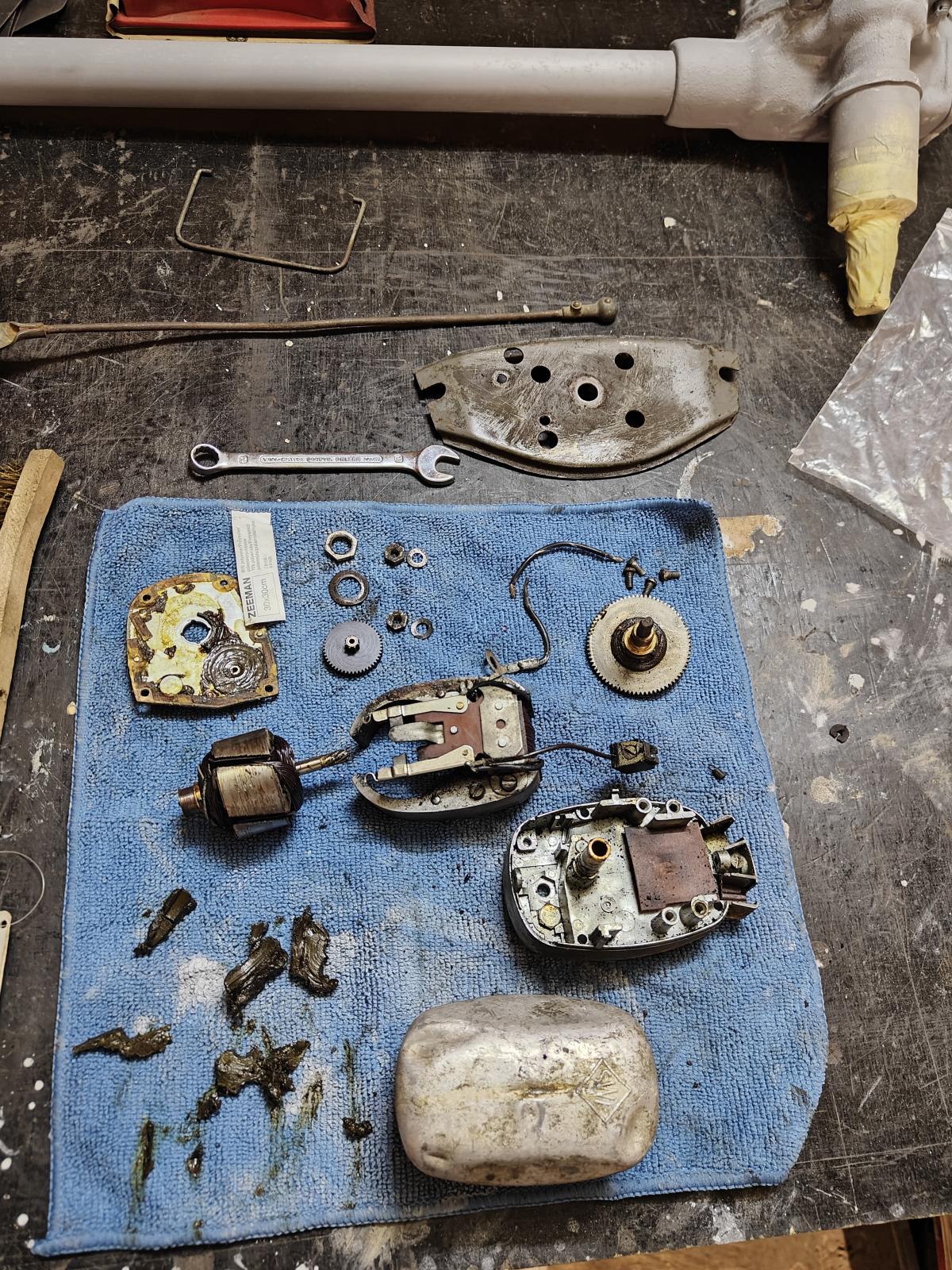

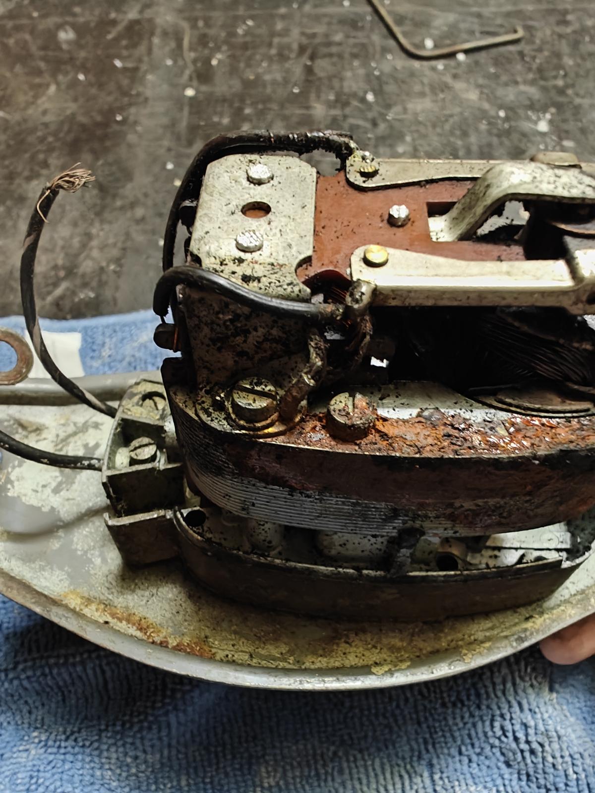

Time for the wiper motor,
I am doing a 12v conversion so gotta get the junk out of it,
Give it a good clean and install the new 12v rotor.

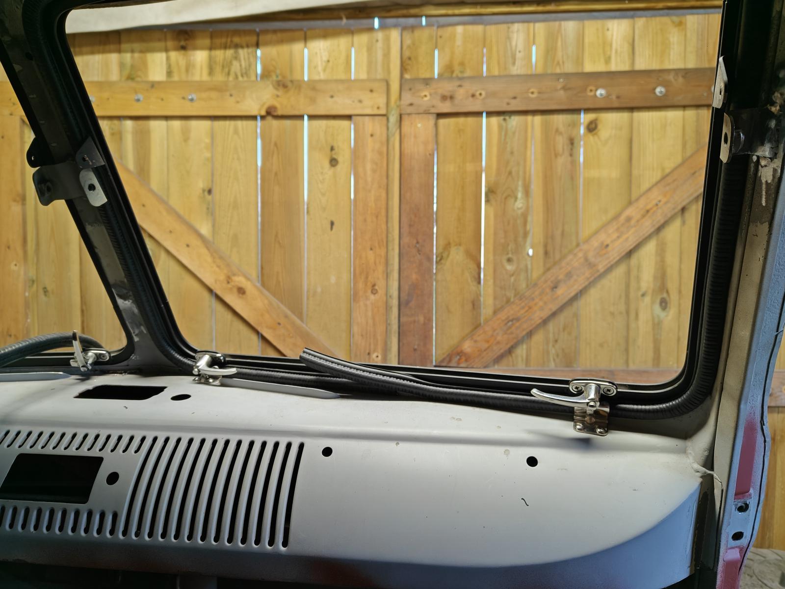

Another common repair on the bus:
Also drilled holes in the dash and positioned my safari window latches.
doing it before paint offcourse Laughing
Almost ready for the exiting sanding part! Rolling Eyes Rolling Eyes

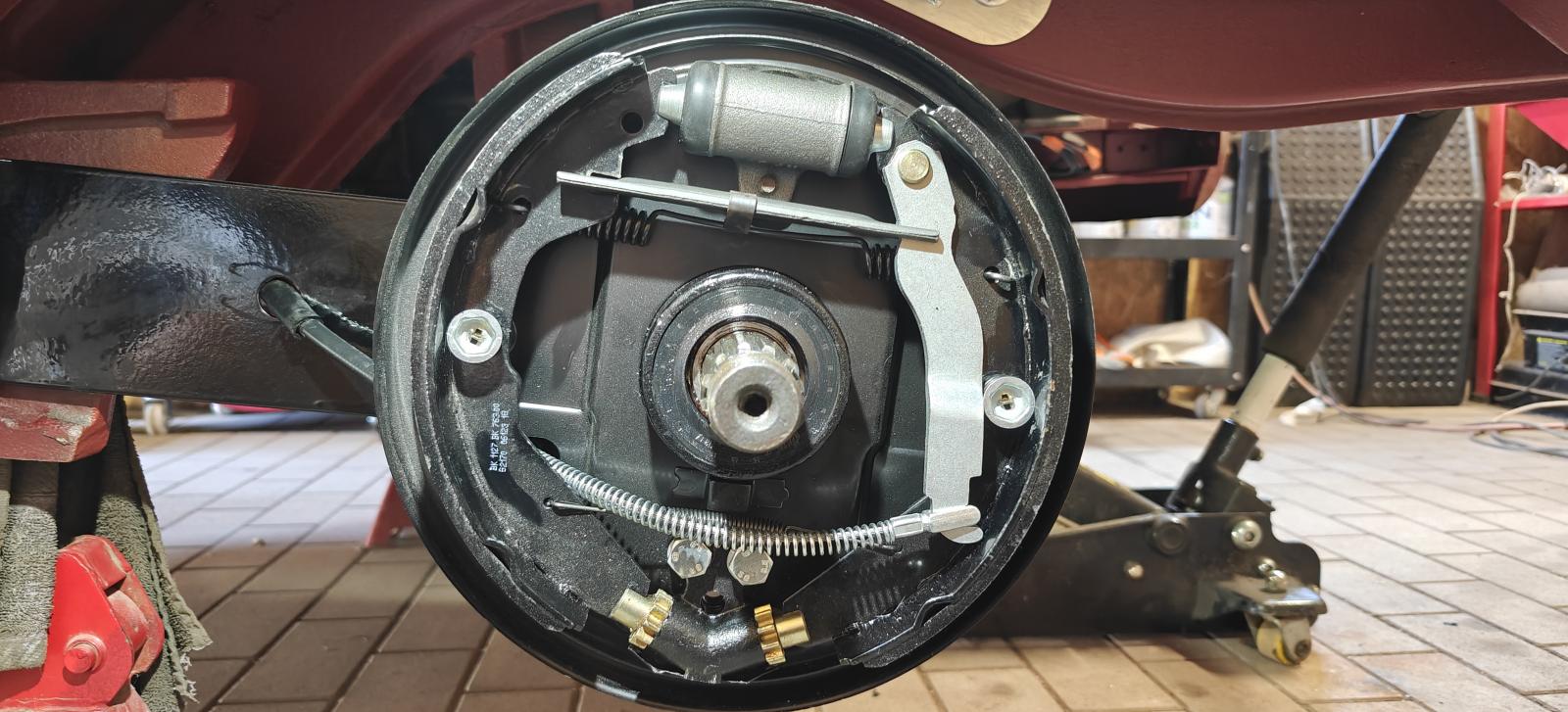

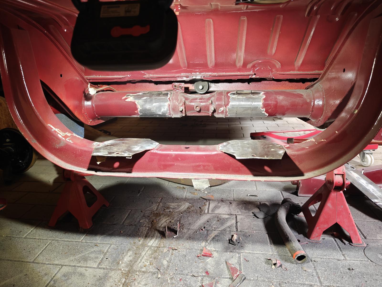

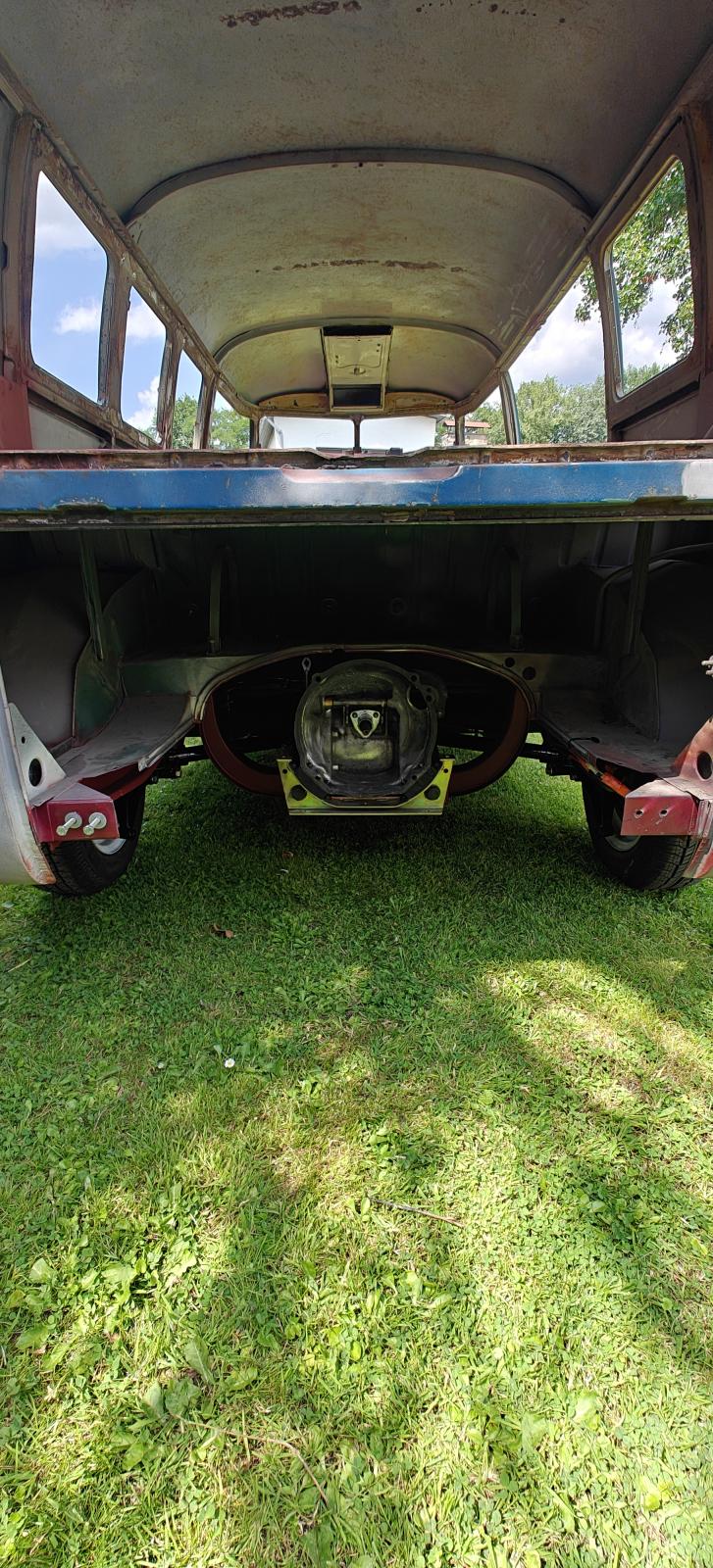

Long time since my last update!
I have decided to sell my straight axle setup an go the IRS way.
there are several pro and con's but in my opinion IRS is way to go for me..
The bolt on brackets for beetle IRS are not an option.. the MOT doesn't allow this here in Belgium so the only that was left is the Creative Engineering Bay window bus kit. These require to cut the OG frame horns and weld in their ones. but CE doesn't make these anymore so i started to gather some parts.
i did managed to find the frame horns seperately aswell as the shock mount brackets. (it think i bought the very last brackets available)

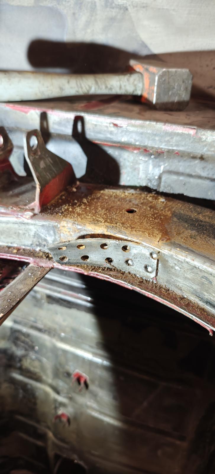

started to remove the old stock shock mounts:
Bolted the new ones in:
next up, cut the OG framehorns:
Triple meausered where the CE horns need to come,
U can find the manual for this conversion online, it's really obvious and easy!

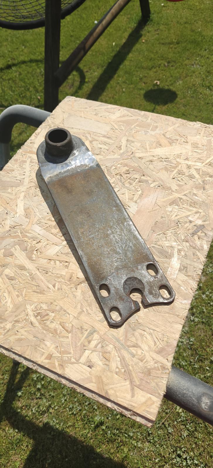

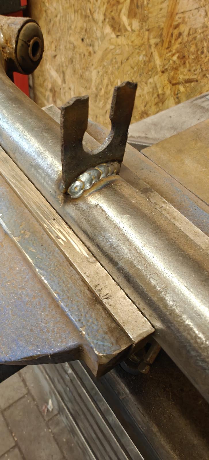

Since i actually need everything from an early bay window and parts for that are so hard to find, i am gonna take the control arms from an early bay (which i had layin around) an use the rest from a late bay bus and fabricate some things myself.
needed to make my own spring plates using stock split bus front piece and late bay rear piece:
meausured and tack weld it:
fits perfect!
Fully welded the CE framehorns:
really happy with the way things going!
More to come!

Nice. I’ve been doing some research on this combination rear setup. Concerning the springplate- is there not any reason to not use the stock 68-70 springplate ?
Yannvanh
Joined: November 07, 2020
Posts: 204
Location: Belgium
Yannvanh is offline
PostPosted: Wed Jun 12, 2024 12:09 pm    Post subject: Re: 11 window 1966 full resto Reply with quote
Nope.. but they are so hard to find here in Belgium/Europe
The only thing what my manual says is that the all of the spring plates (CE, early bay and late bay) have 48 splines..
I don't know how many splines a stock splittie has but my late bay spring plates were too big for my torsion bars..
I had a few split bus and late bay spring plates laying around so i weld them together with a 370mm length
Also there's a mistake in the manual i think.. it should be 68-69 and not 68-89

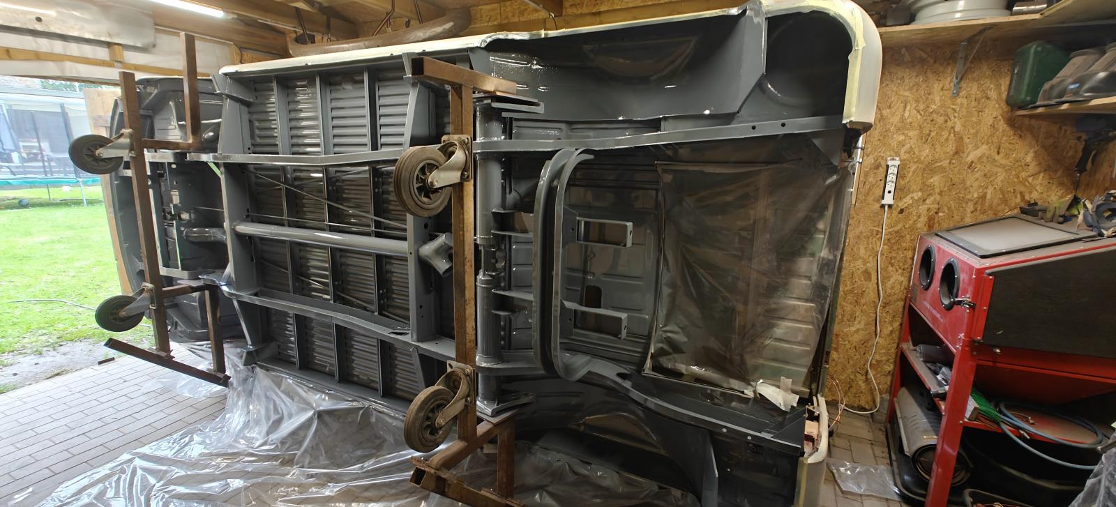

PostPosted: Wed Jun 19, 2024 2:41 am    Post subject: Re: 11 window 1966 full resto Reply with quote

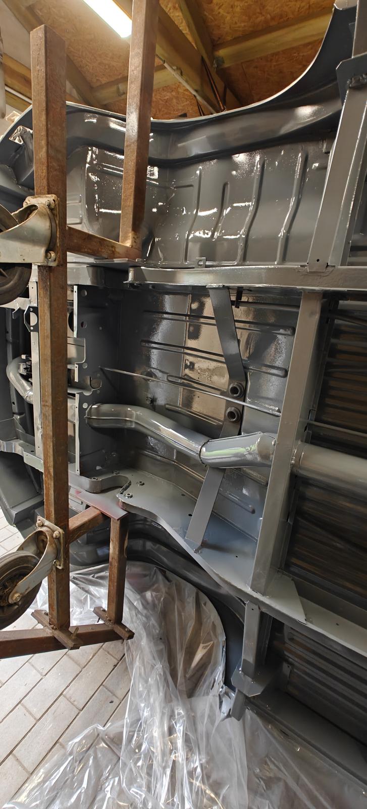

After i made a mistake with the undercoating it began to peel of..
What a headache to get few steps back, but there was no other choice then take everything back off and start all over..
My fault whas that i used 1k brunox rust convertor and epoxy and then put a 2k epoxy over that.. there was no good bond between the two Mad
So everyrhing had to go back to bare metal and i decided to go for a raptor liner epoxy and undercoating:
10 times better then the previous in my opinion.. wish i had it done the first time Confused Still learning everyday!
Now just let it cure for a couple off days and start to rebuild again!

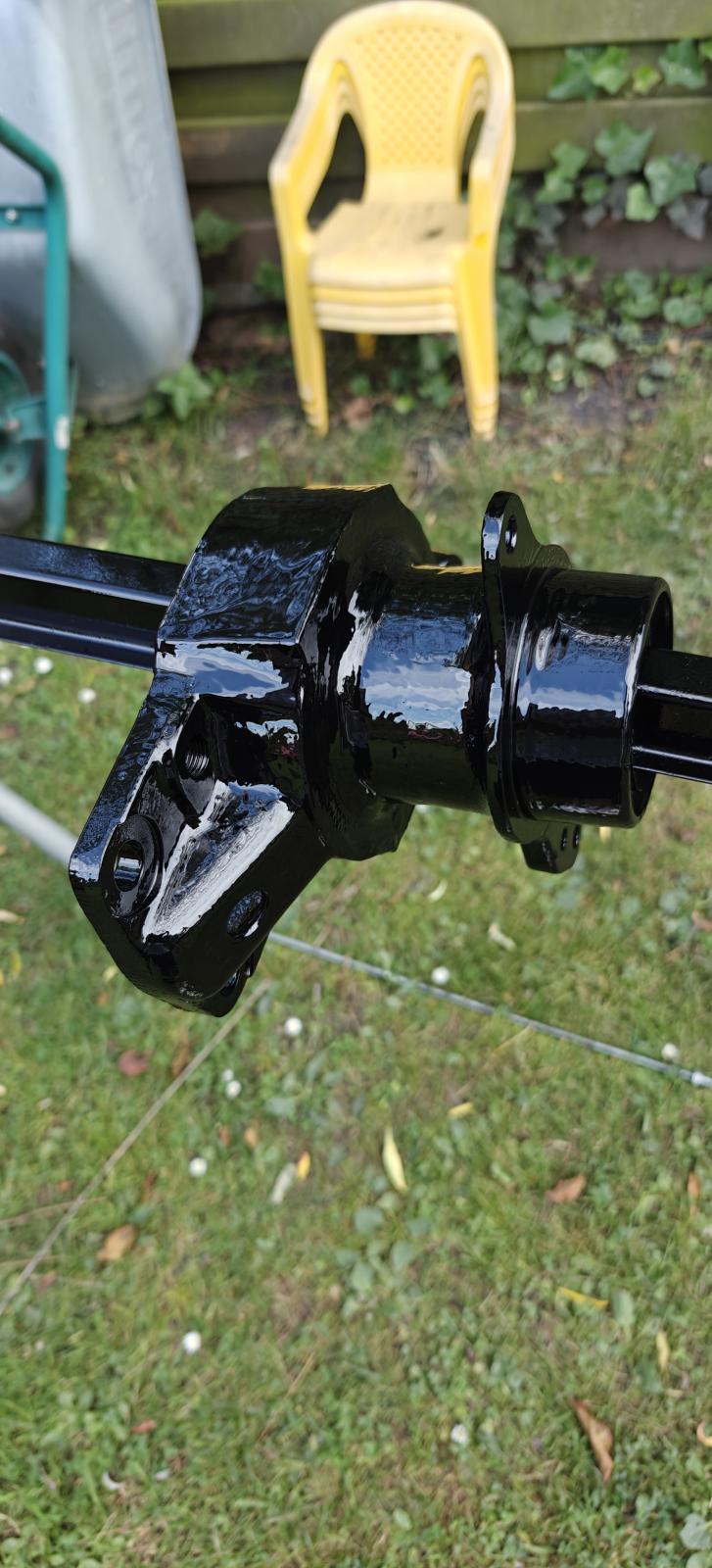

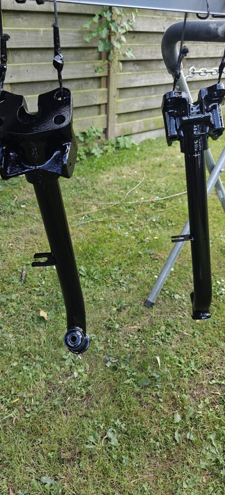

PostPosted: Thu Jul 04, 2024 8:00 am    Post subject: Re: 11 window 1966 full resto Reply with quote
Sanblasted all of the IRS parts and relocated the brake line bracket on the control arm so it doesn't get in the way of the frame horn..
Primed everything in epoxy and painted it black!
Also made custom brake lines for the new setup.
Next up is pull the bus out of the rotisserie and start building things up!
Keep u updated!

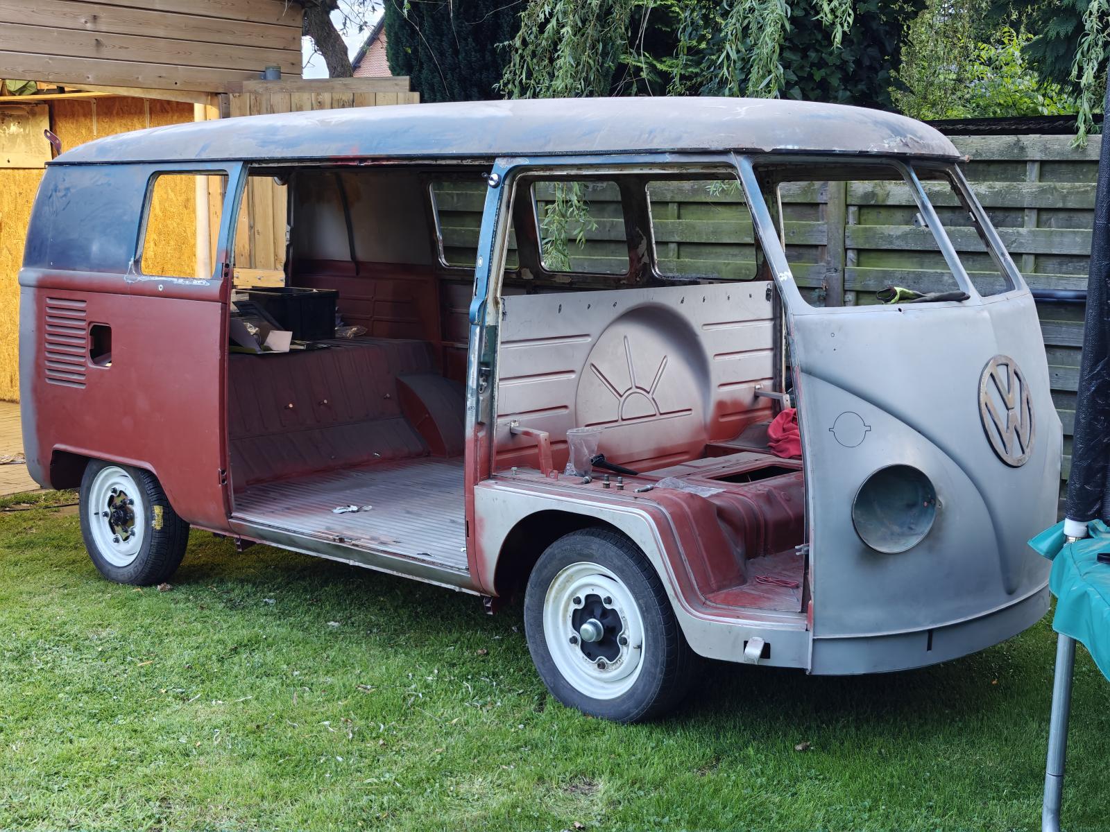

PostPosted: Tue Jul 23, 2024 11:39 am    Post subject: Re: 11 window 1966 full resto Reply with quote
Installed everything and put the bus back on it's wheels.
Sun was shining so pushed it out for some pics!
Its been a while since the bus saw some sunlight!

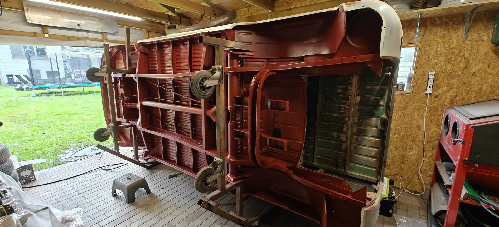

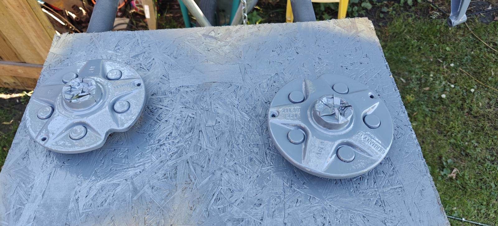

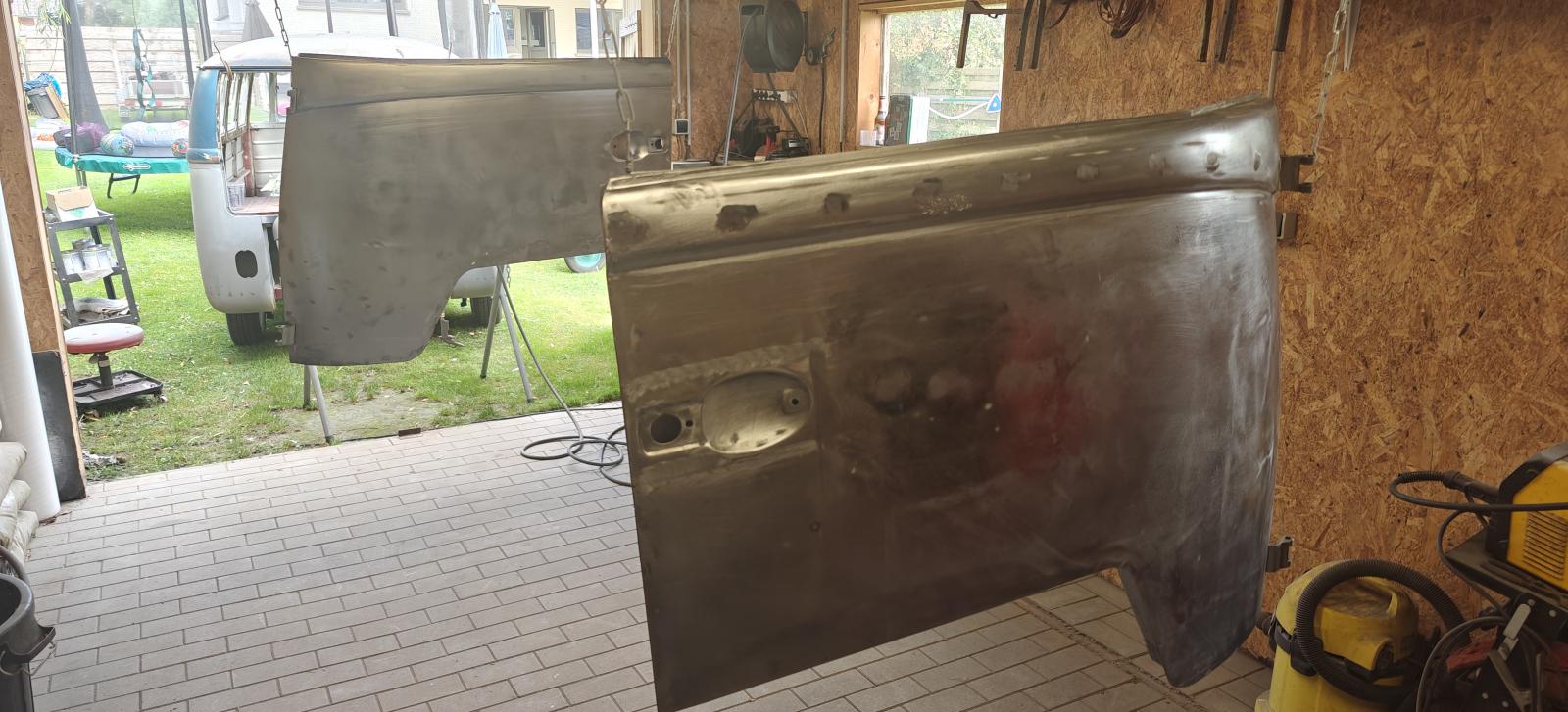

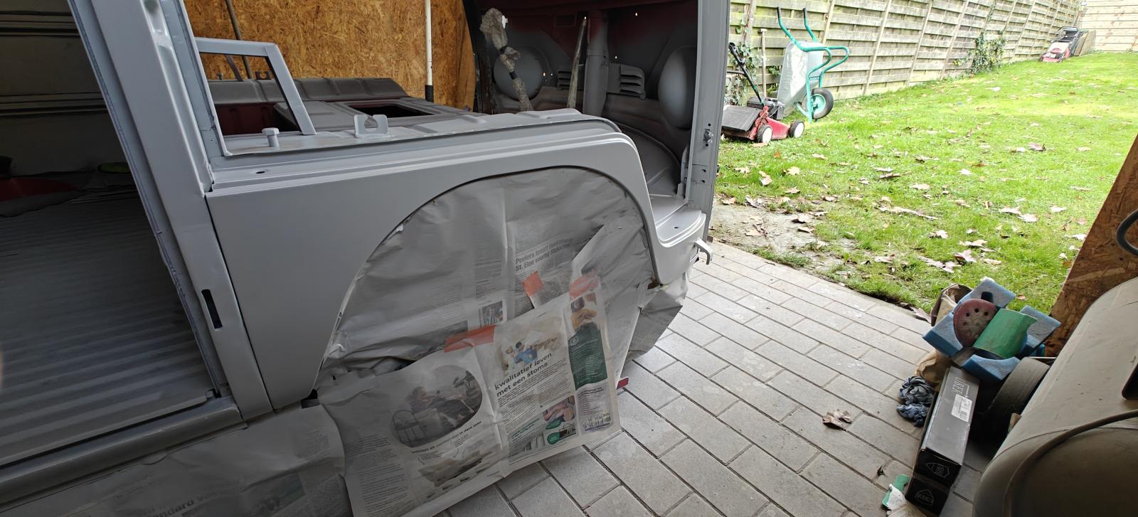

PostPosted: Sun Aug 25, 2024 3:29 am    Post subject: Re: 11 window 1966 full resto Reply with quote
Time for epoxy!
Haven't got a lot of time last months due to kids school vacation and me and my girlfrien working different shifts.
But found some time tonput a couple of doors in epoxy!

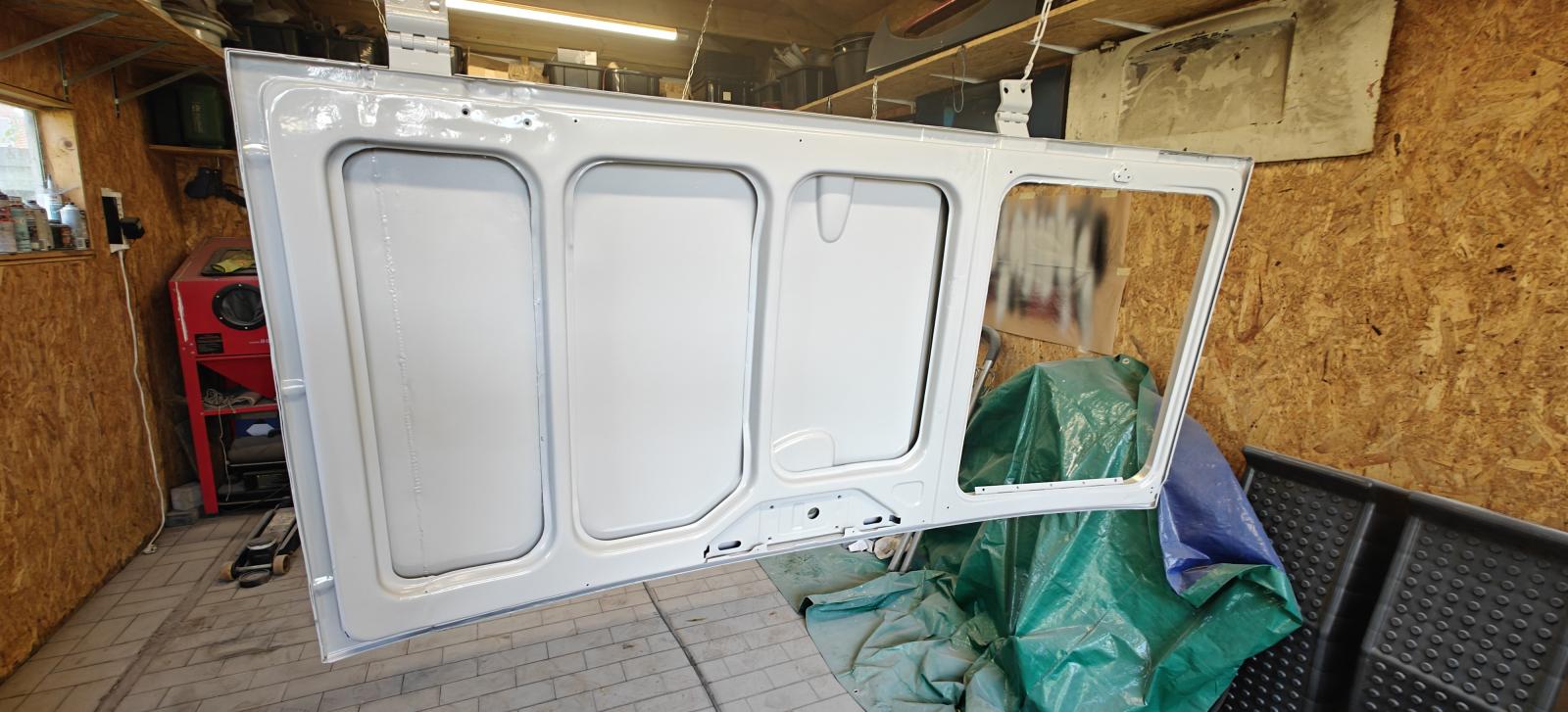

PostPosted: Tue Sep 03, 2024 12:27 pm    Post subject: Re: 11 window 1966 full resto Reply with quote
Some more doors and stuff in epoxy!
i am working my way around the bus because i need to spray the epoxy asap after sanding to bare metal.
We will get there in the end!

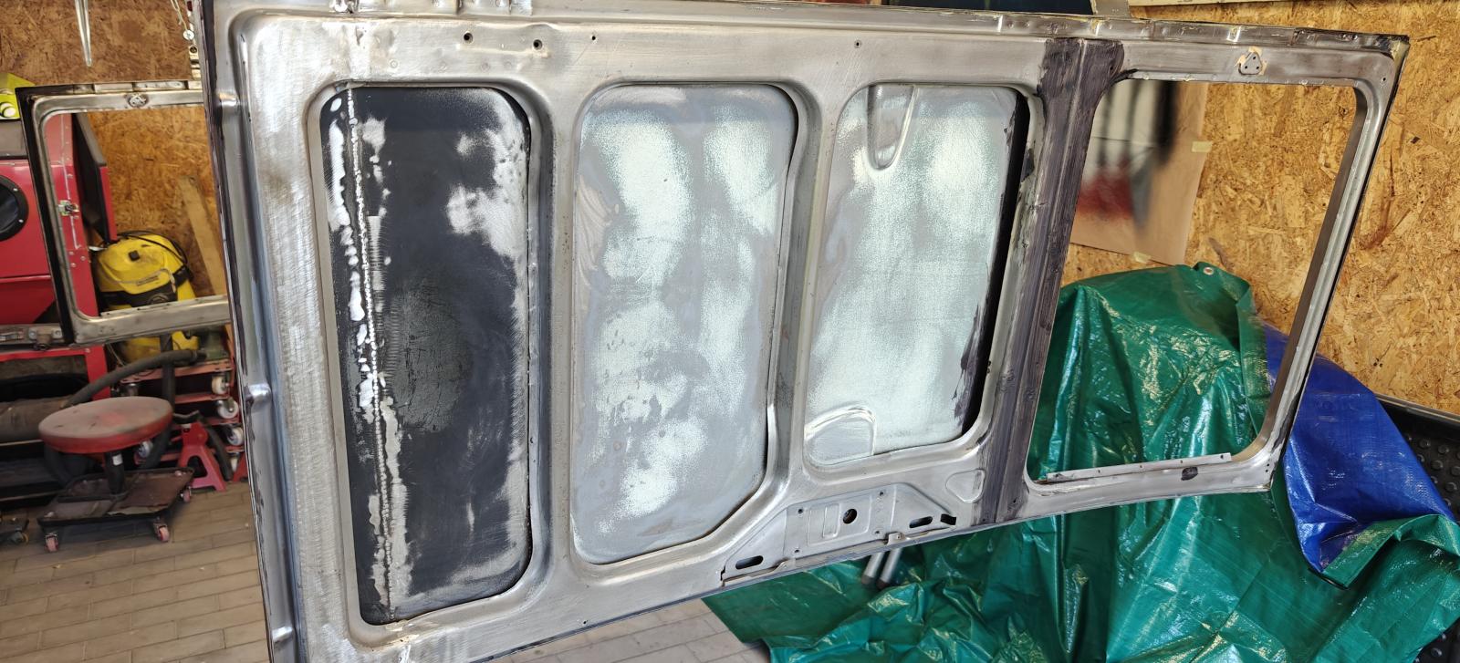

PostPosted: Wed Sep 11, 2024 9:58 pm    Post subject: Re: 11 window 1966 full resto Reply with quote
Long panel and corner also in epoxy,
Hope to do the front and inside before winter!

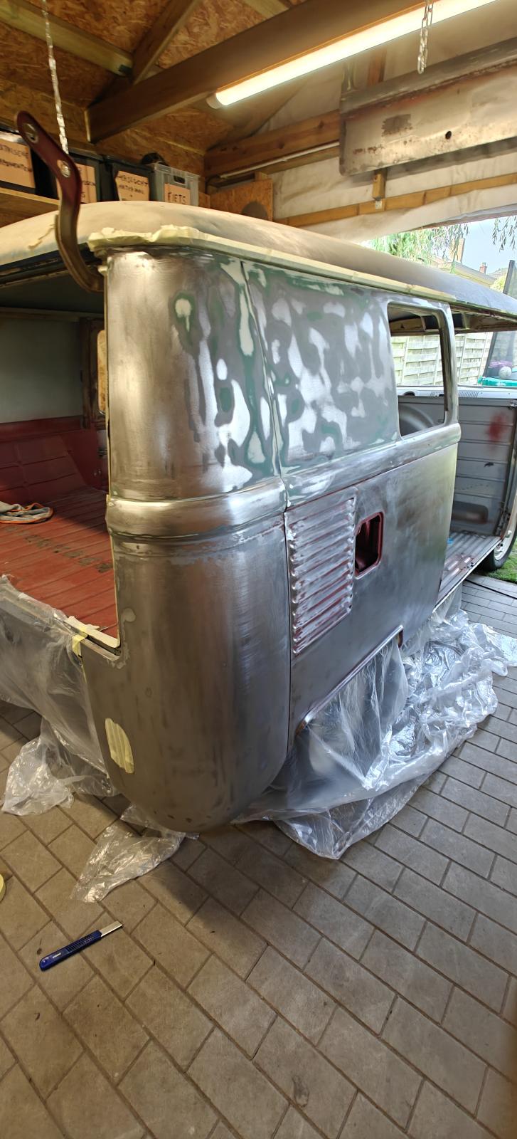

PostPosted: Fri Sep 13, 2024 2:32 am    Post subject: Re: 11 window 1966 full resto Reply with quote
Yeah that's the advantage of needing a lot of new panels..
And that is why i decided to panel bond some panels, so it just needs a skim coat of filler to make it straight

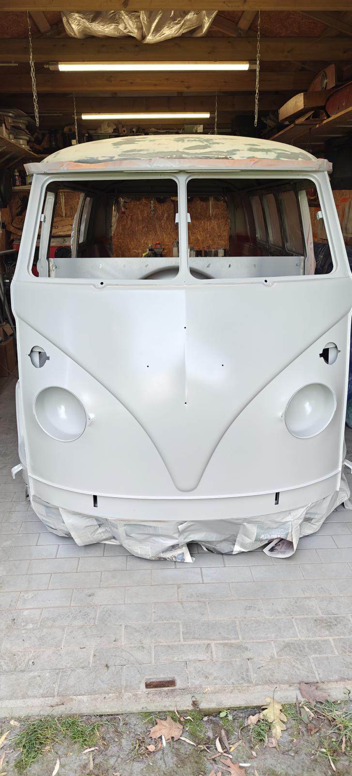

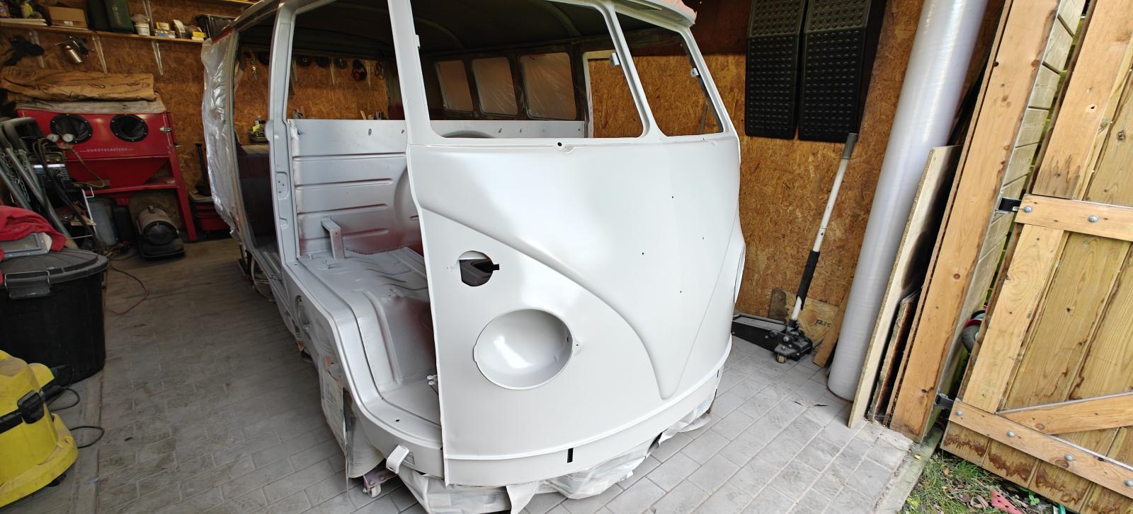

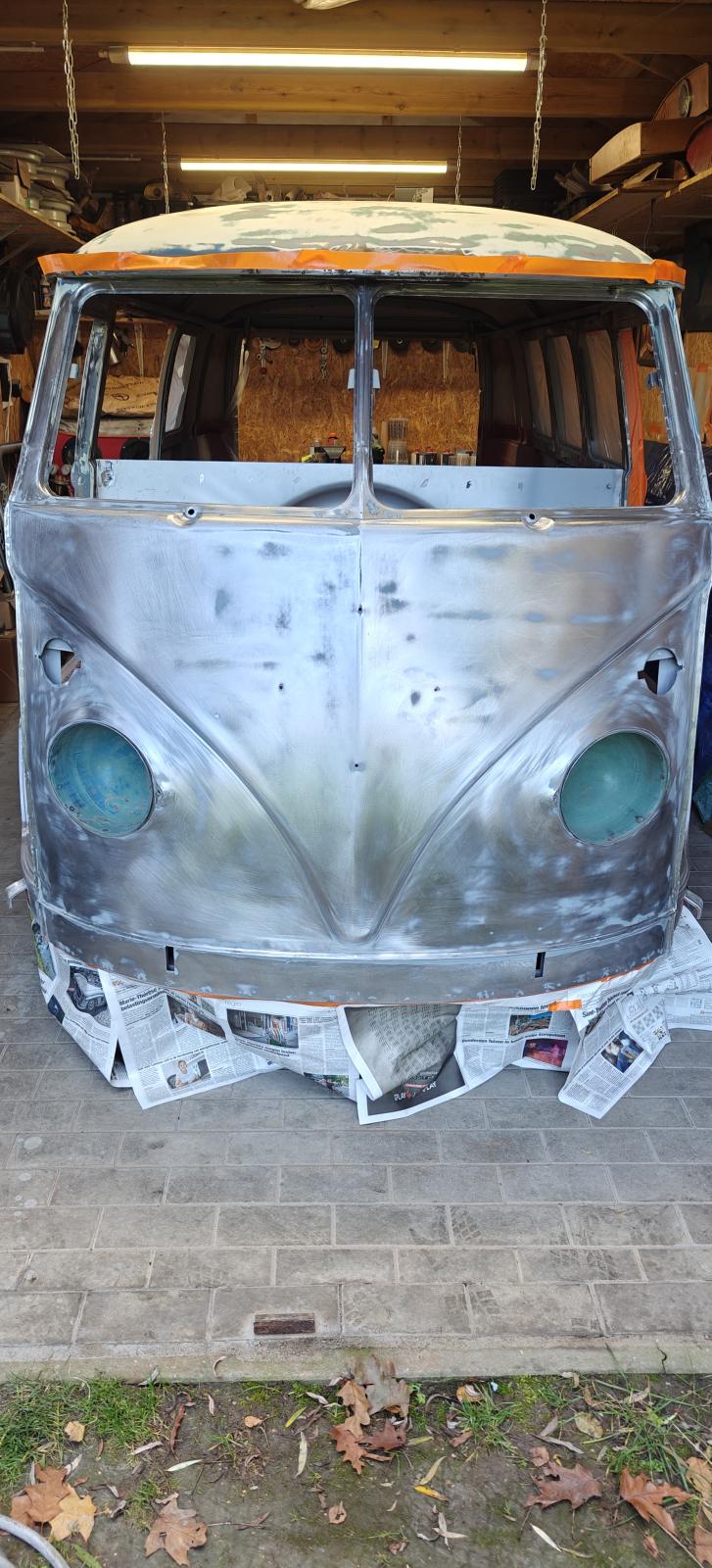

PostPosted: Fri Oct 18, 2024 7:18 am    Post subject: Re: 11 window 1966 full resto Reply with quote
Front end also in epoxy and started to put all doors back on!
Crazy to see the bus in 1 color.. but it looks pretty nice!
