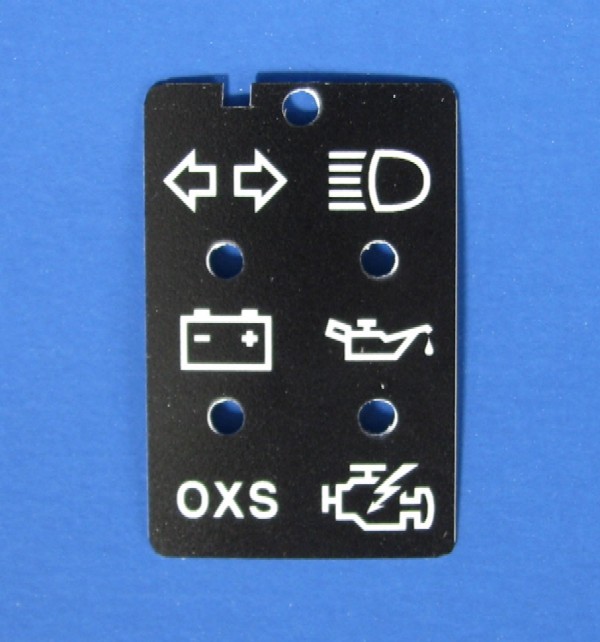

PostPosted: Thu Jan 17, 2008 2:27 pm    Post subject: Check Engine Light for the Dash Indicator Panel Reply with quote
Chester, Nice job on the documentation. I had a mechanic do my conversion but have learned a lot from your chronicles here over the past couple days about all that needs to happen.
I'd be happy to send you this or a version of this dash indicator panel for your check engine light at no charge. You have given us all a lot of your heart and soul on this conversion to reference and learn from. Thank you. Just get me you mailing address and I'll get it in the mail.
It is a high quality backlit plastic film and vinyl so the light illuminates the display properly. It looks stock but can be in a white version as well. Other Samba members can contact me for purchase of this insert.
Thanks again - Nice work!

PostPosted: Thu Jan 17, 2008 4:56 pm    Post subject: CEL - MIL picture Reply with quote
Here's the picture:
pmail me Chester if you want me to mail one to you - like I said, I have the check engine indicator in other positions like the unused OXS location or the oil pressure location if you've gone with an additional gauge.

PostPosted: Thu Jan 17, 2008 5:09 pm    Post subject: Reply with quote
Oops - I don't see how to attach a pic! HELP
[/img]
Wow, that's cool. Thanks. I've put a temporary amber l.e.d. on an old VW Golf/Rabbit dashboard piece of plastic and put it over the blank spot at the lower right corner of the dashboard. That's just to get through the upcoming California CARB inspection and then I want to go with a more stock look. With an '84 I have the OXY marking at the lower left of the VW l.e.d. cluster. I'd love to have it read CHK ENG to the right of it in the last remaining l.e.d. location. Perhaps an engine outline with the lightening bolt running through the middle of it. I'd like to take you up on your offer but let me first ask the CARB referee what they will allow and that will give me a set of choices.
Very cool and thanks again,
Temporary CHECK ENGINE l.e.d.
I'm going to ask the CARB official what is allowed for this spot
The CARB inspection is scheduled for Friday, January 24, 2008. We shall see.
