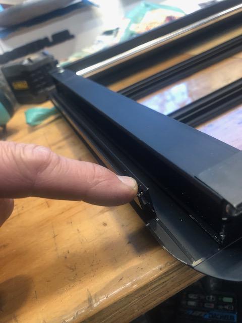

Recieved the windows awhile ago. No charge for shipping from Heritage. Nicely made units. But they are to long to fit my slider window opening! And I took the window out (ruined the seal) already. The openings are indeed different, by one inch.
Looks like they could be made to fit with some trimming.

The jalousie windows you got are for direct drop in into the chassis opening, not into the siding window frame .

PostPosted: Sat Dec 24, 2022 1:03 pm    Post subject: Re: Jalousie (louvered) windows in a Vanagon Reply with quote
The instructions are not at all clear but I think the screws need to line up perfectly into this groove. Before i go any further I am hoping to clarify.

PostPosted: Sat Dec 24, 2022 1:36 pm    Post subject: Re: Jalousie (louvered) windows in a Vanagon Reply with quote
Merry Christmas!
That really looks like a version to attach to a Bay window bus opening. The Vanagon version would not have that screw flange.

I had to mill that extrusion off to use these in our vanagon. I agree they are for the bay bus or a type 2. I’d check with the seller before going further. But in answer to your question, tiny sheetmetal screws secure into the extrusion to retain it to the chassis. I’d be surprised if that extrusion lines up with the vanagon window body seam.
