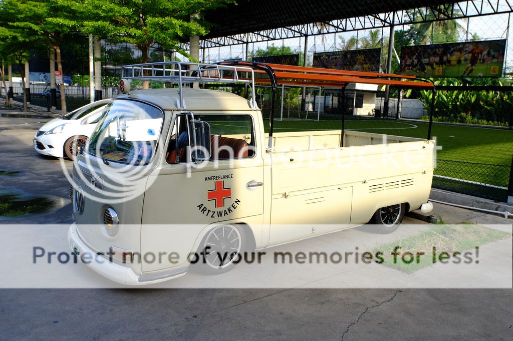

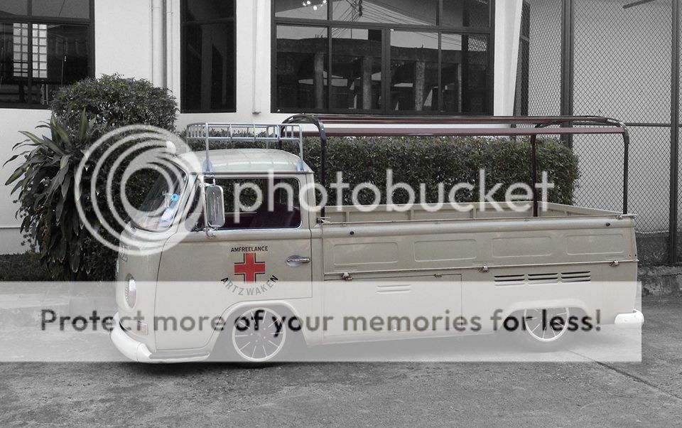

Still running good with 2.5" sideplates clearing from ground.
https://www.facebook.com/artzwaken

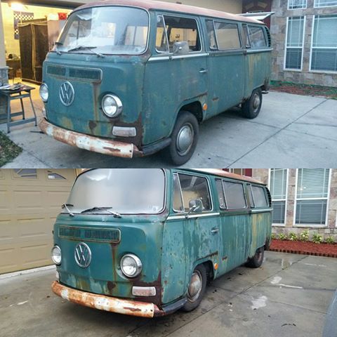

Here is my 69. I just installed a 4" narrowed beam with adjusters. The spindles are still stock ones. The rear has the stock spring plates but it has a notched frame with air bags. The adjustable plates are coming soon. Tires are also the stock height 195/75/14. But big difference on the before and after picture.
