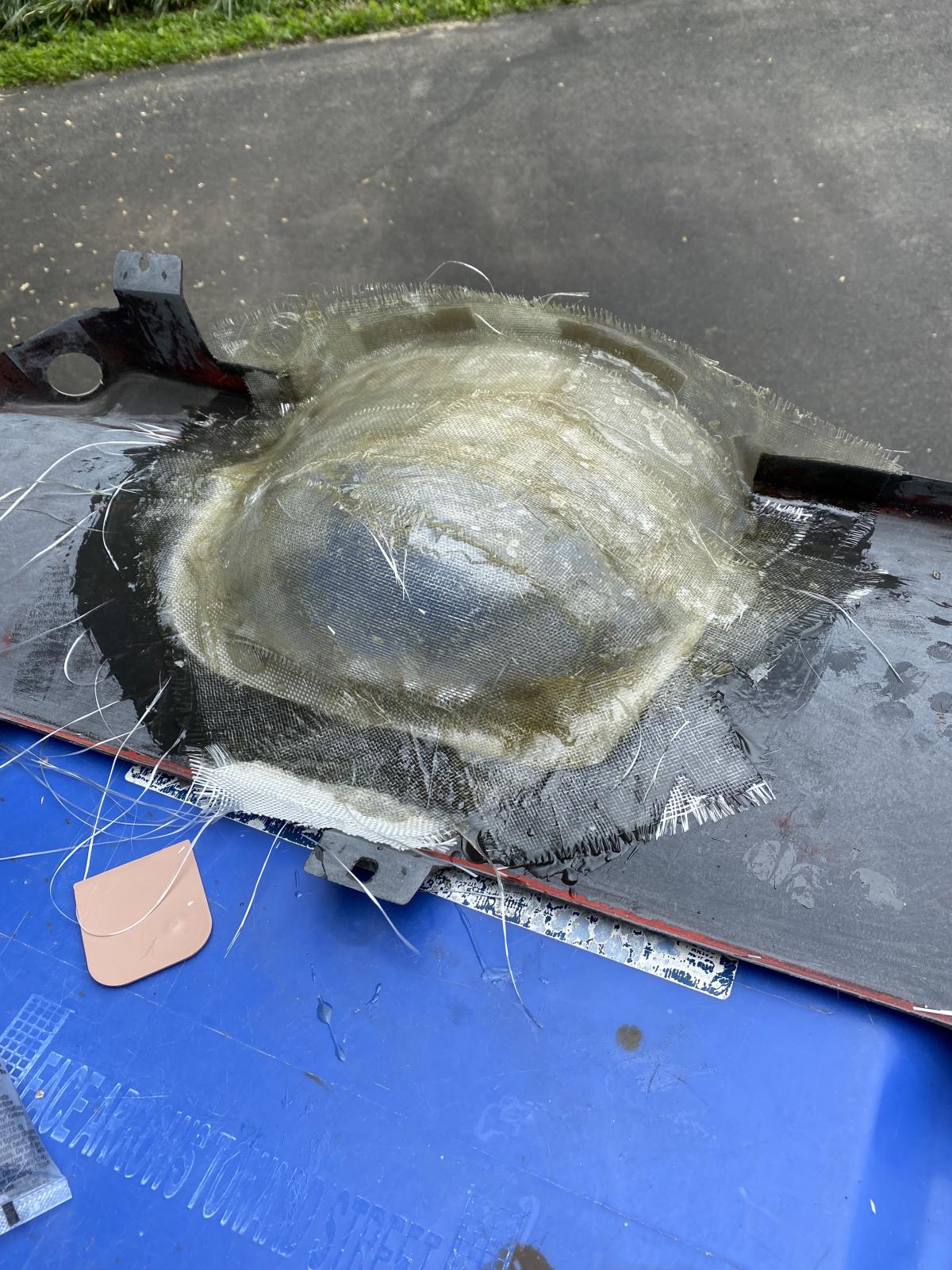

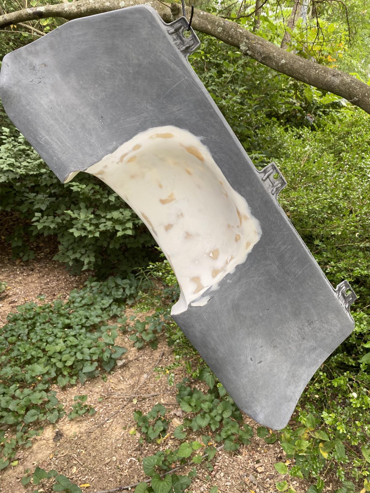

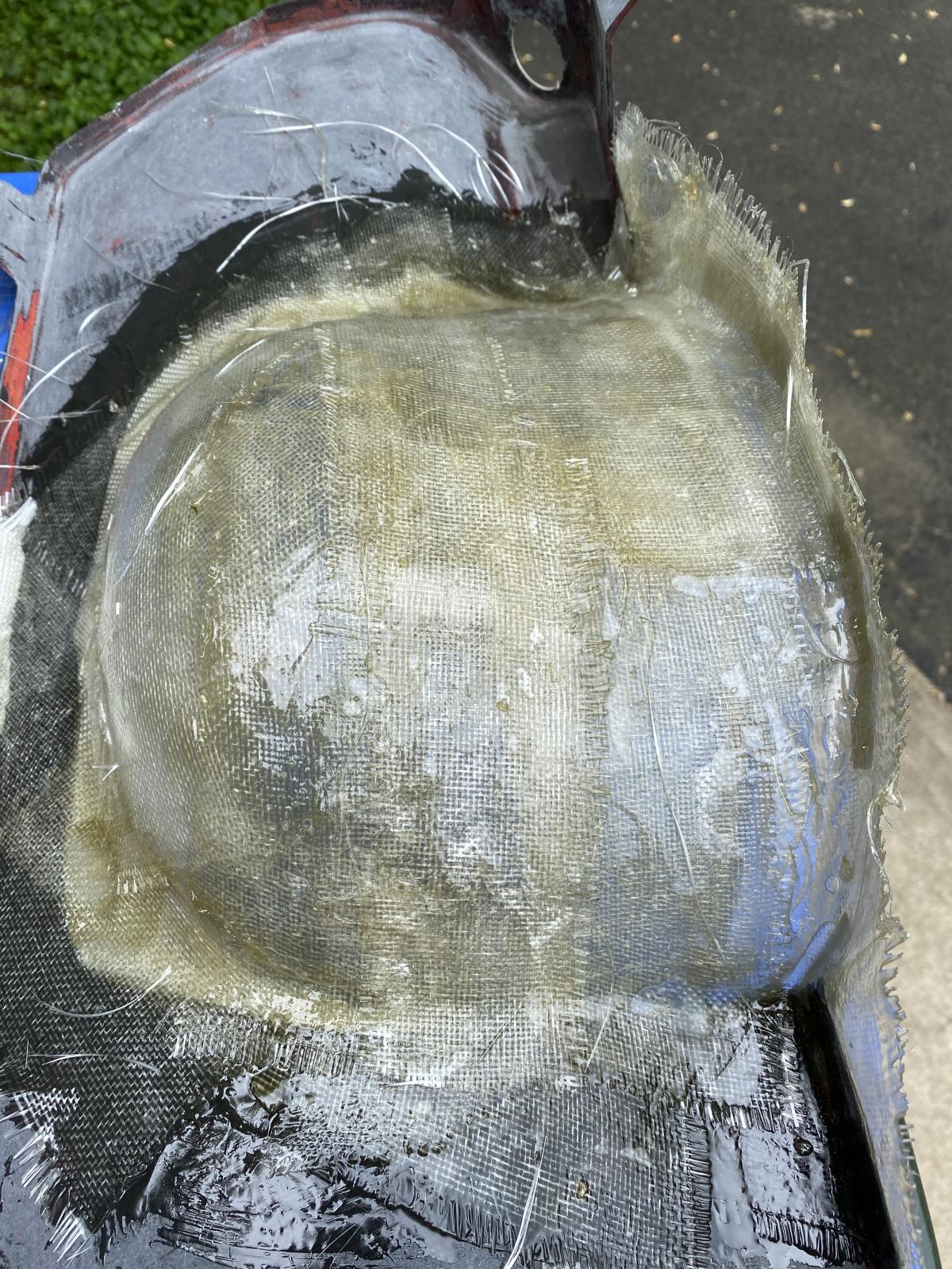

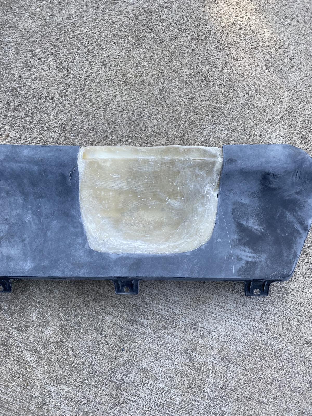

Been a while since I have posted, but have done a lot between work travel. I was a bit concerned about not having a Drain Tray over my engine, and having a Porsche style fan/cooler, obviously the stock tray wouldn't work. I did a search through the Gallery and was inspired by a modification by member alansvwTwinCab. From Gallery
His looks really nice with the carbon fiber design.
Now I just had to figure out how he did that. Since my drain tray was cracked I thought it was worth trying. So I mounted it, made some rough measurements, took out the cutting tool and went to work.
Once I made the cut, I had to figure out what to use for a mold to make some kind of shape. Found one of my wife's plastic plant covers...luckily she hasn't noticed, cut it in half, and attached to the tray.
Busted out the fiberglass, something I haven't done for a while, and attempted to mold a shape. Had to do several layers and trimming.
Once it dried after a few days, I did some cutting, sanding, and shaping.
Mounted it to decklid, and it was still hitting the fan shroud.
So more cuts and measurements, mounted, took off, cut, trimmed repeat several times, until I finally was able to get a shape close enough to fit and close the lid without too much damage to tray.
After a bit more trimming, I finally got it to a shape that fit. Sanded the entire tray, bondo fiberglass filler, spot putty, sanded, primer, spot putty, sanded....seeing a pattern here?
After getting it reasonably clean, I sprayed on several layers of primer and finally paint to match the rest of the engine trim.
Mounted it once again, and it came out pretty good. It's tight up against the lid and just touches the shroud, so I think it will actually drain water through the tubes once connected.

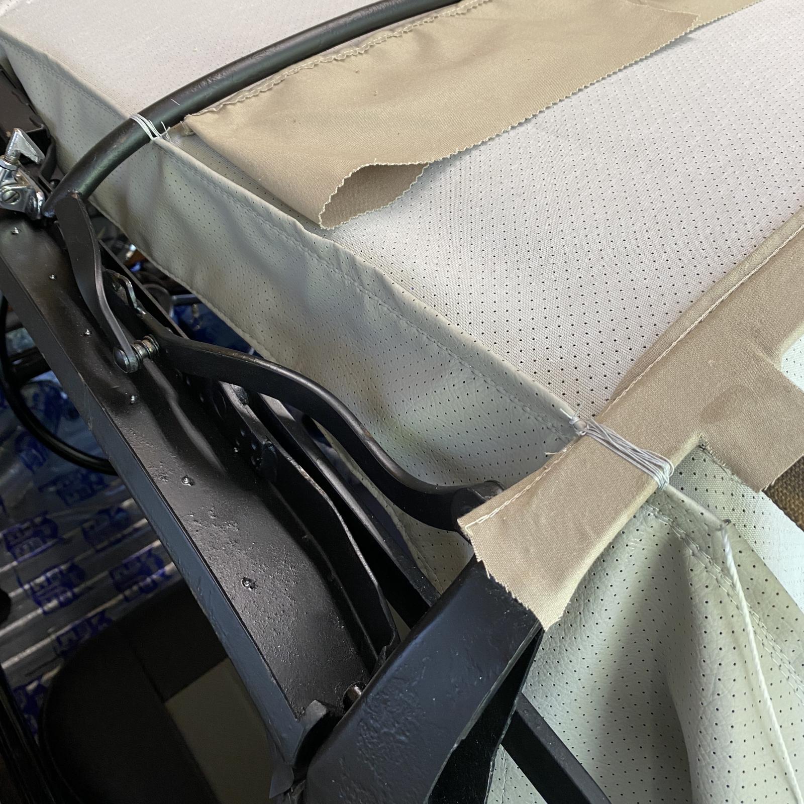

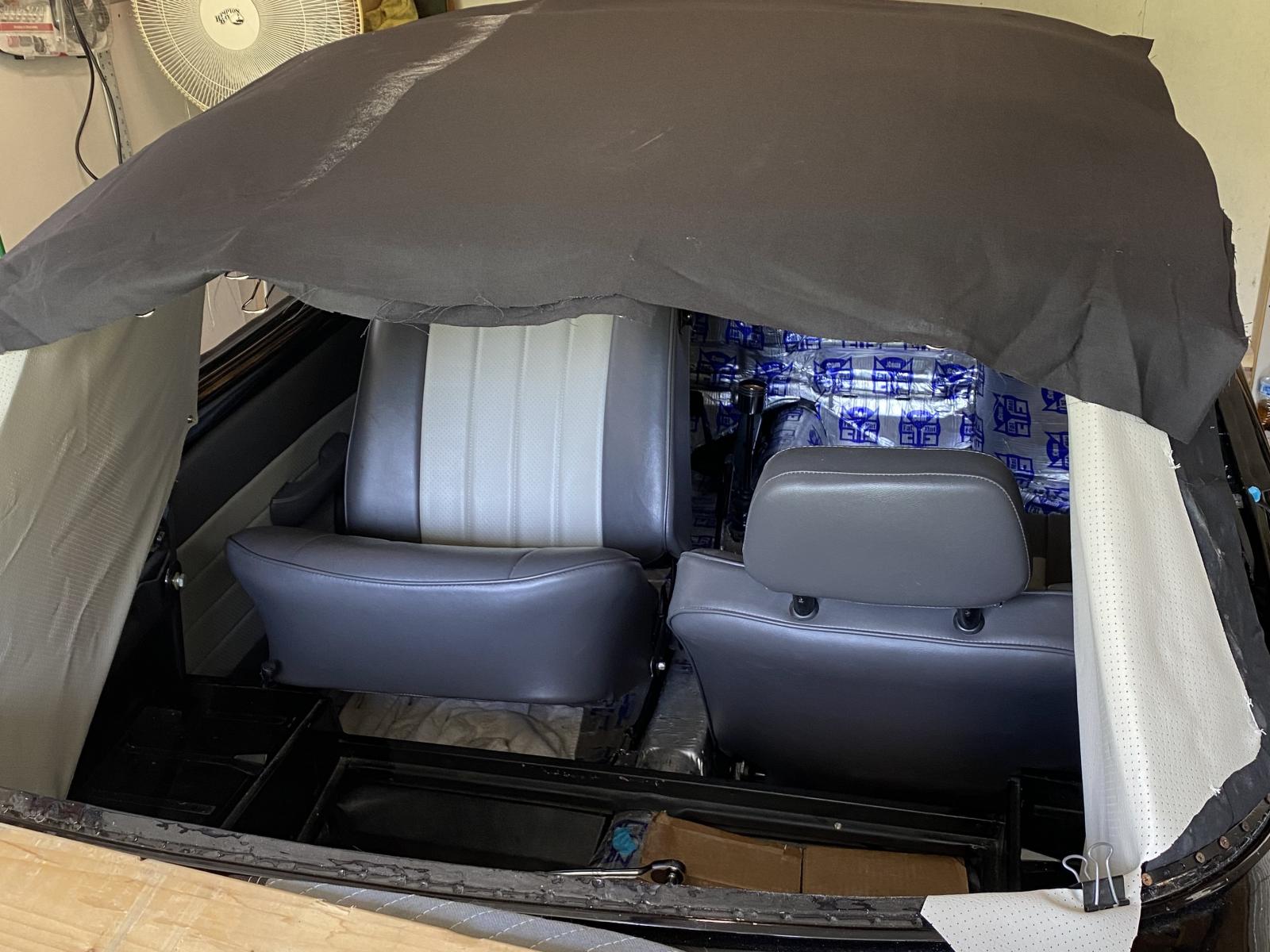

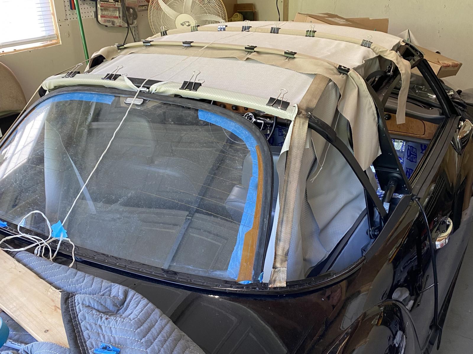

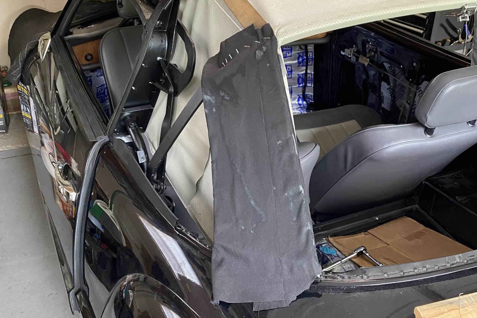

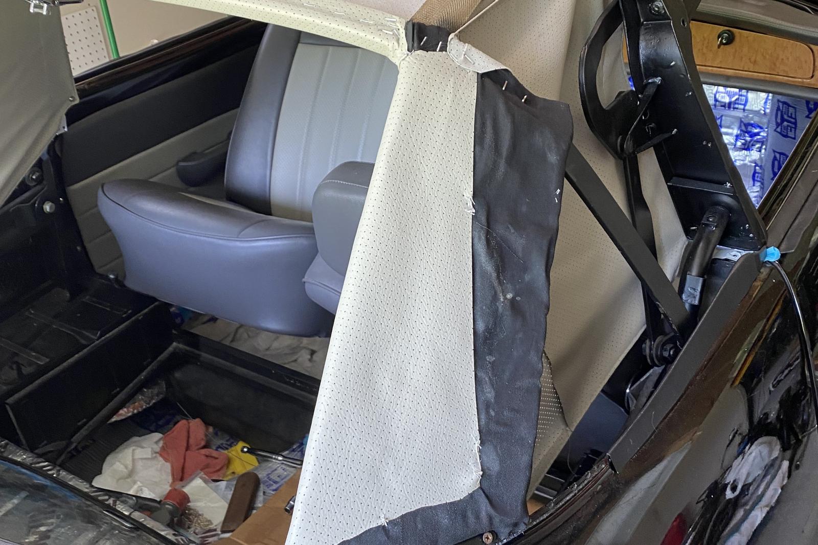

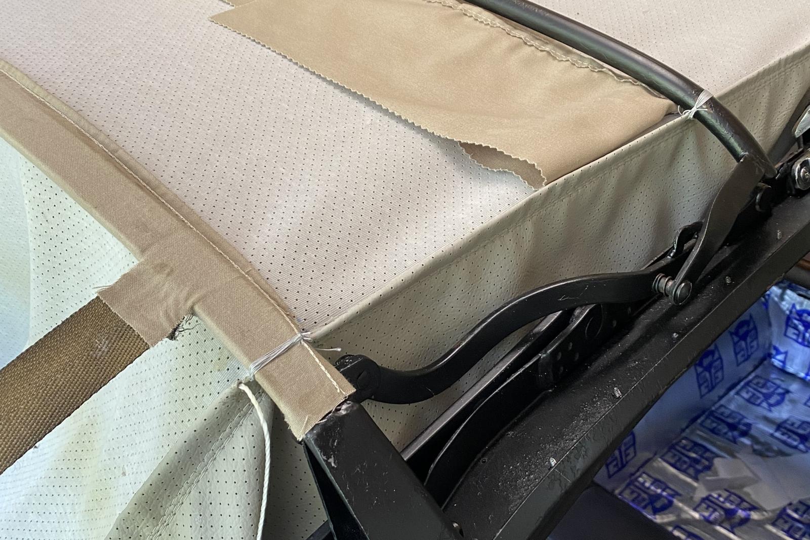

Spent most of last week installing the headliner on my Ghia. Thanks to the step by step instructions in the 'How To' section posted by @Ghiaddict, it made things fairly easy. Except for the heat and humidity I think things went well.
I forgot to take a pic of the elastic bands between the intermediate and tubular bow, I didn't forget to do that!
I started on the top cover a couple days ago and will post pics soon. The top cover has gone fairly well until it came to installing the rear cable, where it definitely takes two people to work it under the lip to pull the material under and lock it in place. My friend John came over to assist...He's the one with the mostly stock 70 Vert I've posted and he has on his thread. Thanks again John!
The question I have for @Ghiaddict I think his name is Vince, or anyone else who has installed a late model convertible top, after tightening the cable down, when I tried to fold the top forward to close, it won't go all the way down, about a foot away, it appears to be too tight at the back.
Question is, do I need to now loosen the rear cable a bit until I can close the top and latch it, then adjust as needed?

Loosen the rear window cable until you can latch it. The top will stretch in time and you can always tighten it later.

Marc, I checked all along the way as I was installing the headliner and had no problem latching the top, checking strap length, frame, and window latch, all worked fine. It wasn't until I skinned it and locked down the rear cable that I couldn't close all the way. I'll run through everything again and see if I can figure it out.
Brau, I haven't connected the rear window cables yet, just the cable that holds the outside rear of the top into the slot. We really tightened the cable tight to lock in the material underneath, so I am thinking I need to back it out a bit. Maybe that's the cable you meant?
Nicholas, sad to hear when any of our people go missing, but yes, his step by step was perfect and I had little problem finding anything too problematic.
Obus, It has been hot and steamy here in Virginia, so today I will let it sit in the sun for a bit to give the top a bit of stretch before I go at it again.

Yes you could loosen it a bit, see if you can get it too latch but from my experience they all are super tight. What I do is run the hooks out as far as possible and push the top down until I can get them to grab the receiver. Then I wait a while and run the hooks in a bit and grab the receiver. I do a bit at a time until I can actually get it to latch. Do it on a hot day in the sun is even better. Once it’s latched leave it a while closed.

Finally got the convertible top fitted after numerous adjustments.
I still have a few little things things to tidy up and am sure I will adjust more as the top loosens up a bit, but otherwise it fits pretty well. Some last minute headliner adjustments need to be made after I install the carpet, so that looks to be next on the agenda. Sorry for the dirty look, haven't given her a bath yet, was waiting until the top was on.
Also got my Vintage 1971 Virginia license plates registered, so hopefully on the road soon. Unlike Marc in Vermont, my Vintage tags don't require a safety inspection! Very Happy
Another step closer!!
