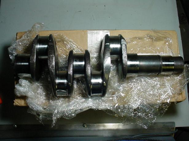

Another nice stroker crank from Jose at DPR. 72mm, 36hp rod journals. Made from a cherry std/std 36hp crank. 8 doweled, hardened, and balanced.

any reason to NOT counterweight?
