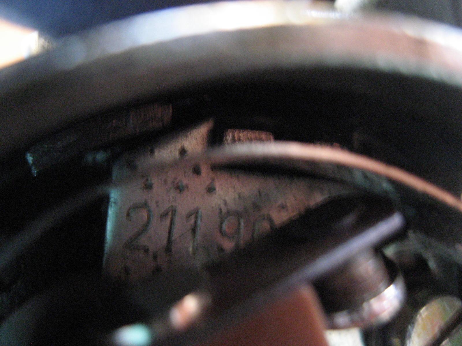

I'm posting these for the Gurus to tell me if any are rare unique or oddball or worth keeping or using.
211 905 205B
211 905 227B

211 B is a Garbe Lahmeyer distributor for infrequent Beetle, Bus, Type III not rare

My numbers I listed are stamped on the points plates.

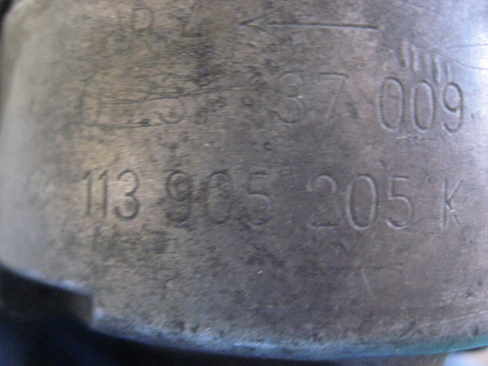

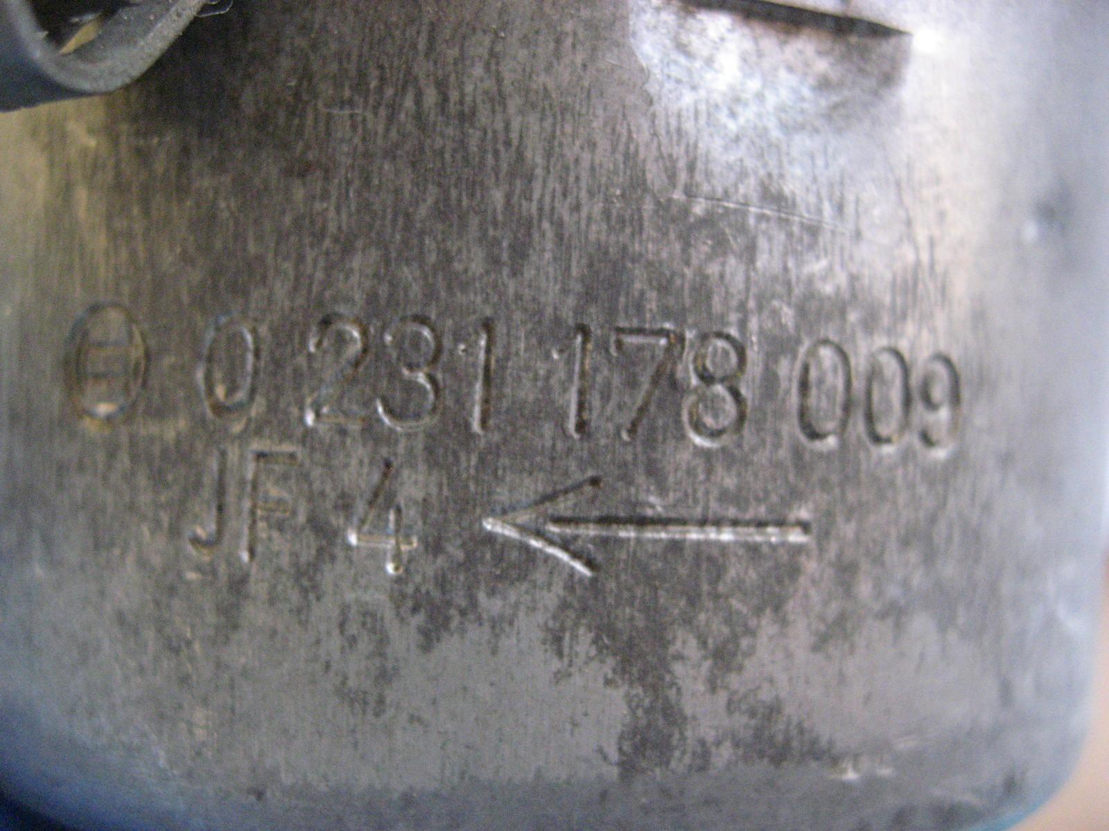

Also, tasb, are any of the photos I posted that end in 009 the "009" that VW people refer to when they brag about having an 009?
tasb
The Distributor Distributor
Joined: April 27, 2002
Posts: 6871
Location: Pentwater, Michigan
tasb is offline
PostPosted: Sat May 17, 2025 7:34 pm    Post subject: Re: Rare Unique and Oddball stock ignition distributors Reply with quote
You have three pics of 009’s. The first is without a vacuum canister. This is THE 009 that is ubiquitous. I would not brag about running one of these. They lack a VW part number just the Bosch and were never factory installed on an engine. The other two are VW# 113 905 205 K’s and should have a vacuum canister on them. Their Bosch part number ends in 009. They were stock on Beetle and Bus 1966-1967.

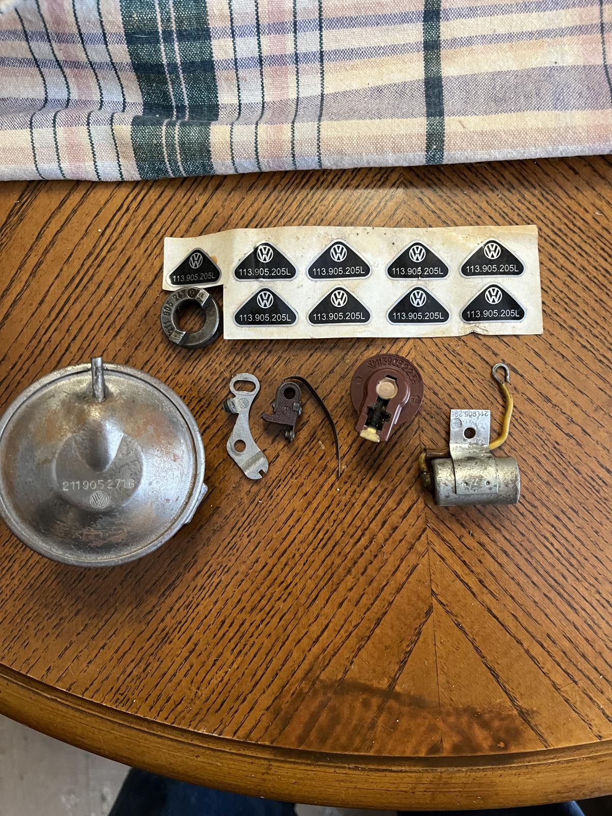

OK using the information from this thread I threw away all the common distributors but I kept one of the Garbe Lahmeyer 211 905 205B.
Tasb Photo:
In the boxes where these marked 111 998 061:
What are the extra parts?
Also, tasb, I did not toss the Mexico body. I am sending it to you for your collection as you requested.

PostPosted: Sun May 18, 2025 1:26 pm    Post subject: Re: Rare Unique and Oddball stock ignition distributors Reply with quote
Wait, you just tossed them? I forgot to comment above, those centrifugal 009s you depicted, there were two of them, one with JF 4 below the part number and another with Z 42 there. Those were German made 009s, which are generally more desirable than the later ones made in Brazil. (Brazil made ones have JF 4 above the part number)
