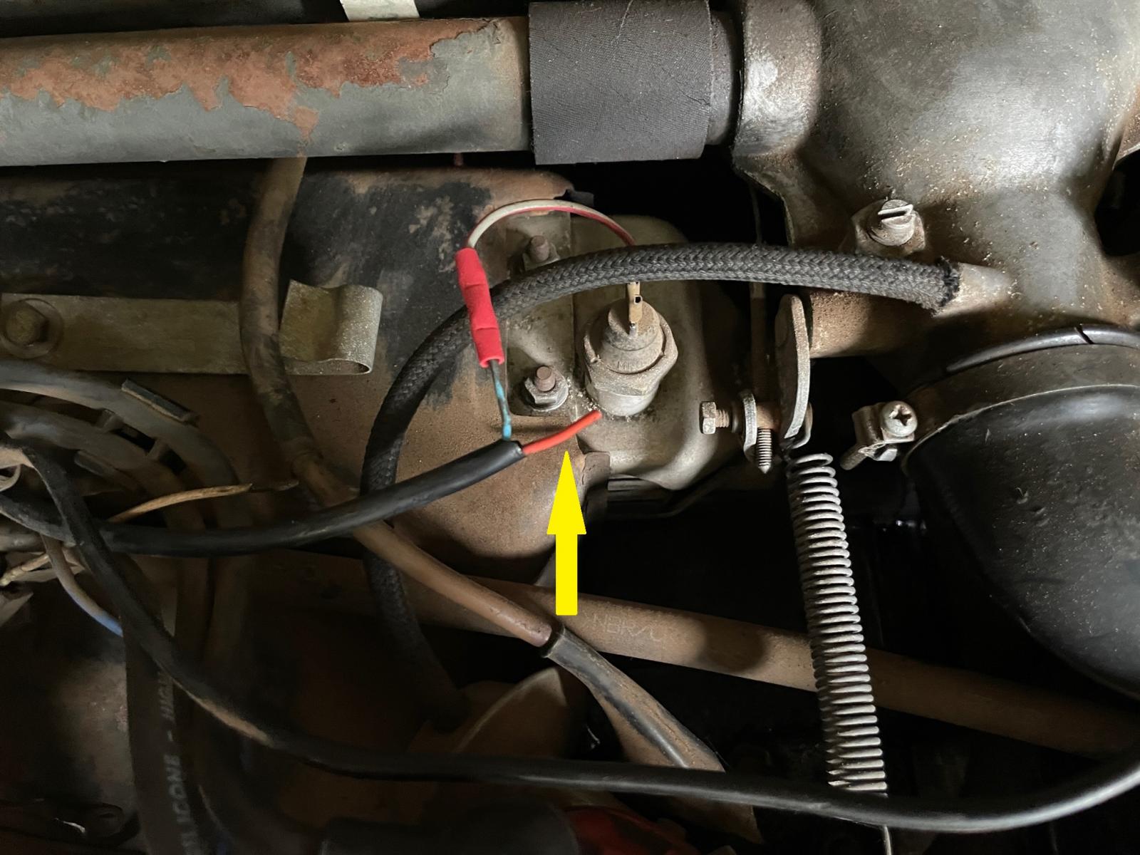

KTPhil Premium Member
Joined: April 06, 2006
Posts: 35668
Location: Conejo Valley, CA
KTPhil is offline
PostPosted: Thu May 11, 2023 8:22 am    Post subject: Re: Fuel injection relief here! Reply with quote
Clipped wire at rear:

desmato
Joined: January 03, 2016
Posts: 56
Location: Michigan, USA, Earth, Milkyway, Universe,... Bottom of some being's shoe !
desmato is offline
PostPosted: Tue May 16, 2023 10:15 am    Post subject: Re: Fuel injection relief here! Reply with quote
KT... funny as Mine looks exactly like yours. I do like the idea of that wire for the tach.
