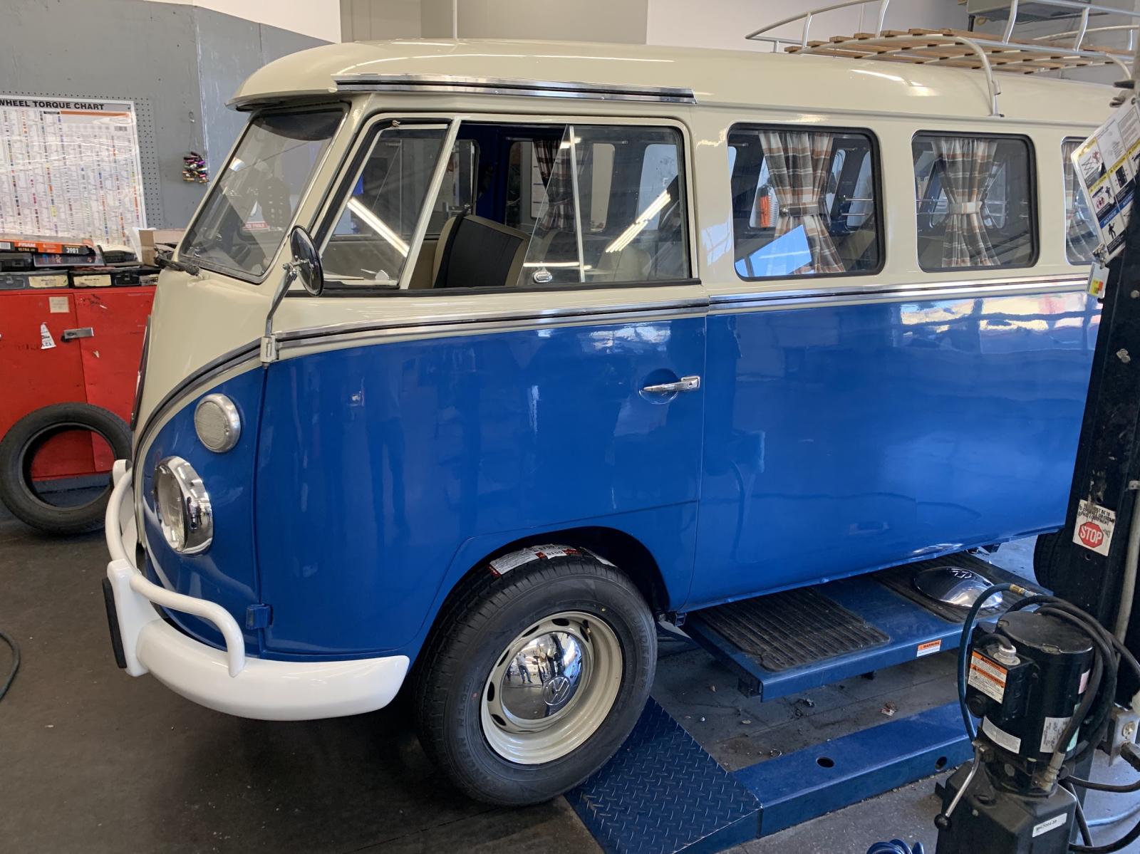

The thunderer ranger 195R15 did not want to clear the factory front wheel arch at full lock left on the driver's side of my imported brazilian 15 window split front end. I really wanted to run these due to the reviews and the larger size but the 195/65R15 currently on there seem to be all that will fit. They also have an 86 load index and feel unsafe at any speed.
Is it possible that this bus is lowered or the front suspension is not centered correctly in the wheel arch? I wish I had a photo when it was resting on the suspension with the larger tire on it, the only I have is at full droop with the lift off the ground or the current tires on the ground.

You have beetle wheels with different width and offset from stock bus wheels. That may be at least a part of the clearance problem.
You may also be able to adjust the steering stop so it doesn't turn quite as far when it hits the stop.
You may have broken torsion leaves in the front beam, allowing the front of the bus to sag, as if it were slightly lowered.

That's why I love this site. I had no idea they were beetle wheels installed. I don't see anything broken or out of place so I'll bet that's the issue.

Not saying it is exactly the problem, but it is a place to start. If you have a shop or enthusiast nearby with bus experience that can look at this in person, it would be worthy of a basic inspection.

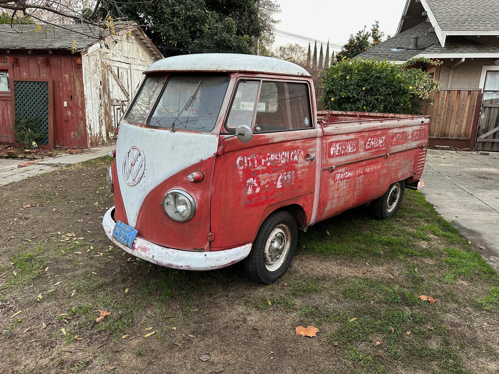

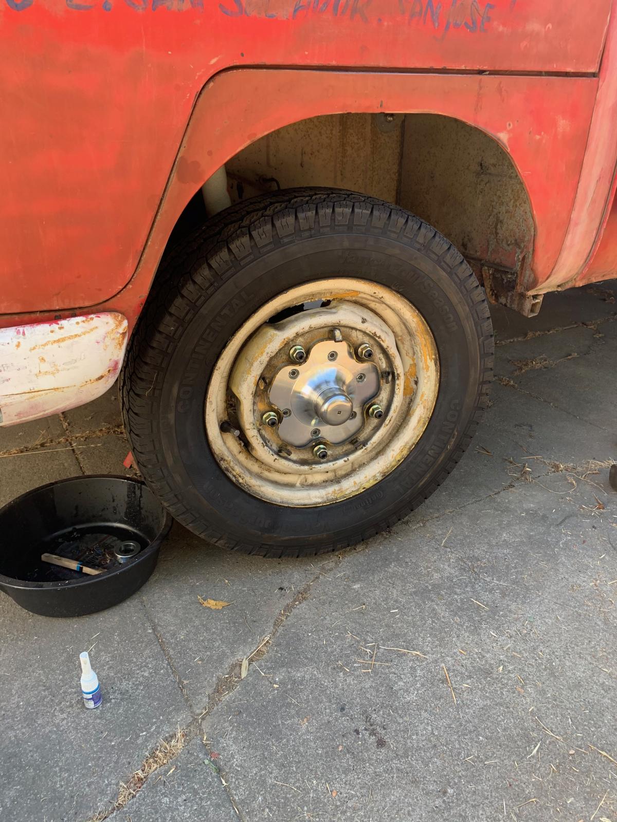

Those wheels seem to have a lot of offset. If you check out my truck, which has 15" bus wheels wearing 195/70-15 Continental VanCos, there is no clearance problem.

Hmmm. I haven’t turned a wheel on these yet. I guess we’ll see. They have to be better than the Pirelli P3 165-15s I used to have on there lol

Back in ‘93 when I put those Pirellis on, I didn’t have the internet to tell me they were a dumb idea. I picked the vancos this time around almost purely on load rating.
The fact that they are literally beetle tires didn't mean anything to you, even back then?
Lol I was a dumbass
