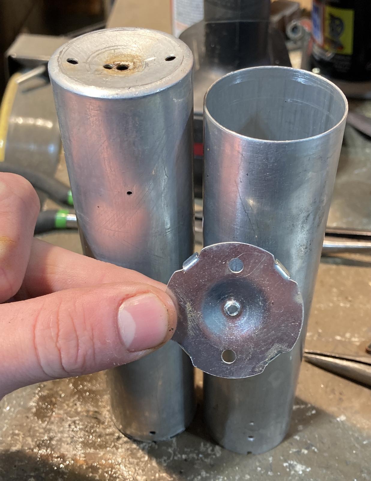

Well, I have a broken one, so you inspired me to get that out. I’m too cheap to not at least give a try at fixing it myself for free Laughing It was stuck and the float didn’t move. It was the one originally in the car. I tried to take it apart but couldn’t get the nut off as the shaft it was on was spinning. So I cut the nut off to get inside. From the shaft spinning it twisted the wire up. I pulled the floats out of both units to compare and stuck them in some fuel. ISP west fuel sender float is floating crooked half sunk Confused I think I have my culprit. The VDO floats perfect.
I did some comparisons on parts. They senders are very similar but all slightly different parts.
You can see the shafts are slightly different with the original having the press marks and the aftermarket uses a nut instead that is not pictured
I put the VDO float on the new sender and it works and actually works in the tank with gas. I think the issue was the new float was sitting half crooked causing it to jam and not go up as well just not floating in general. But now with the VDO float it’s actually reading and the float moves in gas!

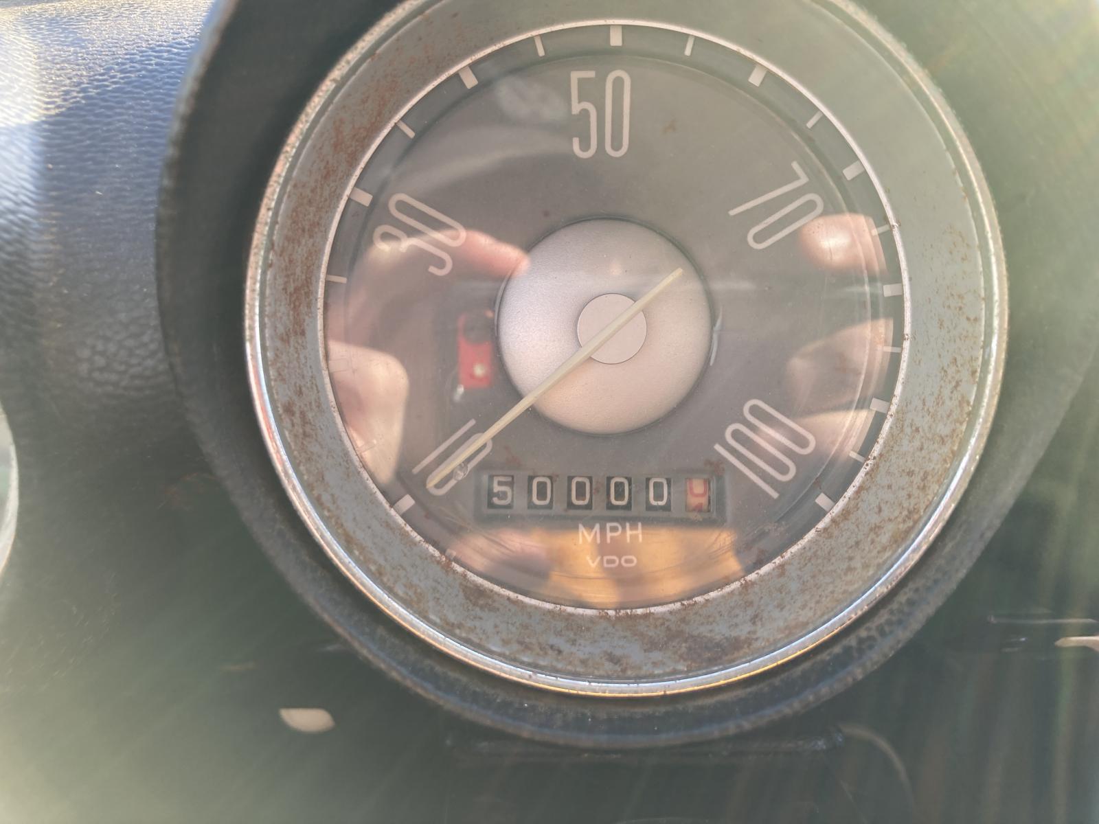

Milestone in this car, it rolled 50,000 miles today Very Happy
Congrats. Cool

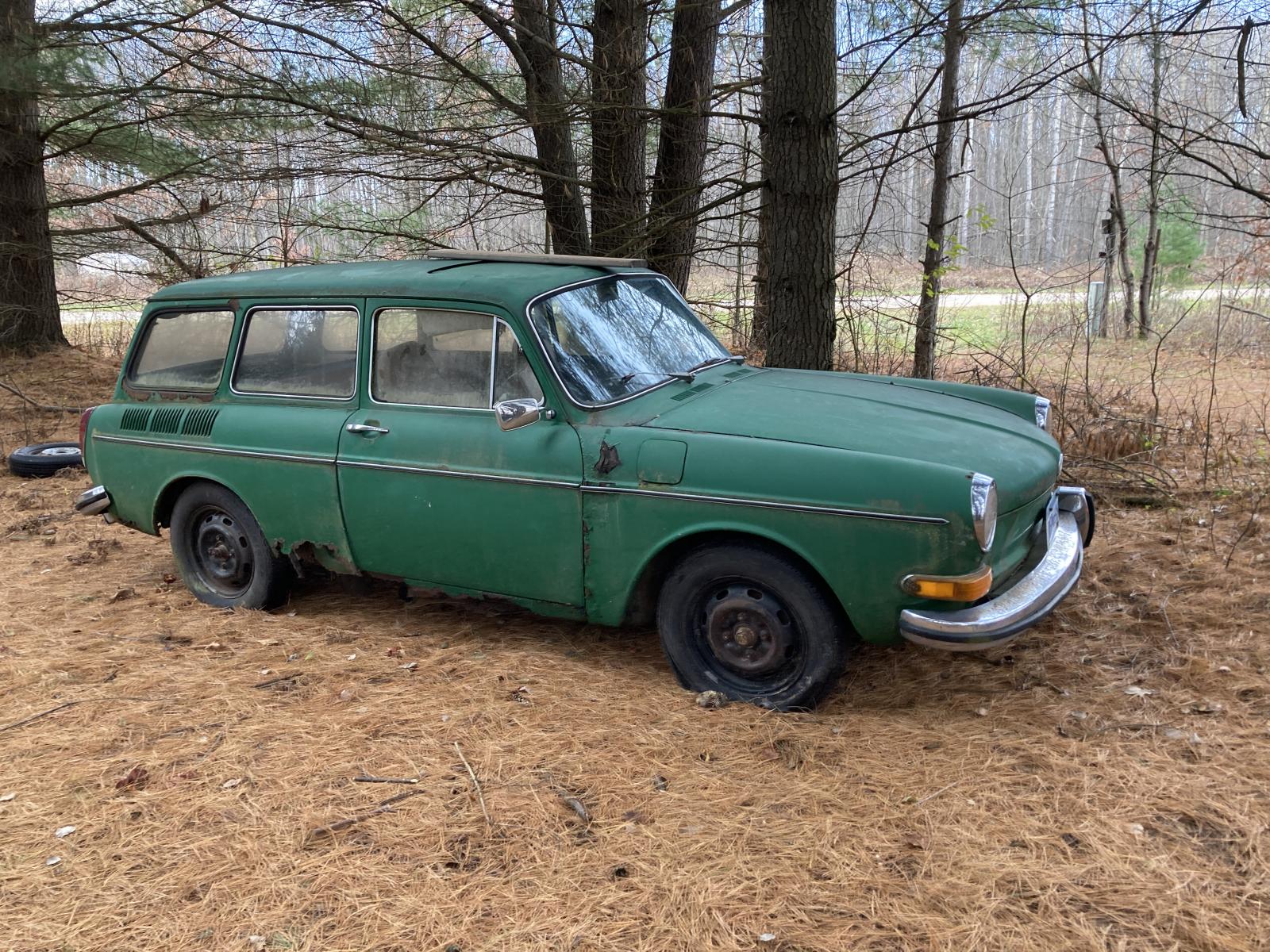

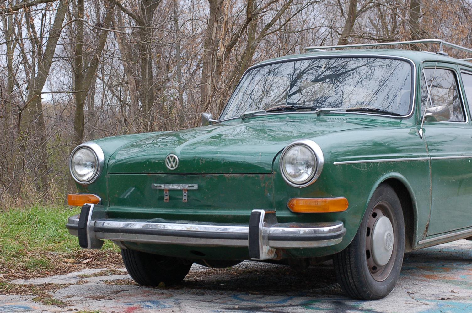

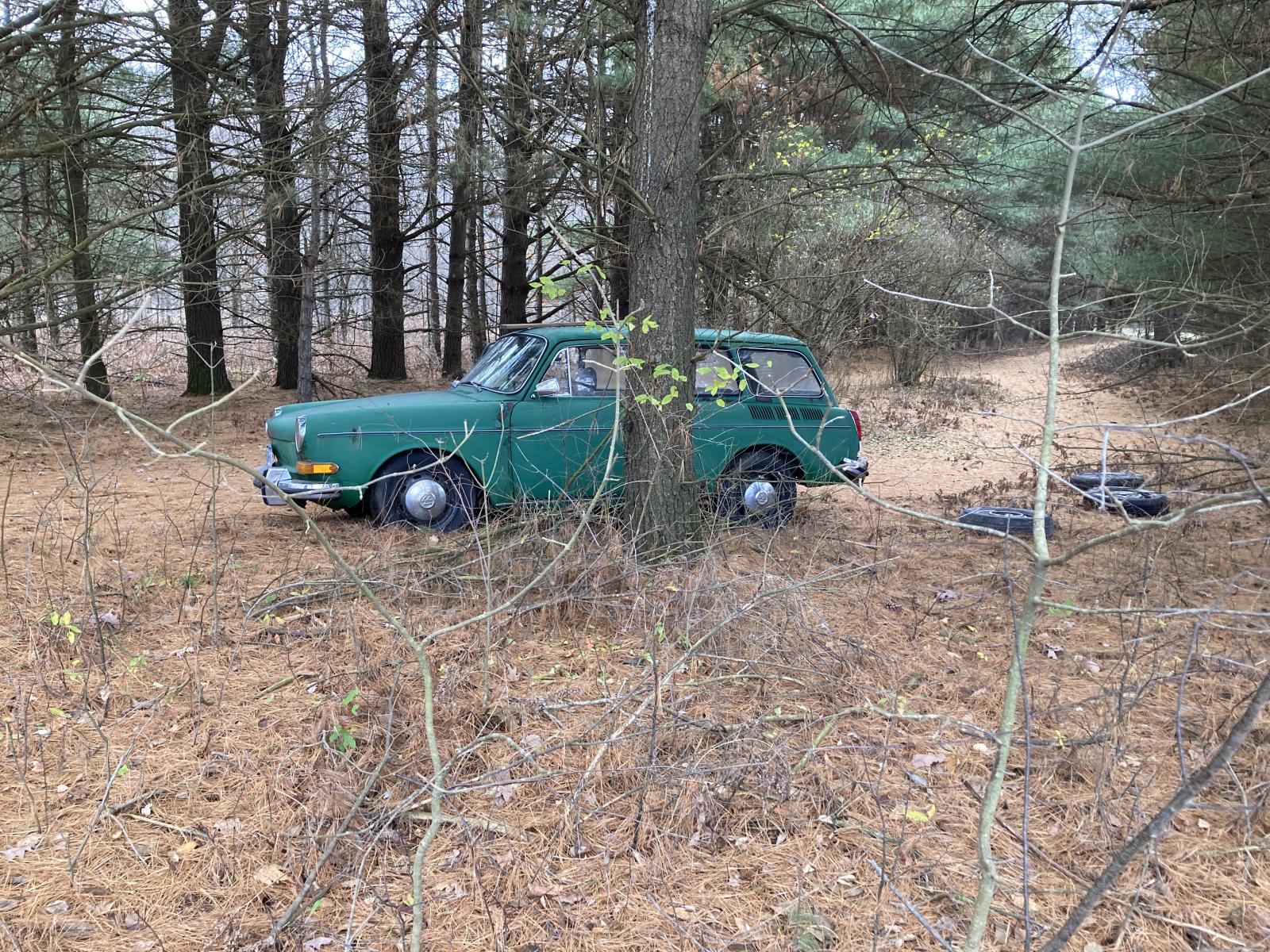

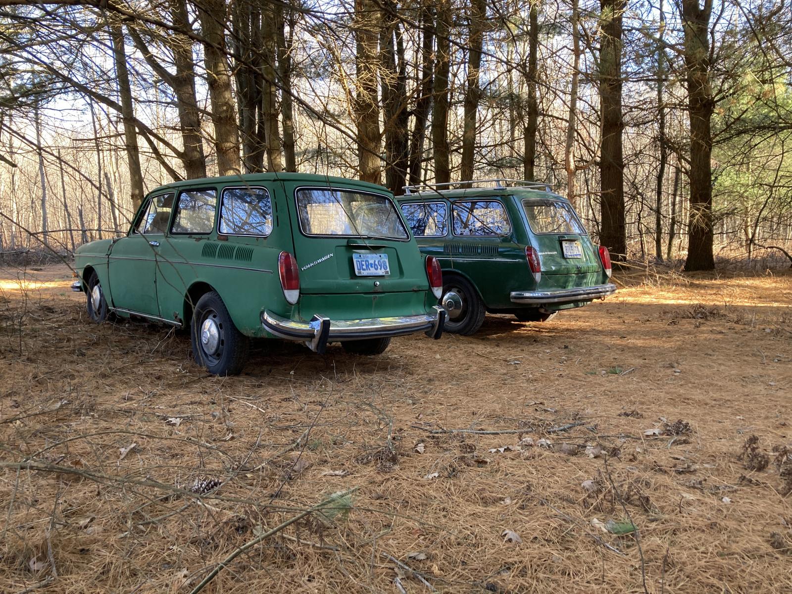

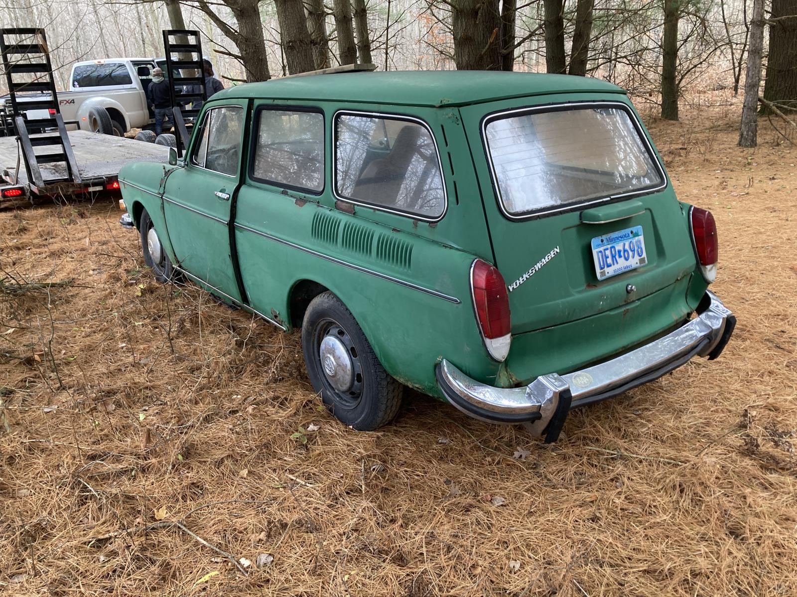

Uh oh, something following home today…

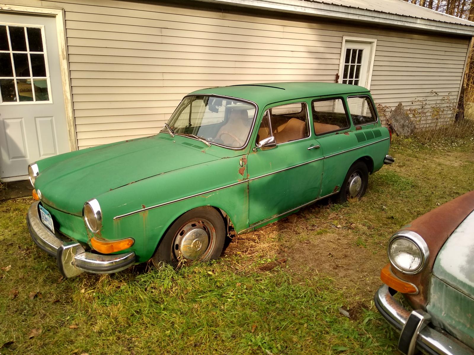

that isn’t Joann though Laughing I got a 1971 green Squareback, manual trans sunroof, title, pretty rotted out but some good parts.
That was trip one, now headed back for round two. My friends getting the other 1971
$450 for them all
“Rome” 91 Syncro

You need to be looking for a ghia or type 34 to fill out the herd. 😁

Hey Aiden, Are those the Two Type 3's from Reed, Mi ?
Glad to see you got them.
Yep! Thanks for the lead! About to get there to pick up the next one
“Rome” 91 Syncro

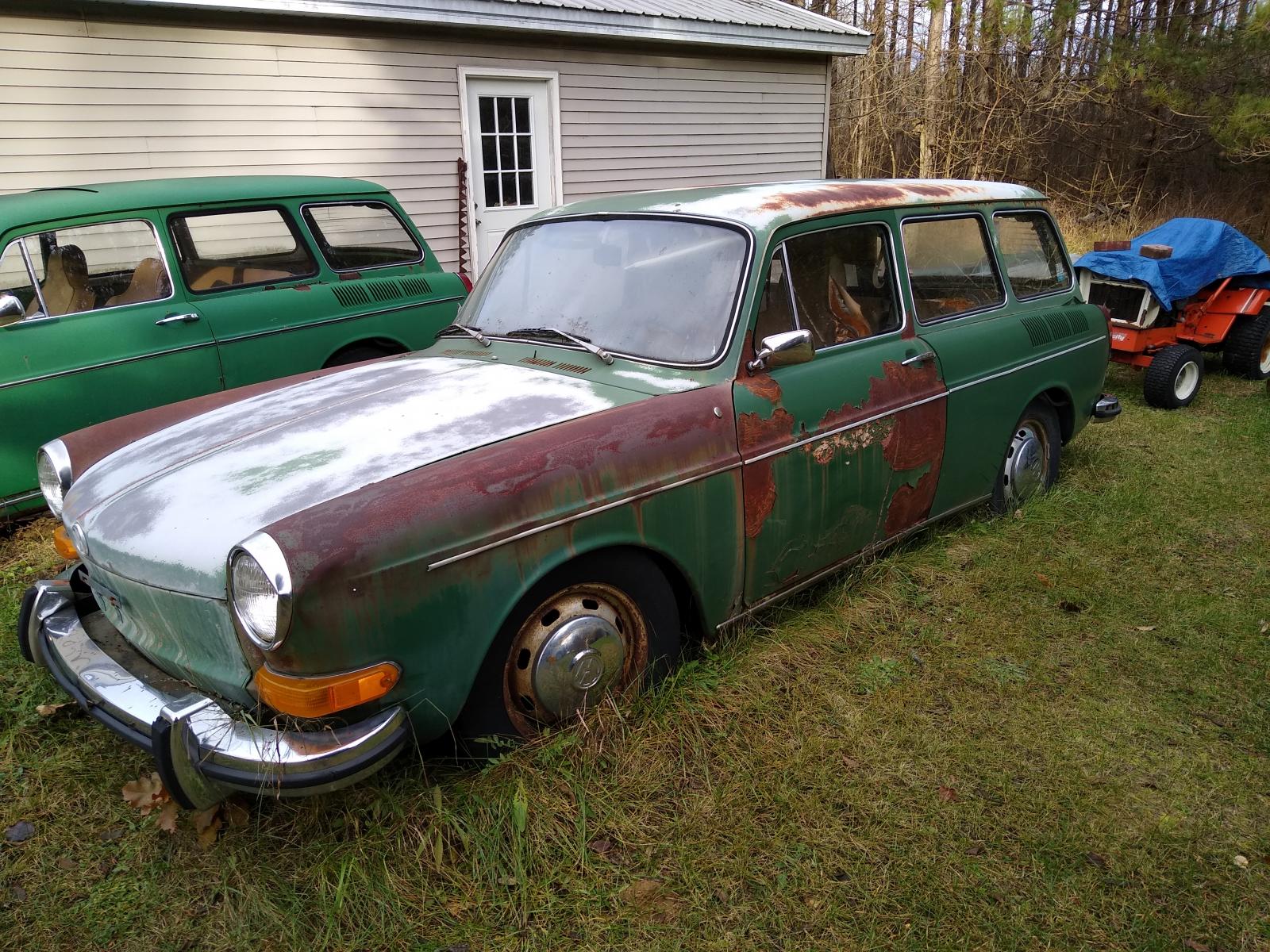

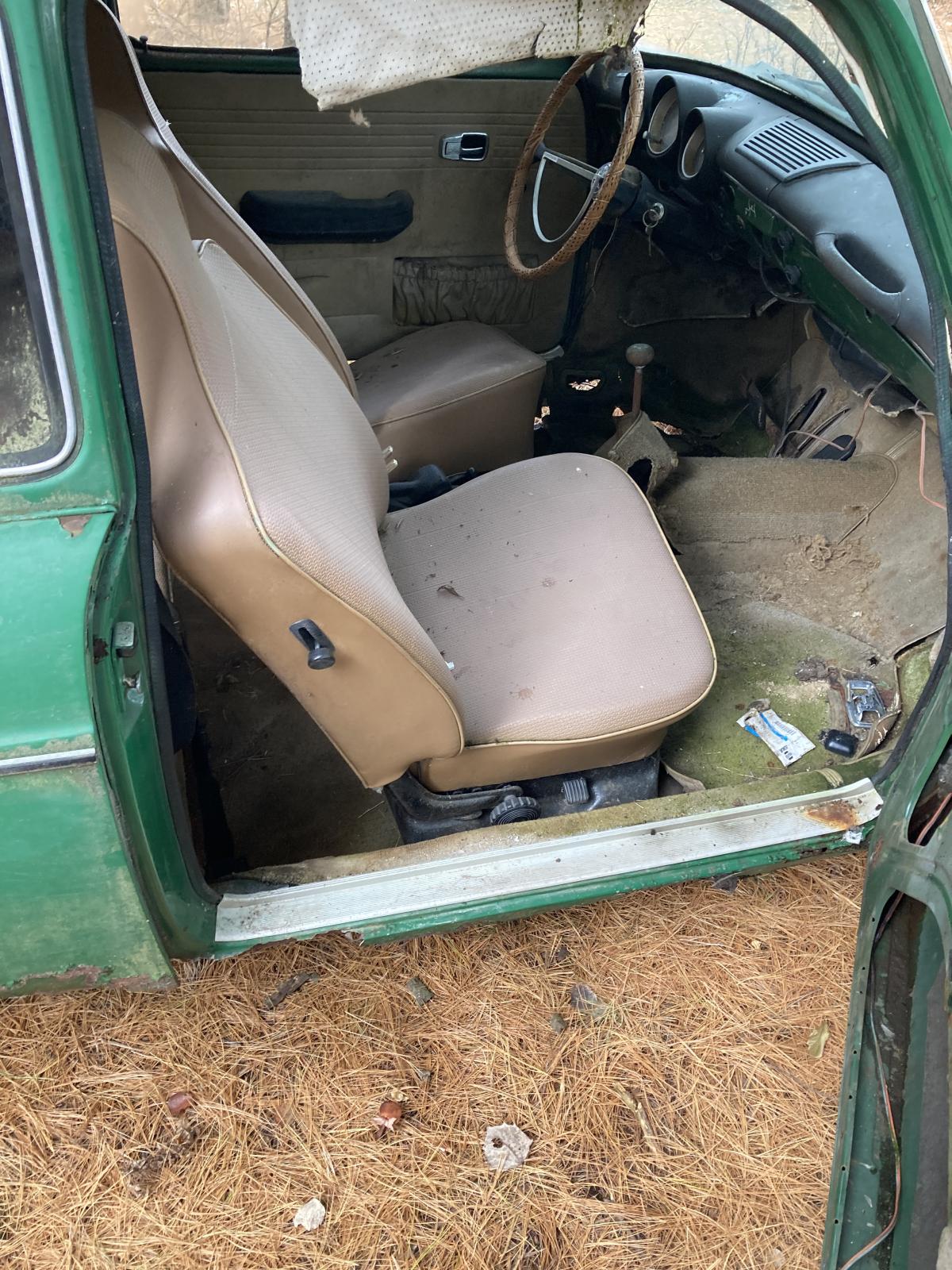

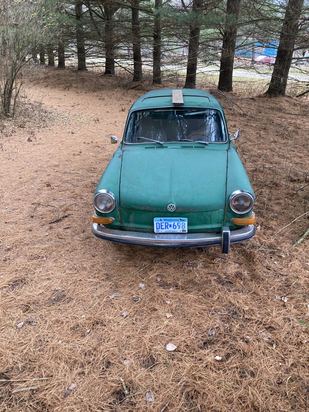

Thanks! Only the rotted one is mine but we got the other one back. And we are making another trip up in two weeks Shocked he had a nice 78 7 passenger bus with a really nice complete interior and the rust was too bad, no motor trans or title but it’s $200 so the my friend that drove us that didn’t get anything today is buying the bus

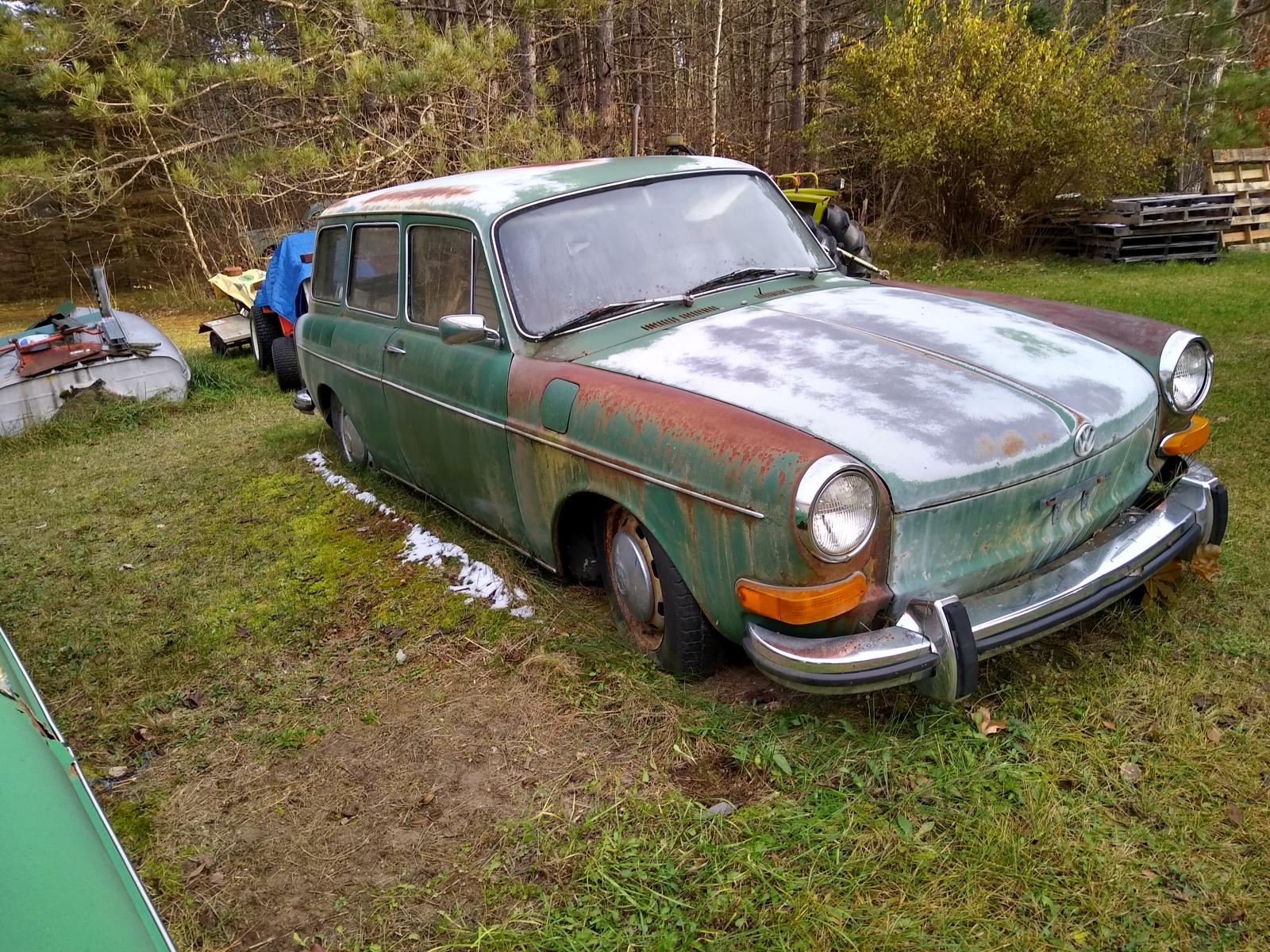

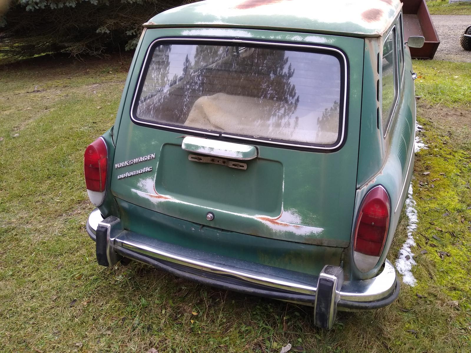

Here are some more pics of the pets car. It only has a transmission, no engine, but a title. H4 headlights, and it’s got a good windshield. The doors are almost perfect but the seats are dragging on the ground Laughing someone took all the sunroof parts out so it’s only some homemade brakes holding it in place. So we had to ratchet strap it in place for the trip. But all the sunroof parts are in a box in the trunk.

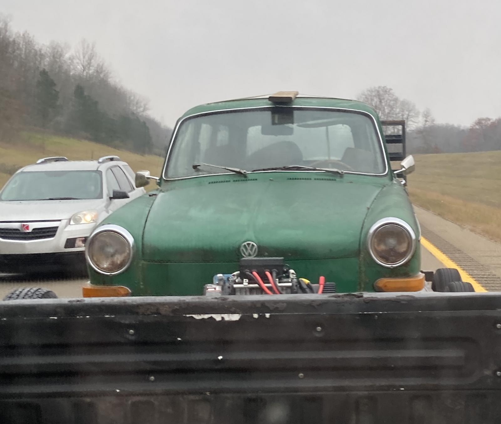

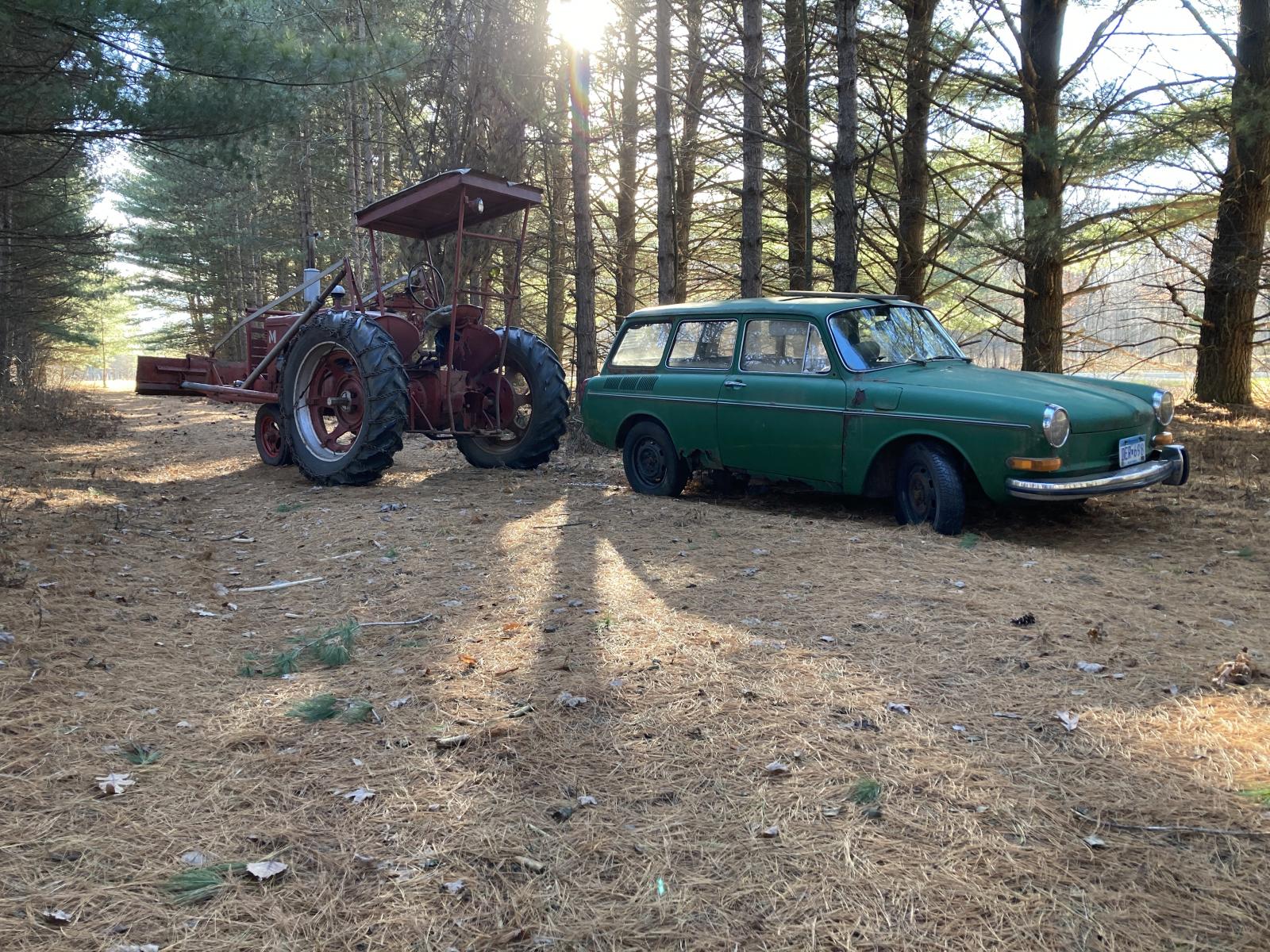

Not much to update on, it rained and washed away the salt so I’ve been driving Joann again. Yesterday I found a major fuel leak in the engine compartment Shocked a couple drips a second. I’m pretty sure the rebuilt injectors were leaking. I found two that were leaking. One just was a little wet around it and in the electrical connection and the other was the bad one. On opposite sides of the engine too. The GB Remanufactured injectors that was a rock auto service have been terrible! Don’t use them!!! Evil or Very Mad I got that all fixed by throwing my 50 year old injectors in and all is fine.
Yesterday I also started tearing into the parts car. My friend needs the front axle for his Squareback. The parts car seemed loved at one point, it has a sunroof, rear seat camping hinges, front and rear sway bars, wood panel interior kit, formula-very shift knob, H4 headlights, number guards and a few other accessories. Anyone heard of the story on this car when it was in Minnesota?
Anyone need any parts? Most everything is available that you see except windshield, front axle and a few other little parts.
Then the beetle that’s finally finished Very Happy

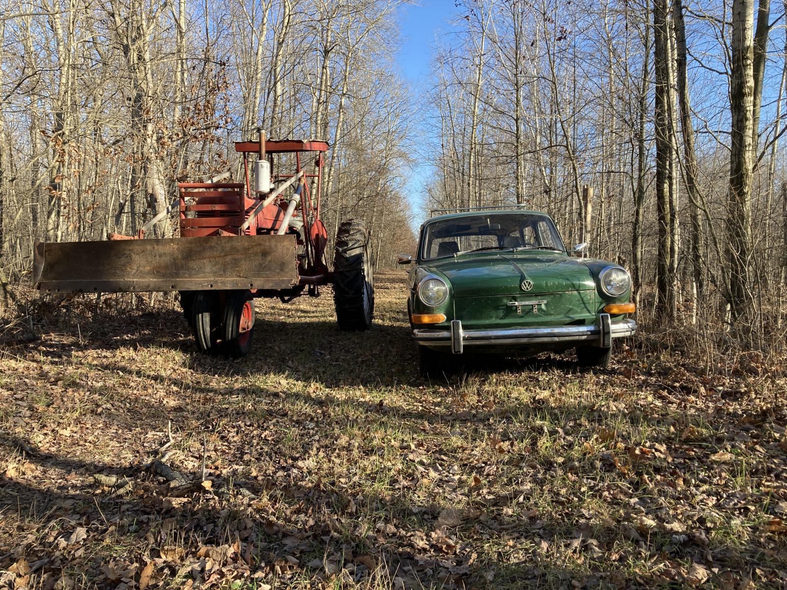

Yep, it’ll get it done for sure! It’s a 1941 Farmall-McCormick super M that I got for “free”. When it wants to work it works good Laughing
Got the front suspension ripped out today, seats, windshield, hood, bumper and the car is slowly getting mutilated Twisted Evil it had a light fretting with a saws-all today and probably a bigger greeting tomorrow Very Happy
