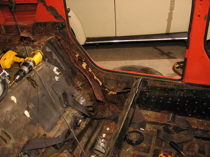

So glad you asked! Laughing
I got out my drill, some bits, and a little liquid courage and drilled out/chiseled off more of those pop rivets. Removed the steering column so it wouldn't be in my way.
I still haven't gotten the largest pieces of the patch metal out of the way yet, but you can see how I can fold them out more:
It's wasted enough to drive a man to drink!

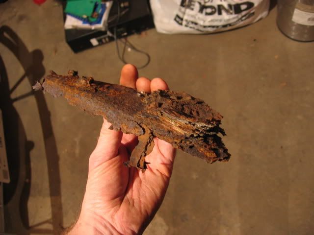

Oh. I also did some grinding to find out where the original rocker ends, and the patch piece begins.
Looks like the new piece is stitched right under the upper rib. When I bought the car, it was kind of neat because it reminded me of the original prototype 181's that only had one rib, but since this turned out to be so rotten, I'm just going to get new outer rocker skins.

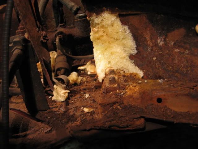

There are a couple sections, especially toward the front, where it's just expanding foam with patch panels pop-riveted over it. Shocked
I think my next big goal will be to reinforce, then remove the body from the pan. Restoring the pan should be pretty straightforward, and will allow me to put the body out of my mind for a while. Wink After that, I'll chop out more of the offending rust and expanding foam from the body. Pretty much every panel apart from the doors and hoods has rust somewhere, so it'll have to come to pieces.
The Thing manual is good about showing dimensions and measurements between pieces, but I worry about missing something important, then not being able to get things like the roof to align when I'm done.
Guess I'll cross that bridge when I get there. If I can't find all of the replacement body metal for the inner panels, I might try bolting together what I have and fabbing up the missing parts.

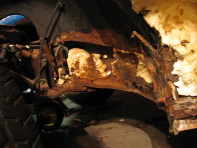

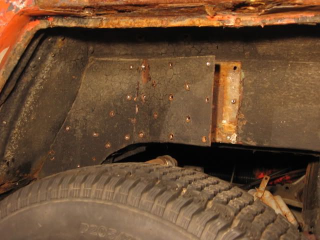

MOAR GORE!!
Imagine my surprise when I found that there were patches in the rear fender wells. I guess the undercoating was thick enough to fool me:
This patch piece truly was holding the rocker to the floor. I should start welding on the braces before I remove any more.
Removed the front left inner fender patch:
Guess I don't need to worry about undoing these chassis-to-body bolts:
BTW, I tried to remove one of the rear shock-mount-to-body bolts, and have nearly rounded the head over. Looks like I'll need to weld on some "help" to get it out.
Finding chunks like this makes me feel like the guy who discovered the Titanic, only to find that it'll take more than some Wetsteel(tm) to bring it back to the surface...

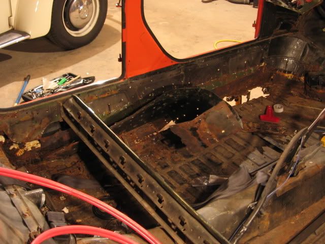

PostPosted: Fri Jun 12, 2009 12:28 am    Post subject: Reply with quote

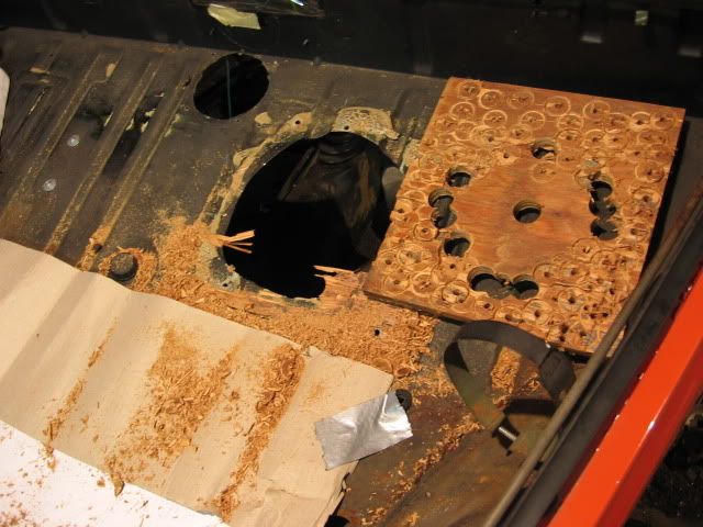

Got a couple things done today. Finally got rid of that audio crossover board in the trunk:
And removed the inner and outer patches on the front passenger side:
The picture doesn't show it well, but I've sliced through about half of the right inner rocker with the Dremel. My line is just under the lowest row of rivets.

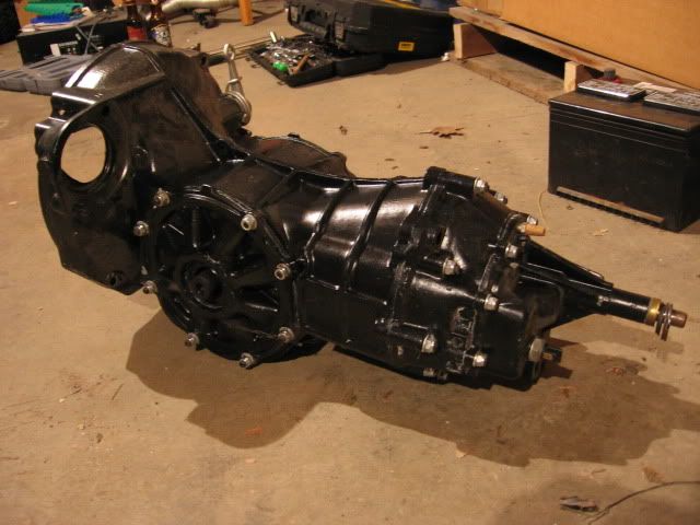

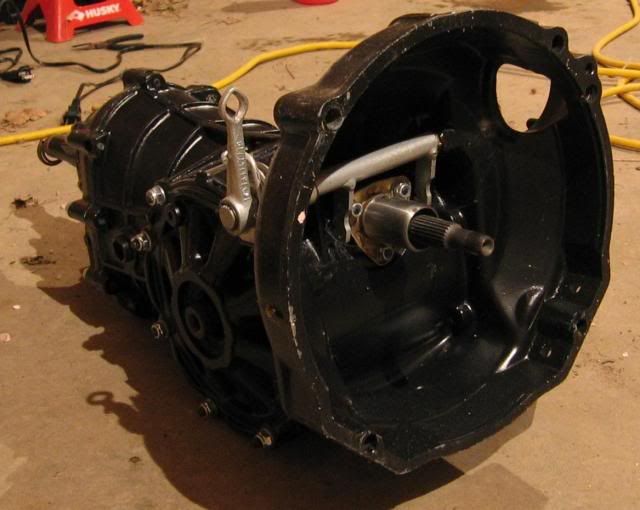

BTW, here's the new transmission:
It's a rebuilt unit from Transworks. You can't see it from the outside, but it's got a 0.94 fourth gear and a 4.37 R&P. According to my math, it should play nicely with the new tires.

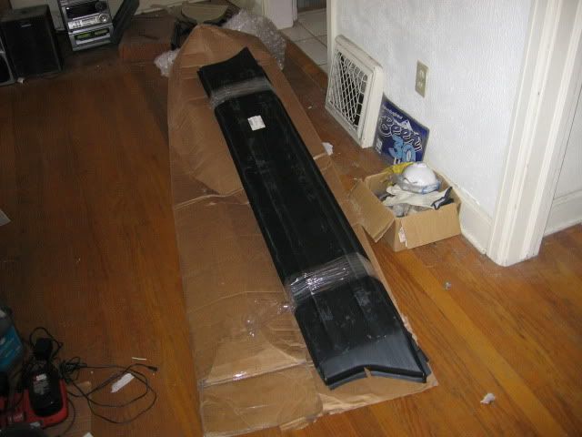

PostPosted: Fri Jun 12, 2009 3:55 pm    Post subject: Reply with quote

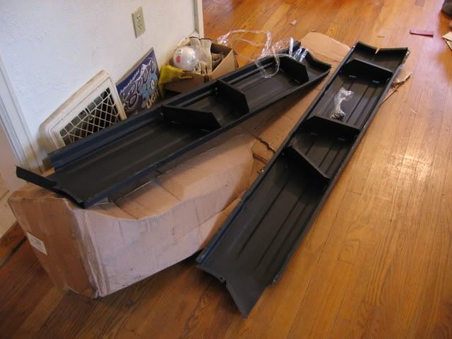

Hooray, more new metal arrived today from EIS!
New Danish outer rocker skins. Very Happy
- Scott
You might need to drill this one just a few more times to be safe. Very Happy
Probably time to weld those braces across the door openings, don't you think? Shocked
