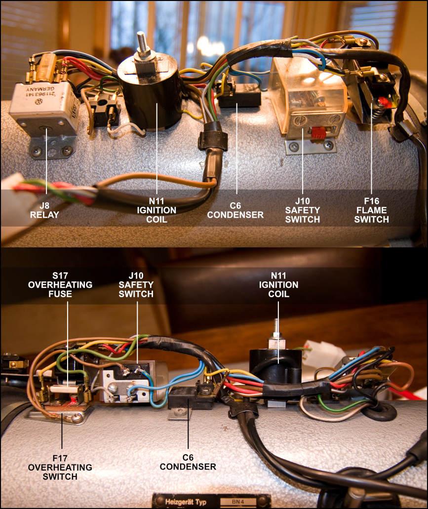

PostPosted: Thu Nov 05, 2015 4:52 pm    Post subject: BN4 wire diagram question Reply with quote
Good day!
I am rebuilding a Eberspacher BN4 gas heater but I'm having a problem trouble shooting some wiring issues.
I have taken a picture of the data plate on the heater and a shot of the wiring and attached to this email for your reference.
I was wondering if you hade a copy of the correct wiring digram for my heater? Please note that my heater does not have a temperature control sensor at the exit of the heater.
Thank you in advance for any help you can offer.

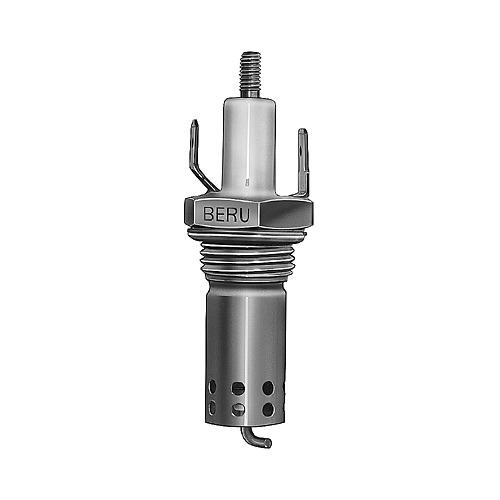

I've been snooping around lately for new glow-spark plug buying options, pleased to say I've found a few. They are available here on the samba from time to time, but the vendors here seem to be really proud of them and ask for way too much money for an item that not many VW enthusiasts are even into. Shame as these cool - "hot" parts may never get into the right hands and may be destined to sit on a shelf - too proud to see use. Crying or Very sad Ive tried to show these vendors links and sales for the same parts - for less elsewhere with little interest to sell at a comparable price. So fine - I get to use this emoji :fist: and this Rolling Eyes
I posted most info to the bay BN4 thread I've been running up. Just thought some of you would find some of the last postings of interest.
http://www.thesamba.com/vw/forum/viewtopic.php?p=7926397#7926397

PostPosted: Mon Nov 14, 2016 12:15 pm    Post subject: Re: BN4 wire diagram question Reply with quote
Yeah. It has an unusual safety switch there too. Possibly some home brew happening there.
You can find the wiring diagrams for the BN-4 in the Technical Section under Thing Wiring. Click here and scroll down. While you're there you might want to have a look at the BN-4 Ladder Diagram. You should be very wary of operating a gas heater with substituted or missing components. The safe use of the heater depends on the ability of the components to interact with one another.
Here's a photo of the top of the heater with the components labeled as per the wiring diagram.
Hope that helps . . .
