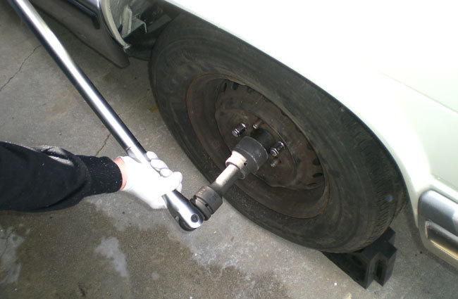

PostPosted: Sat May 13, 2017 3:42 am    Post subject: Reply with quote
pete000 wrote:
Is this extension really necessary?
I am about to order a 46mm socket for my 3/4" breaker bar and wonder if I should also order an extension?
www.edwardpowell.com

61Scout
Joined: November 06, 2011
Posts: 1297
Location: Shoreline/Yakima WA
61Scout is offline
PostPosted: Sat May 13, 2017 8:22 am    Post subject: Re: how do I remove the rear axle nut? Reply with quote
The thing is that you must have room to clear the body. Otherwise you're jammed up and dragging knuckles. Simply lay a board across the body and measure back to the nut, then add some room for clearance.
Ed, if your set up ends up being similar to the picture you posted I'd suggest putting a jackstand under the extension for additional support to prevent the operation from going sideways/crooked and rounding off the nut.
-Kevin

fxr
Joined: December 07, 2014
Posts: 2660
Location: Bay area CA
fxr is offline
PostPosted: Sat May 13, 2017 8:52 am    Post subject: Re: how do I remove the rear axle nut? Reply with quote
When you order the 46mm socket, ensure it's a six-point one, not a 12-pointer.

blackglasspirate
Joined: June 24, 2006
Posts: 1632
blackglasspirate is offline
PostPosted: Sat May 13, 2017 11:04 am    Post subject: Reply with quote
epowell wrote:
I used a similar breaker bar to the one pictured (it was a cheapo from harbor freight) without an extension, though an extension would be nice to clear the fender.
I also used a 6' pipe from Home depot on top of the breaker bar. This past time when I was re-installing the nut I actually snapped the end of the breaker bar where the socket connects. Luckily it was tight enough so now I just have to get a new bar for next time!

[quote="epowell"]
While I didn't need an extension for this job using a short 3/4" 46mm socket, I recall the range of motion being limited.
An extension would increase your flexibility and since it's your money, I recommend getting one or, as TK says, a deep socket.
Ever since we added the 4' Snappy 3/4" torque wrench/breaker bar to the tool bag, these multi-hundred ft/lb axle nuts and crank bolts simply haven't been a problem.
With the recent intermountain oil&gas boom cooling down, I regularly see these on craigslist around here for $200-$300
