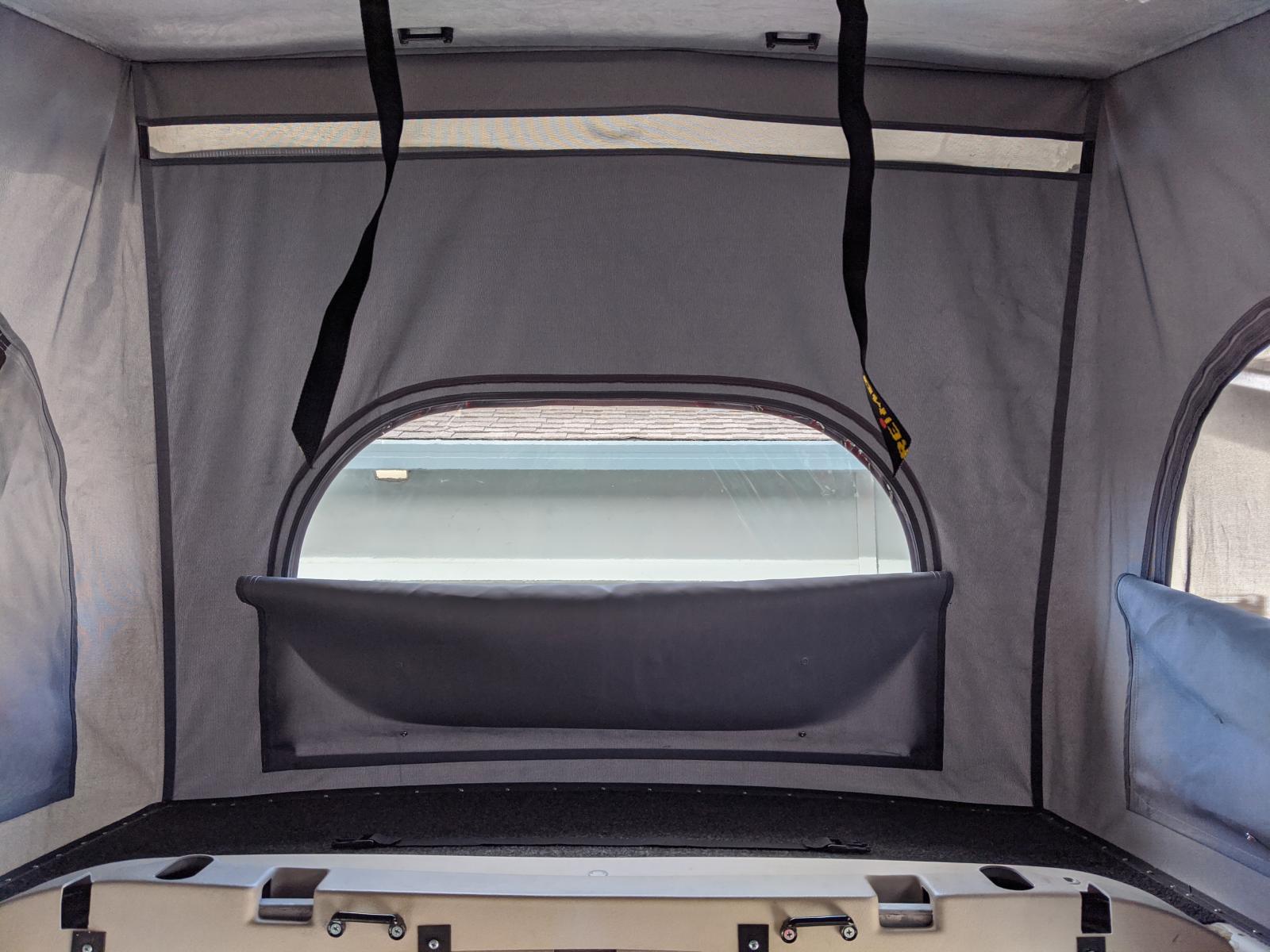

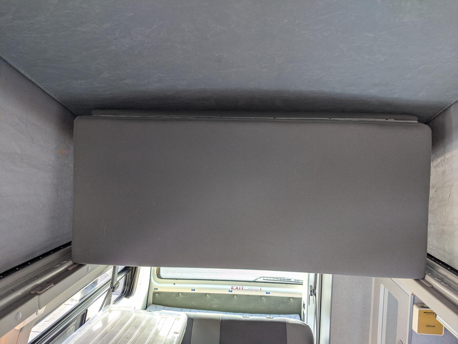

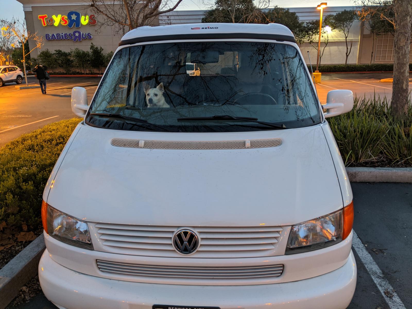

Reimo pop top installed. Now it blends right in with the Westys!

Wow. Looks great.
Need more details on the Poptop hardware please.

Looks nice -- thanks for sharing the pictures! Smile

This is a standard offering from Reimo which includes all the hardware (pop top, hinges and tent). No modification to existing cutout from Winnebago, pretty straight forward removal and installation of the new top. The Reimo top is secured to the van up front with 4 straps. For my van 2 new strap mounting points needed to be drilled and installed on the top so they line up with the Winnebago front opening. I do want to add that the whole job took longer than anticipated due to couple factors: 1) Once the Winnebago top was removed, there was so much silicone residue on the van it literally took a person whole day to clean all that stuff off the van. 2) My installer had to shave some material off the new top so the top would "sit right" on the van.
One upside with the new top is I now have a much larger shelf area over the cab when the top is up. With the top up I can still fold the top bunk out of the way like before, but I do feel the rear hinge doesn't open quite as tall as the Winnebago top. Interior of the Reimo top is a soft cloth material and no internal 12V wiring. I am working on installing LED strip lighting at the bottom edge of the tent.
It took over 4 months for Santa Cruz Campers to get the top from Germany, they are made to order so it took a while.

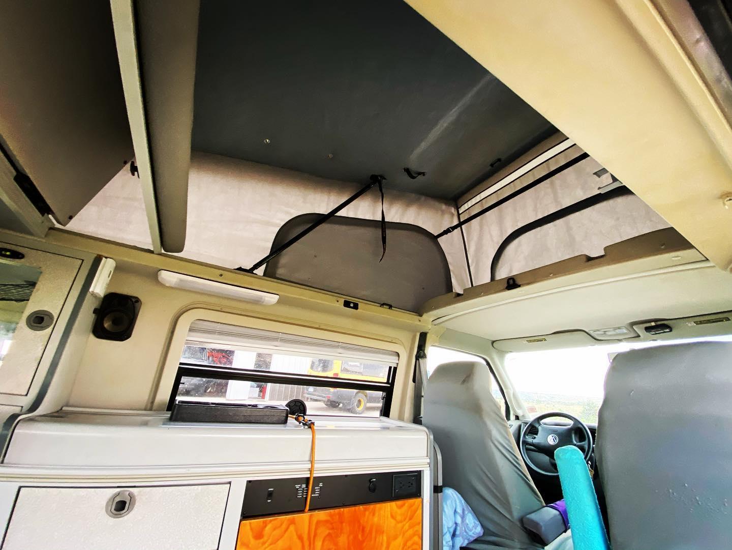

Seems good so far! The extra interior storage space above the cab with the top up is nice. Creaking and rattling is significantly reduced.

Yeah! I didn't get to go on as many trips as I liked this year, but every trip I took I am glad to have this new top instead of the problem prone Winnie top. Jonathan: I never quite figure out the extra mounting holes behind the gas strut on your top, what are those for? roof rails?
