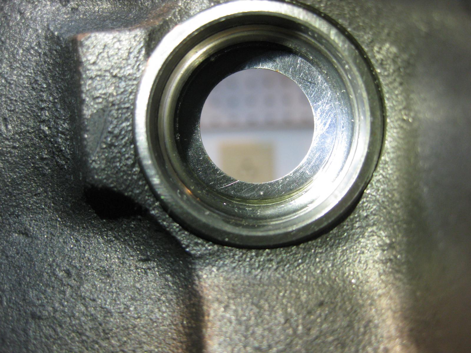

So picking up the disassembly:
I cleaned all the parts in my parts washer and remounted the main housing back on the fixture. The arrows point to a couple small nooks where it is easy to not get all the old grease out of:
Then I pulled the old seals out. They were made of the "blue colored" material, that to me indicates they were original.
I'm using a standard seal puller, available at about any tool or automotive store. Due to experience, I'm careful to pull on the seal and not dig the tip of the puller into the metal surface that holds the seal. Pull gently on one spot, move over and pull gently a 1/8 inch over, move back to the original spot. Gently, back and forth between two spots and the seal should tip out. Also, a little KROIL squirted around the edge of the seal/metal interface will help loosen the seal up from being stuck to the steel for these 50 or so years. Since I know that I can get replacement seals I didn't have to be careful about not damaging the seals.
When you get the small seal out, you look in and see the shim,
Note that this shim is forming the "Bottom" of the seal area. I.E. when the seal is installed, the shim is where the seal bottoms out at. (Which means you can't install this seal until the shim is installed.)
And the shim is backing the upper bearing race which is still in place.
'69 Squareback restoration
'69 Fastback restoration
'66 Type34
OKType3Tim Premium Member
Joined: April 30, 2011
Posts: 300
Location: Northeast Oklahoma
OKType3Tim is offline
PostPosted: Tue Aug 23, 2016 1:04 pm    Post subject: Re: Steering Boxes: VW vs. TRW; VW Teardown & Rebuild Reply with quote

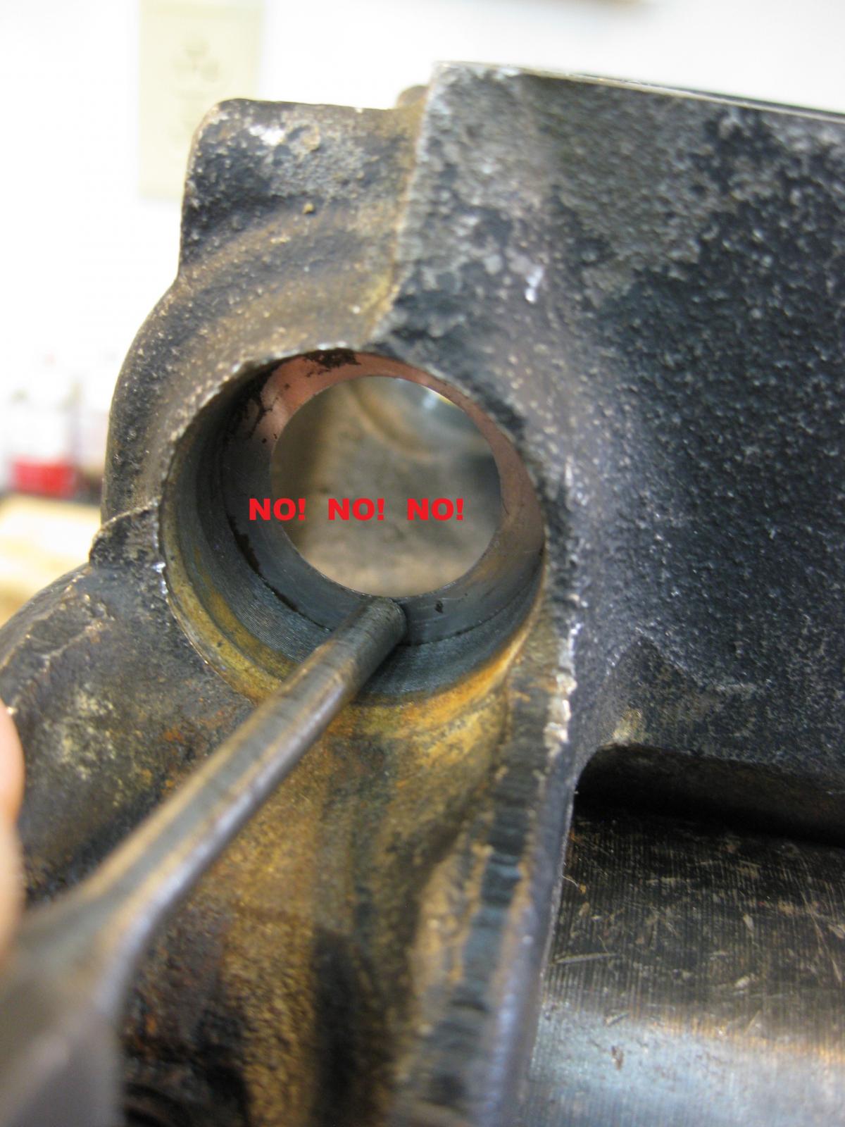

So how to get the shim out without destroying it (completely):
My first temptation, on a previous unit, was to do this:
DON'T DO THIS!!!
Here is what you are trying to remove:
From the outside looking in:
From the inside looking out:
Side View:
The shim is thin and has no structural strength when unsupported, so you are needing to catch the part of the shim that is in contact with the back side of the bearing race. But the bearing race has a chamfer, and the socket is going to fall right into that chamfer. First hammer blow is going to destroy the shim....all the way around, in one blow.
[Yes, there is a reason I know this.]
So.. you might be tempted to do this, BUT DON'T:
The shim is so thin, that the force of a square edged punch is going to cut right through the shim.
So I used a smaller diameter socket (10mm and 8mm 1/4" drive) with a rounded edge that I could work my way around the shim/race; and hopefully not damage the shim to much.
So after a bit of tapping: I have started to move the race, but I have also clearly created some damage to the shim. If I didn't catch the back of the race perfectly square, the socket would slide off into the middle of the shim, causing the shim material to be stretched.
You can just start to see the back edge of the race beginning the clear the notch in the housing.
All I can do is continue as best I can until the bearing and shim are out:

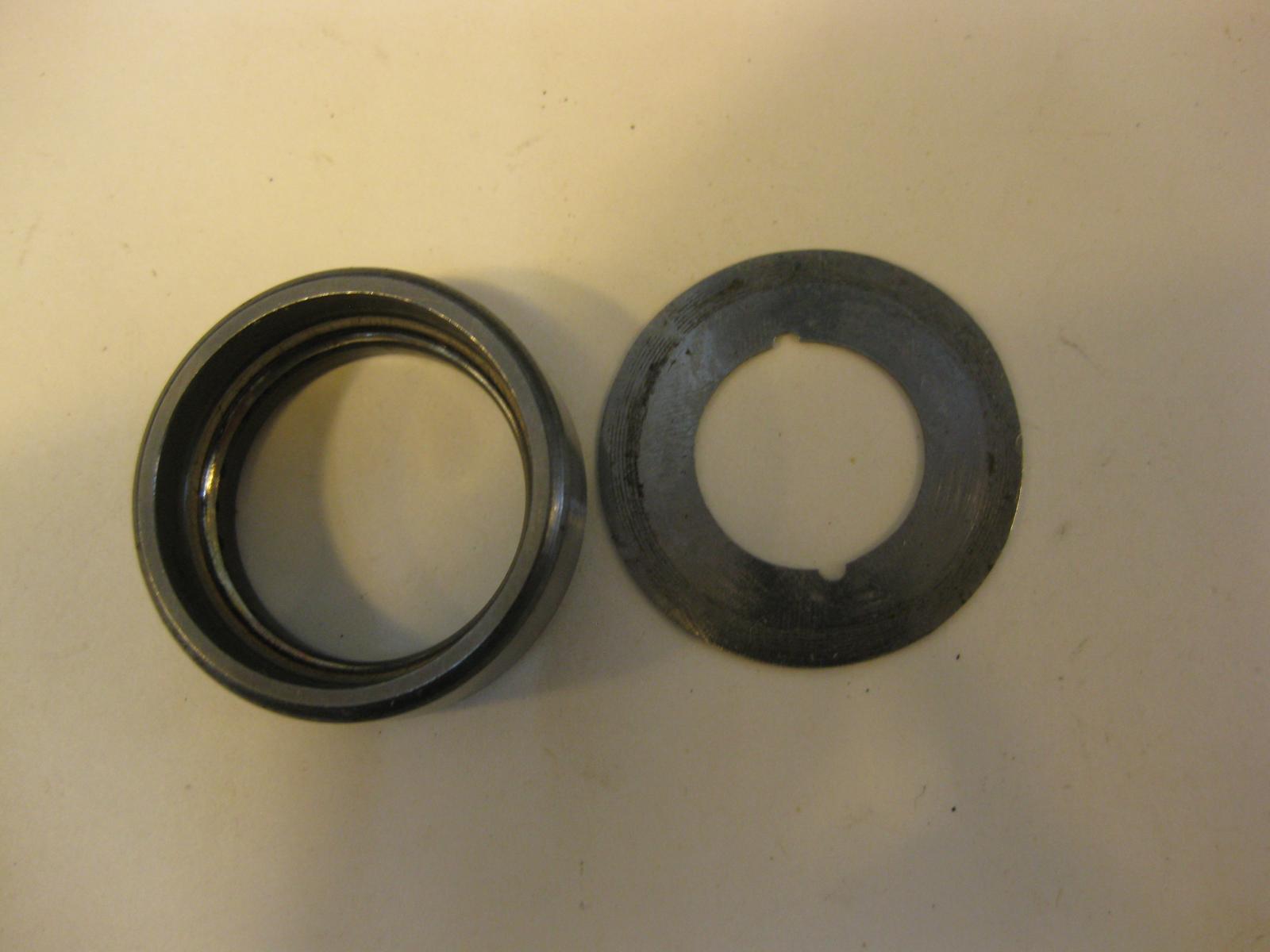

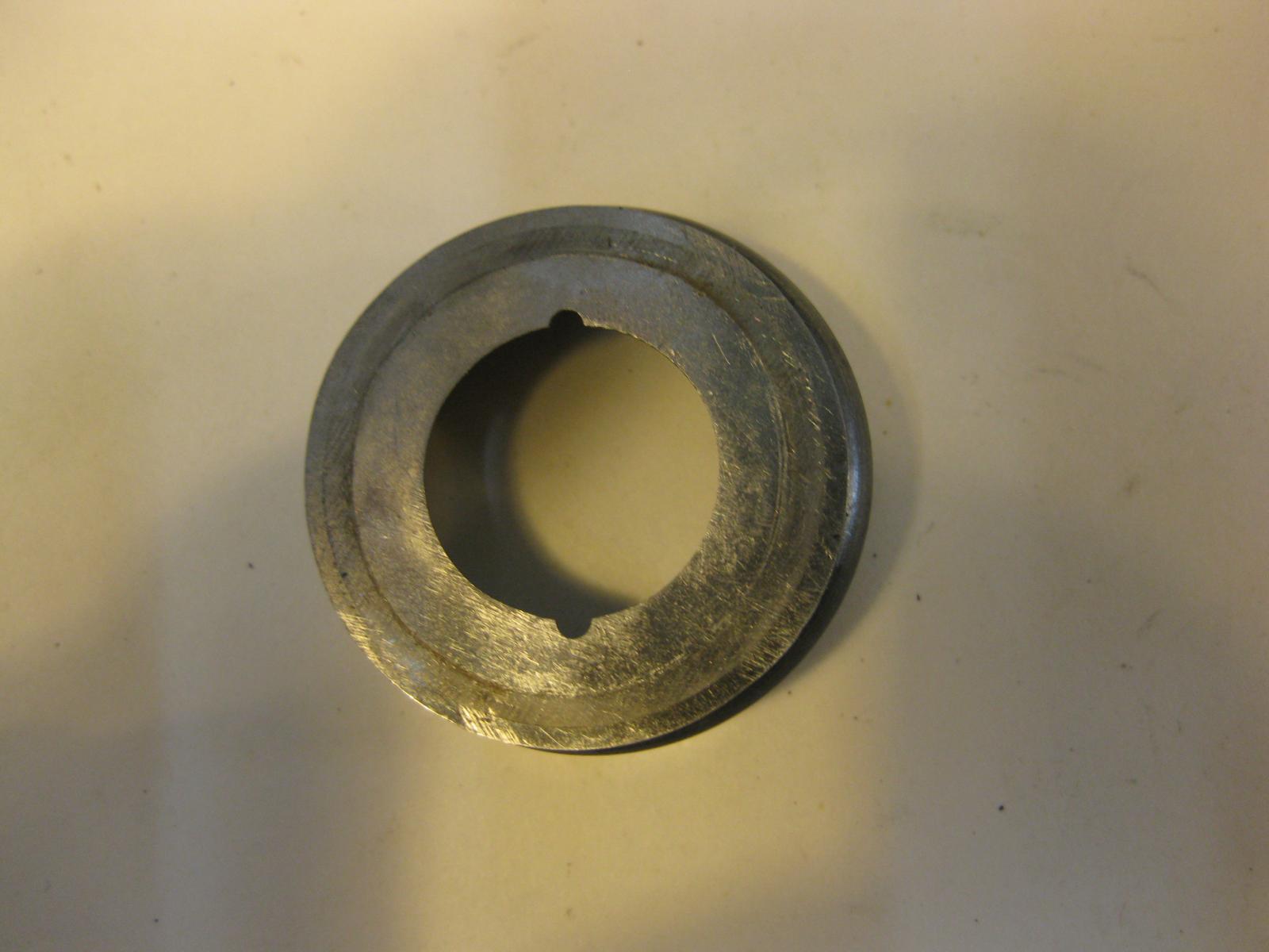

So how bad is the damage:
Let's see If I can fix the shim. I'll use some body work/metal work techniques. First some gentle taps (hammer and dolly) to repair some of the damage.
Then to shrink the metal that has stretched, a propane torch and quench with cold wet cloth.
I wish it was better, but it is what it is, and I think it would be serviceable if I can't find a source of shims.
Um, actually doesn't look to bad from this perspective.
With everything apart:
Clean again and then blast it completely clean. I use 40-60 grit glass beads in a small blast cabinet. Now everything has been degreased, paint and rust has been removed.
So now, on to evaluation and figuring out what I have that can be reassembled into a serviceable unit.
I can tell you that the shim in my steering box was a thickness of 0.2mm (0.0078") and had an O.D. of 31mm (odd really). Since I messed mine up, I can only guess at its I.D. but since the shaft is 16.5mm you need a shim that clears this. I opted to search for shims with an I.D. of 18mm but all I found were 20mm(i.d.) x 30mm(o.d.) shims. I imagine these would work but i can't wait to see what you guys find. I hope some of my information helps in your searches as well.

PostPosted: Tue Aug 23, 2016 3:32 pm    Post subject: Re: Steering Boxes: VW vs. TRW; VW Teardown & Rebuild Reply with quote
FYI: The number of notches in the shim is supposed to indicate the thickness of the shim.

So.....just getting this straight in my head.
So although the seal rests/bottoms on the shim...it could just as easily bottom on the bearing race. So...the shim is there....primarily to set depth in the bore of the bearing race?
Ray
Yes, the seal could also bottom on the bearing race. In fact, the TRW unit I tore down, did not have any shim, and the seal was bottomed on the bearing race.
Yes, the shim is used to provide fine adjustment for 'centering up' the steering worm shaft by moving the upper bearing race. The "Practical Work" book details the shim selection process:
http://www.thesamba.com/vw/archives/manuals/practicalwork_steering.php
Also, all that fooling around getting the shim and upper bearing race out would be greatly simplified if I had VW tool 423; which is basically a 21.5mm diameter drift. I'm thinking I need to have my machinist friend make one of those.
http://www.thesamba.com/vw/archives/manuals/tools/gallerypics/423.jpg

Um. Strike my previous comment about VW tool 423 (which the bentley manual suggests you use). I went and remeasured. A 21.5mm drift is going to completely destroy the shim and pass right through the middle of the bearing race. The only way VW423 would work, is by turning the shim into a mini puller. Doing this by wedging the tool and shim into the id of the bearing race; thus pulling the bearing race from the housing.
In fact! If you install a bearing into a VW housing without a shim; you will have a very hard time getting it back out. The shim does in fact act as a bit of a ledge for you to tap on as I described above. Without the shim, there isn't enough of the bearing race back exposed such that you can actually get some good force onto it.

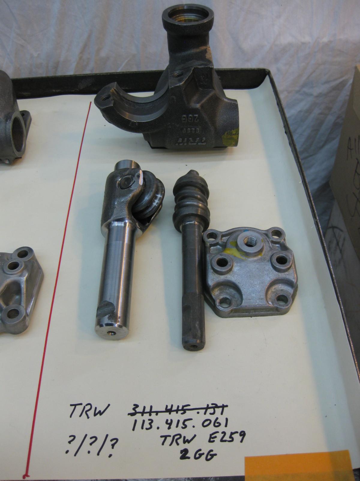

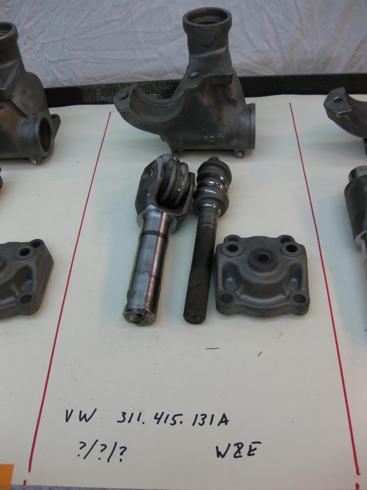

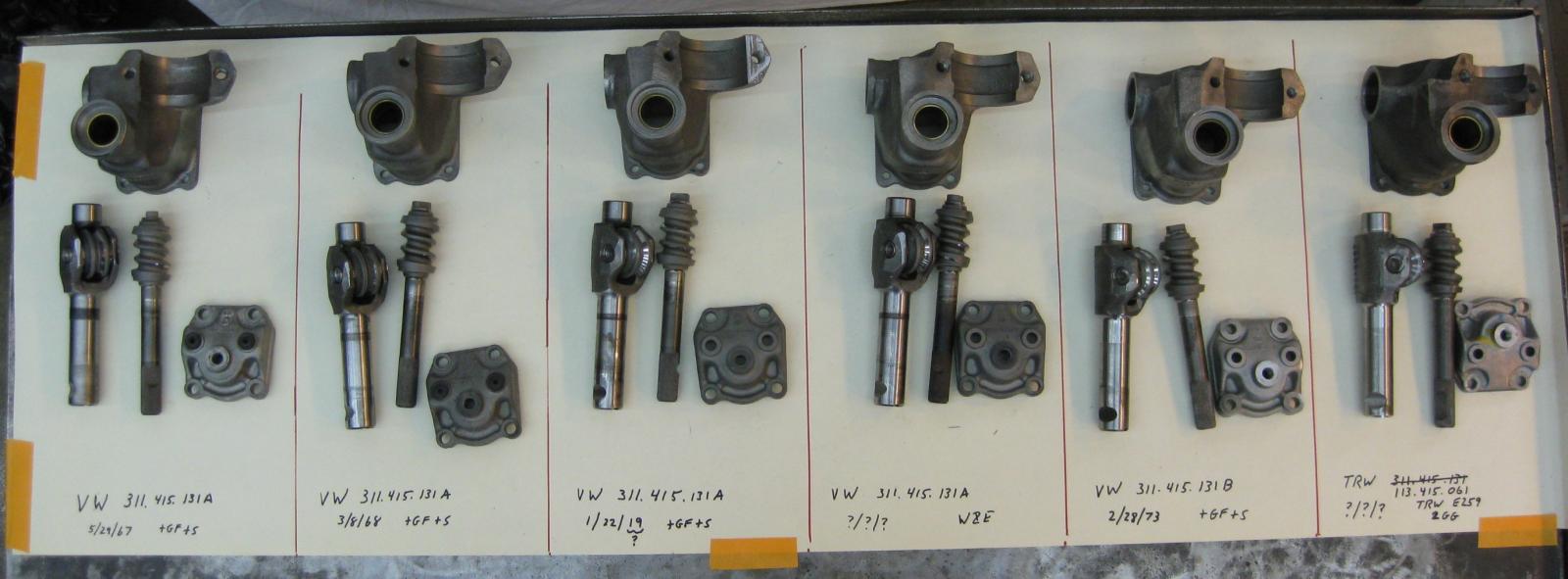

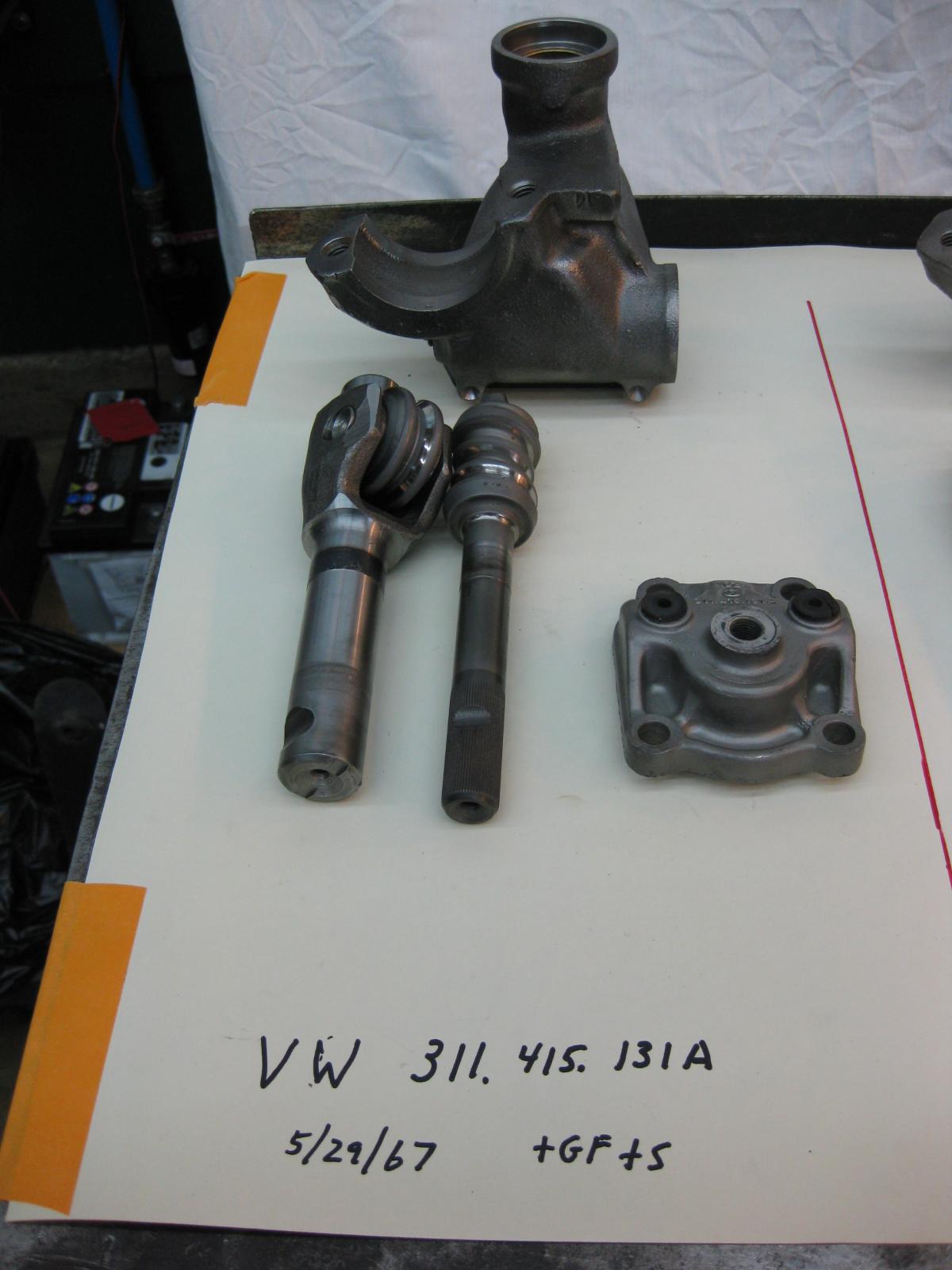

EVALUATION:
I set down with some measuring tools to evaluate the 6 units that I've torn down. I didn't use the electronic calipers much as they tend to have me "Over Measuring", looking for accuracy that isn't actually there.
The parts have been cleaned and sorted:
I obtained these from various sources, so some had steering worm flanges, but not all:

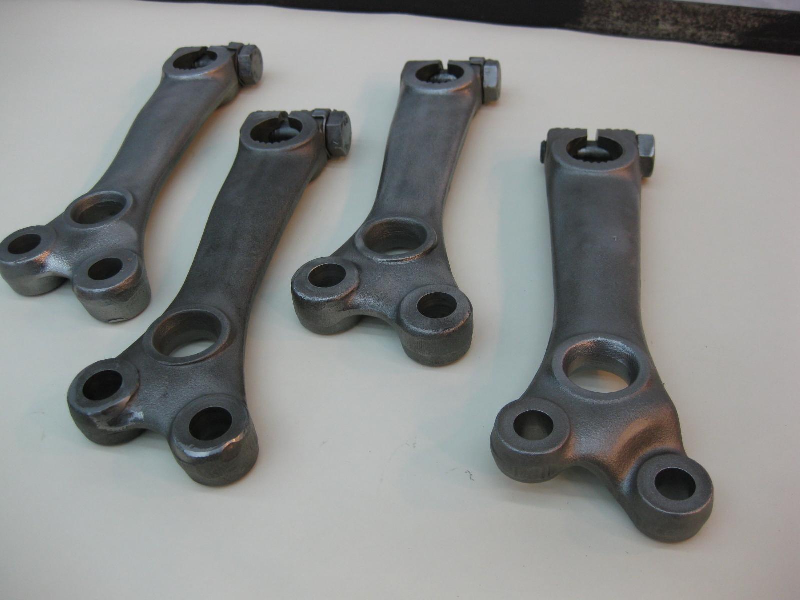

Some had drop arms, but not all:
There are 3 late model drop arms, 1 early model drop arm. Here are the differences; late on the left, early on the right:
Note the markings on the base, "311" vs. "311A"

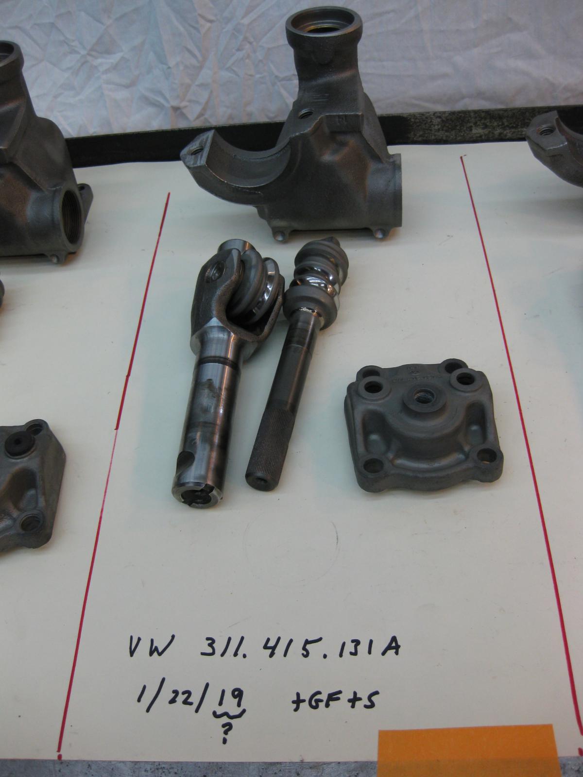

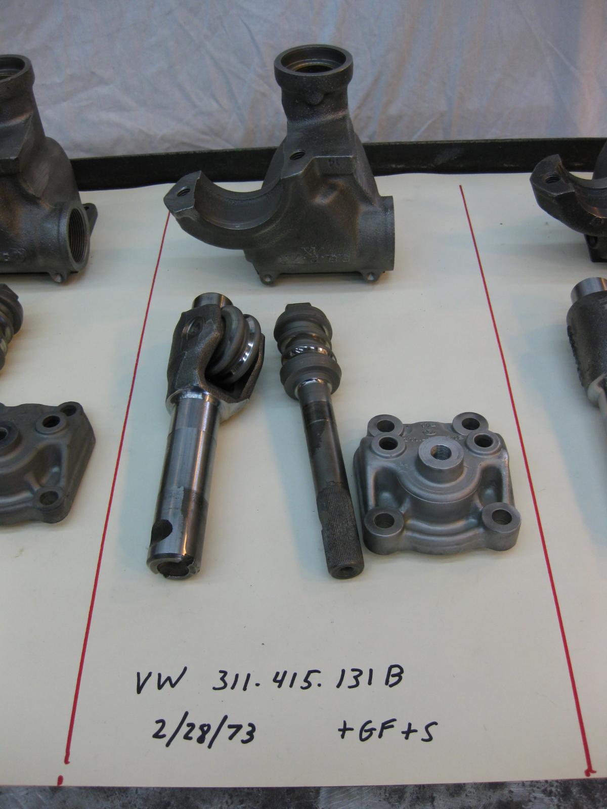

The main components laid out:
Left to Right:
Note the slight difference in the shape of the main housing casting between the 3 different sources. I think that the markings of "+GF+S" vs. "+W&E" could indicated different OE manufacturers contracted by VW. Maybe someone can provide enlightenment on this regarding whether it means subcontractors, divisions, labor unions, or something else. In any case, the "+GS+F" units come with clearly marked casting dates. (although someone messed up at the foundry and put a year of "19" in the mold on January 22nd.
And, so here are the measurements:
There has been discussion and concern about how to know if the bushings are good or bad. From this sample, I think the spec on the main housing bushing was an I.D. of 23.85 mm. And none of these units show any appreciable wear on this bushing.
I think the spec on the bushing in the cover lid was 23.9 mm. As noted, wear of +.2 will be enough that you can physically detect the side-to-side play of the shaft in the bushing
The spec on both the top and lower bearing surface of the roller shaft appears to be 23.48 mm. (Although the shaft in unit#1 appears to have made it through QA with a bit of out-of-roundness.
And, as noted in a post above, the real wear point is the roller needle bearing, and the roller surface and worm surface interface. This wear dependent on getting the proper "play" set on
1st: the Steering Worm [where the ball bearings are],
2nd: on the top adjusting screw for the roller worm interface,
and 3rd: the axial play on the roller (needle bearing).
Very Happy Very Happy Very Happy AH yes grasshopper--that is what the Bentley manual says! Laughing
