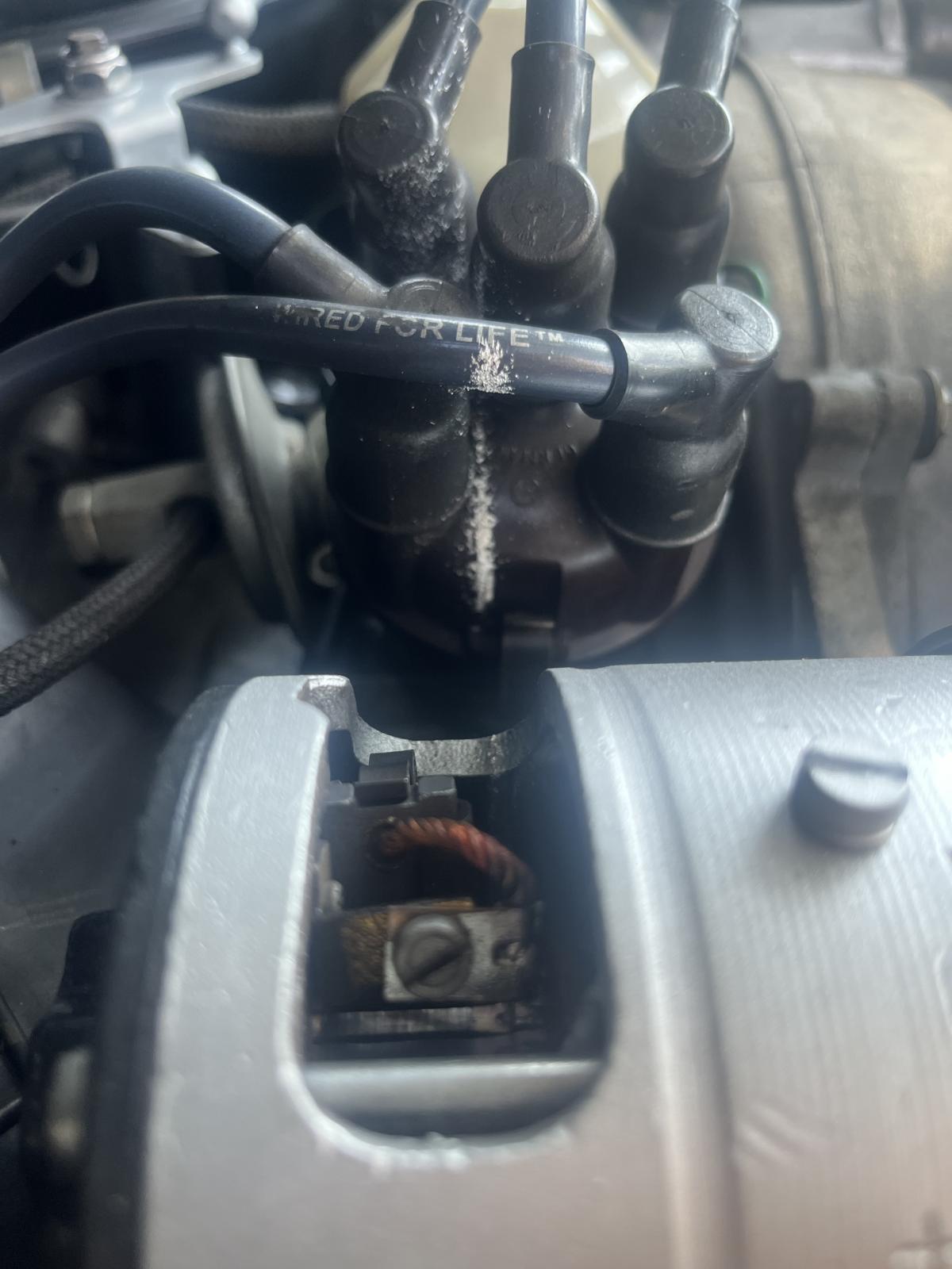

Geez... How long am I going to be dealing with these generator issues???... I think this thread needs a new title.. Something like "Generator woes" or something like that.. THE SAGA CONTINUES!
There must be a different problem going on somewhere that I am just not seeing or thinking of. I only got about 1800 miles out of a set of brushes before my gen. light came back on in June. I swore there was a different time back in march or something that I dealt with this and didn't post about it, anyways.. Generator gave up in mid June.. only got 1800 miles out of a set of brushes.. thats NOTHING.. I decided to just throw a set in finally after driving 150 miles home with the gen. light on once I got home. Fast forward 2 weeks later to the end of June. I go for a drive out to the desert and through the mountains to take some photos and when I pulled in the garage I noticed only one of my brushes was worn down by A LOT.. That's a tell tale sign that somethings obviously up. Most likely the armature needs to be spun and cleaned up on a lathe or something. Took it to Wayne Electric here in Long Beach and $350 bucks and about a month later I had a completely rebuilt generator.. the armature was damaged.. take it home and it was working great! all I did was install and turn the car on and it was fantastic..
Fast forward to just a half hour ago. I pull the car out of the garage to give it a wash.. RED LIGHT ON... WHAT THE @!%$ Brick wall I'm looking at it and with the car running both brushes are seated properly and not worn at all but the gen. is sparking pretty good. This is maybe like my 5th or 6th rebuild in a year or a year and a half.. its starting to get expensive.. AND ANNOYING AS HELL. Voltage was less than 2V at idle and when I rev the motor up it would go out but only sometimes, other times it would only dim. I checked the regulator and it was fine and everything is connected properly and the battery is new within the beginning of the year..
I'm really scratching my head at why this is a consistent issue for me. There must be something else going on that I'm not seeing or realizing.. the car is a 12v conversion. One of those special 6v looking gens. that actually puts out 12v.. Anybody have any ideas as to why my generators are only lasting a couple months if that? They're all aligned properly on the fan shroud for cooling.. I just can't think of anything else.. Suggestions? thought? Anything is appreciated, Thanks
Attached here are a few photos of how the gen. is sparking ad shooting paint onto the shrouds and dizzy as well as how the brushes look ATM
You can see in 2 of the pictures the silver paint has shot out onto the other shrouds and the distributor and plug wires.. Again any help or suggestions are appreciated.. thanks!

Paint? Or the lead from the brushes Shocked Where the brushes touch the armature should of been clean - no paint on it. All it would do is foul the brushes.
Take the brushes out, clean the contact point, then clean the armature with some fine sand paper.
See if that helps.

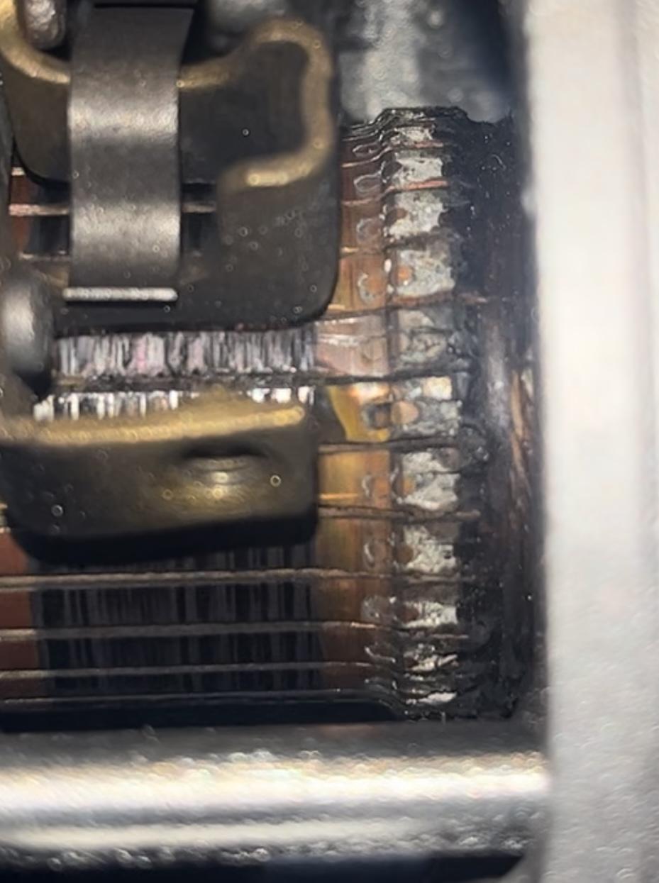

I took it out of the car, inspected it further and it seems as though the armature is burned up.. AGAIN.
Phil, as far as end play I am not sure what the specs are on that.
Mike, I have not polarized it since the people who rebuilt it said they already did that.
Wayne's Electric has been in business for over 60 years rebuilding starters, gens. and alternators. Was recommended to me and has many reputable reviews..
With the armature being burned every time I have to assume that its something with the car.. somewhere.. Maybe it's not the "right" 12v Battery? or maybe the Regulator is bad.. Again.. or maybe I gotta clean something else like contacts or replace some wires that might have resistance? It's times like this where I start to overthink and then think about the impossible.. what could it really be! Maybe even Belt tension!?!?!? Hell if I know at this point.

Wow that looks like ass in there Shocked
That's rebuilt?

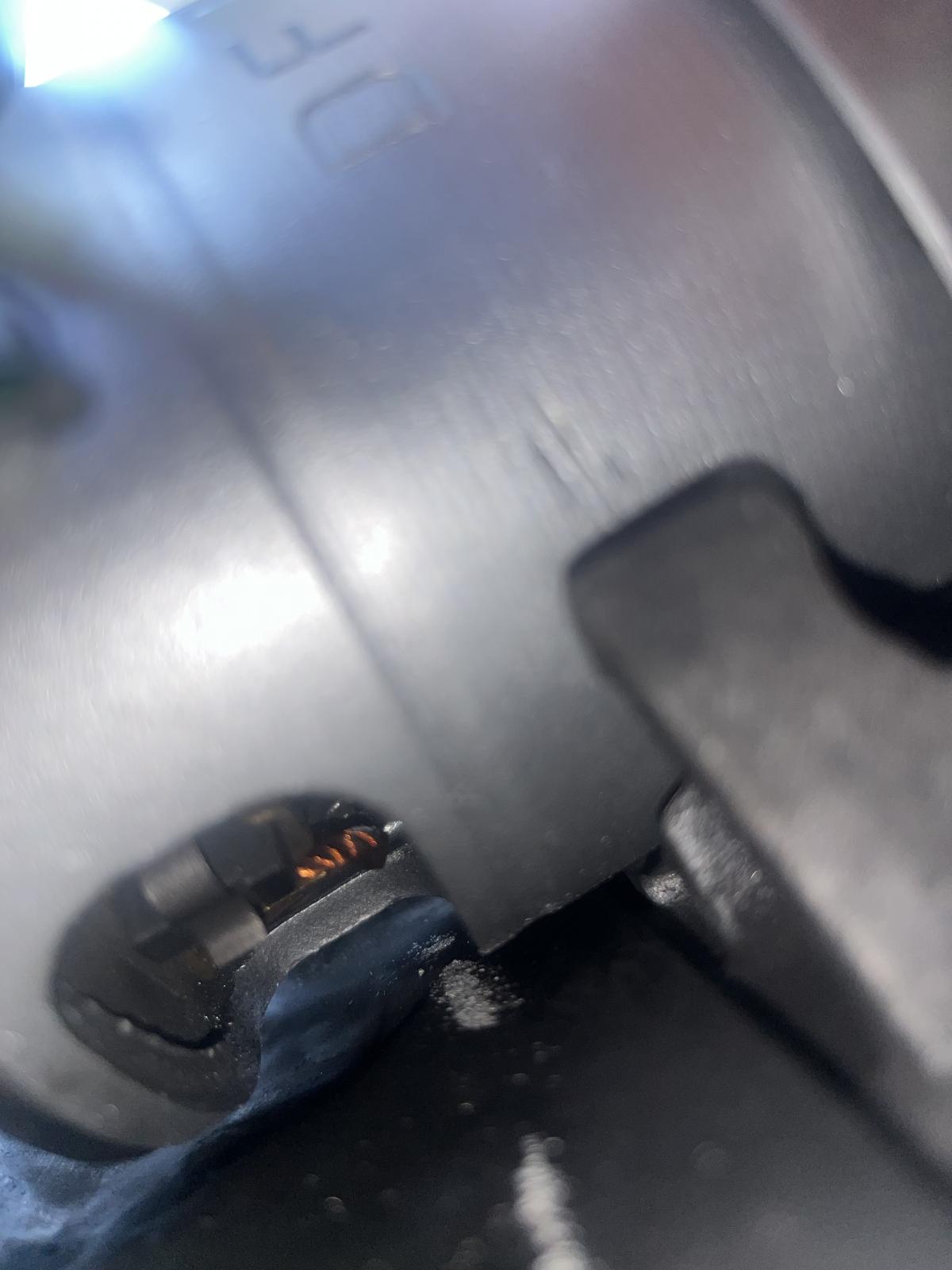

7th generator I've had now.. randomly stopped working. I drove the car and it worked perfectly. I turned it off then turned it on 3 hours later to drive home and my generator light came on right away. Some interesting observations I had:
- Armature, field coils, brushes, and all solders appear OK and NOT WORN/BURNED
- It randomly started working again as I backed up to go home pulled over and checked the voltage again and it WAS WORKING 13v at 850rpm
-left again after checking and it STOPPED WORKING.
-Aligned properly for proper cooling
-Solid State Regulator visually appears OK and tested OK
-Battery tested OK
Trying to go back to the basics.. what can randomly make the generator stop working? If this is the 7th generator I've been through it makes me believe the problem is not the generator, but rather something that is causing it to go bad.
It's such a simple system that this is making me lose my mind..
Already dropped it off at Wayne Electric in Long Beach who specialize in rebuilds.. might just drop the car off and see what they say.. SHEESH! Shocked Rolling Eyes
I wouldn't hesitate to drive this car anywhere other than my speculation that the generator could give out at any time. Am I the only one whose had issues with generators like this?

With weird flakey problems, it is good to confirm that both the regulator and generator are grounded properly. If the generator is painted, the grounding might only be through the little nubby on the attachment strap. (Some people add a dedicated ground wire to the case screw at D-) When the engine warms the nubby contact might improve. The transmission ground strap must of course make good clean connections too.
Maybe there is a bigger underlying problem. Do I have this right: a 12V armature is being run inside a 6V generator housing? Are the field coils in the housing still 6V? (field coils for 6V and 12V are not wound the same!) What would be the wattage / amperage ratings of this modified generator, and therefore what voltage regulator should be used? Regulators must be matched properly to generators to avoid eventual problems. From the VW Typ3 service manual: "It is essential that the correct regulator is used, as a regulator for a higher output would overload the generator, and one for a lower output would not make full use of the generator output so that the current supplied would probably be insufficient to charge the battery and feed the circuits."

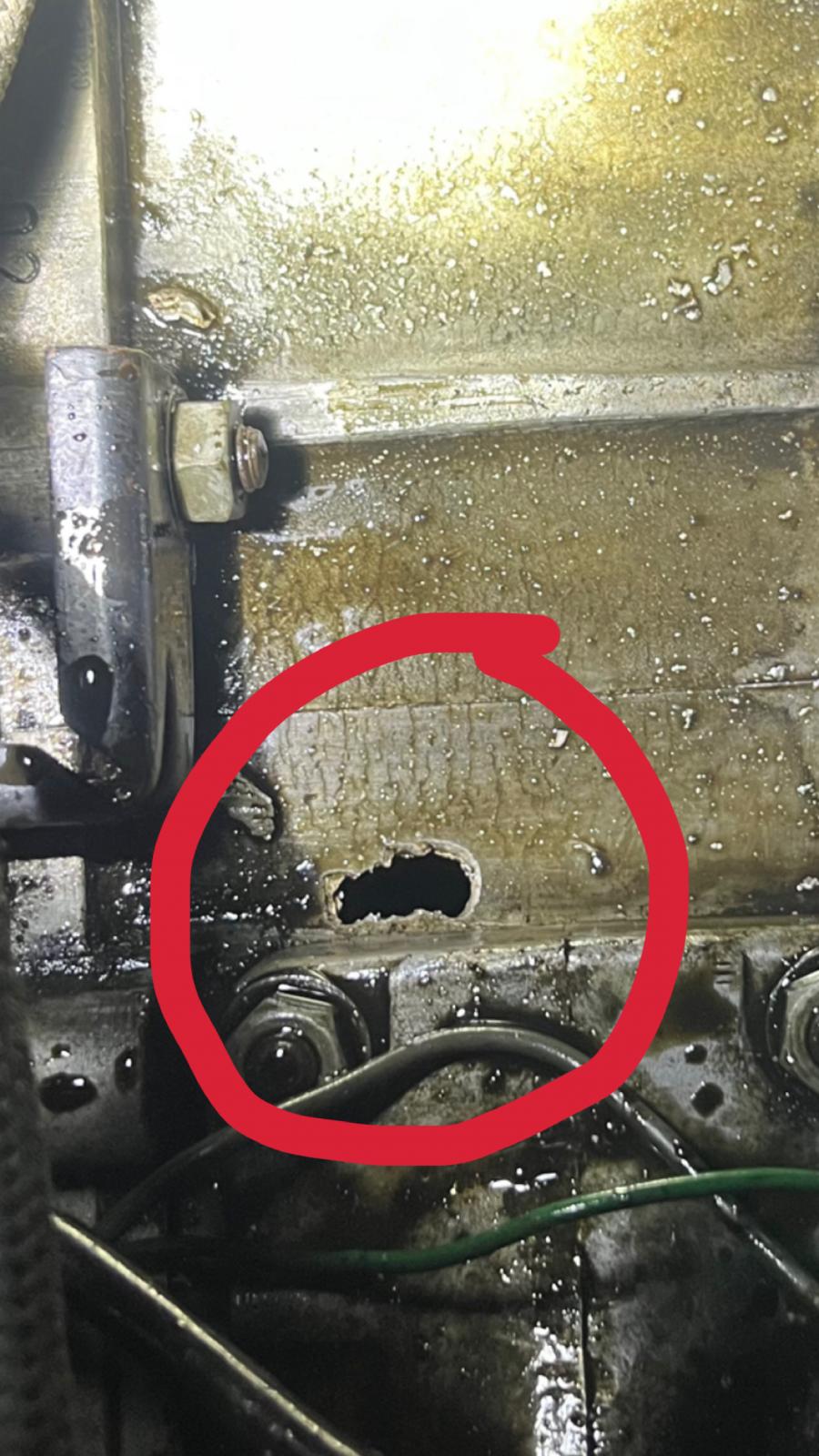

R.I.P. motor.. it decided to take its own life this evening. No idea what coulda happened right now. The only thing I know is that it didn't want to live in this world anymore hence the unrepairable damage done to the case. Showed no signs of having an issue until not even 5 seconds before it decided to quit and go CLUNK. All I hear was some clackity clack clack and some rickety tick tick and it wasn't even 5 seconds long until like is said.. it seriously went CLUNK. I don't even think the oil pressure sensor light had enough time to chime in before the... dare I say it again.. CLUNK. That noise will haunt me for months.. R.I.P motor. Embarassed

WOW, that looks like a rod let go and popped the case on top. I've had a rod snap on the fwy before, and it broke the cam in two, but everything stayed in the case. I later rebuilt it and ran it for two years before I sold the car.
