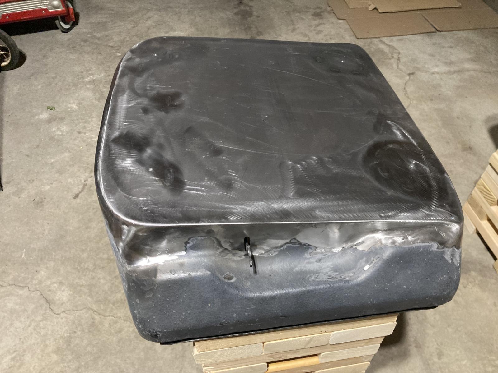

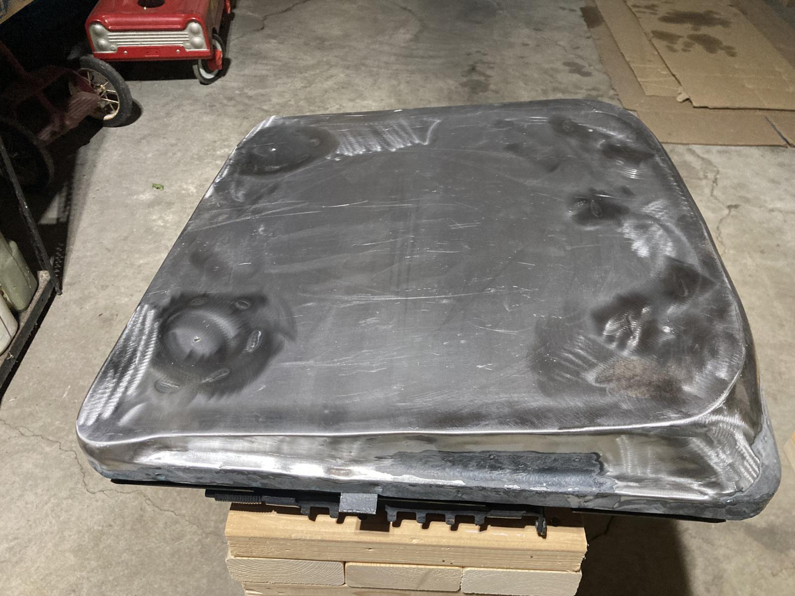

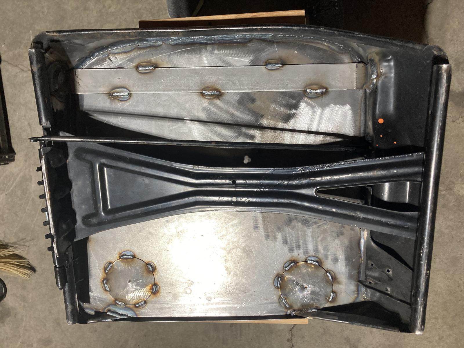

Some progress on the interior, installed the Sewfine door panels.
Picked up a second set of seat bases to use for the new seats. Mapping out a plan to cut these down.

Seat bases are ready for bodywork and paint.

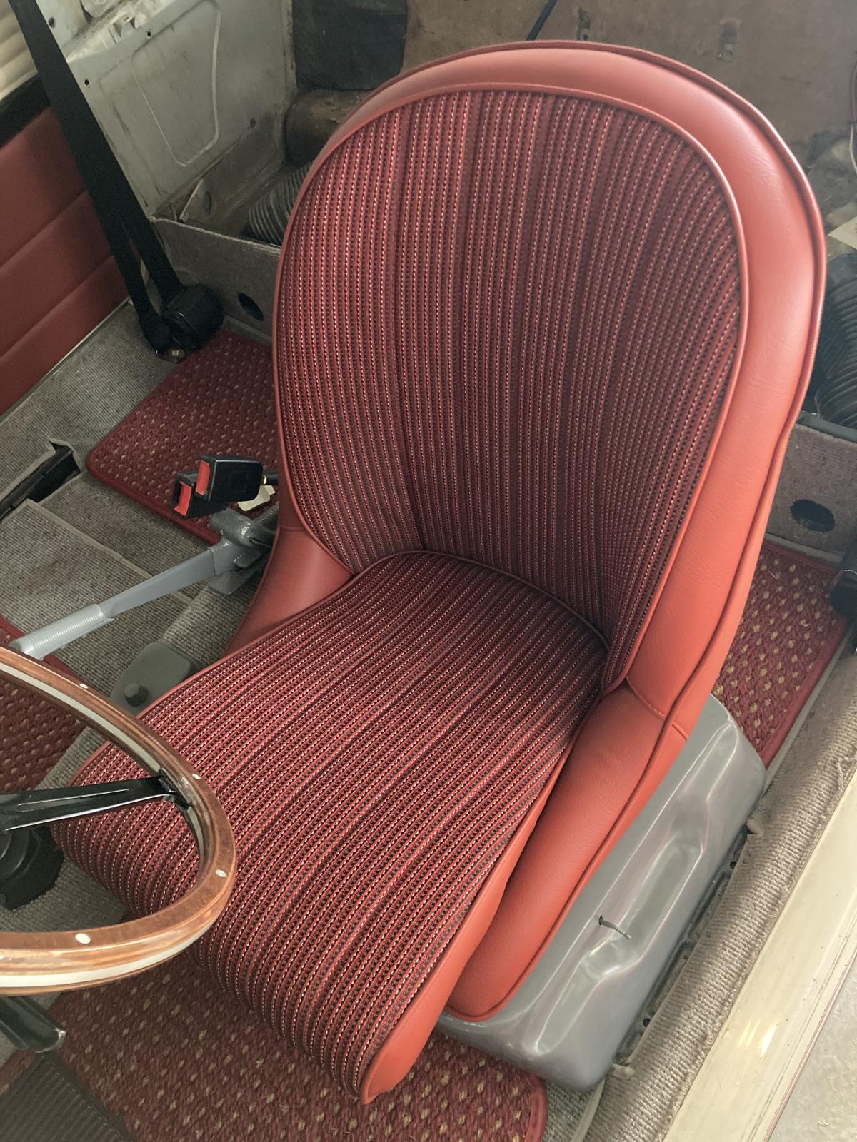

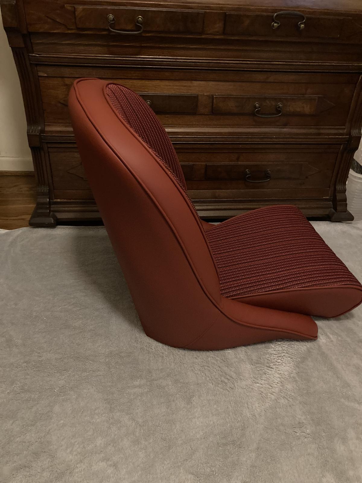

Update on my interior upgrade. First, a recap of how I got here. A few pages back I shared that the first upholsterer did a GREAT job on the front seats but screwed up the back seat, pattern was wrong and the quality was poor. Once I got the car on the road, I found the front seats are just not comfortable for me. Maybe it's because I'm 15 years older than when I had last driven the car or maybe I just didn't remember they were always uncomfortable because it had been 15 years.
I purchased a period correct set of Cobra Roadster XL seats for the front and I ordered more of the same cloth to cover the front seats and to recover (fix) the back seat. SMS Auto Fabrics has the WORST customer service, I hope I never have to deal with them in the future. I ordered the additional fabric, they charged my credit card then never got back to me. After two weeks I checked back and SMS informed me the fabric was out of stock and they were working with a weaver to get more made, could not give me a target date. Another month of no update from SMS so I called them back and was told they still didn't have a date but they would get back to me in a couple days after they checked with the weaver. A week later, still no update from SMS. Long story short, this went on for another 2 months, no update, I would call and they would tell me they would call me back with an update but never did. I eventually got my fabric and it is nothing like the first batch. Not just that the color is a little different, the pattern is considerably different. I guess I'm glad I had to recover the back seat anyways. Typical car restoration challenges.
Got my seats back from the new upholsterer today and they look GREAT! Not quite ready to install because my modified front seat bases are not done. I have not finished body working and painting the bases and now we're into winter weather so I'll have to wait for some random 50 degree day before I can paint. No big deal, car is stored for winter now anyway. Any progress is good so I'll take the win.

Yeah, that material does look a little darker than the first set of pics. I don't know if it's the light or not, but they sure do seem darker. Sad

The seats look great redone. Can't wait to see them on the bases.

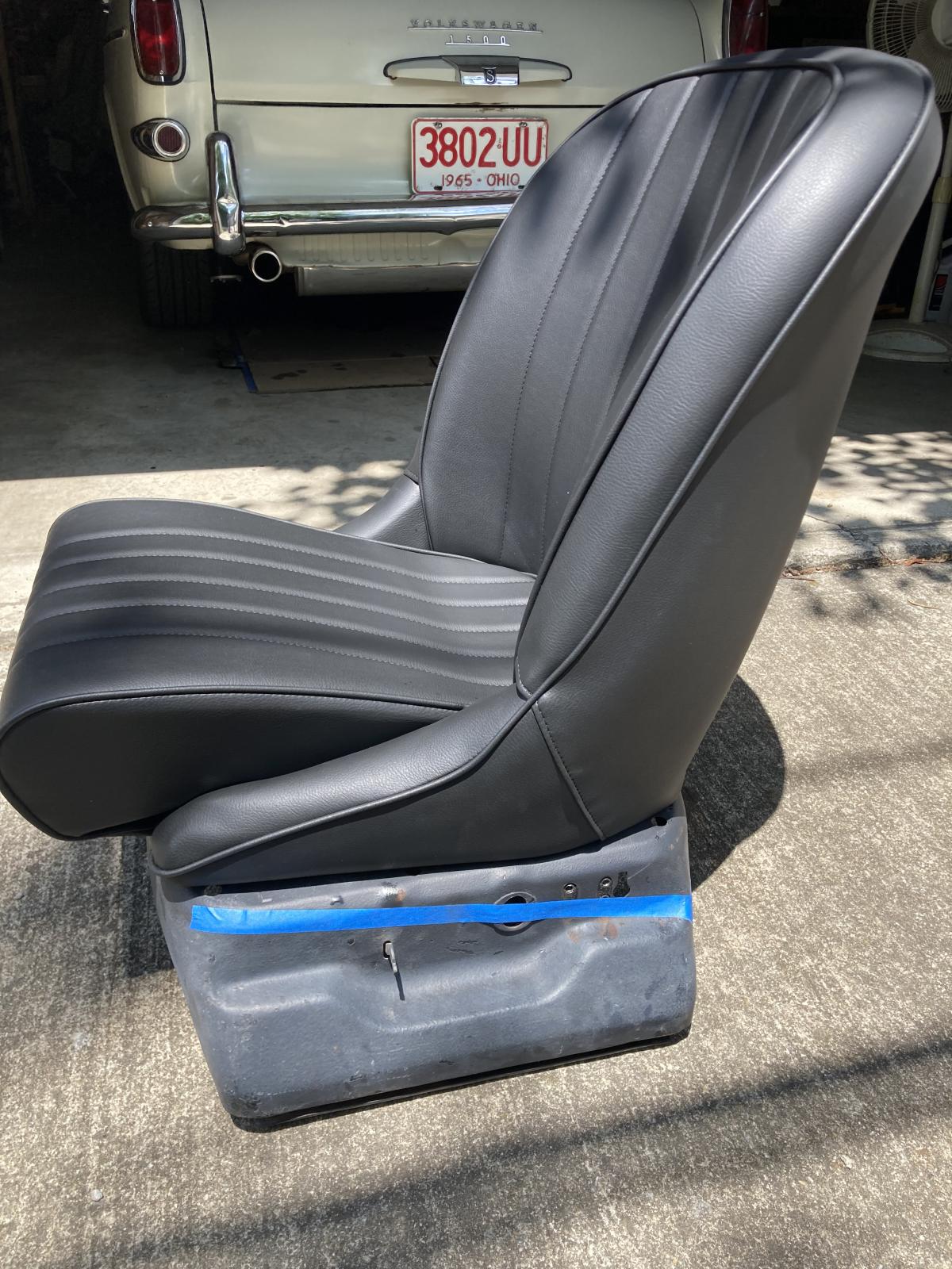

A little progress. Mounted one of the seats on the base to check fitment. So far so good. Final coat of paint on the bases and they'll be ready for final install.

That seat idea is fantastic. Keep the updates coming.

That whole interior is just stunning. Well done.

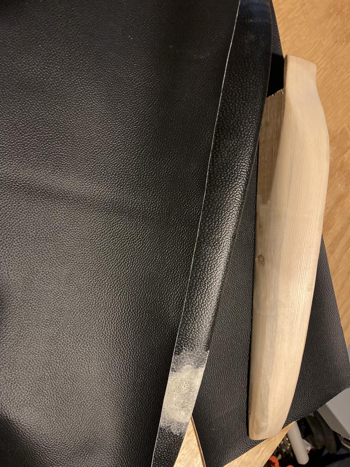

One more… for the side panels where the extra material wraps around the door pinch seam, there is glue residue on the inside but none on the door jamb side of the seam. Is it correct to glue that “flap”?
Here’s a comparison of the vinyl pattern. I made a buck to practice how the vinyl stretches.
