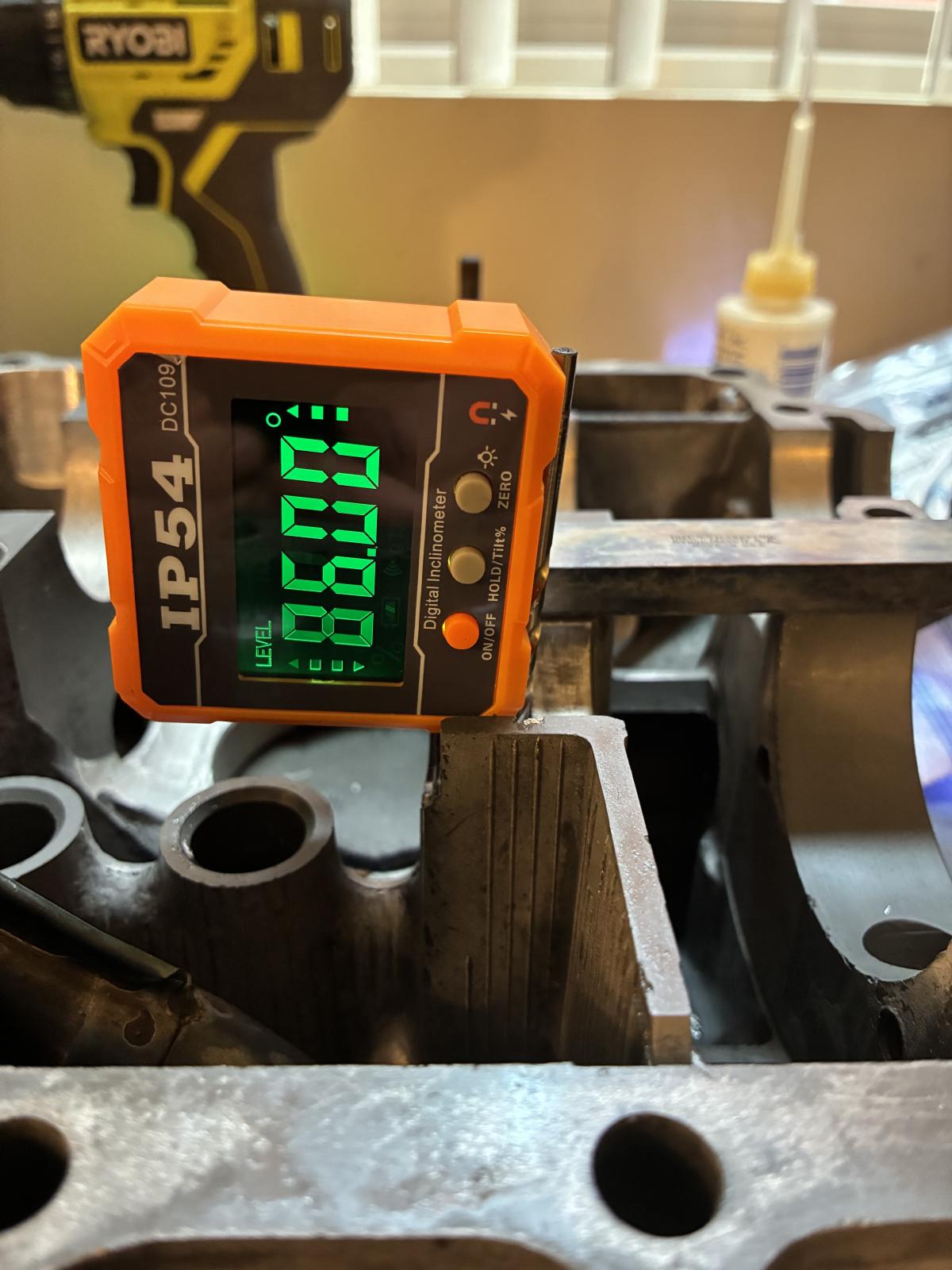

PostPosted: Sat Jun 07, 2025 1:53 pm    Post subject: Re: Crankshaft Crossroads - Now 2027 Build Reply with quote
Did some more searching and pondering over this oiling situation. I guess I was looking for a compelling reason not to drill the case oil galleys, other than I risk punching a hole through my case.
Found lots of reasons to do the drilling and no other compelling reasons not to, so, after a bit of liquid courage and some preliminary measurements using a spare pushrod, a sharpie, and an eyeball to guesstimate how much room for error I had in the case casting "valley", I went for it.
Here's the flow through after drilling using the kitchen sink as a test bed - nailed it!
For anyone who has never done this and looking to give it a try, here's the angle I used to punch through the cam tower to the lifter galley:
Baseline:
Drill bit:
yielding a ~ 3.5 - 4* down angle from the cam tower to the oil galley, working rear to front. This isn't a critical angle to hit, just get in the ballpark and it should work. For the case top to bottom angle, I didn't measure that one but will be easy enough to do if anyone needs it. Or, leave the long drill bit in the lifter galley so it can guide you to the target, you have to sight that one in. Make sure to use a drill stop collar and work your way up to it slowly, checking your work along the way.

PostPosted: Sat Jun 07, 2025 1:57 pm    Post subject: Re: Crankshaft Crossroads - Now 2027 Build Reply with quote
One thing I forgot to ask that I did not find a difinitive answer for in the Hoover Mod thread - is it still necessary to widen the #2 cam tower oil trough if the #3 tower to oil galley has been joined by the drilling?
txoval
Joined: January 23, 2004
Posts: 3820
Location: The Woodlands, TX
txoval is offline
PostPosted: Sat Jun 07, 2025 2:51 pm    Post subject: Re: Crankshaft Crossroads - Now 2027 Build Reply with quote
Look at how much meat you have on that bearing saddle from clearancing for crank.
I wouldn’t touch it
Rob Combs
Joined: December 30, 2020
Posts: 441
Location: South Bay LA, California
Rob Combs is offline
PostPosted: Sat Jun 07, 2025 3:43 pm    Post subject: Re: Crankshaft Crossroads - Now 2027 Build Reply with quote
I appreciate the response.
Question being, is there a benefit to doing so, though? Or is any benefit already captured by virtue of the case drilling/joining the galleys?
You are right, there's not much material left on the cam tower after the clearancing, and on the other side of the groove is the bearing tang slot.
But if there is a real benefit, could one groove just the lower half of the oil trough and leave the top half, near the clearanced section or the bearing tang slot, as it is?
Plenty of meat down on the lower half of the towers...
