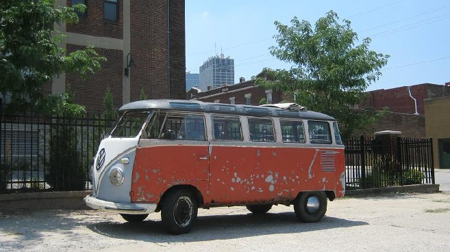

So we took the leap and started this on our Bus.
The red comes of pretty easy....it's all rubbery and gross, dunno what they used to paint it!! The white is really tough though.
But there is loads of filler under the red and white. It seems the bus was prepped pretty well but then just painted with really bad paint
The original top is kind of like a creamy white...There is blue underneath that but only a very thin layer....So think the bus was originally blue/white....But it was a Kombi and I thought those were mostly single color. _________________ 1966 11 window
Rusty as hell.

Our bus seems to be blue on the bottom and creamy white on top....But under the cream/white is also blue.
Where 2 toned busses painted the entire bottom color first and then the top?
What color would you say this is under the white:

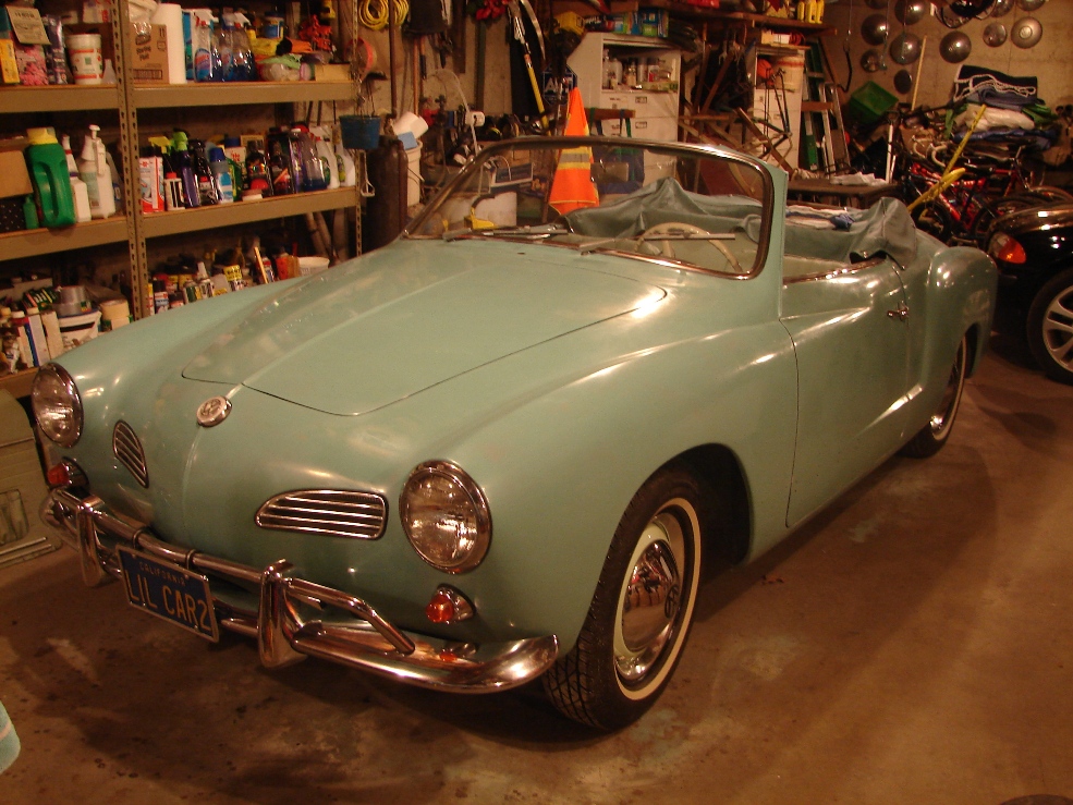

I was in my garage a few weeks back looking for something to do. I started to pick away some of the blue paint on my bus at the top of the screen post - I'd chipped some blue off last year and found the original L345 grey under it. So after a couple of hours I'd stripped the screen post and decided to carry on after reading this thread. After many hours work using Nitomors paint stripper, I've just finished the front end. I'm happy with how it turned out - just got the rest of it to do now.

Looks fantastic, 6voltbus! Can't wait to see more. How did you blend your paint in? _________________ RIP HBB (1984-2009)

Posted: Wed Sep 07, 2011 4:14 pm Post subject: |
| Thanks for the compliments guys. I bought a tin of L345 grey but either my old paint had faded or the new paint was too dark as it didn't match too well. I took a small amount of paint then started adjusting it with white and yellow untill I was happy with the colour match. I only wanted to paint the areas that had been bare metaled so I used a small airbrushing gun to spray it. I tried to just overlap the old paint with light coats of paint to avoid leaving a line - it took 2 or 3 attempts before I was happy with it. After it had dried I carefully polished the paint back to blend it in. It did take a while as I'm not a pro painter but getting the colour right is important if you're just doing a small area on a large panel. The smaller stone chips I did with a small brush then polished them later. It isn't a show quality job as the paint is 53 years old and going thin in a few places. I just wanted a tidy looking VW with as much original paint as possible. |
