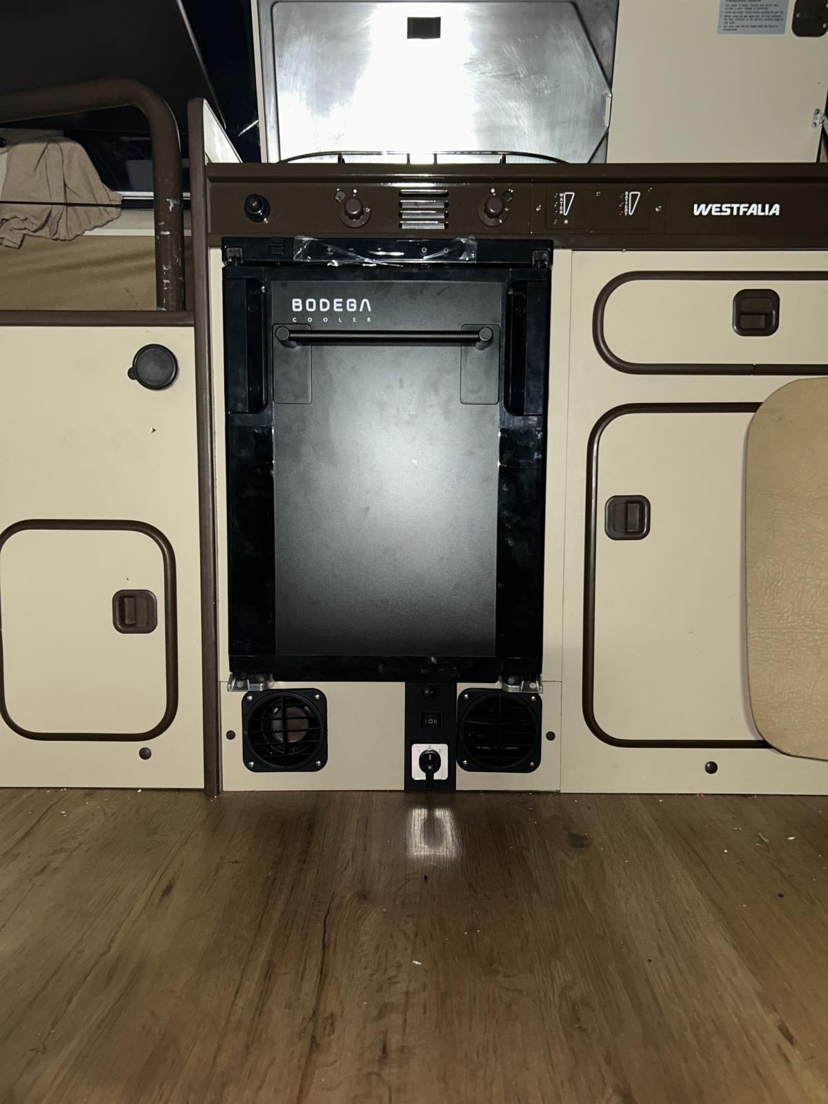

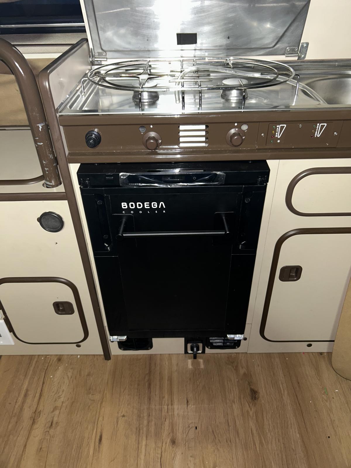

PostPosted: Sat Mar 01, 2025 7:06 pm    Post subject: Re: fridge replacement projects - post here Reply with quote
Here is my bodega 45L install with a Propex hs2800.
