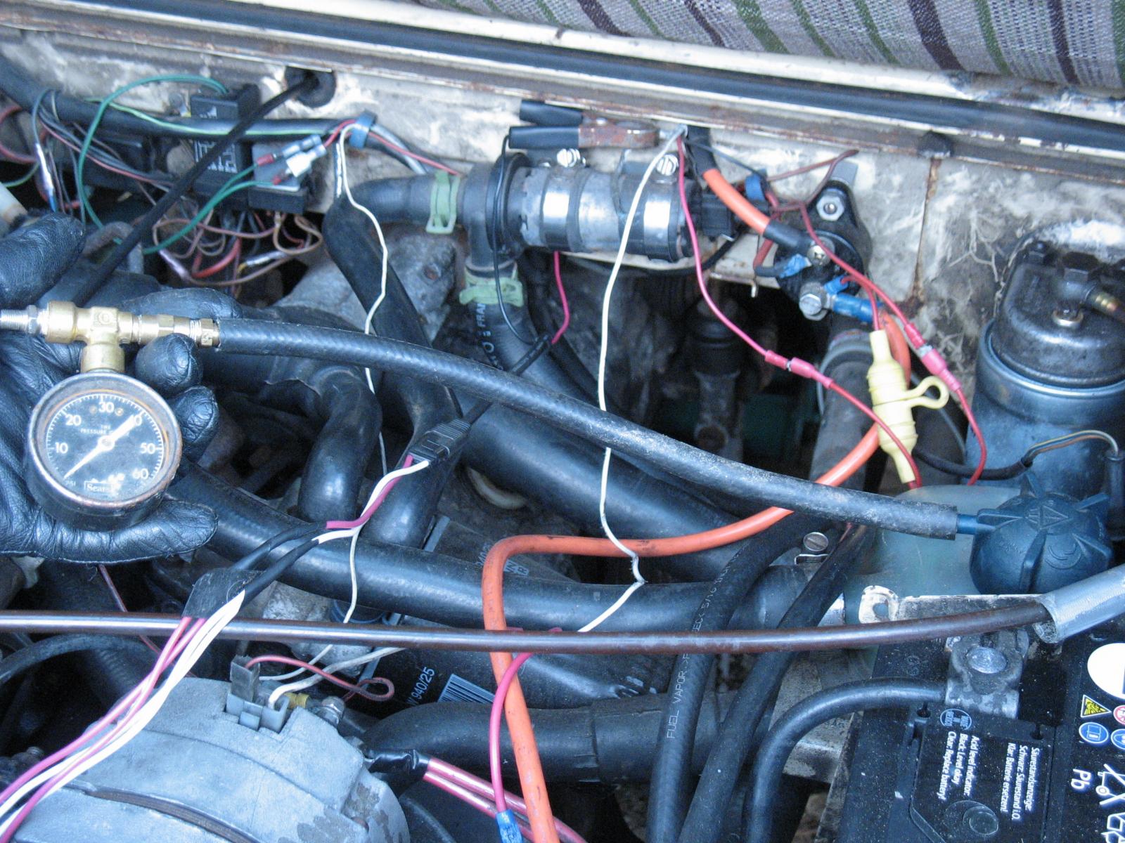

this is the tool i use to bleed my JX Diesel system (86 drive train)
as you can see the essential components are a T fitting, a pressure gauge, a Schrader valve, a hose barb, and a short length of hose.
place the hose over the nipple of the expansion tank cap and pressurize to about 5 PSI. any air sorce from a bicycle pump to shop air will do. then open the bleed valve on the radiator. refill tank and repeat as needed.
it also works on the earlier style tanks with the U.S type radiator cap. (original 82 drive train)
