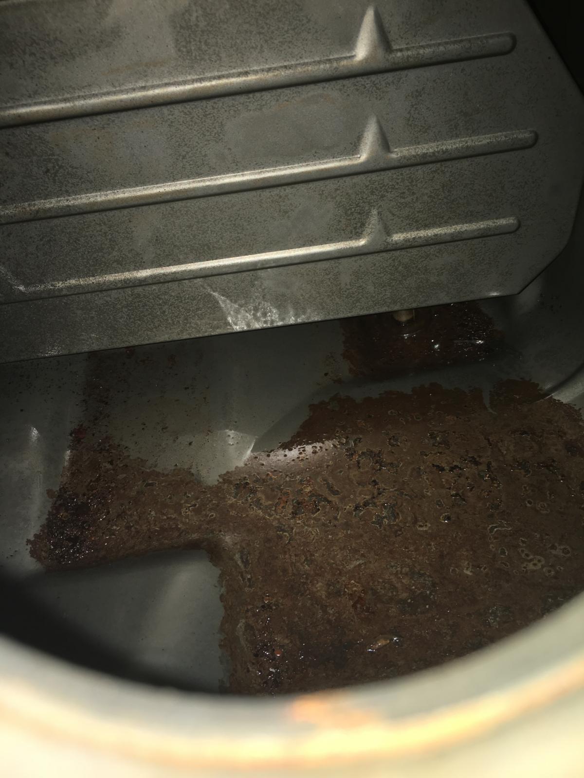

bus68us wrote:
Here's what my tank looks like after 2 muriatic acid washes of 1 hour each and a phosphoric acid wash. Did I do something wrong or is it supposed to get flash rust after ospho?
That looks like it has flash rust after the hydrochloric acid (aka muriatic acid, for some reason) wash. With that bit of flash rust in there, it is perfectly ready to hit with Ospho (which has phosphoric acid in it, but is not the same as generic cheap phosphoric acid -- don't cheap out) to turn that nice thin layer of iron oxide into iron phosphate. Go back and read Ray Greenwood's bit on why you need a thin layer of iron oxide in order for the Ospho to work.
After the Ospho has had a chance to do its thing (let it dry well, like a day or two), the rust color should turn a dark brown or black. Then you hit it with a coating of mineral oil or ATF or thin motor oil just to keep it happy until it gets back into service.
At least that is my take on it, after reading this entire thread.

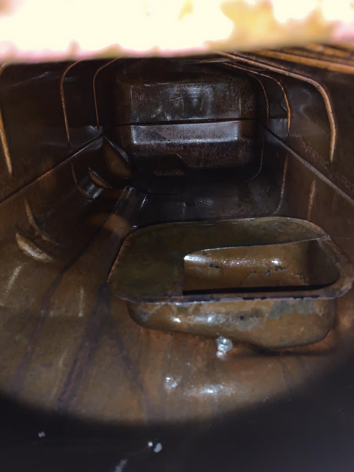

Hey guys,
So this weekend I finally pulled my fuel tank out.
It was pretty bad, basically the bottom half covered in rust. I did what was suggested. Muriatic acid 1:1 with water. Rinse with baking soda. Then I used fan to dry it quickly. Once that was done i poured some rust converter (phosphoric acid) into the tank. Will let dry over night. Tomorrow I will be pouring ATF in there.
I am very happy with the result. With the one exception.....my tank is now pink inside, like it was made out of copper. Is this normal? Did everybody else end up with pink tank after using phosphoric acid?
Thanks!

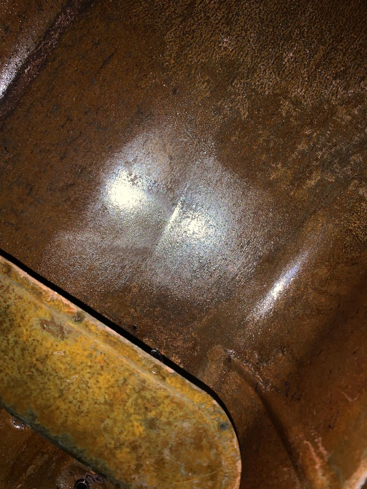

This is what I came to today. I am so dissapointed. After muriatic the tank was like brand new inside. Nice silver color. This is what the rust convertor did. I am not liking it at all

Too fast.
You do NOT want to dry the tank quickly after using muriatic acid. The object is to let is flash rust. It needs to have a nice even layer of DRY surface flash rust.
Which phosphoric acid product did you use?
You have to pay attention to the solution strength and what the product description is.
For example...in the past....Jasco metal prep and prime was my go to product (no longer made now). But....straight from the container....it is far too strong and will remove all rust and leave nothing to convert. Its directions note that for rust removal....use straight from teh container. For rust conversion....dilute it with water 2.5X to 1.
Also a lot of phosphoric acid based products have a surface coating polymer mixed in. That may be what you are seeing. Ray

Product i used is called Pro-Form rust comvertor. According to data sheet it contains 10-30% of phosphoric acid, isopropyl alcohol and cupric sulfate. It says fo not dilute and must be topcoated. Let dry for 24 hours.
Its pickle. What to do now? Repeat the while proces and hope it will deal with this brownes?
I would need to find something else obviously for conversion. And when you dilute phosphoric, you just use water?

You can try some Phosphoric and see what it does to that golden brownishess, if not a quick Muriatic wash will get it off. As Ray mentions a fine layer of orange after it dries from rinsing out the Muriatic makes the Phosphoric work better. Don't do more than 2 hours with the Phosphoric and dry it quick after rinsing that stuff out, a leaf blower works great for that.
Thanks Mark, I will follow your recommendations. There is couple things I am no too sure about...
1.I will source the product you recommended, I have a shop not too far from me but they were not open on the weekend. But for that, do you use the phosphoric straight out of bottle or do you dilute it?
2.One of my mistakes I guess I left it there for 24 hours which was recommended on the bottle so I will definitely cut the time to 2 hours. Shop vac works magic for me for drying. When you say after rinsing that stuff out, you mean after two hours of Phosphoric, rinse with water? Or?
Also I will just sum thing up,
Muriatic Acid for 15-30 minutes
-) empty tank -) pour water with baking soda to neutralize the Muriatic -) let dry enough to create slight rust film -) Phosphoric Acid in the tank for 2 hours -) empty tank and rinse with water and use shop vac to dry quickly -) ATF because It will be sitting empty for a bit

I did one last week, repeated Muriatic soaks until clean, followed with a water rinse (no baking soda, no drying), next day a cup of hydroponic supply PH down (80% Phosphoric) into the cup or so of water that was still in the tank, roll around the yard an hour or two then drain and rinse with water. Then force dried immediately and finished with ~1/2 cup of ATF.
Since you have already gotten the big scale off it shouldn't take long with the Muriatic to get it bright inside again, the stuff in there now doesn't look heavy.
