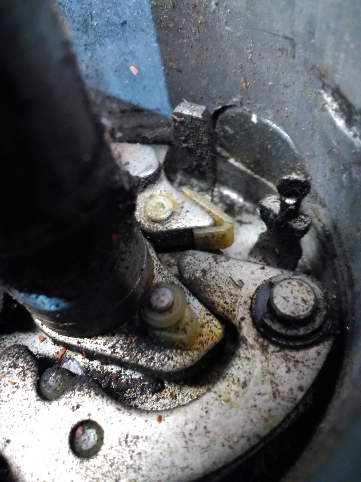

I know this thread deals with OEM distributors, but has anyone here disassembled, cleaned, lubed and reassembled (fixed) a German 009 distributor? I bought a decent looking one from eBay and want to service it for a spare.

PostPosted: Tue Jan 30, 2018 6:31 am    Post subject: Re: Distributor 113905205T rebuild *PIC Heavy* Reply with quote
I've done a few 009s.

PostPosted: Tue Jan 30, 2018 7:57 am    Post subject: Re: Distributor 113905205T rebuild *PIC Heavy* Reply with quote
Hi Glenn,
Am I missing a spring or is there only supposed to be one depending on model? Can I just wing it and get any spring the seems/fits the same?

PostPosted: Tue Jan 30, 2018 8:38 am    Post subject: Re: Distributor 113905205T rebuild *PIC Heavy* Reply with quote
Only 1 spring.
You can't use just any spring and expect the same curve.

PostPosted: Tue Jan 30, 2018 7:28 pm    Post subject: Re: Distributor 113905205T rebuild *PIC Heavy* Reply with quote
Yikes! Shocked That distributor was clearly stored/left in the weather. Lots of rust and corrosion in that one. A great reason why I won't buy any used distributors from the rust/salt belt.

PostPosted: Tue Jan 30, 2018 7:34 pm    Post subject: Re: Distributor 113905205T rebuild *PIC Heavy* Reply with quote
Other than some pitting on the breaker plate, it cleaned up fine and works like new.
Some can't be saved.
