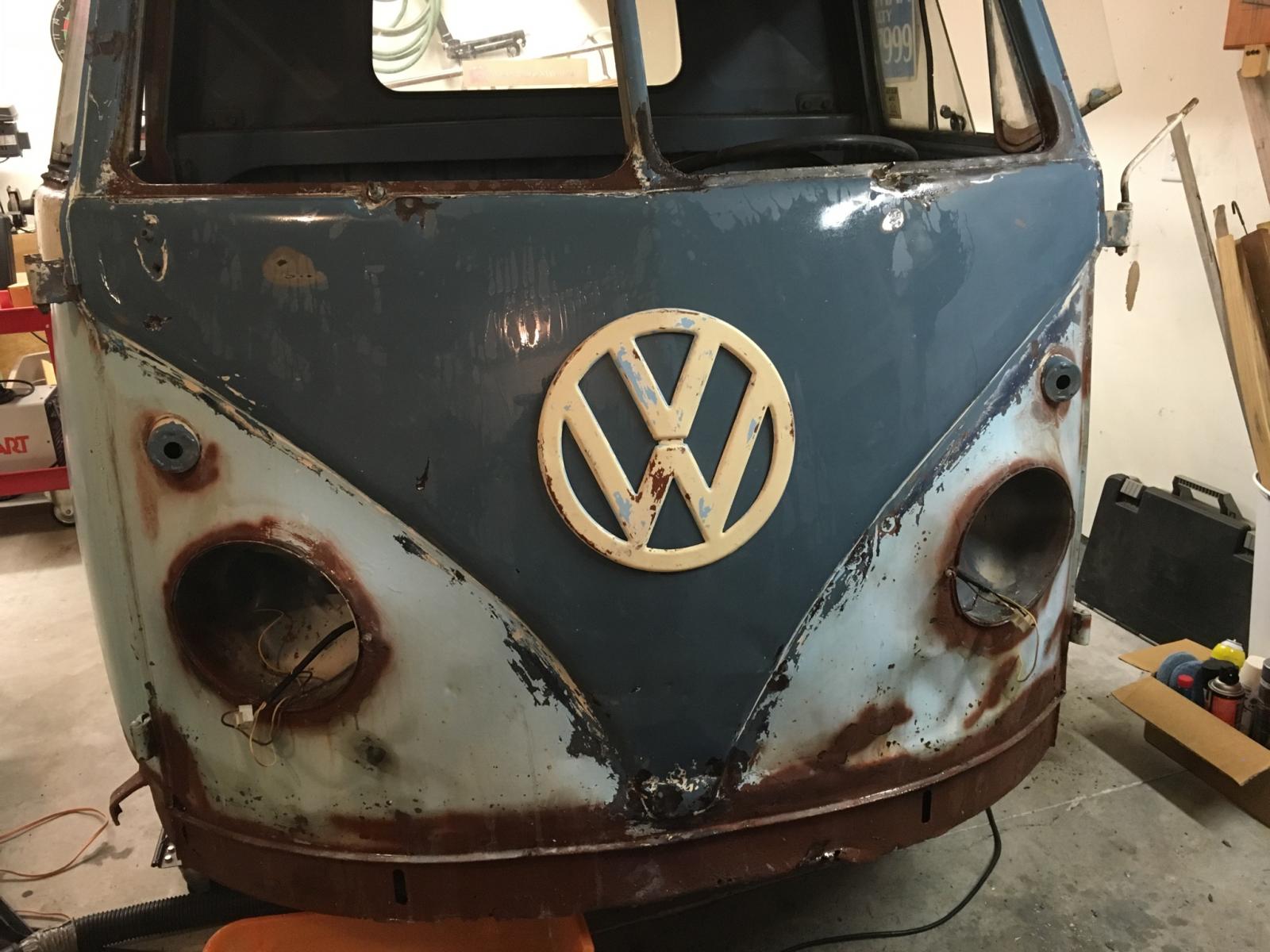

And now I have an entire new appreciation for what goes on in this thread!
Method- Easy off oven cleaner... when layer bubbles, straight razor scrape and repeat. When last layer is revealed, wash down and switch to 0000 steel wool then elbow grease down to dove blue. This area took one can of the cleaner. I was bold and started out front and center! If this area didn't come out nice... the rest would've been pointless to me. To each his own.

PostPosted: Thu May 26, 2016 12:13 pm    Post subject: Re: Removing aftermarket paint to get OG paint Reply with quote
thats cleaning up nice. the heavy duty EZ Off oven cleaner works better that the regular stuff. also try using a heat gun or hair dryer to warm the panel up in small sections, that helps tremendously. keep it up!

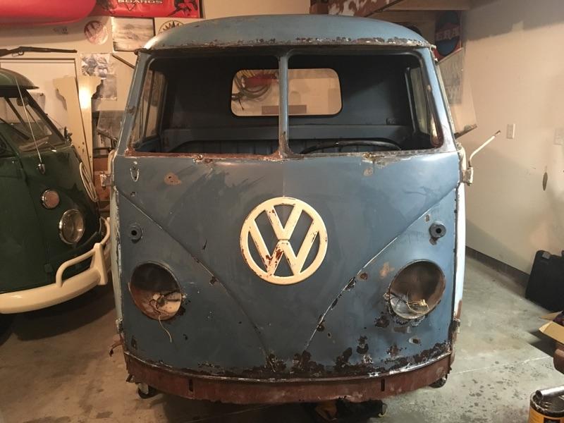

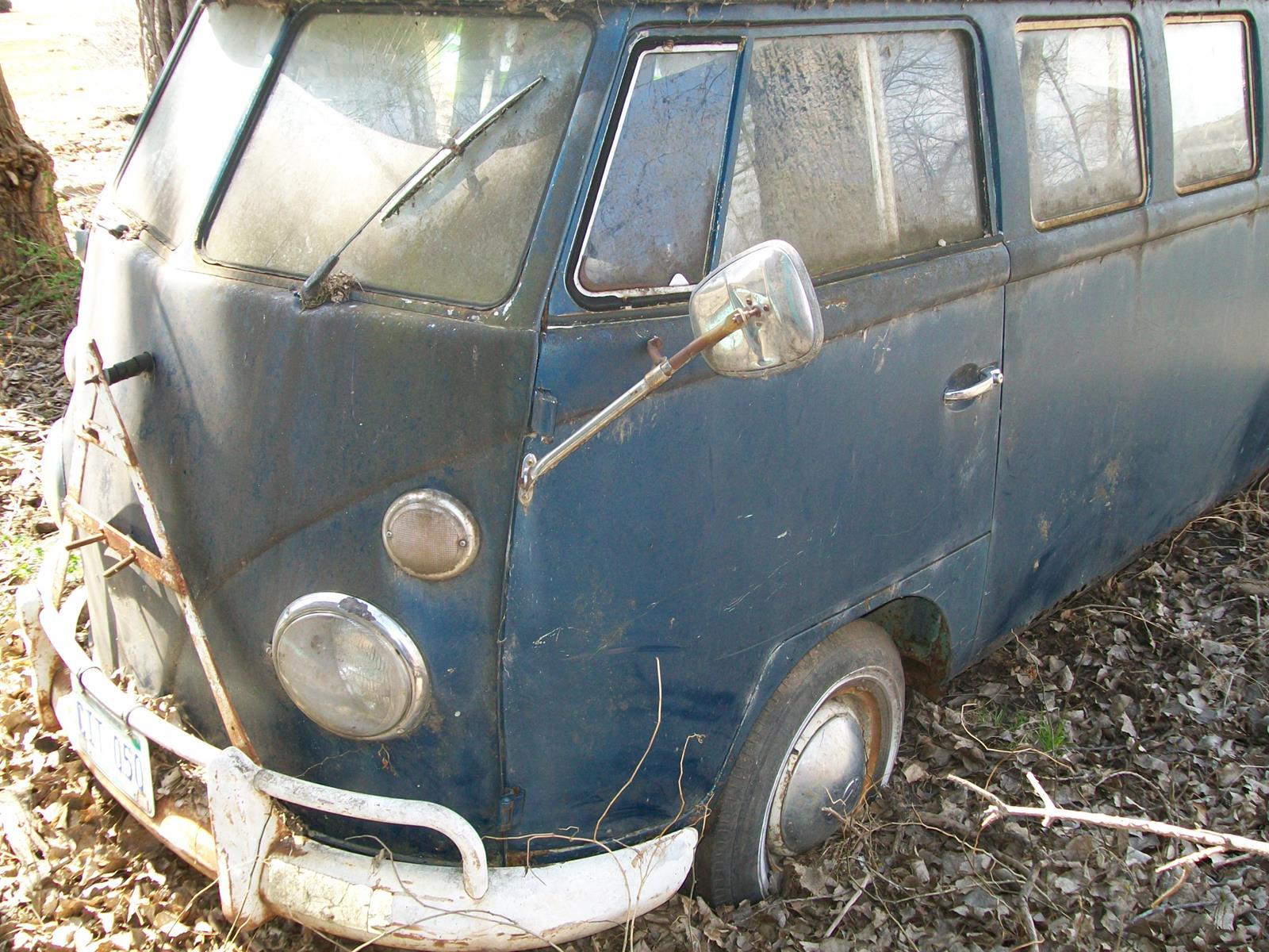

This is my first post and I am looking for advice on OG paint to the engine compartment as well as the rest of the car.
I would like to restore the OG paint wherever possible on the car and touch up spots with dulled/mixed paint.
Regarding engine compartment, there is quite a bit of surface rust to the RHS. Do I use rust remover to remove as much of this as possible? Do I then sand down or simply seal, or paint? Whatever I do I guess I have to neutralise that rust...
I have not had much luck restoring OG paint from the vehicle. I think I need more elbow grease... and have visited hardware shops today to buy as many products as I can. I am in a remote location and that means that products such as Easyoff and graffiti remover, acetone do not seem to available. Paint remover is, and sandpaper and scotch brite equivalent so tomorrow i'll arm myself with those and a big bucket of water, as suggested on this forum.
Am I right in thinking it will be a real pity to not give it my best shot in restoring OG paint? Other option would be to paint new...
Your advise and tips are much appreciated. I am doing this as best as I can and wish to give the bus the respect it deserves.

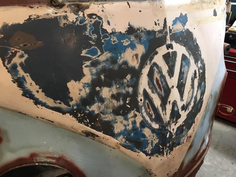

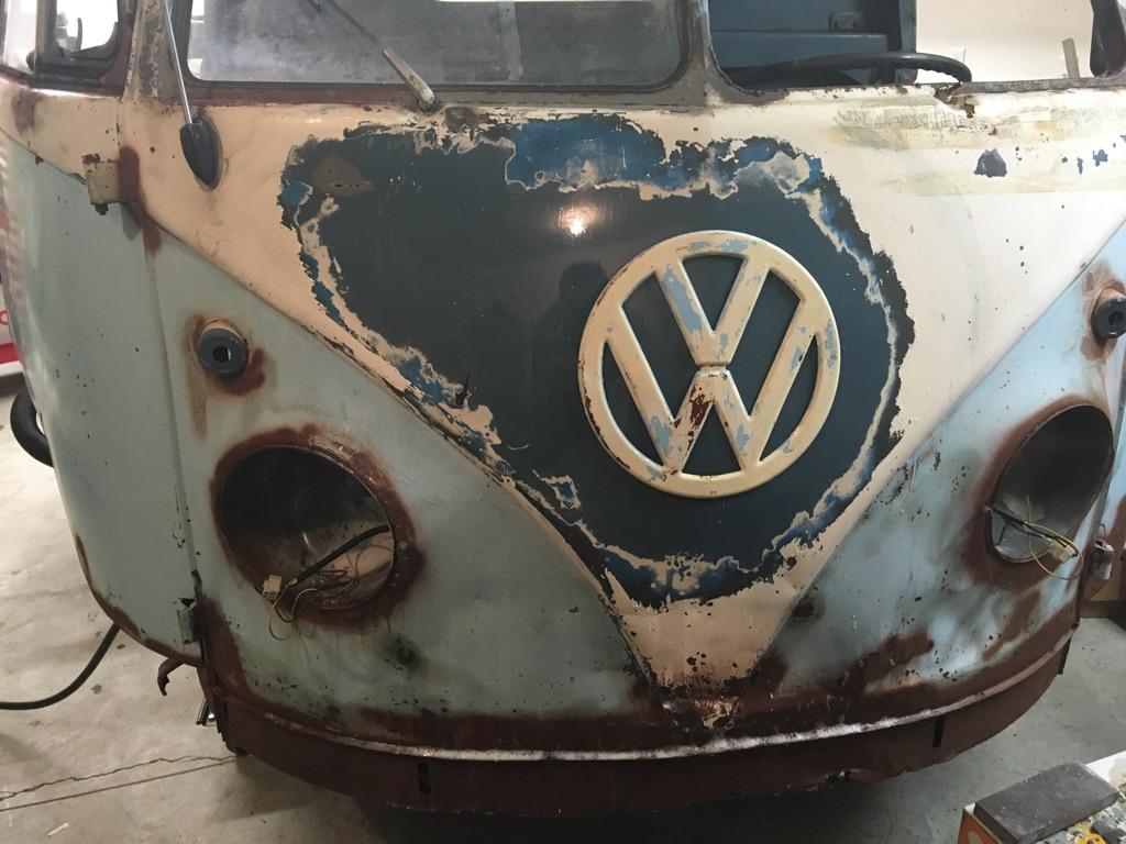

PostPosted: Mon Nov 28, 2016 7:55 pm    Post subject: Re: Removing aftermarket paint to get OG paint Reply with quote
put this on for 5 minutes and just wiped off
I mean it's probably going to look terrible when done, but it's trial and error.

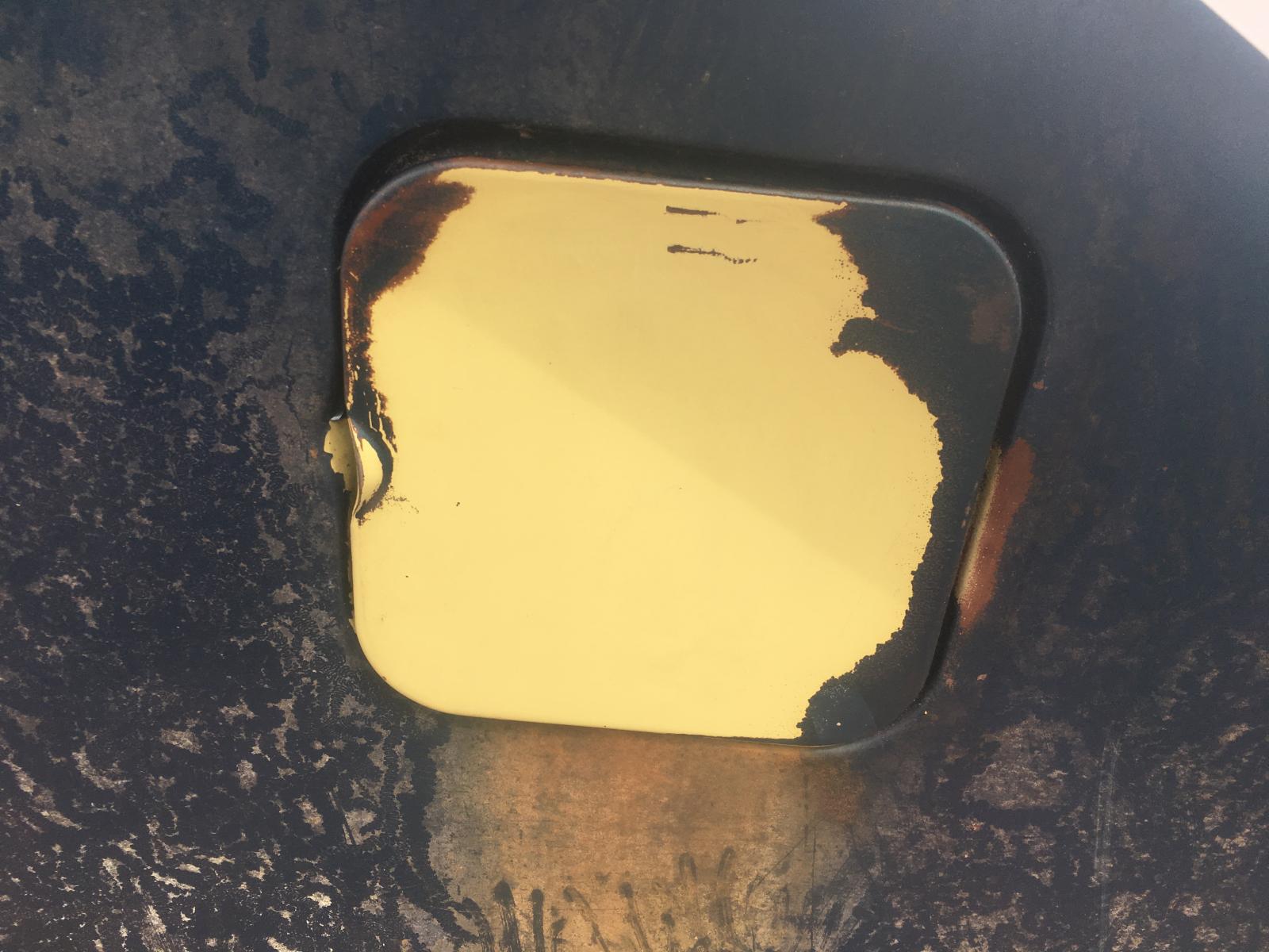

I am trying to remove the paint on my double cab. I have done one test section and it is pretty rough. The truck looks like it was extensively body worked before it was last painted. They sanded down all the high spots to bare metal and used filler to fill in the low spots. Take a look. I was really excited to strip the paint down on this as it might be the only known double cab in the Postal Yellow color. It does still have the M code plate it started out as a postal yellow color per the m code and all other evidence.
Do you think I should keep going? I am not sure how much original paint is left as it appears it was sanded and body worked pretty seriously. It has original paint, then a quick repaint in the original yellow, then primer and red, then black primer and a grey base coat. It is a lot of coats and the top two were professionally down so they do not come off easily. It also has skim costs of bondo to even out the low spots.

PostPosted: Fri Mar 17, 2017 3:46 pm    Post subject: Re: Removing aftermarket paint to get OG paint Reply with quote
ronjonlasvegas wrote:
..Do you think I should keep going?
I can fully understand your a bit disappointed. My front and doors turned out to be sanded with 80 grit, while they left the rest untouched.
I think if you strip some more panels and you see the postal yellow appearing, you get more excited, despite the sanded/filled spots.

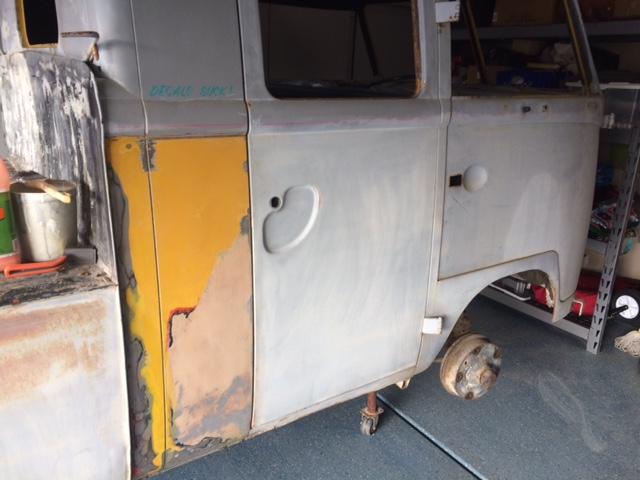

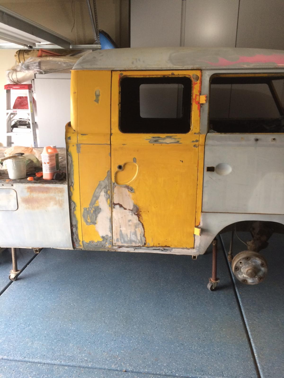

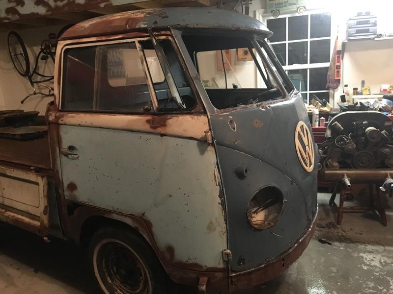

I had a little more free time and stripped some more paint off last weekend. I am using citrus strip and a razor blade scraper from Home Depot.

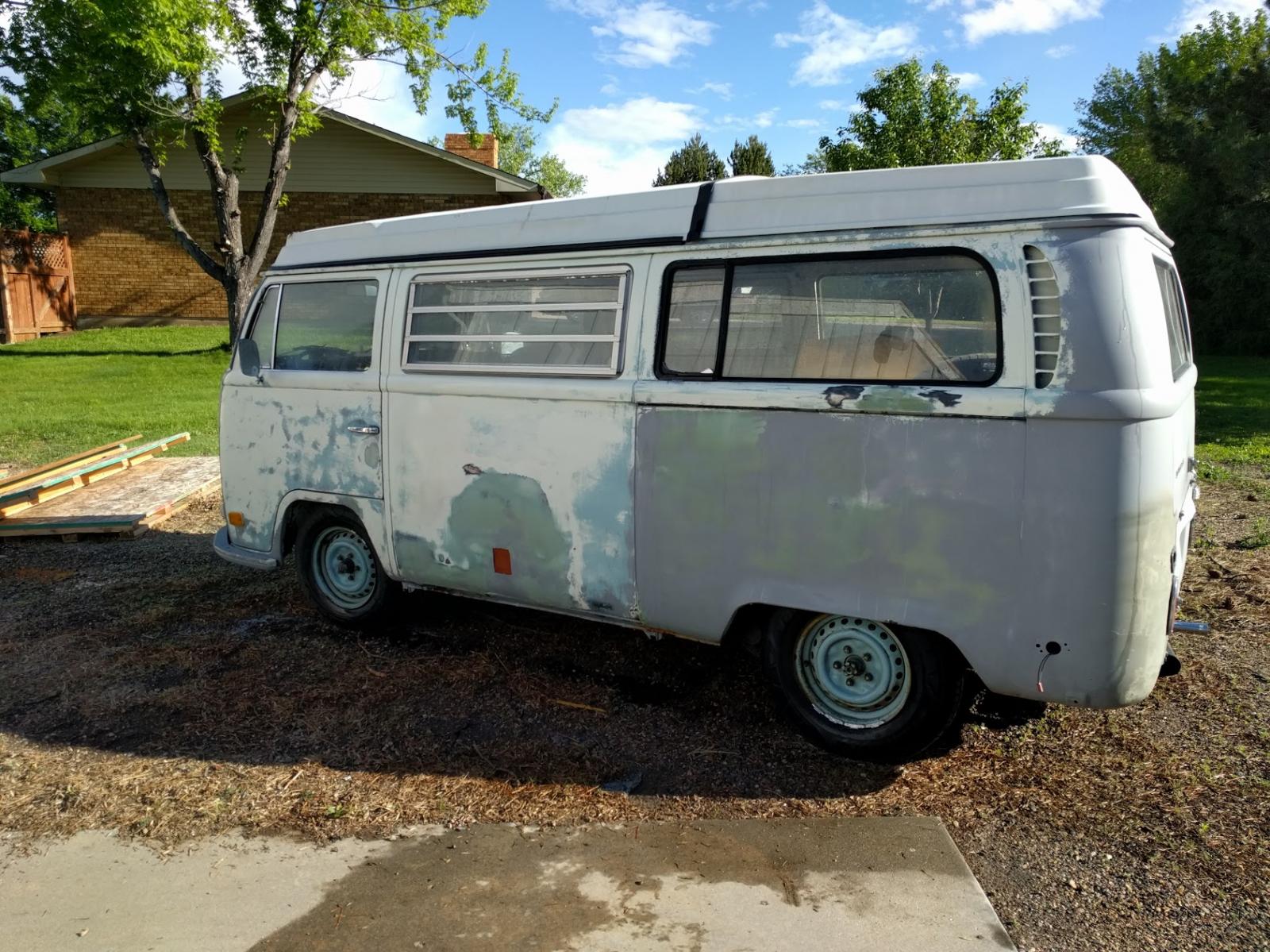

PostPosted: Sat Jun 03, 2017 7:32 am    Post subject: Re: Removing aftermarket paint to get OG paint Reply with quote
After too many hours of work, but it's nice to see some progress.
The bottom half will be fixed and repainted at some point, but instead of driving around with a bondo mess (it was in a wreck on the left rear), i'll peel it back and paint it later.
Some of it comes of like a knife through butter, and some of it no amount of scrubbing and respraying and scrubbing again will take it off. Wonder why.
Using Lift-Off to remove the primer, and Oven Cleaner seems to work best for the old blue paint.
