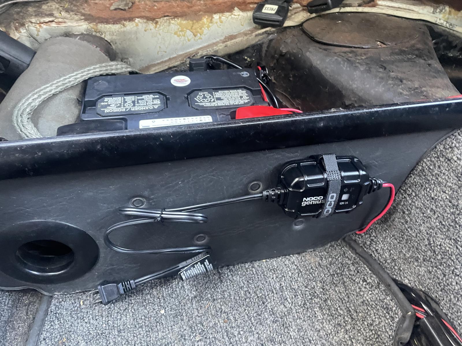

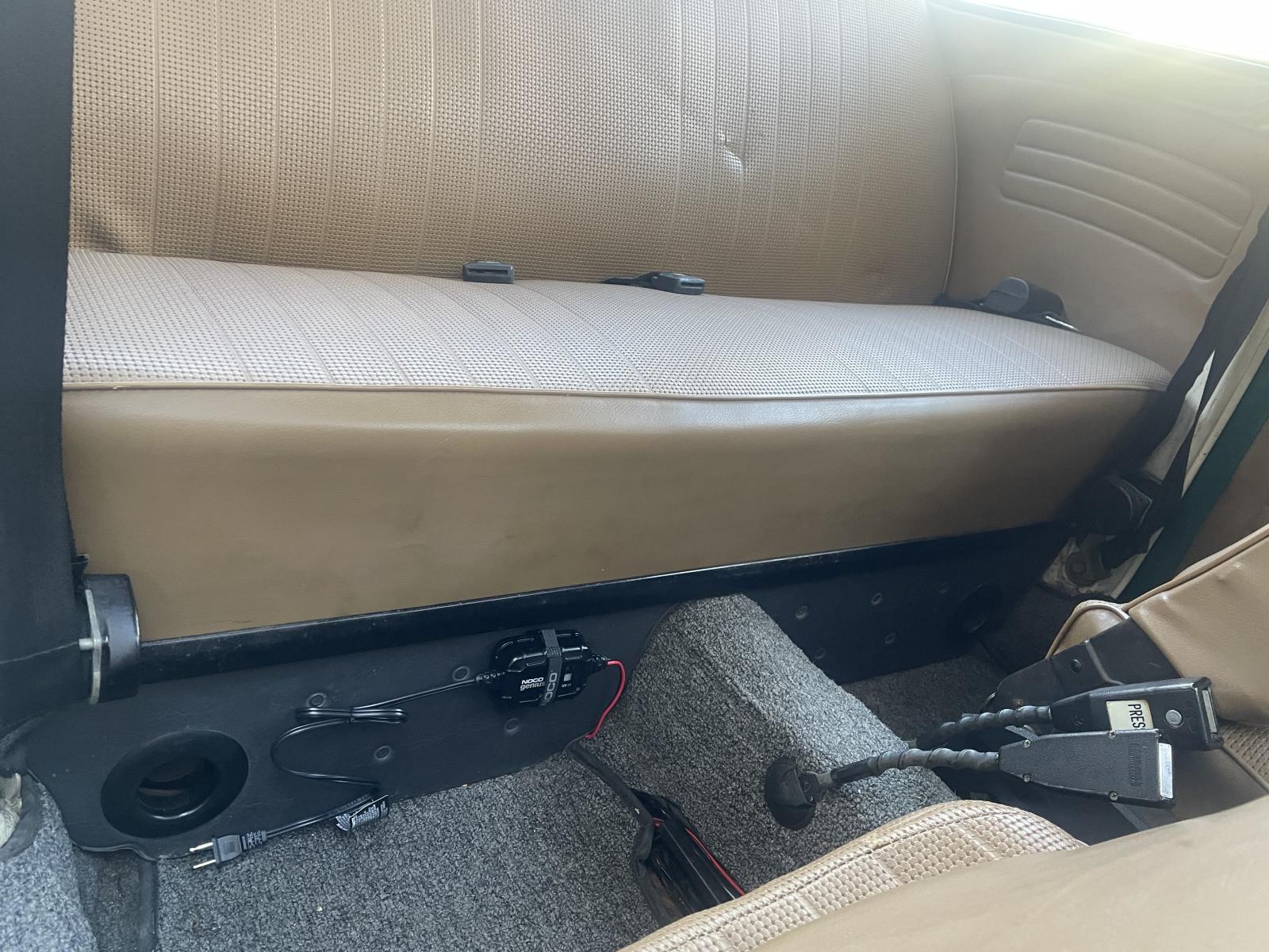

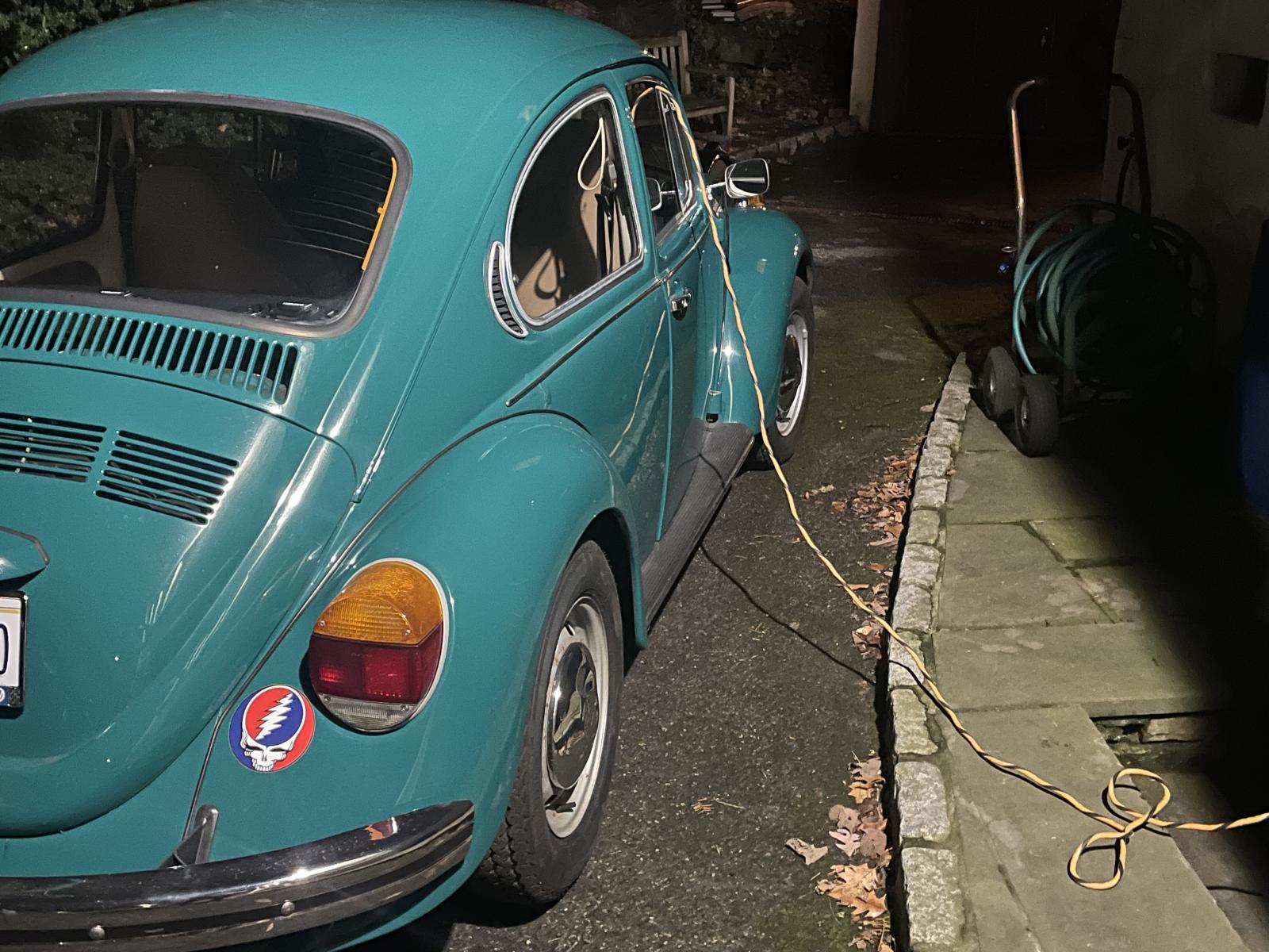

PostPosted: Sun Jan 12, 2025 6:34 am    Post subject: Re: What did you do to your Bug Today? Reply with quote
When I first bought my '73 Super in 2021 the seller told me it had a slow drain on the battery from (he thought) an aftermarket car alarm. I've left that alarm in place because it is the same one my Dad had in his bug in 1971 and it actually works. Plus I didn't let the "drain" bother me because in driving the car on a regular basis it never ran down the battery.
So in almost 4 years now that has happened 3 times when left and not started in say 4-5 weeks.
Over the years I've found and corrected most of the butt connectors and bad wiring with soldering and upgraded connectors. If there is a bad ground or connectors someplace I have not found it yet.
About two weeks ago the battery was close to dead in my driveway so the usual PITA taking the rear seat out and hooking up the charger for a few hours. A few friends on mine that own vintage and antique cars suggested what they have, a charger/maintainer that they installed in their engine compartments.
Of course they can pop the hood and look at them. For me install would be under the rear seat but I do/did want to see status. So on recommendation bought this NOCO that was highly recommended:
When I went to install the negative lug on the battery came off without loosening it. I had put some fog lights on the car a month earlier. The lug bolts were tight but kinda crushed into itself. So that may have been why the battery was running down in the first place, who knows? I used some aluminum from a pie plate to help make a tighter bite:
That worked fine.
I installed facing out so I could see & monitor battery status. In the future I might flip it around so only the power cable is shown. But I was doing this outside in the cold so for now and it being not in the way, this was fine:
Put the seat back in:
And hooked-up to house power, My 52 year old beetle Tesla:
It only took a few hours for the only indicator light to start blinking Green indicating 75-85% charged. But it took almost 24 hours for it to read straight and stay Green. This charger de-sulfates the battery and that is a long process for a little 2amp version. But it will correct or fix anything on the battery if possible. Which is kinda amazing.
Just went thru a period of ultra cold weather where I didn't drive or start the car in about 12 days. Other than the finial install and charging on Dec. 17th it wasn't till yesterday that I turned the key and she came to life with all lights and other stuff showing brightness. I'm short of 100% recommending yet as the loose lug may have been the problem in the first place and also the only other times the battery ran down was several weeks of not being used. But my friends with this same charger ($39.00 on Amazon) swear by it and leave it "on" all the time on their cars. I just hated taking that seat out and back on.
I maintain six (6) motorcycles and do not Winterize them. I start and ride them at least once a month if not too cold or snowbound and am a diehard Deltran Battery Tender owner. But this NOCO brand is a step higher in my limited opinion than the BT 12V battery charger/maintainers I use on the bikes, snowblower and generator battery's. I'll come back to this posting after the Winter to offer a final "you should get this" as my friends and a huge amount of positive reviews indicate. What my hope is to NOT use it (plug it in) at all to see if in fact it did correct and maintain the battery from the get-go.
https://www.amazon.com/s?k=battery+charger+maintai..._sb_noss_1

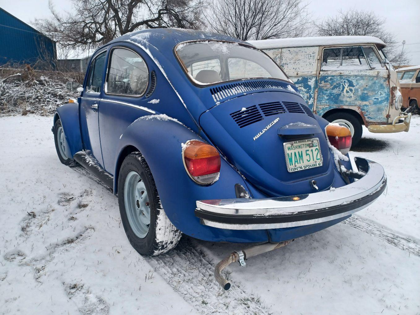

PostPosted: Tue Feb 04, 2025 4:03 pm    Post subject: Re: What did you do to your Bug Today? Reply with quote
Drove '77 sunroof standard around the yard in fresh snow.
Trying to keep poor cool

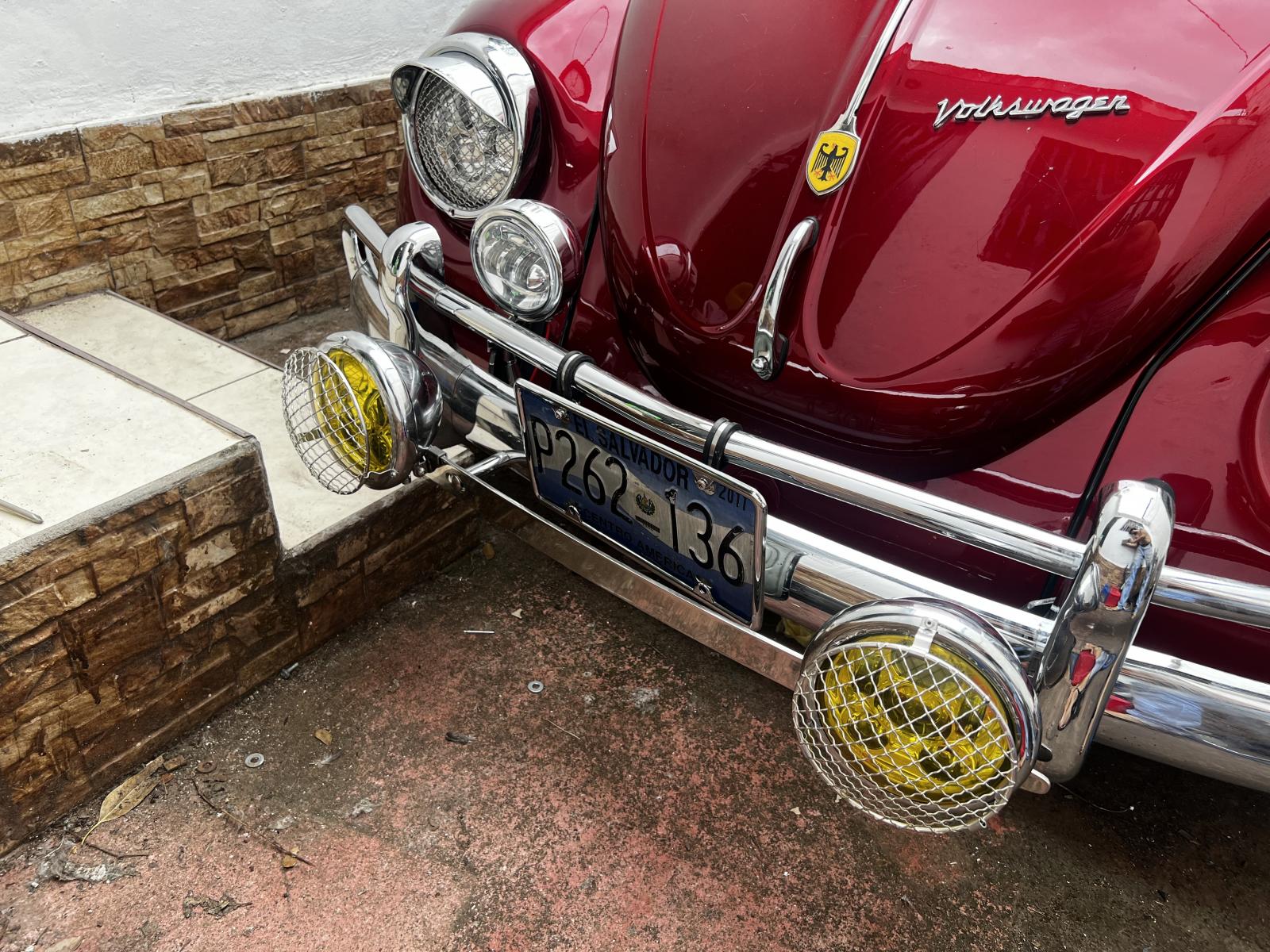

Yesterday I installed bumpers, plate, headlights and foglights with their rock guards and the eyebrow

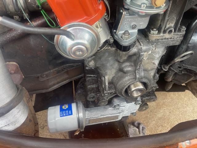

PostPosted: Mon Mar 17, 2025 1:00 pm    Post subject: Re: What did you do to your Bug Today? Reply with quote
Installed a Maxi 2 Oil pump and filter. Blasted and painted a few tins.
Orange 72 Super
