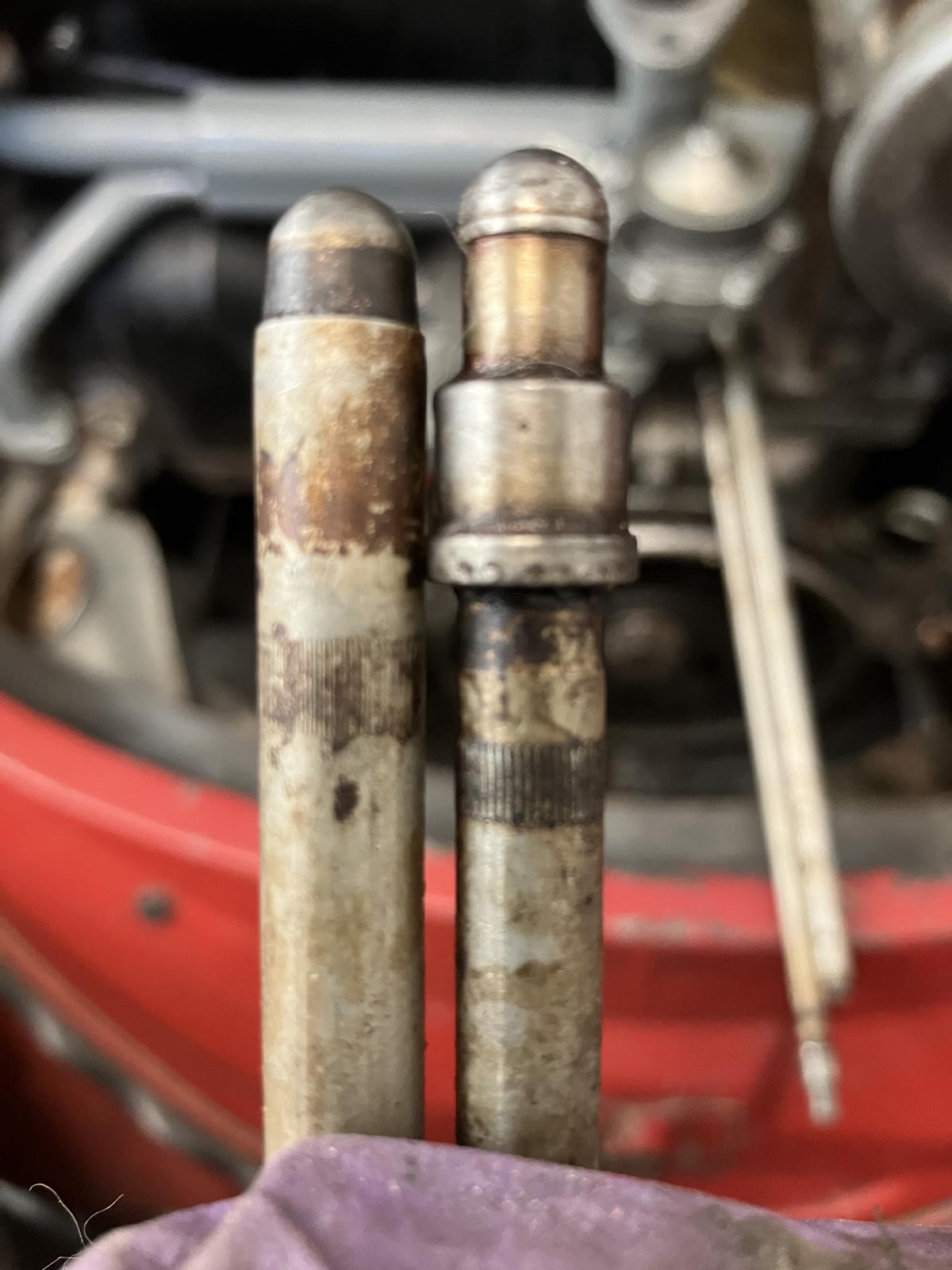

This post reminded me forgot to update my progress. Despite being on a liquid diet Saturday, did get the intake filter installed and the heat riser pipe massaged. The filter is slightly snug fit, will keep an eye on the temperature with my IR thermometer during the break-in.
Went to install the pushrods and rockers, as getting started, hit me to check they are clear, all plugged to dome degree, some totally, glad caught that. Soaking in Kroil to resolve the carbon, didn't feel strong enough to flip over yesterday and today found out need to keep my walking to a minimum.
By the way, so glad changed GI doctors, the center they use is fantastic, seemed everyone employed there adores dogs, some coming to drop by and give attention (does have a visit command). Better, first time meeting the GI doctor and really like him. Hopefully in a couple weeks can spend more time with Ruby!

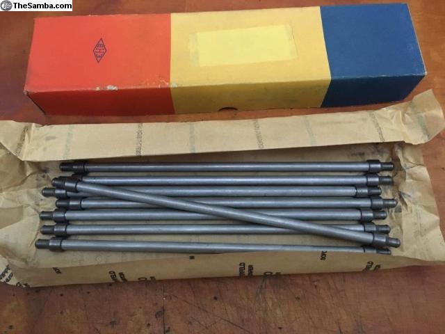

Here are the two different pushrods, aligned to show the difference in length, I have two of the kind on the left and six of the other, installed the last rebuilt in the 1970s and about 250,000 (using 1964 heads with 1/2 bolts on the rockers). What puzzles me is both have the ribbing and per Volkswagen, means the longer length that started in 1965.
Do I go with or does someone have a couple of the one on the right?

I have these but if you can just replaced the two you need you might be better off.

Are these the longer length?

PostPosted: Tue Feb 06, 2024 6:10 pm    Post subject: Re: Dad's 1964 Ruby Red Beetle Reply with quote
I've got 4 of the longer style (right one in your picture) pushrods left over from when I rebuilt the '65 40hp that's in my VW. They are straight and clear inside but need the usual cleaning associated with old parts that have been sitting for years. They're all yours if you want them. PM me if you're interested. I've been checking in on this thread from time to time and hope to see your car back on the road again.

PostPosted: Tue Feb 06, 2024 6:33 pm    Post subject: Re: Dad's 1964 Ruby Red Beetle Reply with quote
Fantastic! Very Happy Exactly, 1965 would be the longer length. PM sent. Even if plugged, would still accept them, not hard to un-plug, just takes soaking them in Kroil.

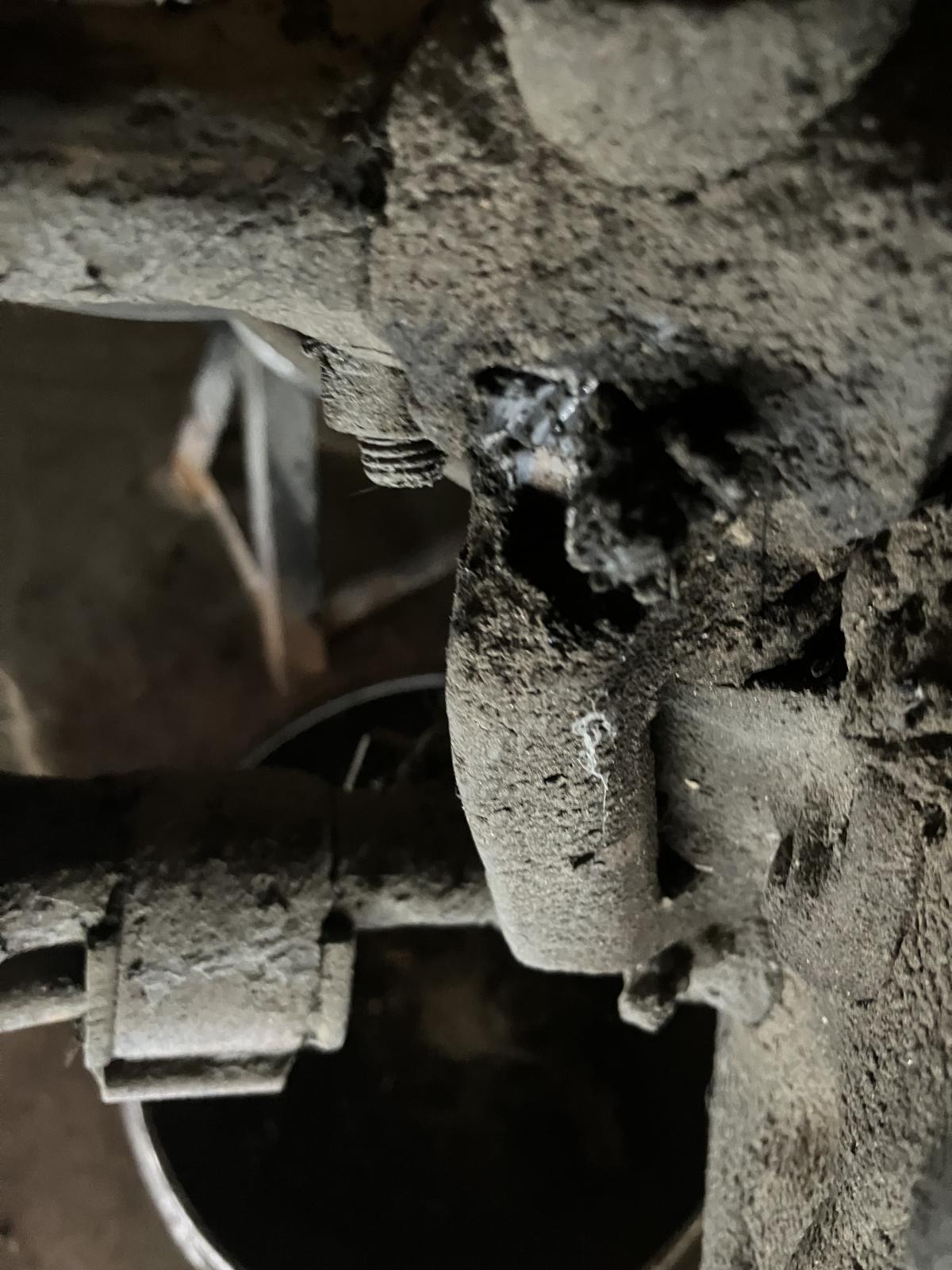

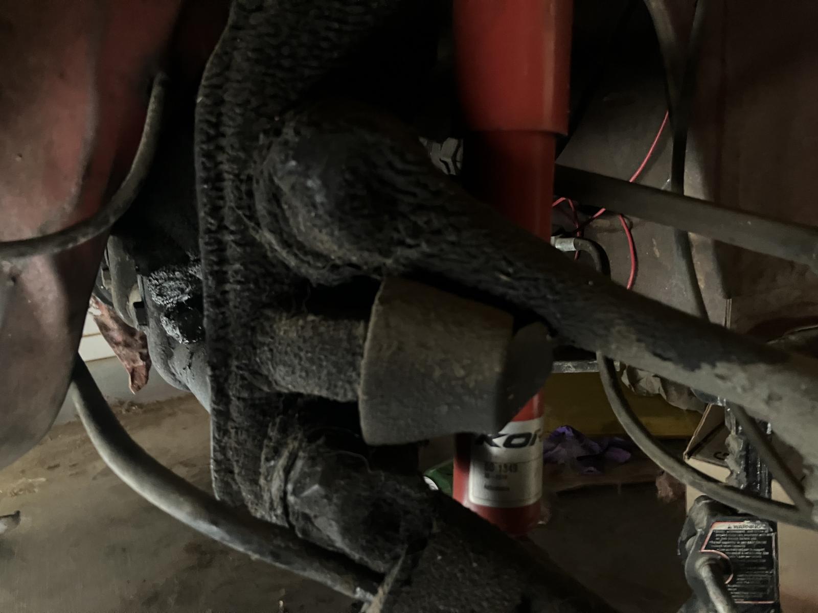

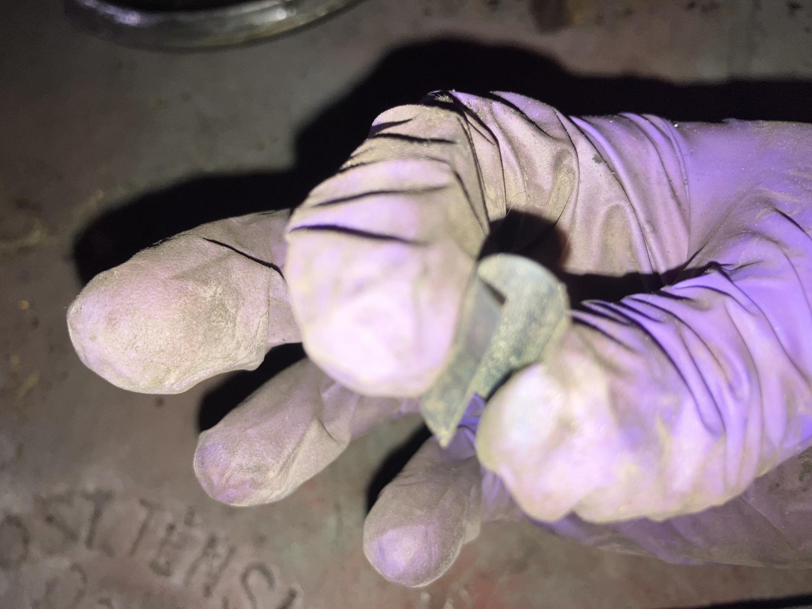

Cleaning the driver side, this came off somewhere, anyone know where it is from and goes?

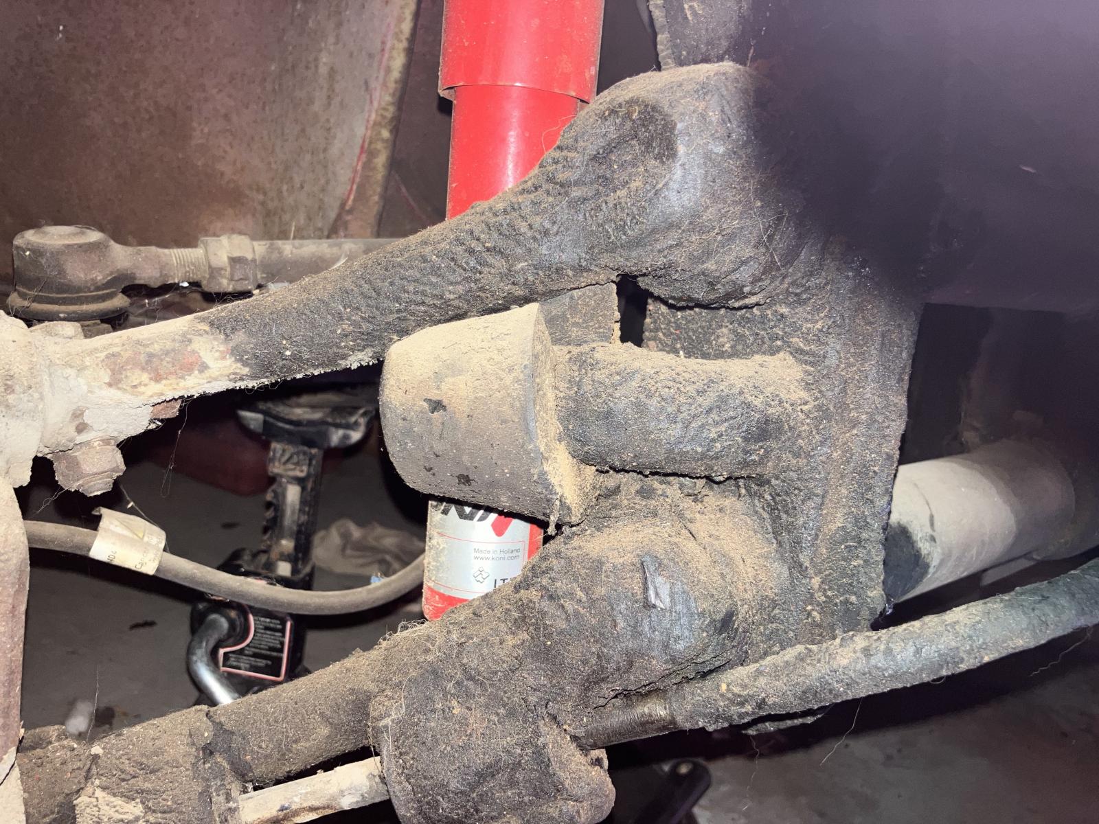

While cleaning, found a couple things. Firstly, the torsion arm seals have shrunk, significant gaps, so the beam will have to come out and get new seals installed. Secondly, the sway bar rubber mountings are still soft, though some look deformed, replace those at some point. Thirdly, found the steering box is leaking, in the late afternoon added a little more oil (have ATF to use up), careful not to fill to the top, now when steering feels better and quieter. At some point will have to rebuild it, do it when rebuild.
Speaking of feeling better, before greasing the kingpins, grabbing the drum and turning took a significant amount of effort and I am no weakling. It took all my strength to get grease in, my understanding because what grease was left has dried up. With grease added, now the only restriction is the steering dampener. At the steering wheel, feels so much better. My Dad was very meticulous about maintenance so really surprises me he missed greasing the front suspension. Also makes me wonder what the grease is like in what looks to be original tie rod ends, boots are still good.

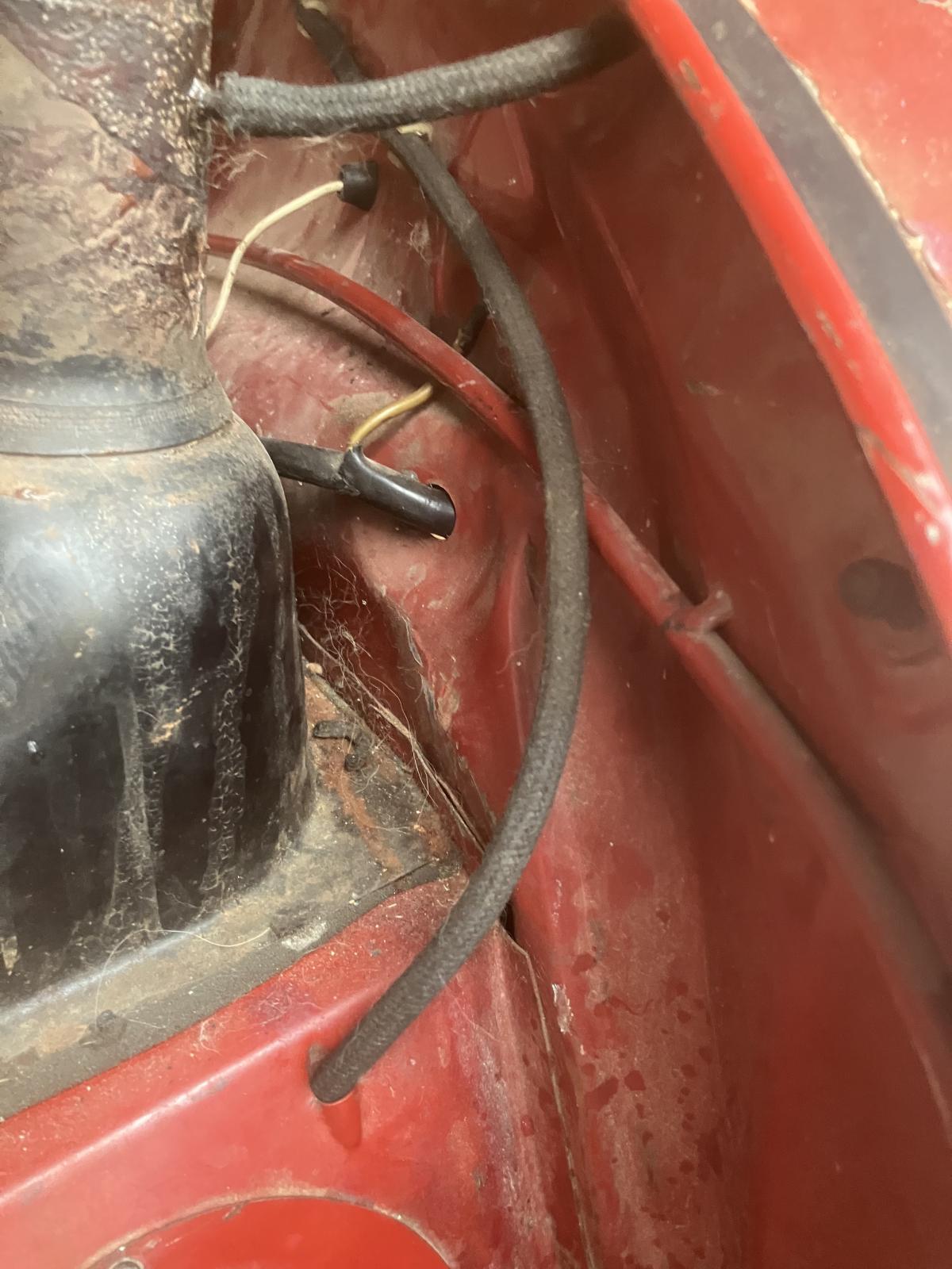

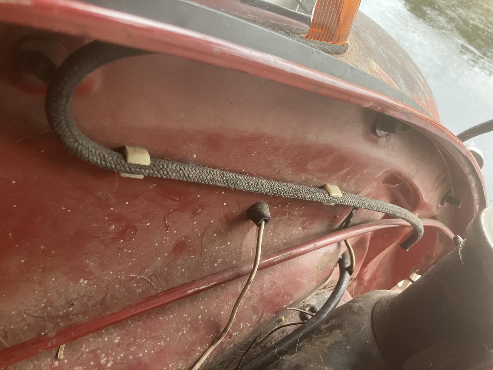

When cleaning out the spare tire well, found the fuel tank vent hose so crispy it broke off in my hand. Laughing
So, I replaced it, now know why I had a long piece of this hose. Would not surprise me if one reason the cabin smelled of fuel on warm days, know Dad tried to have that sorted as one of the few recipes I have. Sure be nice if that simple, I rather not have it.
I think they are. These are the 1300 to 1600 versions. I can measure for you if you would like.
Thank you for your reply. Very Happy Though, as can see from above, someone is giving me four correct pushrod tubes. If had spending money, pick this up, eventually like to build another engine. Very Happy

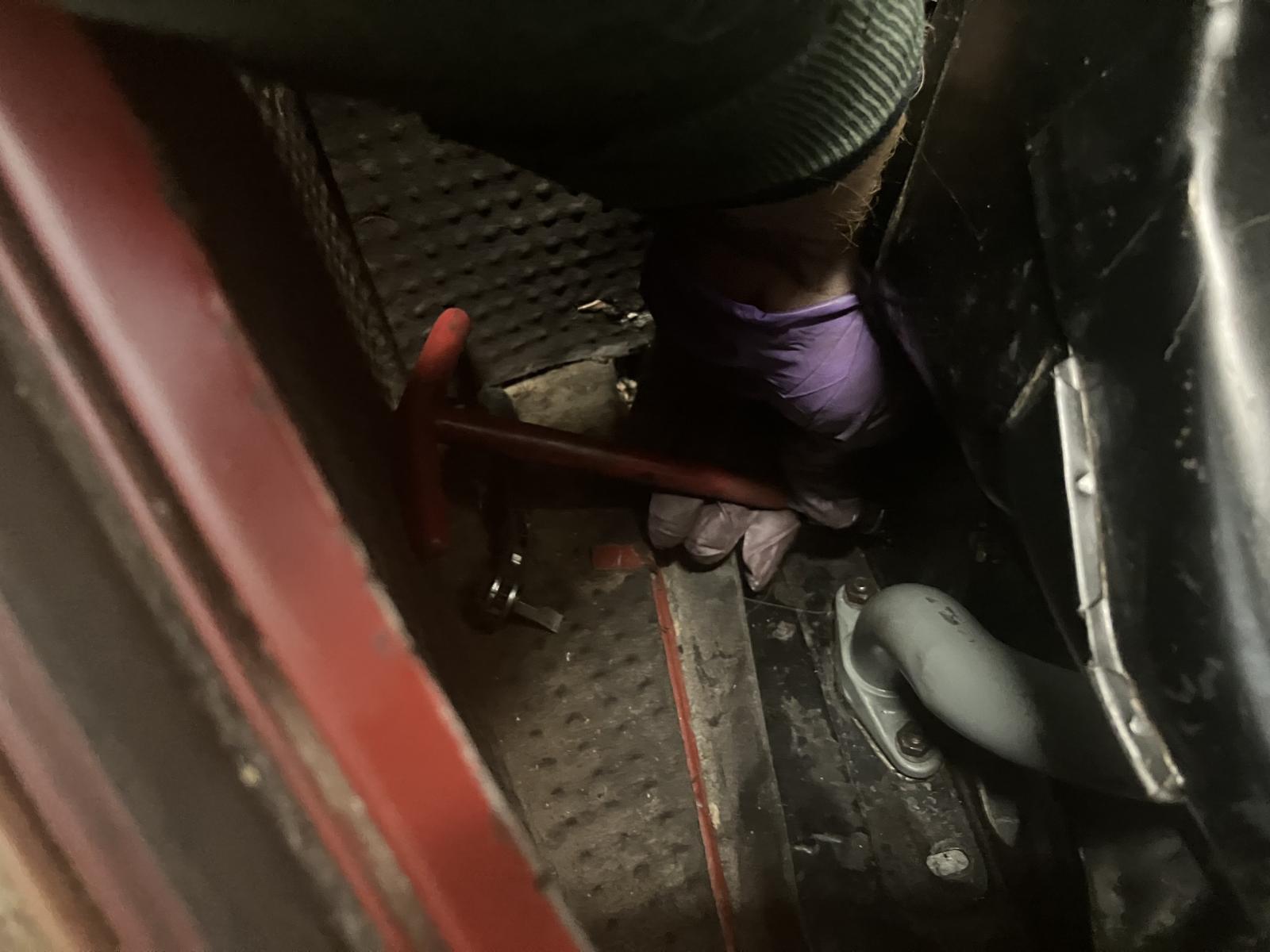

Bent a wrench. Lesson learned, don't forget to take off your rubber gloves when using heat, if not, the burn be far worse, and burning human flesh doesn't smell all that great. Put on some cold water from the hose bib and kept working.

Interesting no one noticed Volkswagen seems to have made the steel fuel line too long, see how at the top of Ruby's is significantly higher from the inlet than this 1964 with 22 miles?

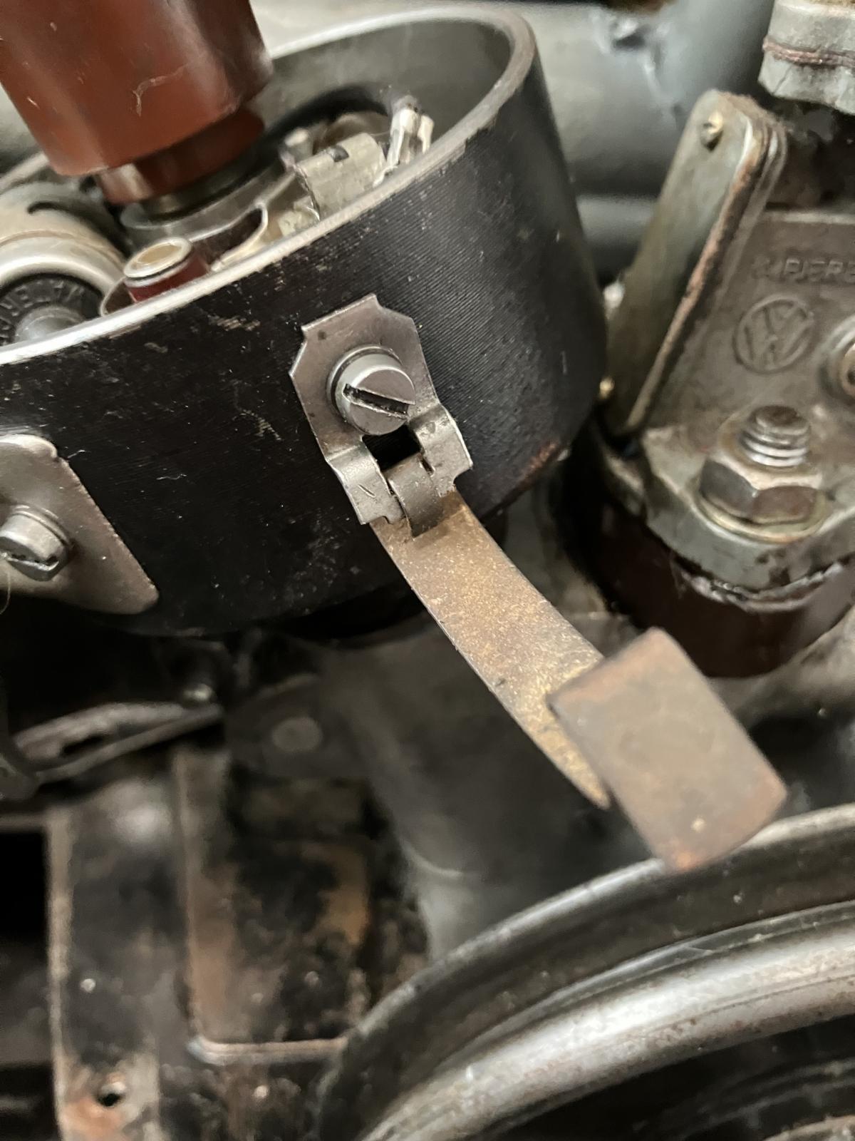

Only now realize don't have a 6 volt static timing lamp, so pulled the turn signal bulb and temporarily tacked on some leads, to be replaced by a socket (an absolute chore getting the solder to stick even using flux). Also an opportunity to improve soldering, as can see, does need improvement.
Higher than the carb inlet at the top of your photo?
If you match the rubber fuel line length I believe it will look the same.
Look on Black Beaty's line, the end of the steel fuel line lines up with the carburetor inlet.
Will then not reach the fuel inlet. Doing that to the outlet of the fuel pump makes it worse.
I have stared at this for long amounts of time multiple times, and just not seeing anything but Volkswagen made it too long.
