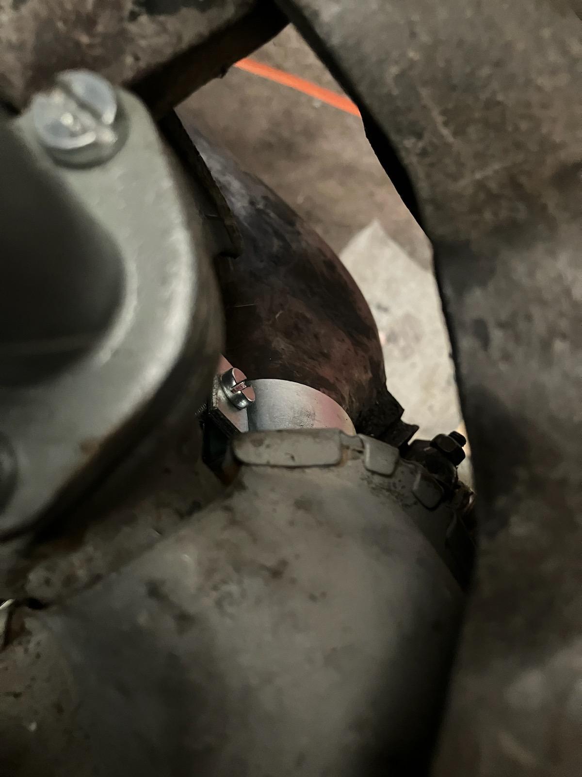

Firstly, a question. Anyone know what size the hardware that holds the wires to the points?
The borrowed distributor has non Bosch points and took about an hour to set, figure been easier with the Bosch, though at least got it set and do for now.
Barely getting anything done:
Monday got the new generator strap installed (B and T from Germany).
Tuesday set the dwell to 0,4mm and static timed the engine. Tested the fuel tank, found one leak, pulled the tank (thankfully most of the gasket stayed on the body), and found a new leak, two in total. Hopefully Saturday can find my very large vintage soldering iron that belonged to my maternal Grandfather in the storage unit.
This morning got the heater box to kidney clamps installed (nice German units for what seems to be a good price for the quality) and the German plug wires installed. Also got the ignition wires installed, glad chose Wolfsburg West. In fact, I like these more than the Bosch, stiff wires and tight rubbers. Had to quit before the office opened, so much fumes have to have the door open, hoping tomorrow morning have cleared out.
Are you talking about the flat head screw?
Sometimes it's easier to set the points outside of the car that way you can insert the feeler gauge in there more easily. If the distributor is installed, just turn the crank until the lobe presses out on the points. Put the feeler gauge in between the points and tighten down the screw. Some sets of points close down when you tighten the screw. So, after you tighten the screw you have to check the gap again to confirm the settings.
Adriel Rowley
Joined: October 12, 2006
Posts: 4823
Location: Mesa, Arizona
Adriel Rowley is offline
PostPosted: Thu Feb 22, 2024 4:25 pm    Post subject: Re: Dad's 1964 Ruby Red Beetle Reply with quote
heimlich wrote:
The "stud" as the manual calls it and then has a nut.
These points don't allow for either.

Made it out for a couple hours, now can't think of anything more doing other then sealing the fuel tank. Speaking of which, having it out turned out to be fortunate, almost every seeming bad thing has something positive (except loosing a pet or a human), as then really simple to swap the brake fluid reservoir.
Also bled the front brakes and adjusted all four corners, set to where a slight depression starts engagement and with the brakes off, slight drag. These dead blow hammers sure are handy for these tasks working alone.
Please consider I am Autistic, so I process information differently and still working on social skills. Thanks.
