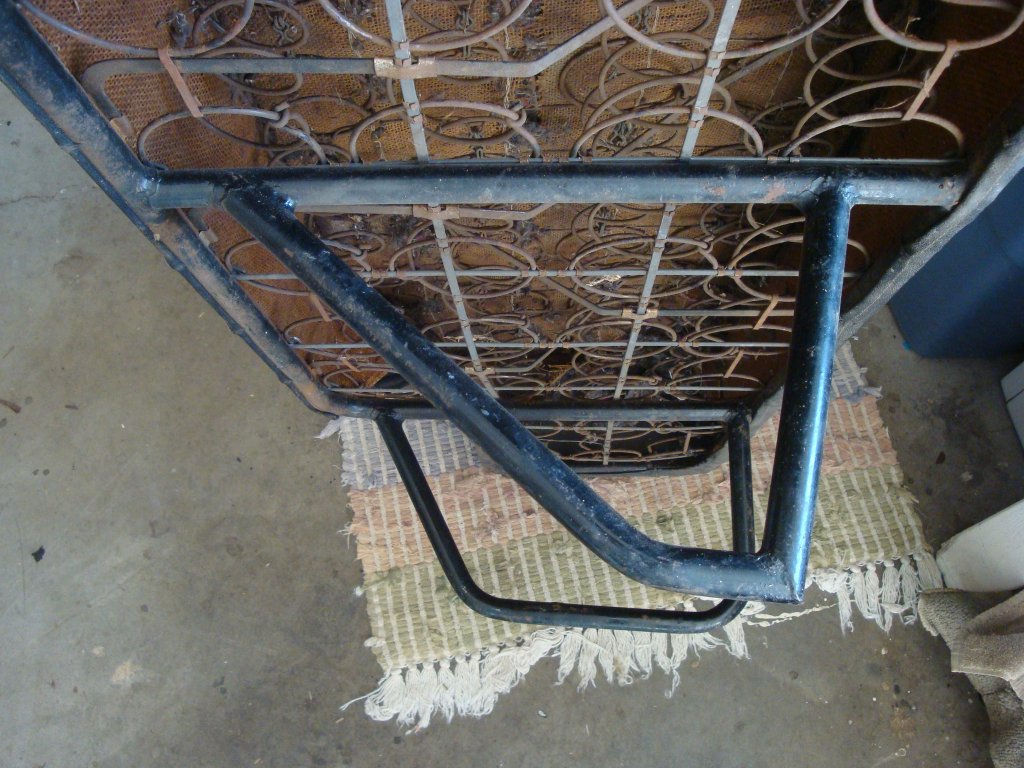

The bottom looks strange though, there should be more cross-bars, here's another photo of the bottom of a 6-leg seat
See how the 6 "legs" that come down from the seat back connect to cross-bars on the bottom of the seat frame?
It may be a "6-leg" back rest on a later 56-57 seat bottom.
The large springs on the bottom ended in 1957 so that is why I say it might be a 56-57 seat bottom.

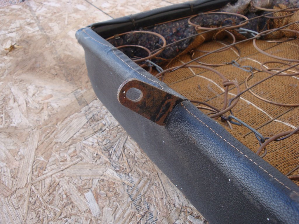

Barndoor (pre March, 1955) rear seats and and 55 and later back seats are also slightly different.
The Barndoor rear seat back rest has 2 tabs that stick out, like this:
and the bottom has a sharp center leg like this
(This is for later 1955 Buses too)

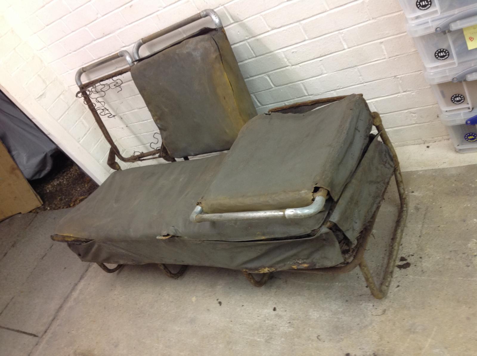

I recently picked up this early double flipper
It needs some love
Looks to be in similar condition to Lind's seat here
https://www.thesamba.com/vw/forum/viewtopic.php?t=...p;start=20

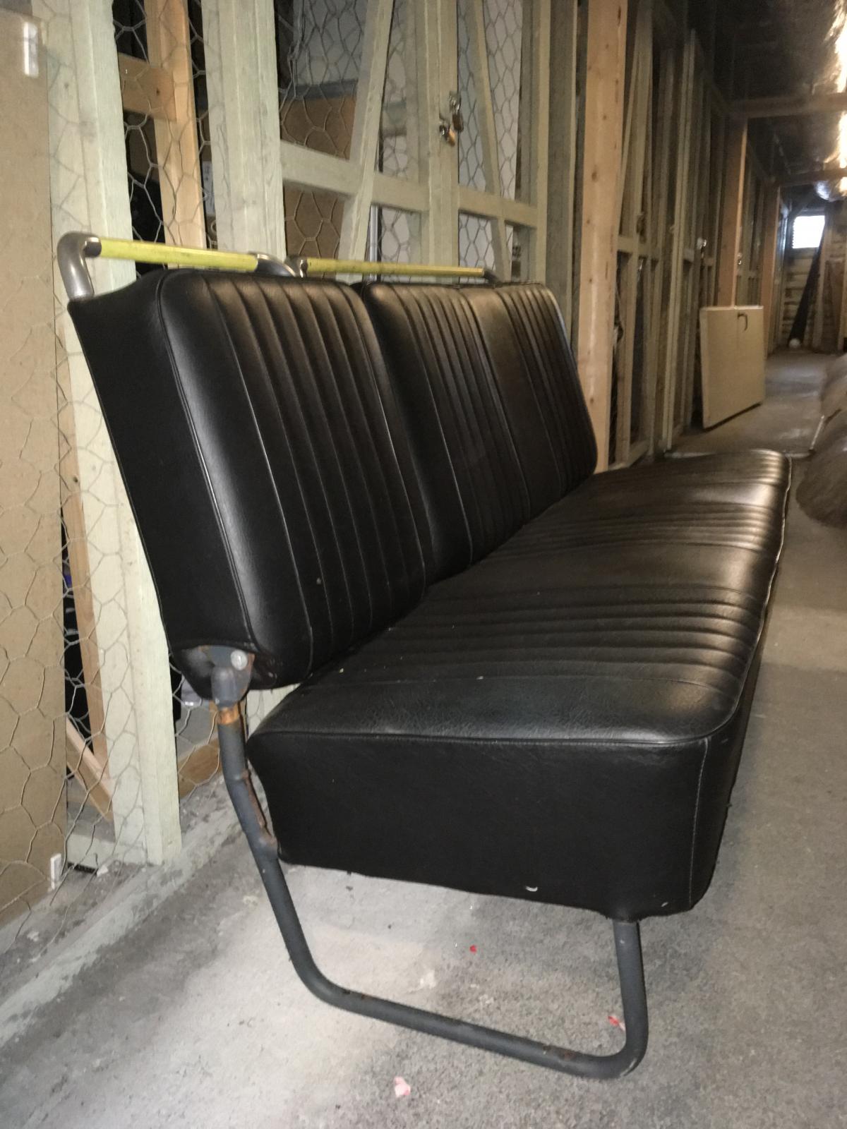

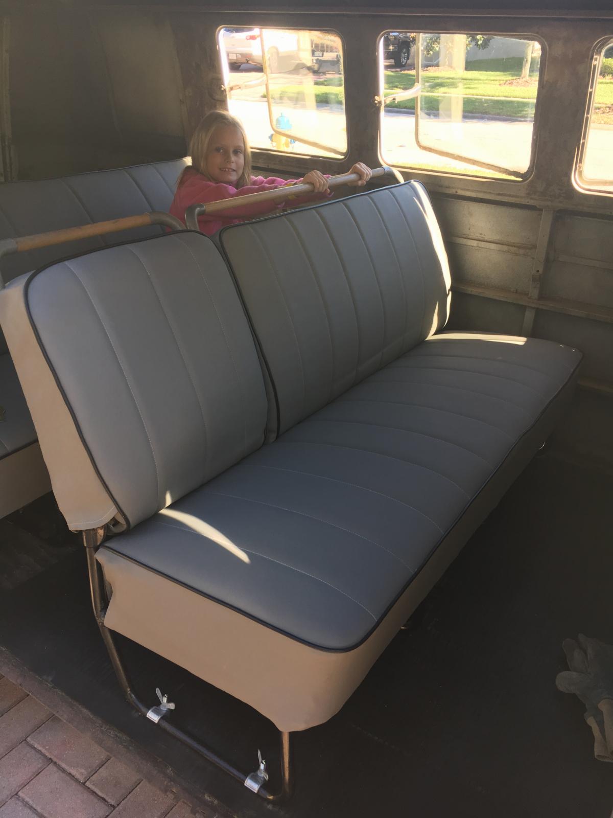

I have a question on this grab bar in my 58 pressed bumper standard bus. It looks like most 58 pressed bumper pgsg buses came with a black grab bar... Does anyone know when these white/cream grab bars with the aluminum mounts were manufactured and for which models. I do know it had an ash tray mount on the back originally... Here are some pics to help with my question.
If it helps the only thing I have been able to find on this site is " early -mid '61 deluxes have white ribed vinyl material on the grab bar"
There has to be more info out there on this grab bar...
Original pic of the seat prior to getting it redone...
Posts: 71436
PostPosted: Thu Nov 15, 2018 7:37 am    Post subject: Re: Middle seats Reply with quote
Nice score on that double flipper above!
On the vinyl grab bar seat above, what you posted is correct.
"early -mid '61 deluxes have white ribed vinyl material on the grab bar"
This is what Buses had this plastic-covered grab bar. 1961 Deluxes.
I can see your seat before it was redone has the upholstery for 59-61 Deluxe Bus.
