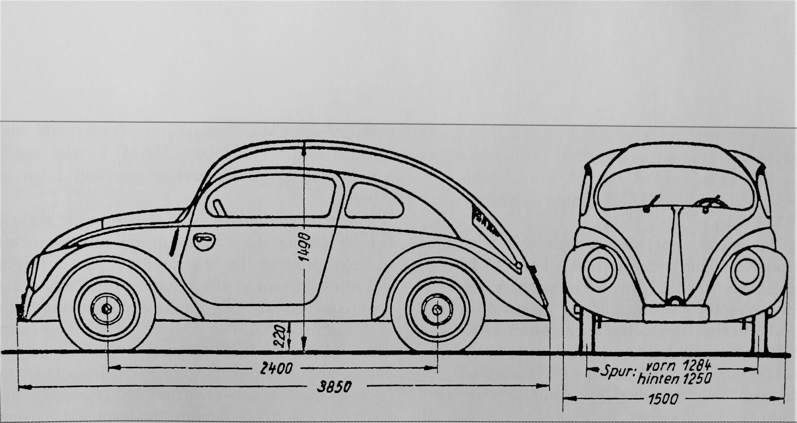

Also in 1936 a proper drawing study of the W30 body appeared showing crucial dimensions which will be useful in creating a replica body.

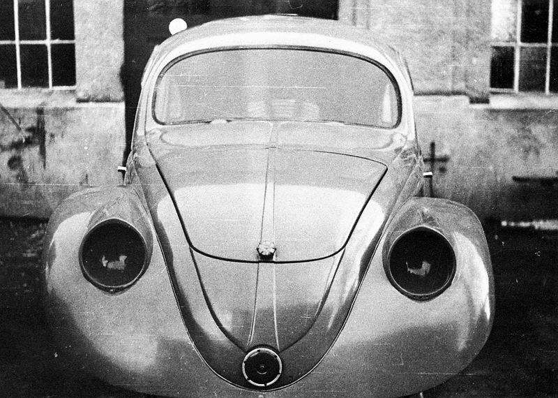

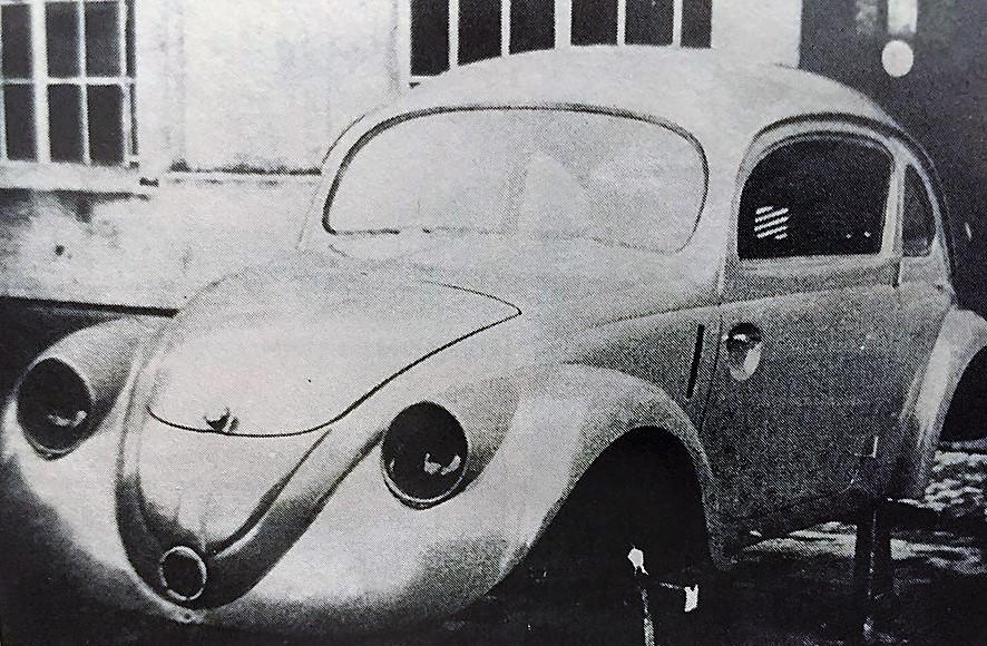

Just like with the previous Volkswagen prototypes the task to build the bodies of the W30 went to Daimler-Benz (DB). In September 1936 the work started. One of the bodies was brought forward and was already finished sometime in early December 1936. At the same time the V3 tests were in full swing but as we can see the next generation was already on its way. The first W30 chassis was also finished at around the same time. Unlike all the other 29 cars after that, the first one or “car zero” was finished at the Porsche Villa. After the body was built at the DB factory of Sindelfingen it was photographed in the factory grounds sitting on trestles. After that it was taken to the Porsche Villa and photographed some more right in front of the house. The complete chassis was delivered from another DB factory at Untertürkheim and photos of the chassis were made in front of the house. Later both were united in the Porsche Villa garage and now complete car had the temporary plates IIIA 0426 installed and more photos were again made. Later on the car received its permanent plate IIIA 37000 and it was photographed some more in the garden of the Porsche Villa together with car V3/3.
Body "zero" at the Sindelfingen factory grounds before being delivered to Porsche. Note the body is already mounted on a bare chassis platform.

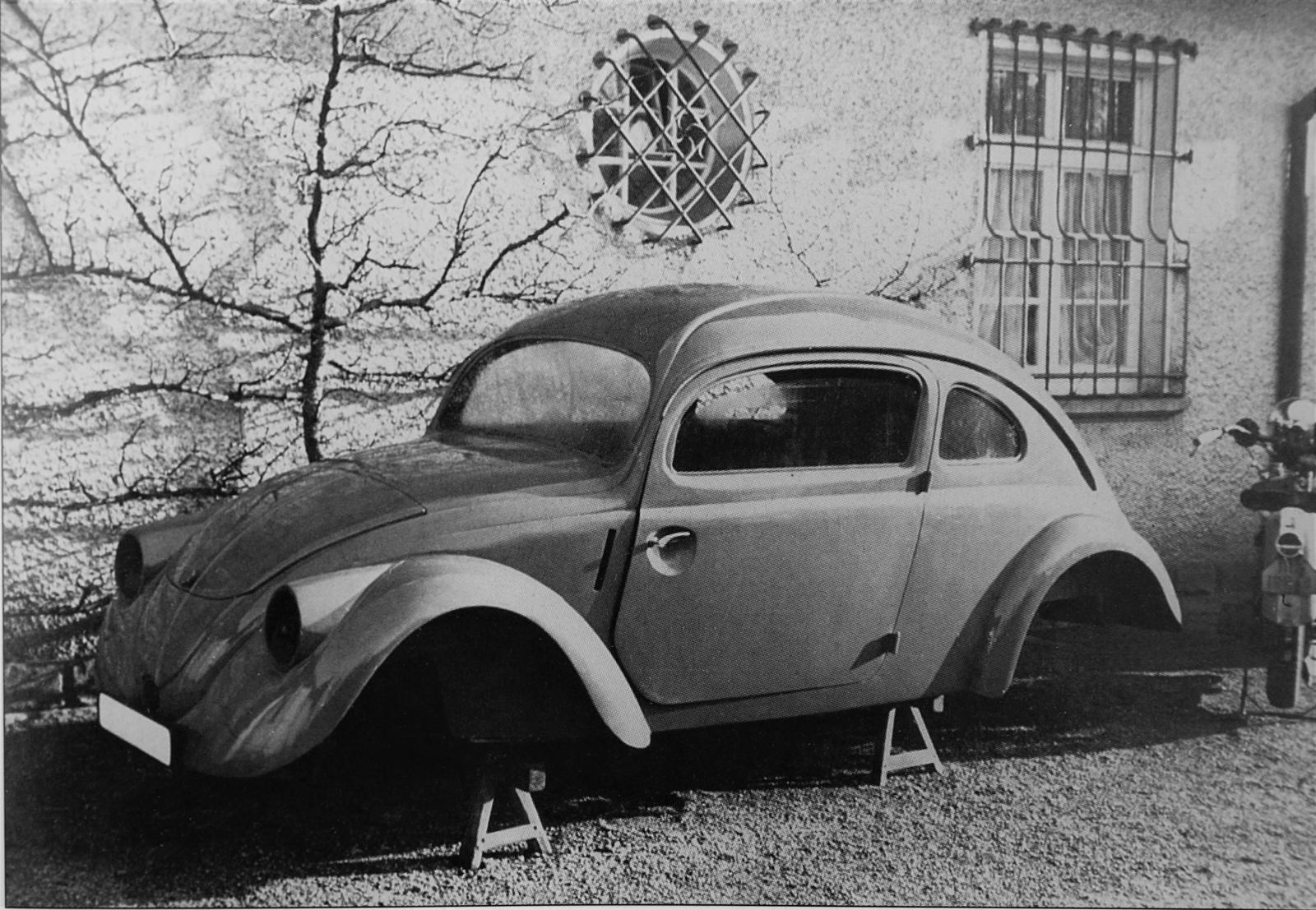

The same body "zero" as delivered to the Porsche villa in Stuttgart. This would be the only car of the W30 series to be assembled in the Porsche garage just the way the previous prototypes had been in 1935 and 1936.

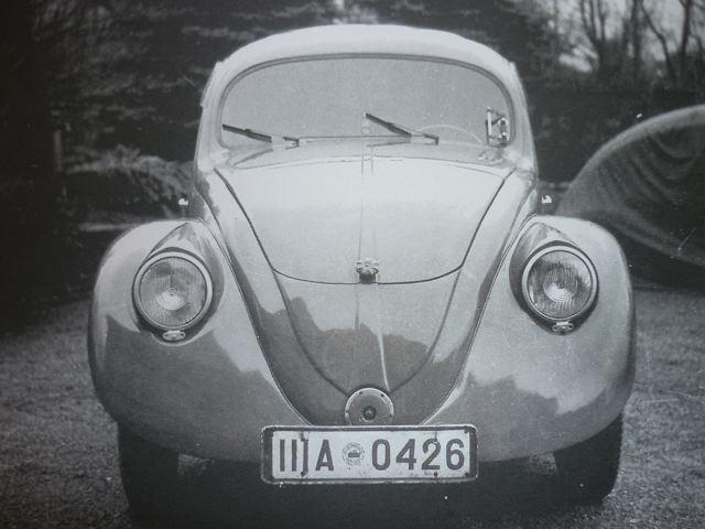

The now complete car had the temporary plates IIIA 0426 installed and more photos were again made.

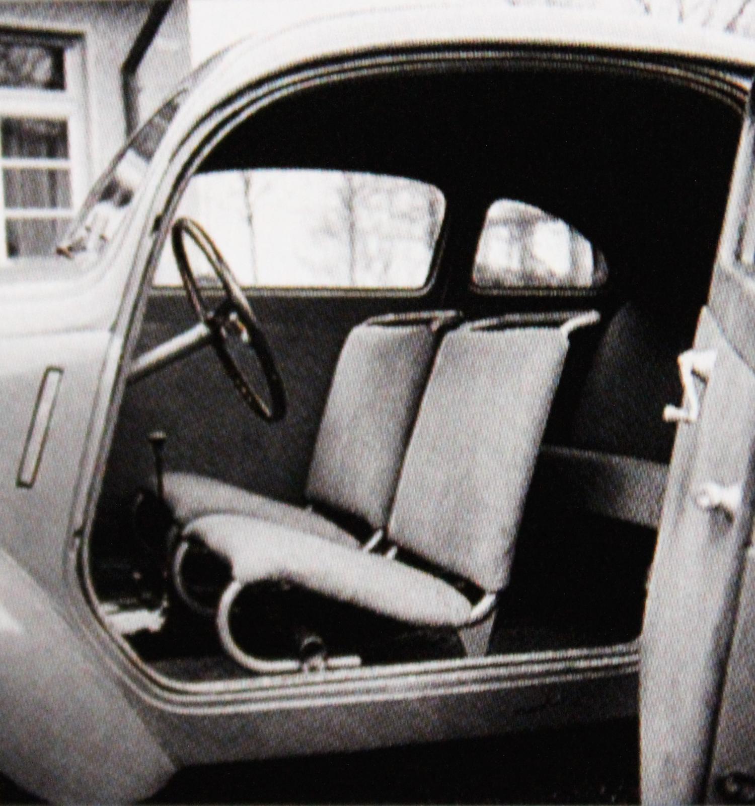

Several photos of the interior were made as well. These are invaluable for a proper reconstruction of car 26.

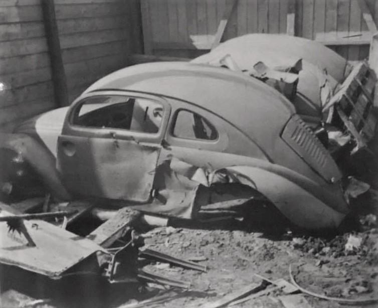

Car in the centre of this topic, W30/26 was one of the other test cars built afterwards. It was tested under various conditions. It was tasked to be driven on “Autobahn, Schwartzwald und Stadt” (Highway, the Black Forest and City). At the end of the official tests it had driven 59,651 Kilometres which was an average figure as many other cars had done much more. Although there is only one known to me photo of car 26, it is a very special car. During July 1937 car 26 was taken to Berlin Technical University which had a wind tunnel. The car was specifically prepared for the test by having its wheel arches covered and modifications made to the windscreen. It can be presumed that the tests were done with the car unaltered and then with the modifications seen in the photo below. The best Cd achieved was 0.435! This was proof that the shape of the Volkswagen was on the right track for providing very good fuel economy. I have not been able to find much more about car 26 except that in his book Chris Barber writes that in a Porsche factory inventory list dated sometime after September 1938 car 26 is no longer recorded, or at least the body was missing, presumably destroyed in an accident. The chassis and engine from car 26 had been fitted with the body of car 8. Something I discovered recently is that car 26 no longer appears on a board listing the cars and drivers on the wall at the Kornwestheim Barracks where the W30 cars were stationed until November 1937 (thanks to a Samba member by the name “IIIA-0426” for this info). What ever was the case it seems the body of car 26 was destroyed at some point but the chassis lived on.
Car 26 undergoing wind tunnel tests.
This could as well be body 26 destroyed in an accident.
W30 cars being torn down for checking at the Kornwestheim Barracks. Note the board visible in the upper right corner.
Closeup of the board shows car 26 missing from the list. This is no later than November 1937.
After the W30 prototypes had been broken up in 1942 the mechanical parts were reused for various experiments and development. What is even more special is that the chassis of car 26 is the only known chassis to have survived. It was discovered after the war in a junk yard in Austria. It is known that in 1944 Porsche took various cars that he was working on to a new factory site in Gmünd, Austria near his family home. Chassis 26 was very likely one of those. It appears that while in Austria chassis 26 was used with a very early type 62 Kübelwagen body. The distinctive “beak” on the framehead used to support the spare tire has been cut off and hammered down.
