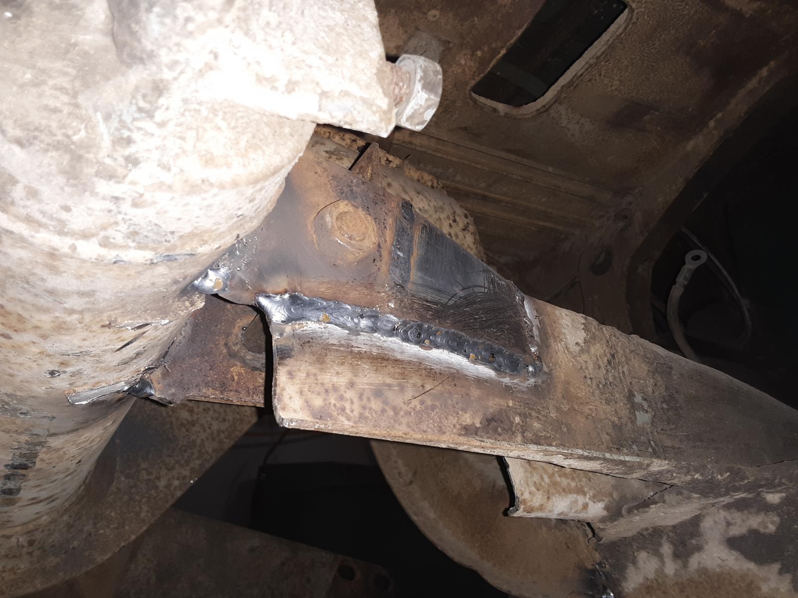

PostPosted: Sat Aug 15, 2020 3:02 pm    Post subject: Re: Bay IRS into a Split Reply with quote
my 59 kombi is 68 IRS. Brackets welded under frame horns. Pic shows reinforcement of the frame horns.

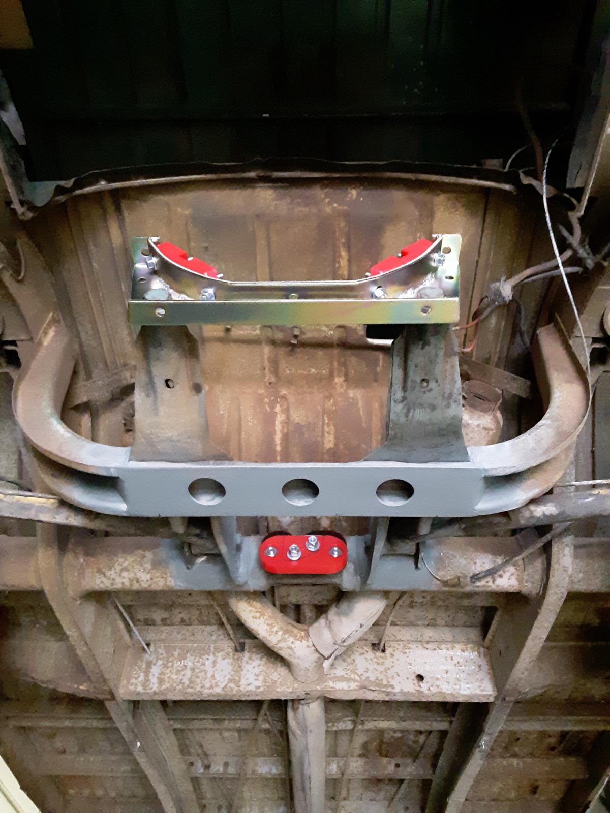

PostPosted: Wed Aug 19, 2020 12:53 am    Post subject: Re: Bay IRS into a Split Reply with quote
I lifted my '67 kombi with the same combination that Brett used. Although I've dropped the trans for improved CV angle, which allows me to use the Type1 nosecone also. I believe my drum-to-drum dim. is 57-1/2 inches.
Type1 transaxle with 100mm flanges
Type2 stock length axles Type4 CV's
Early bay trailing arms and spring plates, split torsions
~1 inch trans/frame horn drop. Custom front mount
Busstom

dred wrote:
One thing's for sure, this is an elegant solution for beefing up the cradle and hiding/eliminating the bent flanges from errant jacking on almost every Bus out there. I've been contemplating something like this for 20 years or more, but have just never executed. This is the first example I've ever seen of it outside of my imagination. I suspect I'll go thicker, say .188 or a quarter inch, and perhaps wrap up the sides (can't tell if that's eighth inch or thicker). One day.
Nice.

PostPosted: Thu Aug 20, 2020 5:46 am    Post subject: Re: Bay IRS into a Split Reply with quote
Thanks Busstom, it just worked out that since I lowered the center of the cradle I could remove the bent up lips and then get back to stock profile with the plate I fabbed in. Its 10ga

PostPosted: Sat Aug 22, 2020 11:31 am    Post subject: Re: Bay IRS into a Split Reply with quote
Hi Dred, Did you weld metal to the outer frames horns where it was removed.
I didn't see it in the last pic.
It doesn't look like that's possible, because the control arms reside in that window cut into the sides of the horns.
Dred, I see more clearly now...I didn't notice the tabs on the ends that break up into the channel of the cradle. Very clean. (And sorry for responding to Bretts question, just stating my observations.) Wink

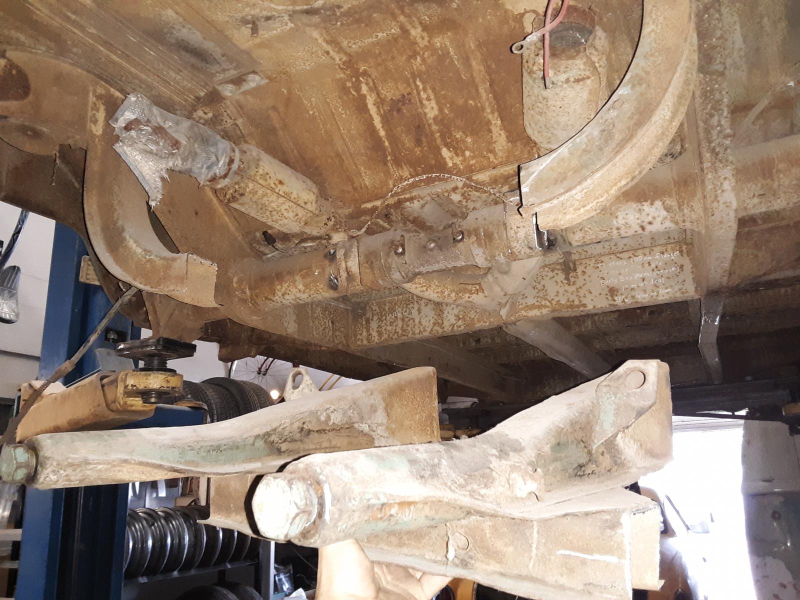

PostPosted: Mon Nov 23, 2020 3:59 am    Post subject: Re: Bay IRS into a Split Reply with quote
I used all the parts from a 70 model in my swap and just modified the arms and fabricated my own brackets so I didnt have to cut up anything on my pickup. The brackets slide under the heater tubes, over to the transmission supports.

PostPosted: Wed Nov 25, 2020 11:20 pm    Post subject: Re: Bay IRS into a Split Reply with quote
After all IRS parts are installed
