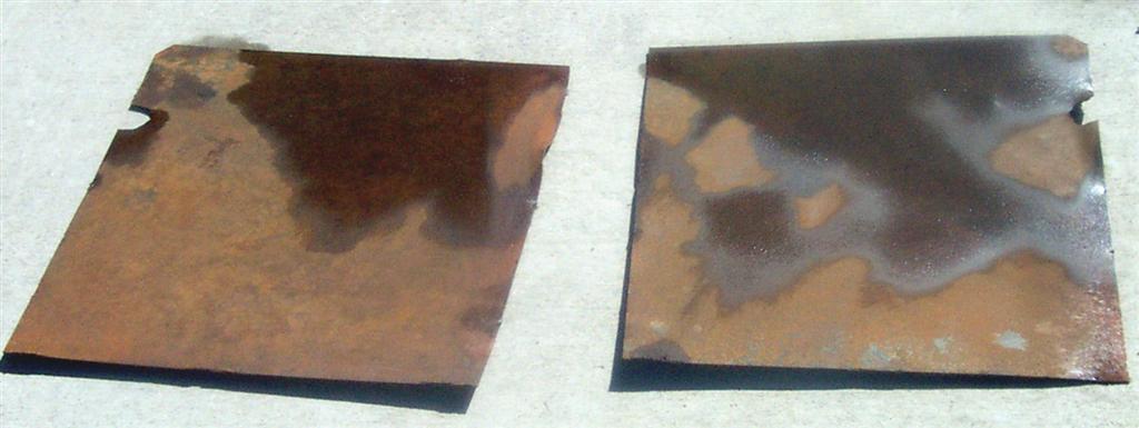

The steel panels were used as pan patches in my ghia for about 6 years, they have been sitting outside now for 4 months. I've been pouring salt water, coke, coffee, etc on them every other day for the past few months. To prep them all I did was wash with soap and water, wire brushed them and then rinsed.
2 coats of each product were used.
Eastwood, Masterseries and Rust Bullet - they all went on very similar, almost like a liquid metal. Eastwood seemed a bit thicker and dried by far the quickest (30 min). My guess is that all of these will end up with similar results.
Por-15 - went on thinnner than the other coatings and took a lot longer to dry (2 hrs). The first coat had a green tint.
Rustoleum - went on like house paint and had zero flow
Jasco - this stuff was strange, it runs $6/quart. it is a clear green liquid that seemed to convert all the rust better than the 2 Por products. Then it formed a clear "coating" over the raw metal. It will be interesting to see what happens with this.
I will probably top coat 1/2 of the panels and then let them sit out all winter in the snow and see which ones fail first.
The Por-15 came in a kit with a degreaser and rust remover. This did an excellent job of getting rid of the rust and prepping the rusty metal although if you go through all the steps there is no rust left and you could probably just use an epoxy primer to seal the metal and it would hold up fine.
The 4 smaller sections have East,RB,Master & Por over the "properly" prepped metal. I also put the Por directly over the rust with no prep just like the other coatings so everything is equal. The rust colored coating is the Rustoleum and the black/white coating is the Jasco.
I'm guessing that Masterseries, Rust Bullet and Eastwood's products will have similar results. Rustoleum is crap. I'm really wondering what will happen with the Por-15 and that Jasco. Both of those are quite a bit different.
Let me know if you have any questions or if there are any other products to test (I still have the back sides left)

The Jasco won't last. It'll rust tomorrow. It's made to prep the metal before painting.
I used that stuff on a bunch of old rusty bolts and they came out beautiful. I set them outside so I wouldn't have to smell the chemicals and in a day or two they all had a purdy rust color to them.

The Por metal conditioner and the Jasco took about 95% of the rust away. I thought the Jasco did a better job (espicially for $6). I'm going to use an acrylic primer on part of the jasco square to see if it will hold up at all.

Well, after the first heavy rain the Jacso and the primered Jasco failed. It's just flaking off. All the other ones are doing fine.

A tiny bit of rust is starting to show on every coating only along the edges of the 2 panels
